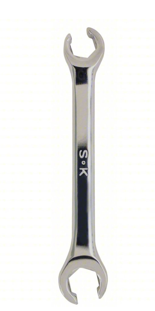

    Also, there are special wrenches to use on flare nuts so that “rounding off” the corners is far less plausible. Pic attached. If you decide to buy some, Harbor Freight has a set that works just fine. Remember though, there metric and SAE types.

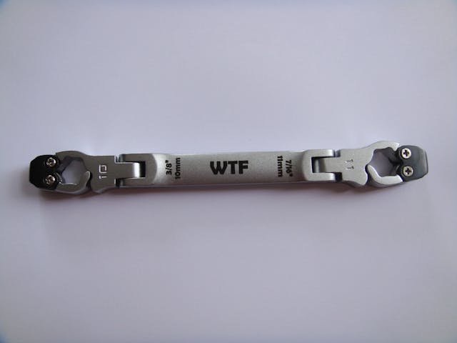

    This style works well. I even use a cheater on it.

    Where you get that one? That looks like it’s up to any seized flare nut job.

    I got mine online from Ebay. Was about $20. Search "ratcheting flarenut wrench". (WTF=won"t trash flarenuts.)

    Appears no longer made. Did find some sorta similar ratcheting wrenches.
