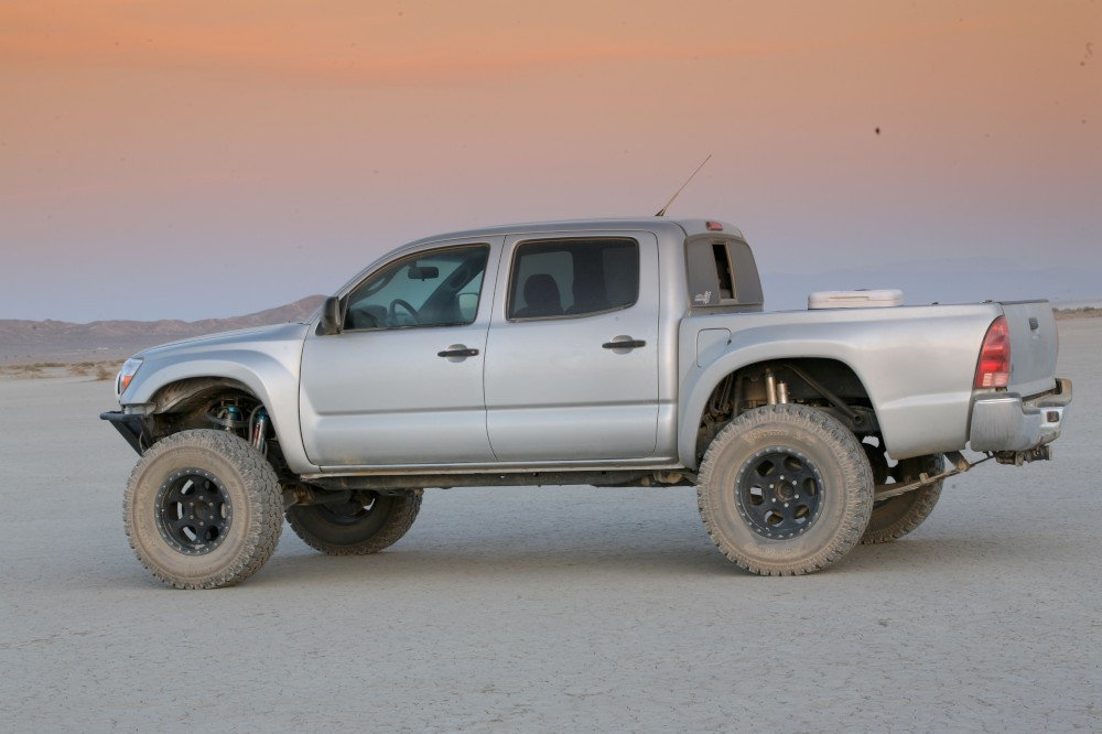

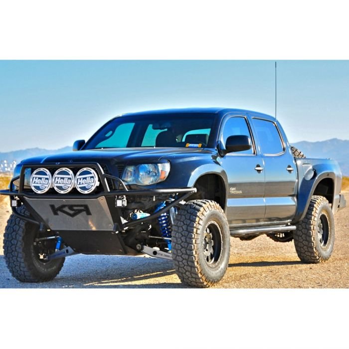

    tcs-35sltk-0515tac_parent_item-3.jpg because if your looking to do this, please do it looks amazing.

    I was looking to do something like this, IvanhoeTaco that looks amazing

    The fenders themselves arent that expensive compared to the 10k+ long travel suspension that the trucks that run these fenders have.
    I'm not saying you have to be a desert prerunner truck to have long travel fenders but you at least need to have a nice size tire in them. Like 35s. Of course what makes these trucks look so good with these fenders is the fact that the suspension has been pushed out 3 inches because of that expensive suspension.
    I 100% support building your truck regardless of function or form if it's your toy, but making your truck look like those in the pictures even without the suspension aspect is going to going to cost alot and really hurt day to day drivability of a truck like ours.

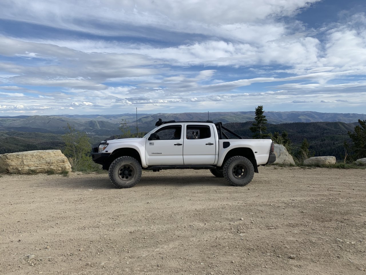

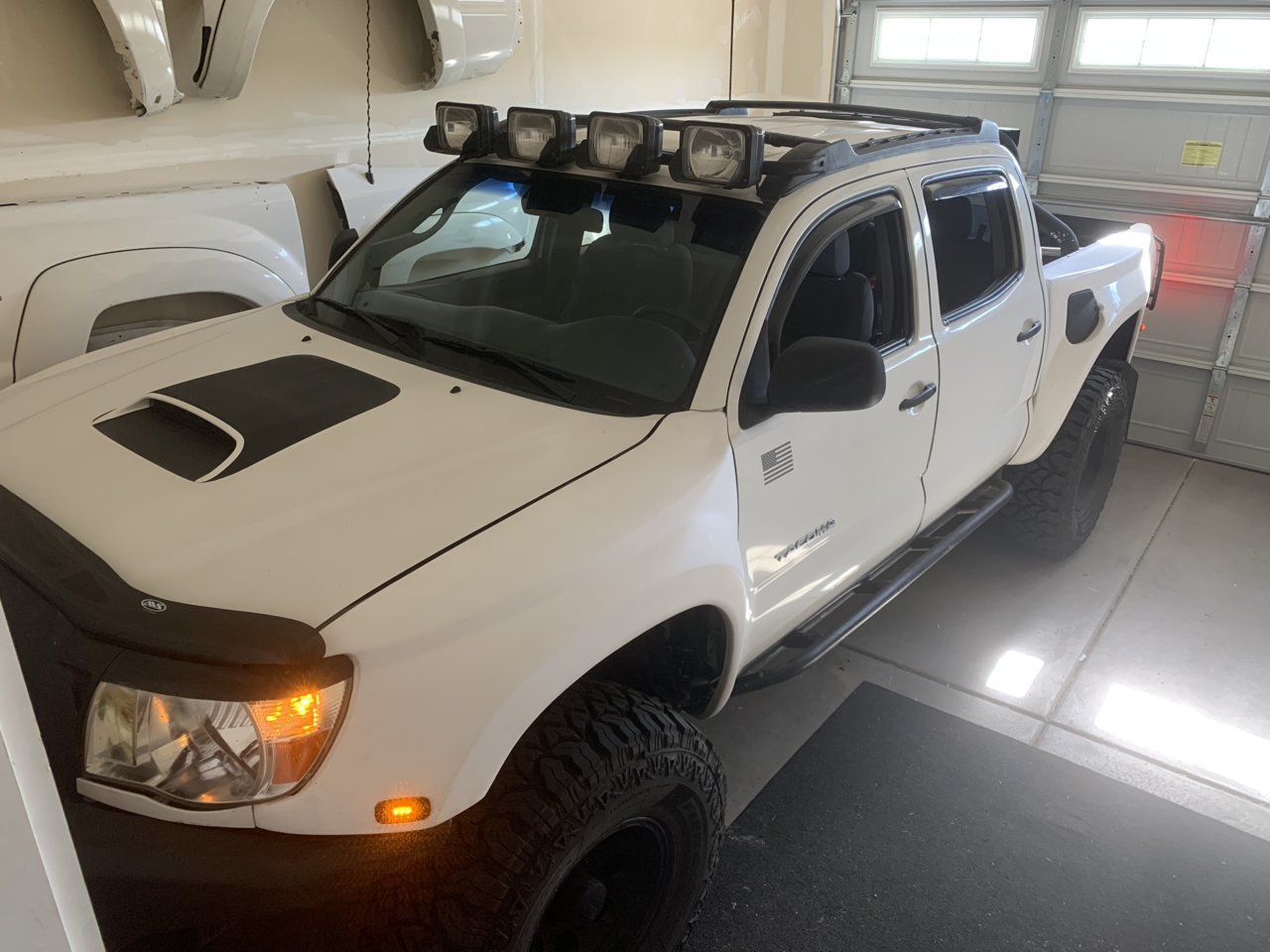

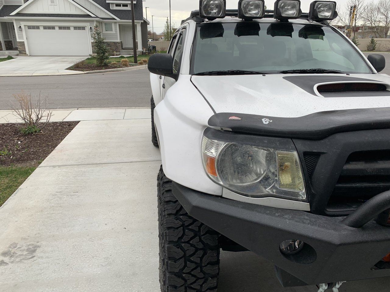

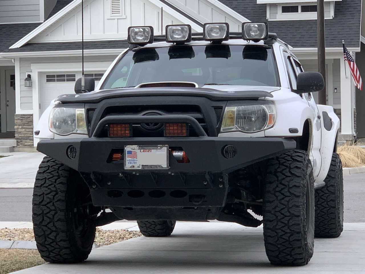

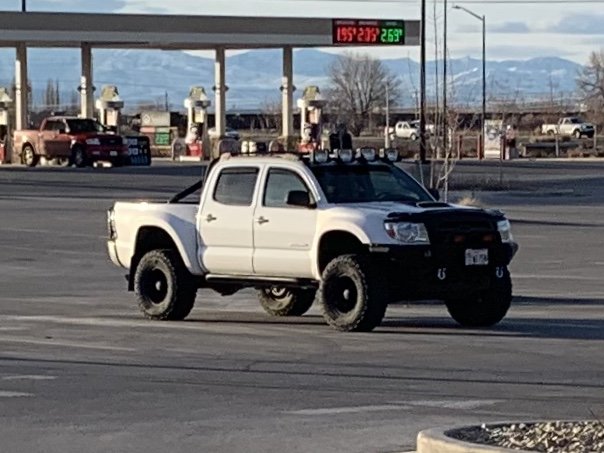

    I have the fenders in that image.
    Without long travel you will need extreme offset wheels and/or spacers. My current setup is 16x8 -11mm with 1.25” spacers and my 315/75r16 tires line up with the edge of the fiberglass fenders.
    A8ADC366-77EC-4423-B11D-C3BD2BE051FF.jpg BB02D729-7266-4E4C-9F55-6B589776D8FB.jpg D82CFB64-C7BD-42CE-9DD9-A21B117A1694.jpg
    +1!
    Definitely need 35’s!
    305/70r16 or roughly wide 33’s for reference:

    What brand are your flares. Lines look good.
  16. Dec 2, 2020 at 2:26 AM
    #16
    ImMrCrash
    ImMrCrash Intermittent Error
    Jan 5, 2018
    #240334
    333
    Utah
    07 DCSB ᴛʀᴅ ᴏʀ 4x4
    Bilstein 5100’s Dakar CS047R Supreme Suspension U-Bolt flip kit Sumo Springs Blue ADV Fiberglass Fenders 1st Gen Snorkel DV8 Apex Plate Bumper X-Bull 13k Winch KC HiLiTES 6x9 Trail-Gear Sliders 4x Innovations LCA Skids Spidertrax 1.25” Eagle Alloy 16x8 4” BS Fierce Attitude M/T 315/75R16 Bearcat 980SSB CB
    Advanced Fiberglass Concepts.
    Just don’t look too closely! Overall I’m fairly happy with them except for around both headlights and taillights. There are some gaps with not enough material so sanding to fit wasn’t an option.
