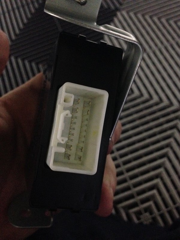

    I didn't see the flasher relay on the back of the fuse block under my dash. Is there anywhere else it could be or is that the only spot and I was just in too much of a hurry?

    Yep, on mine it isn't on the back of the fuse box, and there is no electronic flasher available for the 18 pin model. :(

    My 2005 Tacoma doesn’t have a relay, Just a wire plug in... i unplugged it to put the relay in and now front signals don’t work. What do I do? There isn’t a relay
  10. Dec 13, 2018 at 8:56 AM
    Muddinfun
    Muddinfun Well-Known Member
    Apr 17, 2017
    #216500
    7,495
    Your truck has DRL. To remove the DRL and install your LED flasher, you need the grey plastic jumper block part# 82671-30360. It's available from the dealer for about $8. Your truck has a 3 way harness that goes to 2 spots on the fusebox and to the flasher on the right side of the fusebox. Remove all that and install the LED flasher and the grey plastic jumper block. This will eliminate your DRL.
