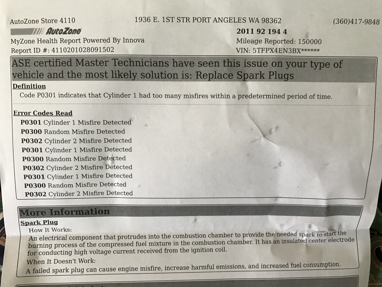

    My 2011 just started doing the same but the check engine and tac off just stay on don’t flash. I heard it could be a few things something as simple as a gas cap even. I will take mine to a autozone store and have them hook up and get the error code and go from there. You can also disconnect the battery for a few minutes and see if it resets I hear.

  18. Oct 28, 2020 at 10:50 AM
    #18
    Terry2014TRD
    Terry2014TRD Active Member
    Jan 18, 2018
    #241680
    33
    terry
    2014 double cab 6 speed manual TRD Off Road
    3" lift 18" rims and Toyo tires
    Just had mine checked at autozone and looks like I need new plugs. 20855B0F-1C80-435F-B36D-0E6DCF4A54EE.jpg
  19. Oct 28, 2020 at 10:55 AM
    #19
    3JOH22A
    3JOH22A トヨタ純正男娼
    Mar 27, 2019
    #288172
    12,470
    District 6ix
    3G Tacoma on 35"s, 5G 4Runner
    This is why the Autozone printouts are dangerous. All the ECM can sense is the engine slowing down (using the cam and crank position sensors, all happening at the millisecond timescale) during the specific cylinder's power stroke. If it happens often enough, it trips the misfire code for that cylinder. Misfire can be caused by a lack of fuel, spark, or compression.
  20. Oct 28, 2020 at 11:18 AM
    #20
    Terry2014TRD
    Jan 18, 2018
    #241680
    33
    terry
    This truck has 150k miles on a 2.7 liter motor. It is a quiet motor no rattles or noisy lifters etc. so I wouldn’t think compression would be an issue. I will replace the plugs and maybe clean the Mass Air Flow sensor then a new gas cap if it still shows a problem. Go from there
