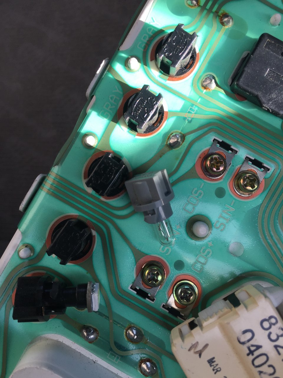

    Jon call it !!! It as led ligths wtf C4CB77D5-821C-4E7A-8CAE-48001AB52573.jpg2E357FFF-4288-4205-A100-DBB90E3AE132.jpg
    All but two bulbs ( grey ones toshiba ) are led cuz this be was cussing to flash ?? Or just replace them all ?
    Thanks @mechanicjon

    Bad led's.

    LED flicker of death.
