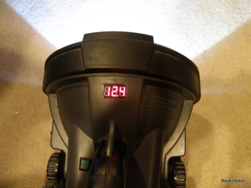

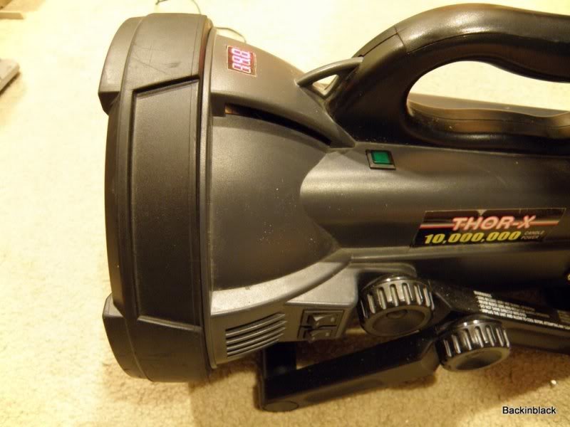

    Home made HID beam thrower. Started with a Cyclops (THOR-X) 55w Halogen. Converted to 35w HID. Increased the run time to almost 3 hours before the ballast gives up at around 8.5vdc left in the SLA battery. I needed to install a miniature LED volt meter to keep an eye on charging and discharging voltages. The telescopic H4 lamp allows me to switch between spot and flood mode. The output is ridiculous...

    That's awesome! And last almost 3 hours?! Impressive! I would like to see more night shots, if you got em.

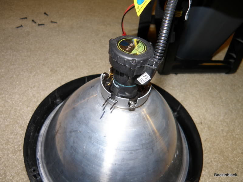

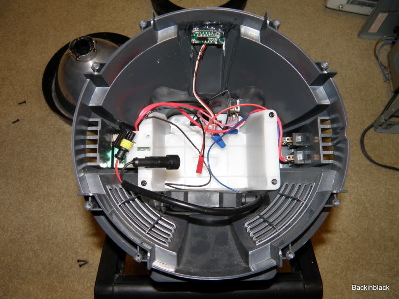

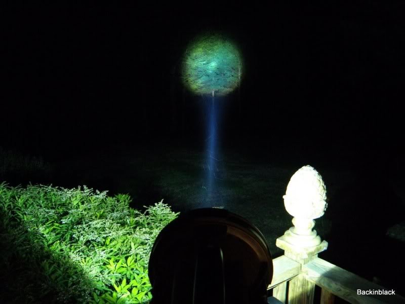

    Not much of a writeup. Once I discovered that it uses an H4 bulb, the rest was easy. I had a leftover slim 35w ballast that fit nicely in the housing in front of the SLA battery. Picked up a 35w H4 telescopic HID burner with the correct adapting flange and it dropped right into the back of the reflector. I re-wired the switches so that the first powered up the ballast and gave power to the second switch that controls the flood/spot mode of the lamp. The LED volt meter is toggled by a switch and wired straight to the battery. I recharge when it's below 10vdc and stop charging at 14.7vdc. Also, it runs for 2 hours, not 3 as mentioned before. My bad.

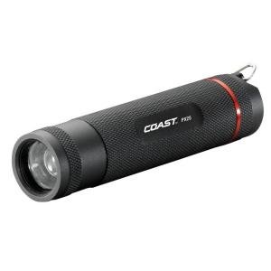

    I have one of these and love it.
    Coast PX25 LED Flashlight 208 lumens
