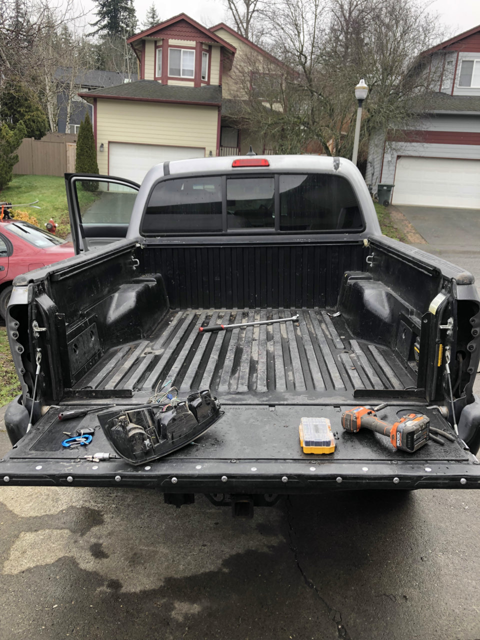

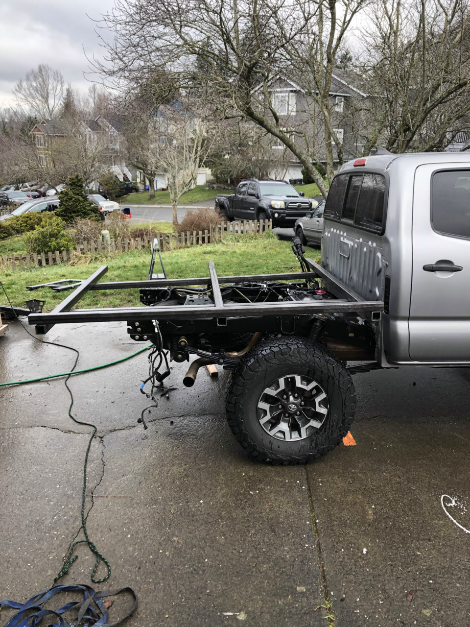

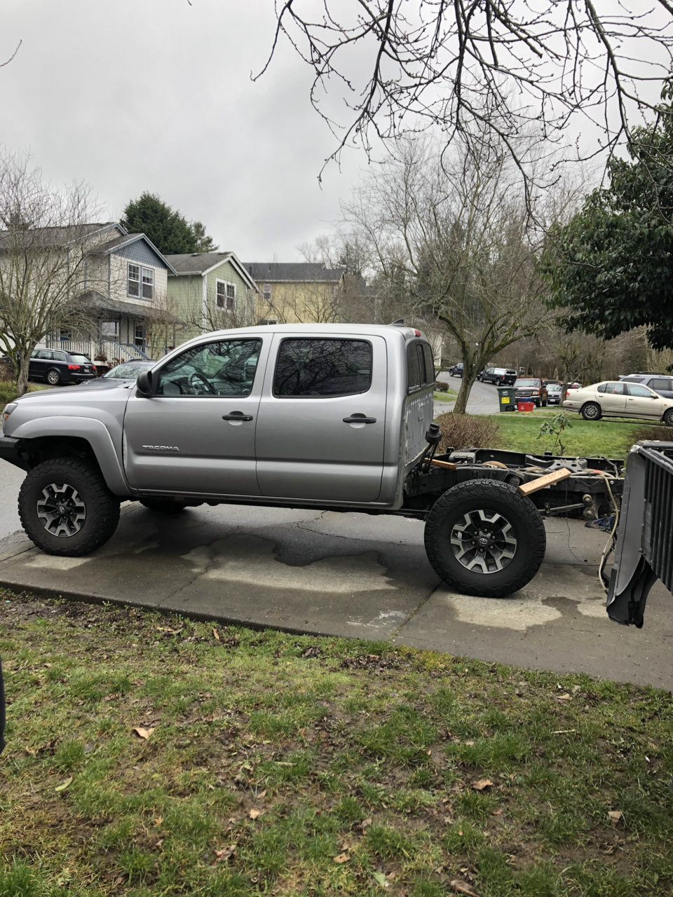

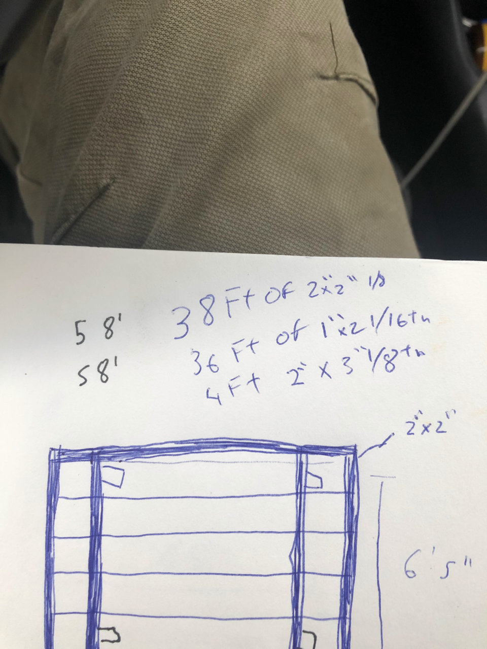

    Last year I bought a 2014 DCSB TRD off road 4x4 and thought it was my dream truck. I thought that the short would be adequate but am blown away with how small/unusable it is. So after a little thought and a lot of instagram day dreaming I decided I was going to copy the Overland under budget guy. The goal is to first make a functioning flatbed that is 76"X 76" and then this summer to make camper portion that can easily be removed. So far I sold my camper shell, removed the bed and bought the material along with some tools follow along and share your thoughts/ concerns this will be my first major welding project so any input is welcome!IMG_7583.HEIC.jpgIMG_7581.HEIC.jpgIMG_7583.HEIC.jpgIMG_7584.HEIC.jpgIMG_7586.HEIC.jpg

    I would box in the stock frame, especially with the leverage of that overhang.

    Thanks that was something I noticed when removing the bed it was only about 200 lbs I will weigh it when its all done see what the difference is!

    Yeah a 6' first gen bed is almost exactly 200. i'd suspect a shorter composite one to be even less.

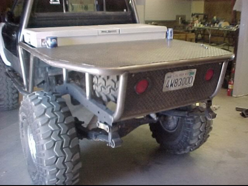

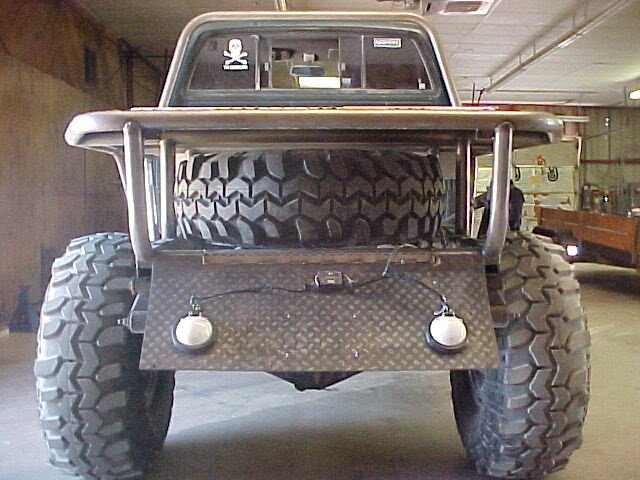

    I always liked this spare tire ‘cabinet’ idea. This wheel is ridiculously huge, but having a ‘drawer’ makes sense, and. Why not make the tool box top flush with the deck.
