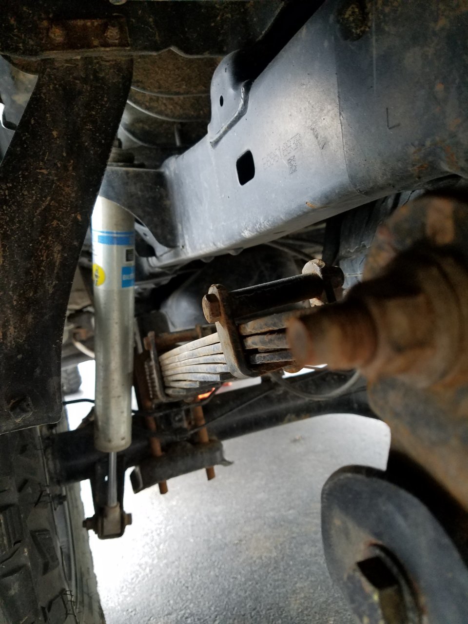

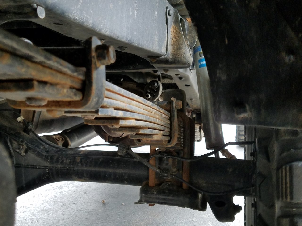

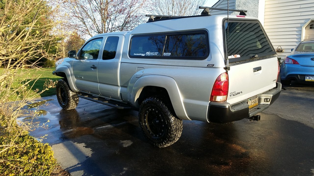

    Hello tw, i purchased a set of 3" all pro leaf packs about 6 months ago. recently iv noticed that they sit very flat. The truck rides fine but is this normal and a safe thing? Heres just a few pics20180409_170554.jpg 20180409_170721.jpg and heres how the truck sits. Currently Snapchat-870947172.jpgjust worried because i plan on going on a cross country trip this summer.

    That does not look normal...

    Yea, almost looks as if they want to bend the opposite way.....

    Don't know about the allpro's but that's normal for the factory springs. I think toyota just designed them that way, even brand new tacomas have flat leaves.

    Allpro leafs seem to not last long. I have expo leafs and I think the only reason they haven't gone negative arch is the sumo springs I have on them. Their quality control is questionable. I would call them and make a stink. They shouldn't be negative arch.

    Stock leaves look the same, my 2016 +3 leaf AAL had a good arch to it at first, but now it's looking much more like the photos you posted. I think the main problem is that they're a large number of thin leaves and they tend to individually fatigue over time.
    If you look at smaller (2500, 3500) HD trucks, their leaf packs are typically 2-3 THICK leaves. The only time they use a ton of leaves is when you get something configured as a chassis cab with a 2-3 ton payload rating.

    Seems the standard is to measure the distance from the center of the hub to the fender. With that measurement you can compare it to others who have posted the same measurement.

    OP, there is a reason why AllPro is not a vendor here on TW any more..... their QA and quality on their springs is sub par and many people have had the same issue as you. All pro standards shouldnt look like that with all of 200lbs of a cap or so in the rear of a truck.
    From the look of it, any "lift" you are getting over a stock pack is not from added arch of the all pro spring, its simply the extra thickness of the allpro spring acting like a block haha.

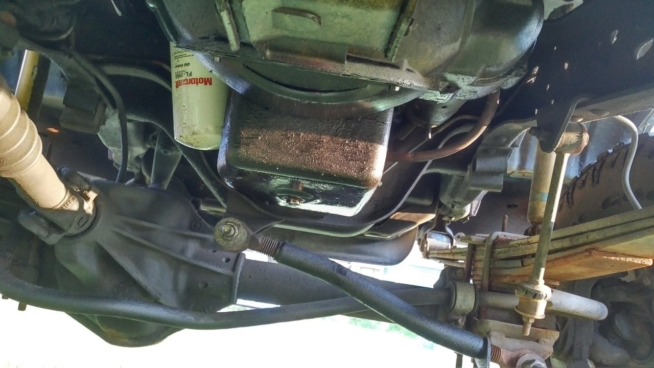

    This is my front of my F350, leafs are thicker and wider than a tacos

    I agree, any lift that the truck has in the rear is coming from the thickness of the leaf pack and not from the arch. Infact i think it has less lift then the pack thickness because the arch is negitive....:facepalm:

    Yea iv had a 96 f250 that had front leafs that were very simular. Its seems like they all are that way. However i think that most people on here with aftermarket leaf packs in the rear of there tacomas have arch or should have arch. :confused:

    I have measurements from when i first installed these leaf packs. Il compare them to what they sit at currently and what they sit at stock.

    depends on the spring design if flat or not
