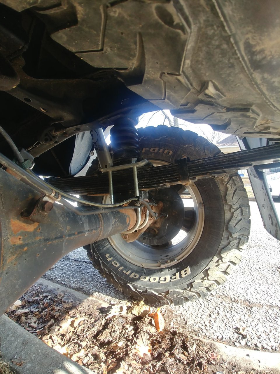

    I have both a shackle flip and a ubolt flip kit. For the flip kit someone makes an adaptor plate to work with sumo springs. I drilled out the flip kit plate and mounted the sumo springs to it.
    I'll take some pics when I get back to the truck.

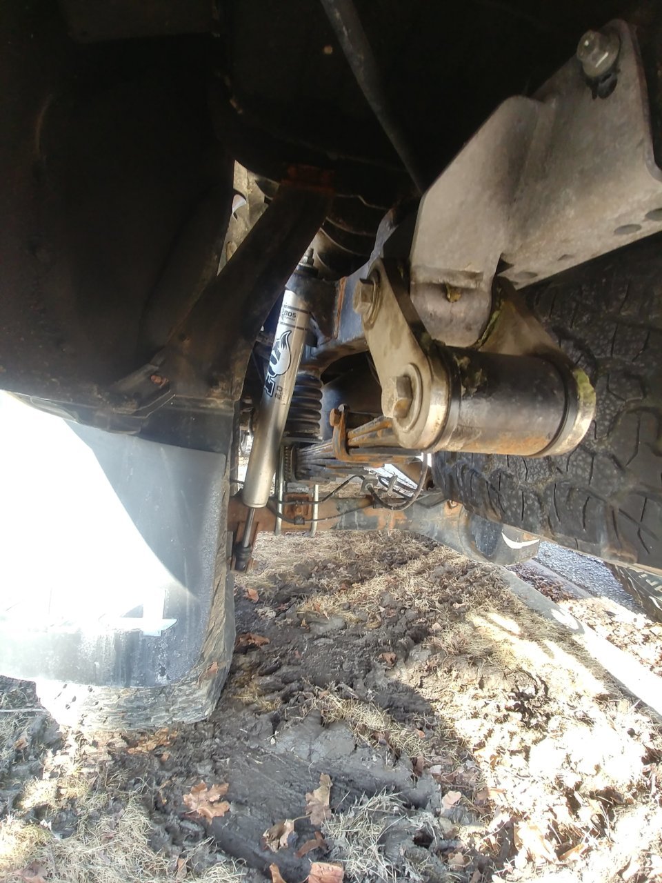

    In that pic I have like 400-500lbs including cap (in of itself 175-200). I simply don't trust allpro. The first set of leafs I got from them, the main leaf snapped. Thats the first pic I posted here. Your correct on the bolts. I have just enough thread to catch 7/8th's of the bolt. I used thread locker to make sure nothing moves. They're 1/2" bolts and I'd like to go up the 5/8" and longer to catch the full thread.
