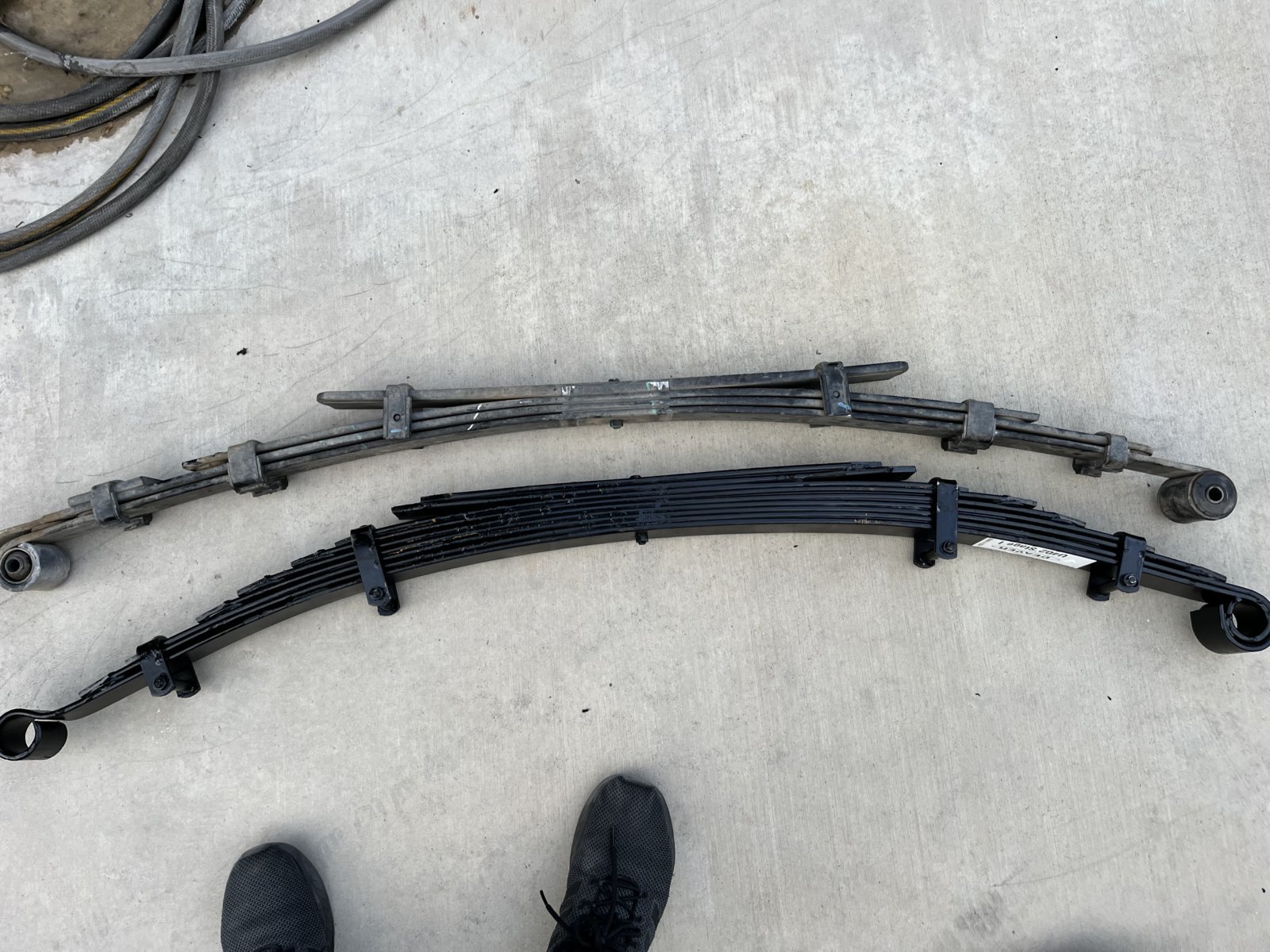

    mine seem to be pointed downward a bit. this isn't supposed to happen right?

    depends which part is pointed downward, adding pics is the way to get help in this case. If adding a permanent weight to the bed, or even significant temporary weight- a new properly sized leaf pack is the right way to go with these trucks. They were designed for comfort, not hauling.

    [​IMG][​IMG][​IMG][​IMG][​IMG]

    Is that unloaded? Time for new leafs

    it has an A.R.E MX Series topper on it.

    I'd get a new pack

    I thought it look bad and other people said it was fine but what do they know xD
    Any recommendations on a new pack?

    I've installed tons of different packs and add a leafs but the only leafs I have personal experience with on my own truck is o.m.e. dakars and chevy 63's. While the dakars were great I just didn't have the weight in the bed to get them to flex out like I wanted. I've heard great things about Alcan and Deaver. Could probably give them a call and they can set you up

    do you think I can get away with using these old ones for another year? I don't have the money rn for new leaf packs but will be keeping my eye out now that I know.

    You should be good. You could browse Facebook market place / Craigslist and find some cheap takeoffs for a temporary relacement too in the meantime. Lots of people upgrade from factory packs and sell them for fairly cheap
