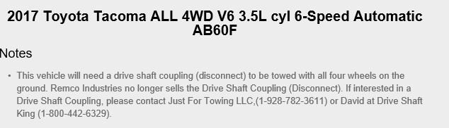

    I was setting my 05 DC/LB up to to behind my motor home I bought the driveshaft disconnect got it installed and had the baseplate ready to install. Then life changed, bought a house and sold the motor home. Try going to REMCO and they will tell you what you need to do.

    The one thing every 4WD vehicle that can be flat towed have in common, is a transfer case that can be put in Neutral. Remco, the 4 down towing guru's, list a drive line disconnect for Tacoma's, for flat towing.

    Call Remco, they'll know.
