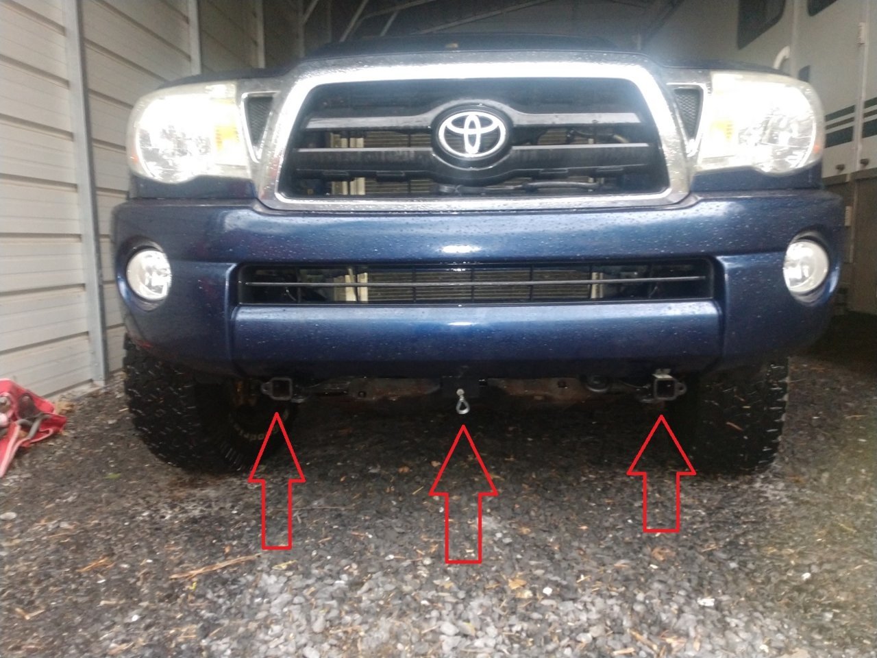

    All set up for flat towing. 2 receivers and 1 brake cable the pulls when the surge arm on the ready brute tow bar pulls it.
