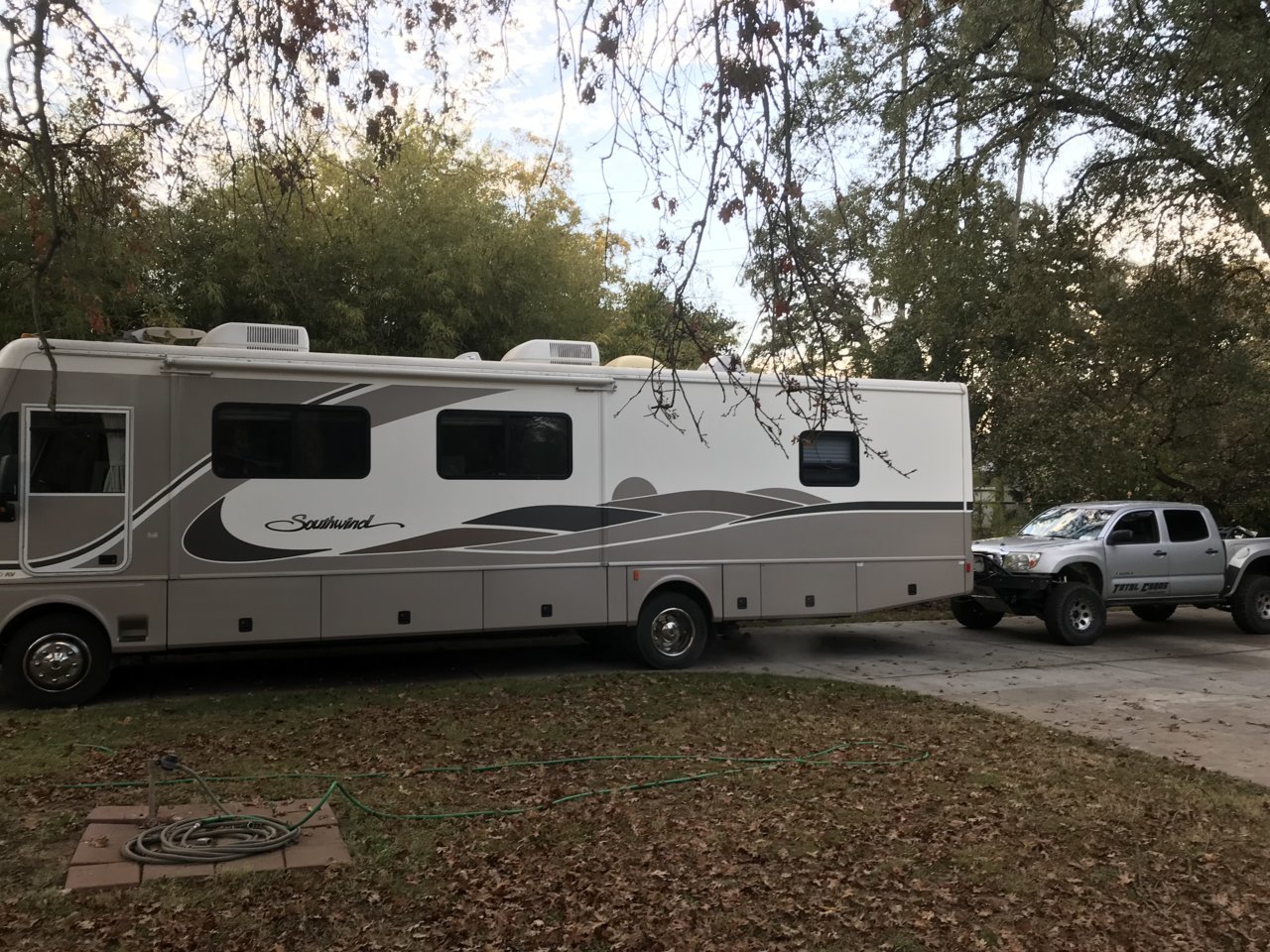

    If you see my Tacoma (or my 4runner) behind my motohome I have a manual transfer case in neutral. I did a prerunner to 4x4 conversion. The 4runner has a drive line disconnect.
