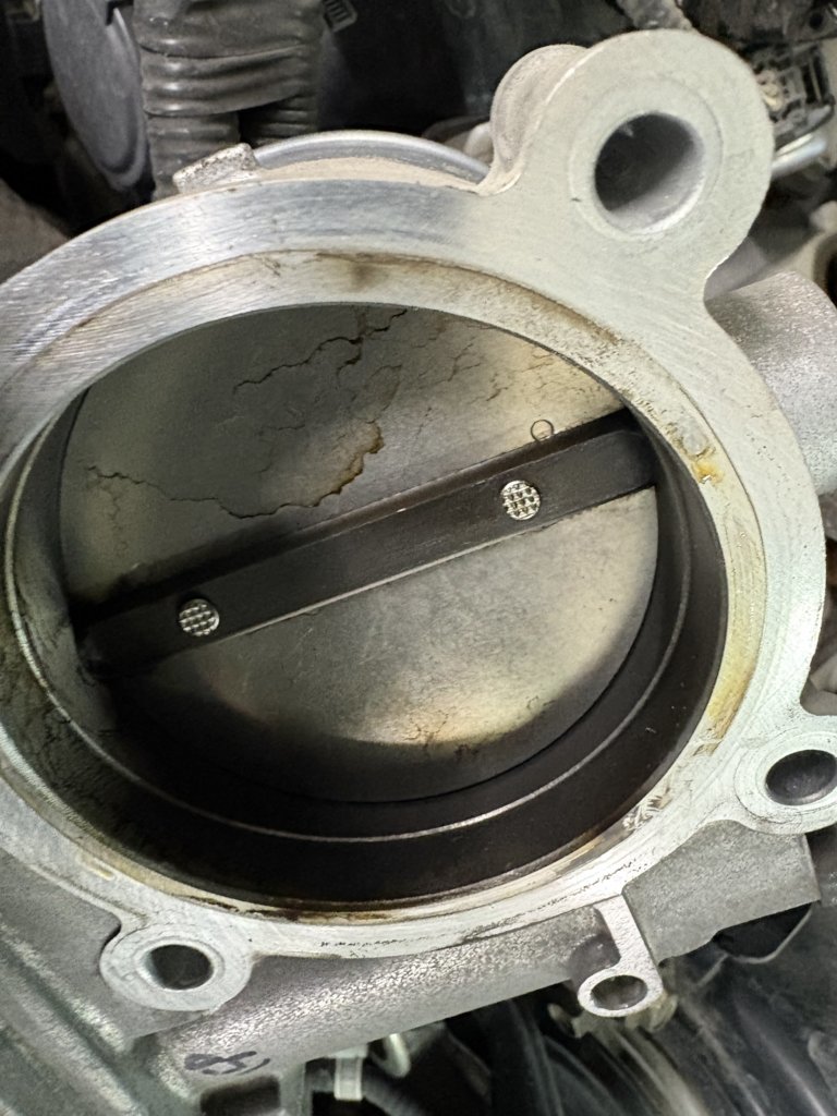

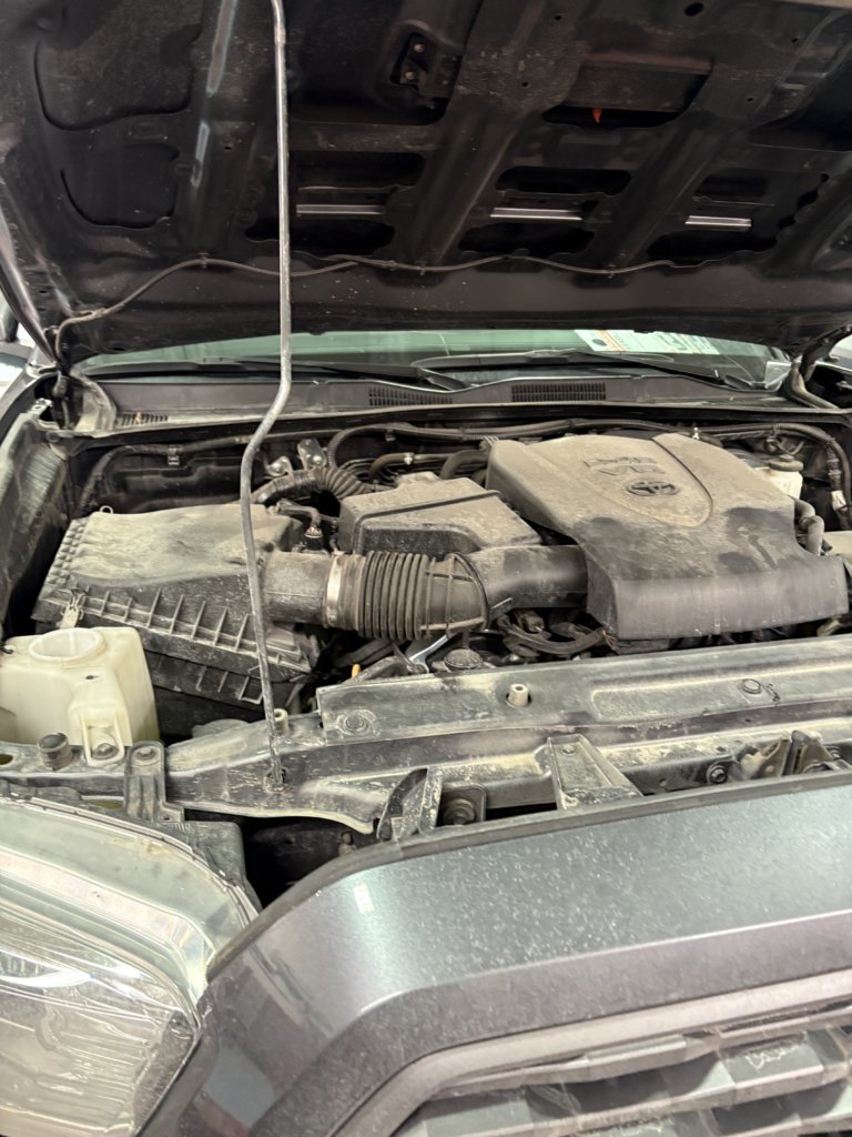

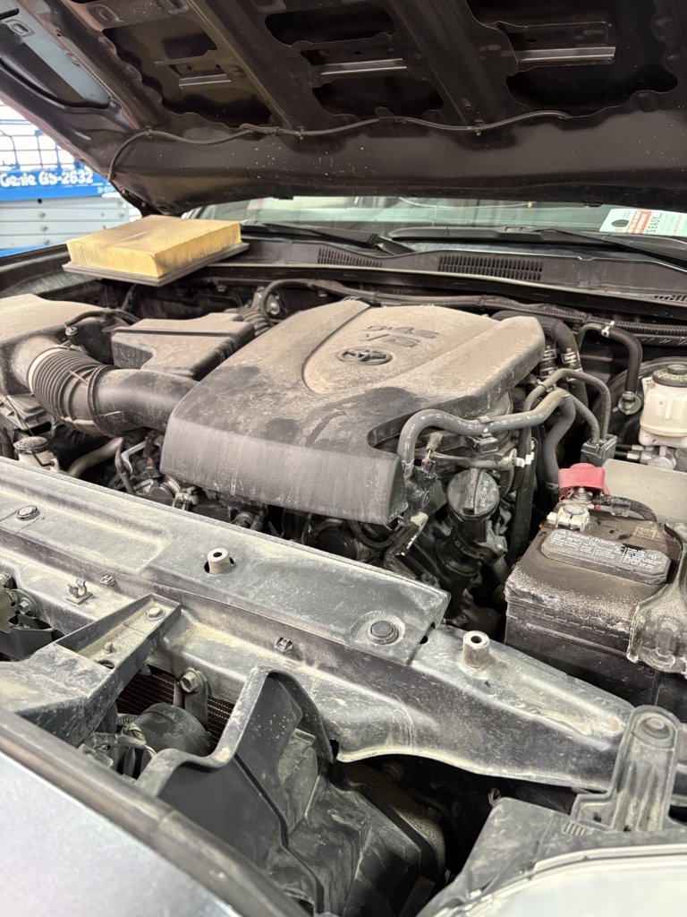

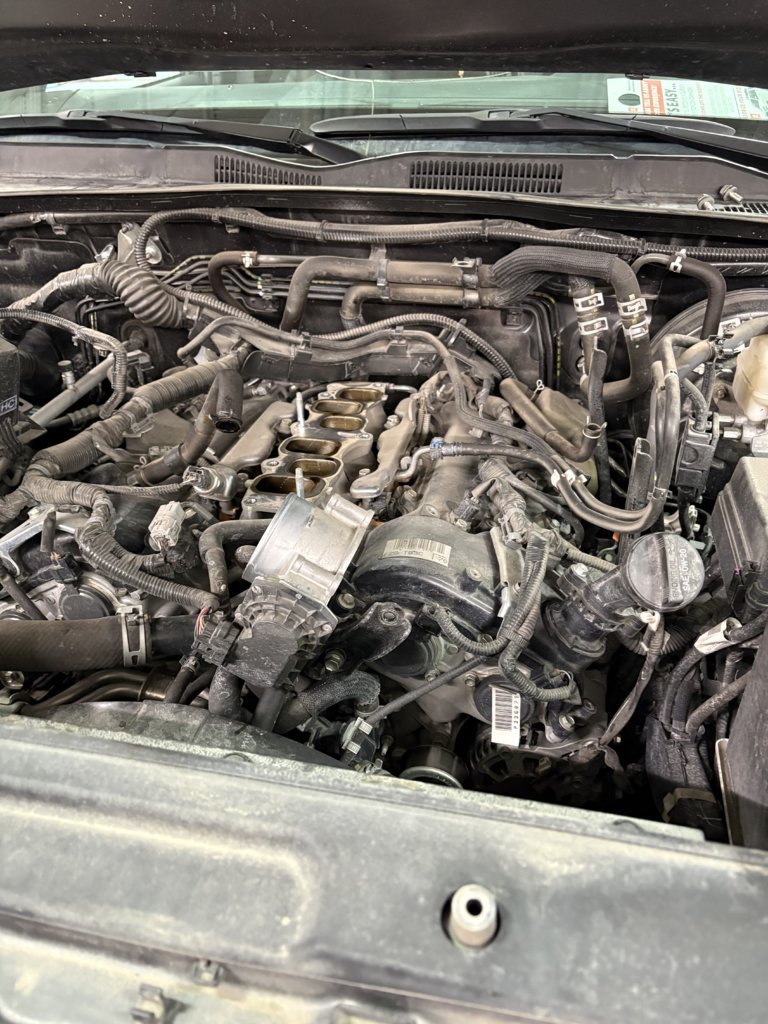

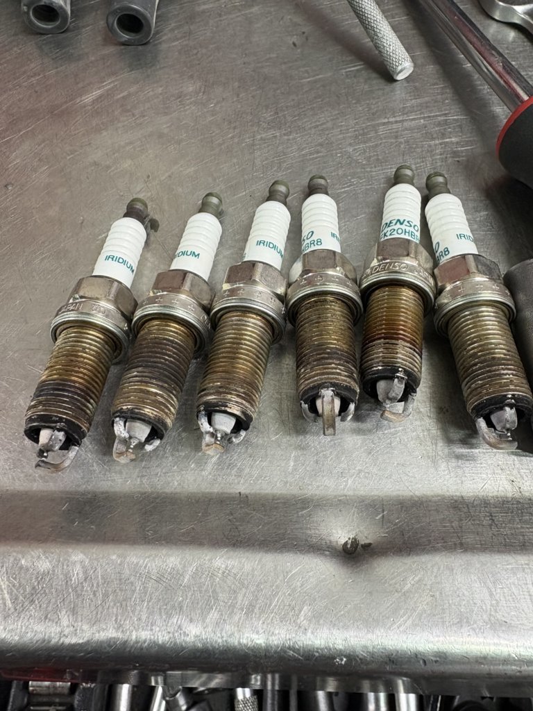

    So I always tell guys to take the plenum off I thought I’d see how long it takes me, no rushing no tool prep. Started 10:06
    haven’t done these plugs in over a year
    Finished 10:32 even dropped 2 bolts. Always clean the throttle.
    The big reason the long way is the short way is there’s risk of cross threading using the cheat method and it doesn’t save that much time.
    Even if this takes 3 hours for a diy it still makes more sense. Why save time when you’re chilling in your driveway?
    ps I washed the engine bay once I was done the service

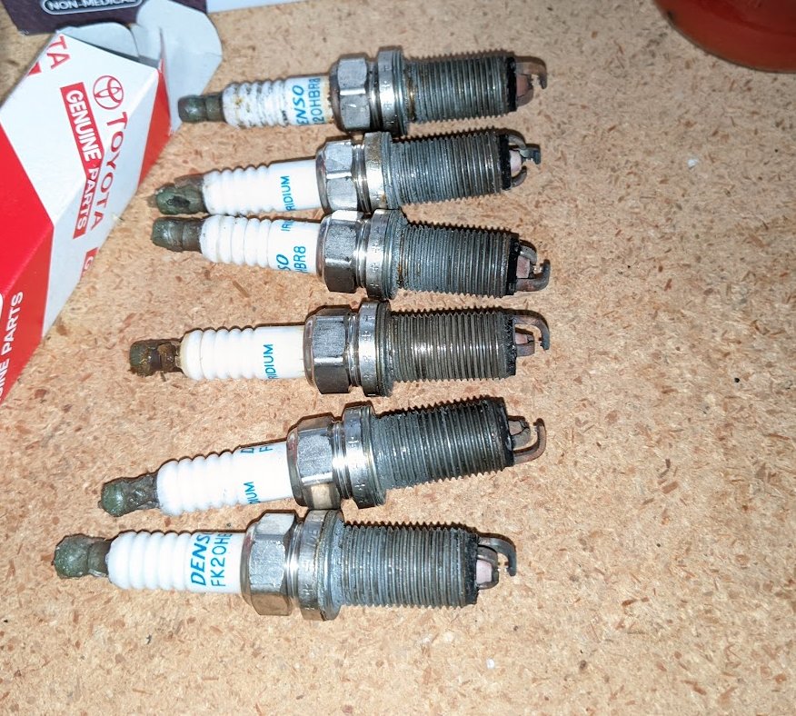

    That's an interesting plug design, are those the stock plugs for the 3.5?

    ya it’s over quoted on these trucks, it’s 2.5 most dealers agreed to 1.5 but it’s just how it is.
    I usually don’t call them until later, these were done at 60,000 but im a believer that it’s good until 100k
    they are odd ducks and have varying replacement miles. Maybe these are Canadian spec
    One did! The snap on flex magnet is a god send.

    Wow, it certainly was dirty. I see air filter was dirty. Did you remove the throttle body to clean? Did you use a hose to wash the engine bay?
    Nice job. I was wondering how long it would take…. Where did you purchase the plugs? Toyota or parts store?
  9. Mar 18, 2025 at 3:21 PM
    Bishop84
    Bishop84 [OP] Well-Known Member
    Dec 17, 2015
    #172494
    12,005
    You have to remove it to remove the intake, but I do remove them to clean if it’s really bad.

    Do you guys use new gaskets for the throttle body and manifold, or re-use?

    I re used them this time because they weren’t quoted. They were still soft, I spray synthetic spray on gaskets like these to keep them soft and they’ll be good till next time.
    when they are hard they need to be replaced

    I've done them twice. About an hour, because I don't remove the intake manifold. The driver side is the worst.
    That air filter looks awful btw.
