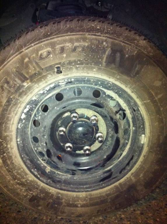

    2. I lowered my spare tire (damn that thing is ugly) to find that it is a 16" wheel with a 245 tire - kinda small for a truck that comes with 17" wheels. Is that little donut the right size spare?

    Well the SR5 models come with 245s so I'm guessing that's why it has a 245, and they dont bother to change it if you get a TRD package. Can you take a picture of the spare? I have never seen it, and I'm wondering if the wheel looks like the SR5 wheel

    Dirty ass spare, currently on truck.

    3 Words: Full Sized Spare

    I am not stoked to be rolling on a 245 Grandtrek.
    My TRD Sport should have come with a full size spare, yes?

    My 2007 TRD Sport Prerunner came with a steel 265/65/17 spare. Same tire as on my four aluminum rims.

    That's the original tire size on the sports. The wheel size makes no difference is tire size except the cool factor and rubber band look. It's full size for your truck but not your setup.
