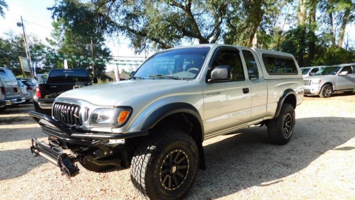

    I recently sold my 1st Gen TRD Off Road that I had setup with a Remco driveshaft disconnect and Roadmaster Stowmaster tow bar that stayed on the Taco. A setup I drove and towed behind various trucks all week long (I buy/sell trucks) and then behind our Motorhome on weekends. It was a setup that I had put over 30k trouble free miles along with an immeasurable amount of “towed” miles. The owners manual said it could not be flat towed, too.
