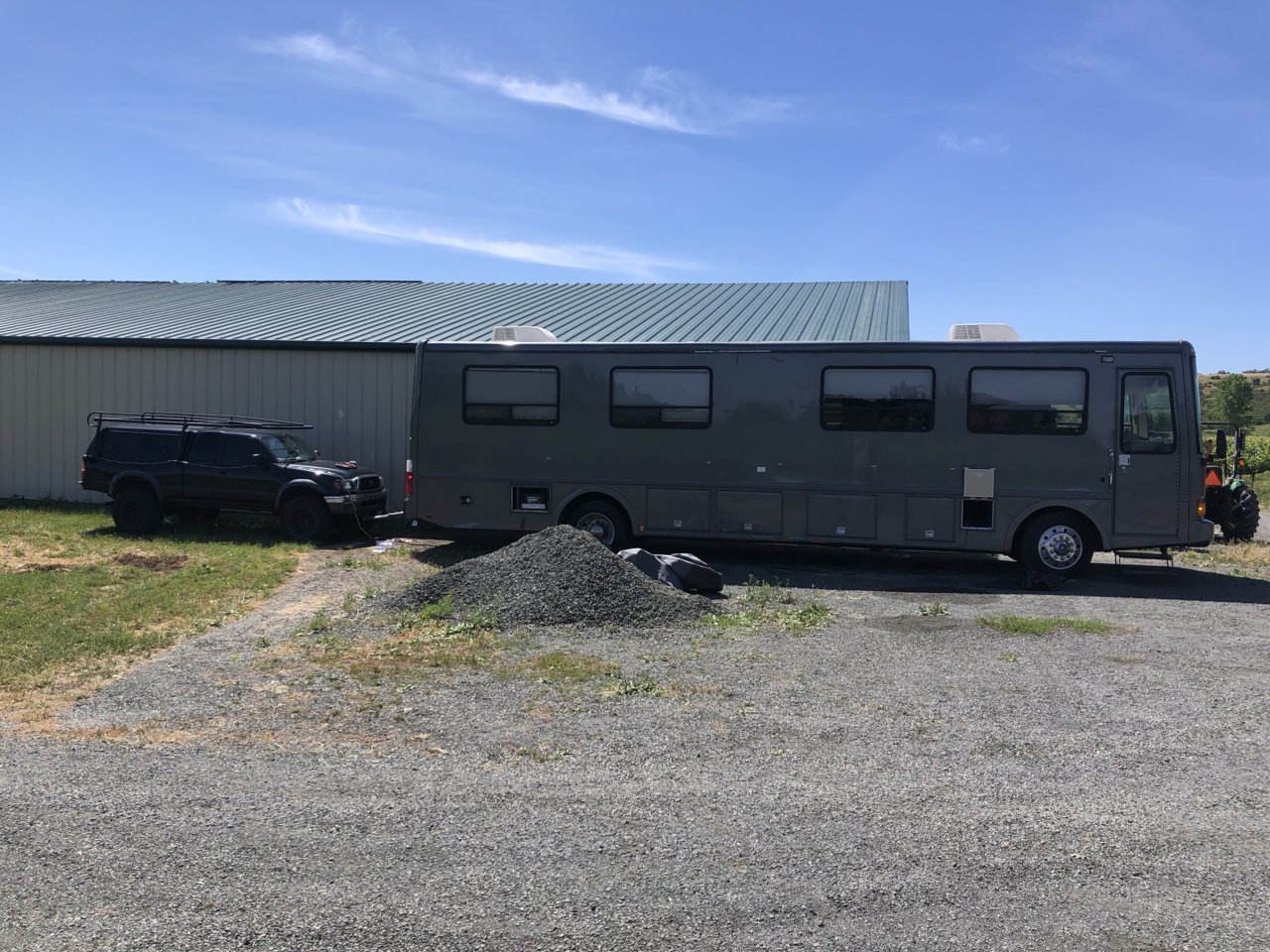

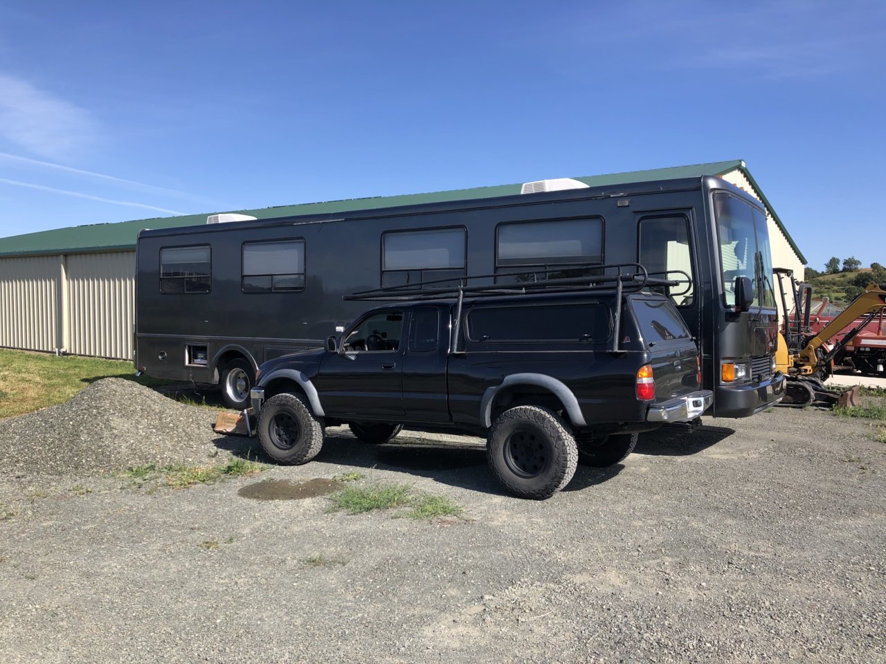

    Hey y’all! I got the RV! She’s a beast and has a Cummins L10 with Allison trans.
    I’ve been looking into the flat tow issue more and someone/mechanic told me I could leave my truck running to keep the pump going lubing everything till I can figure out a way to install a bypass switch that’ll keep just the pump running ( most likely power from the rv so not to run my truck battery out ) on longer trips.
    any thoughts on this?
