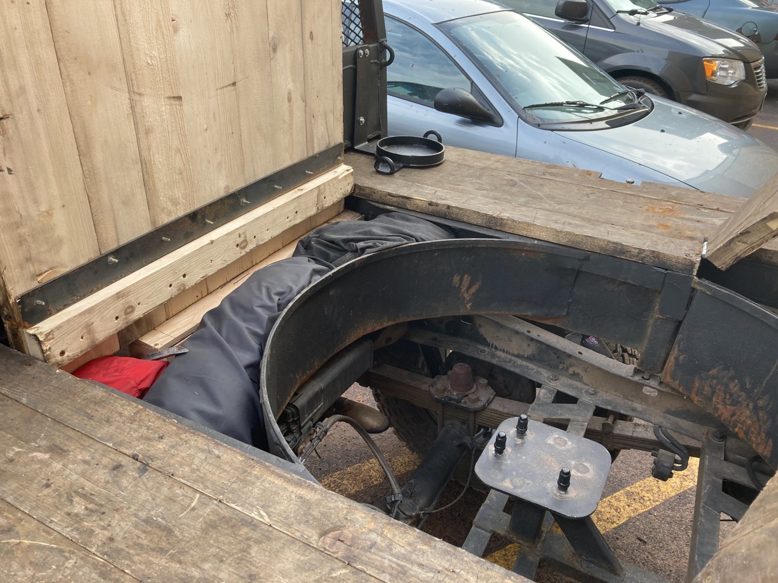

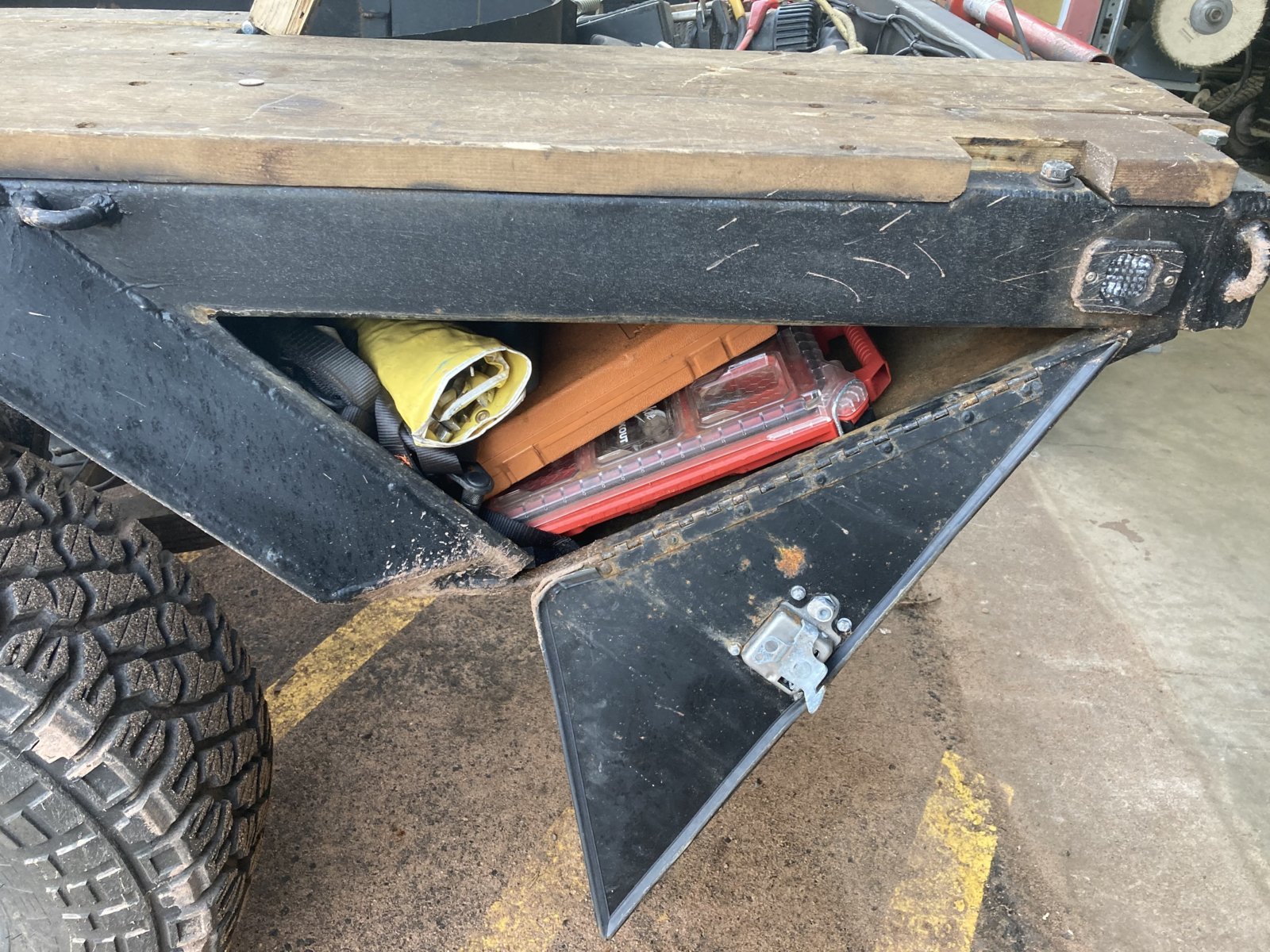

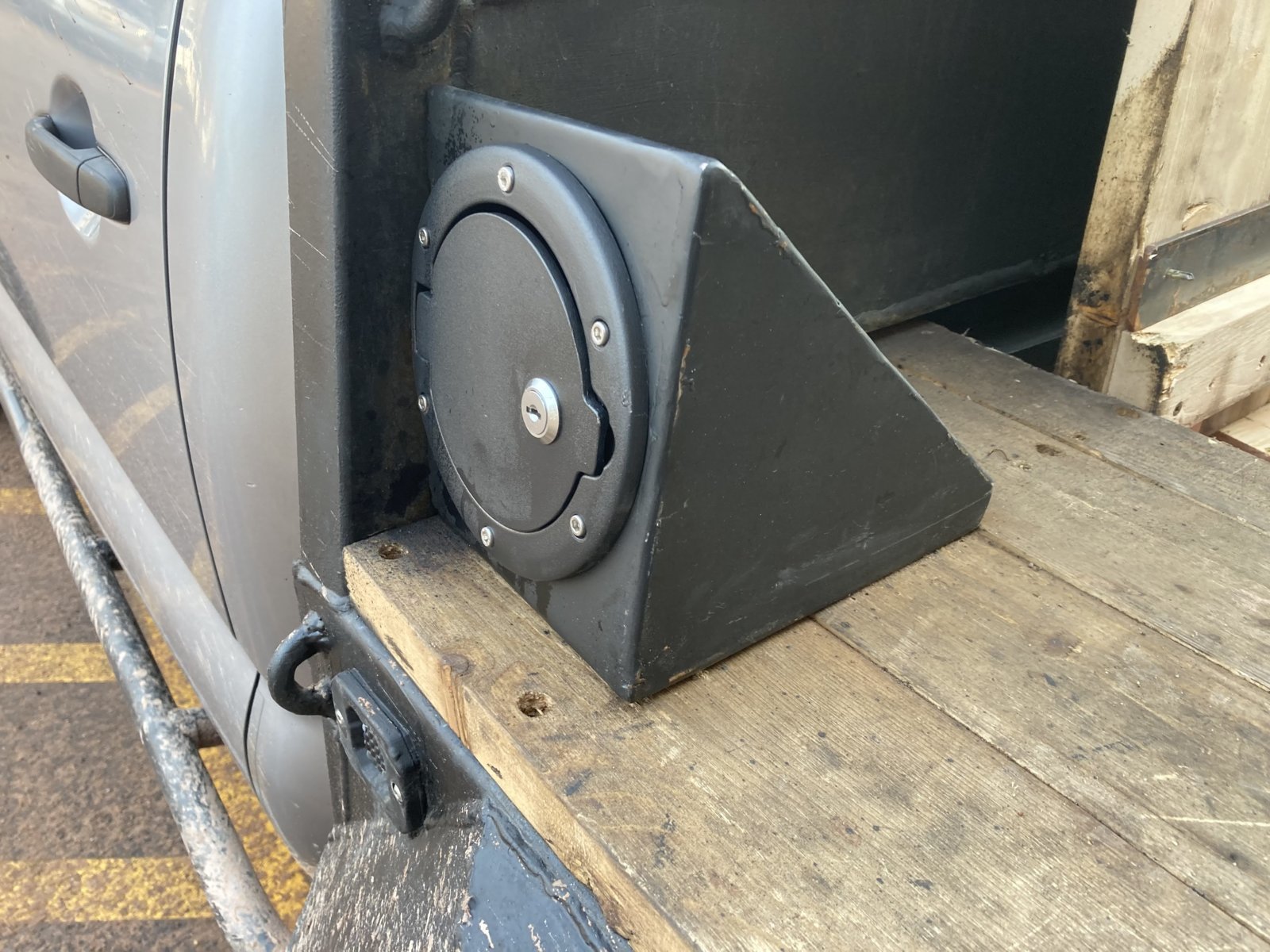

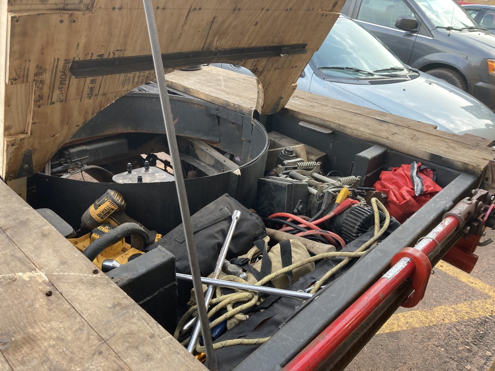

    One thing that gets wasted with a lot of flatbeds is the potential storage! Here are some images of the storage cubbies. Also, what to do with the gas filler. I made a sheet-metal cover and bought a locking Heep filler door. I have a heep part on my Taco... Oh the injustice!
    The furthest most back cubbie: Winch, tools etc. Then the forward cubbie: camping stuff and the spare axle shaft long poles and torque wrench. The spare is out and you can see some of the xmember modifications. Tied the frame together. Tied the trailer receiver to frame. Tied Hammer Hangers to receiver/frame. STOUT! The Haunch Pockets are HUGE. I have all of my recovery gear in the passenger side one and this side has extra tools and parts etc.

    Not sure. It was cheap and I had it on had it on hand. Like the look. Not very durable. Certainly would not spend real money for hard wood. Better for sleeping than metal, and I sleep up there... So, solid maybe.

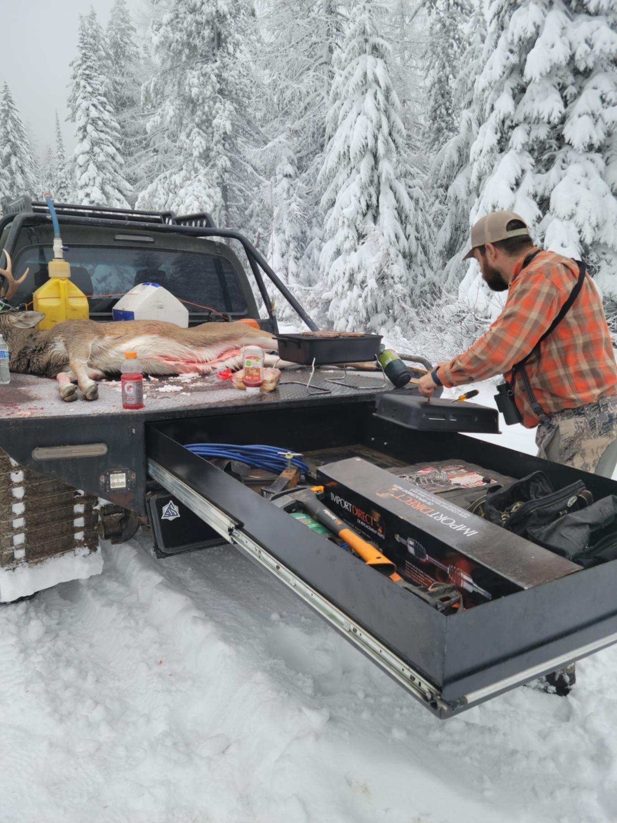

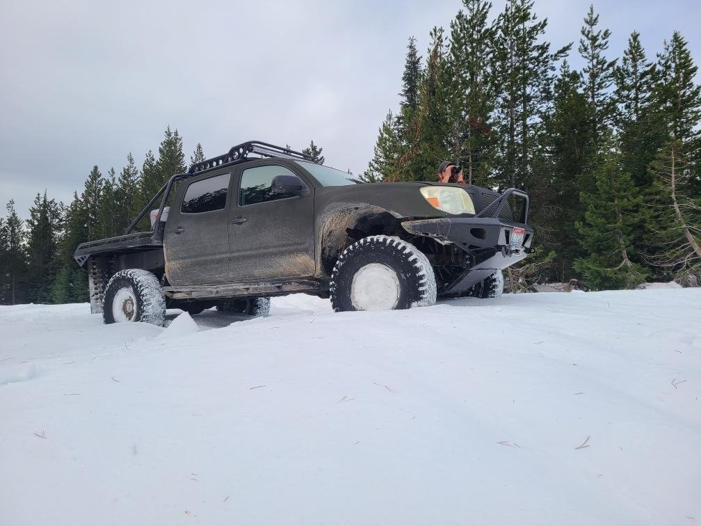

    35s, flatbed, rhino liner paint, SOS front bumper, JD Fab lca pivot, JD Fab inner fenders and some other stuff.
    Here's some pictures of my 07 that I built Resized_20221106_085304.jpg image000003.jpg 20200913_191246.jpg

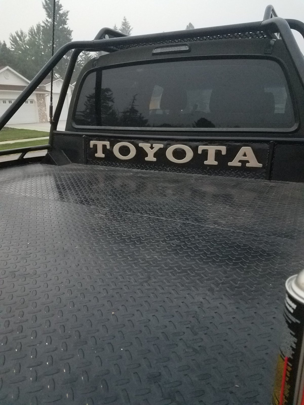

    Diamond plate

    I love the big storage draw under the tray. Looks like it would be well sealed too, with that big gasket?

    Nicely thought out! This is the best one I’ve seen yet, by far.
    Thanks, it's been working great, nice and dry, the slides I bought are rated for 550lbs so no worries about what you can put in it either.
    To be honest I couldn't tell you, a friend of mine had them left over from his Tacoma and I trade him for a couple of ribeyes.
