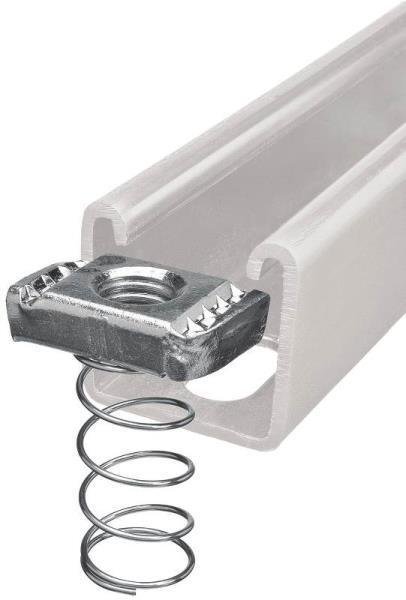

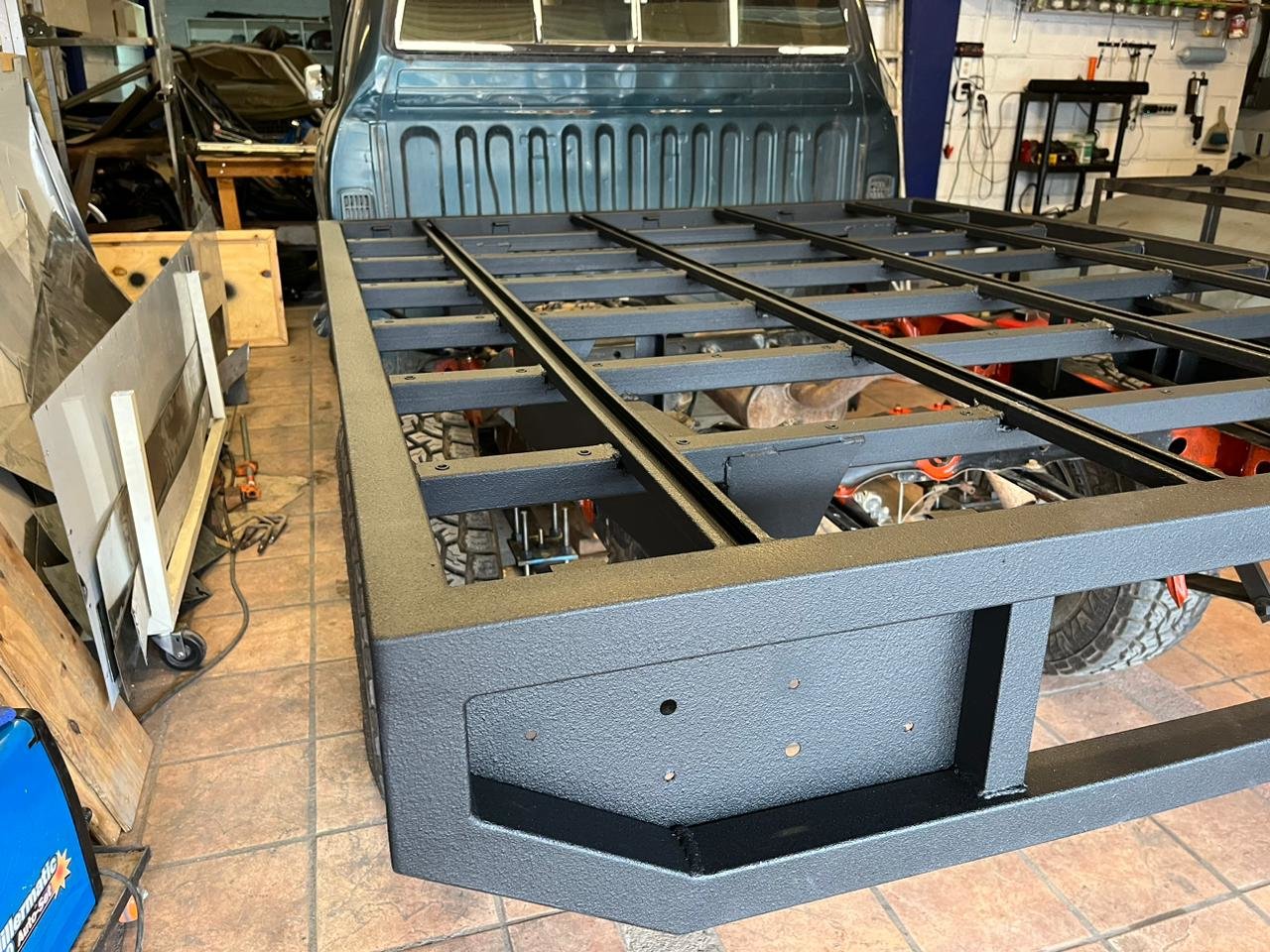

    I went for lengthwise unistruts, they double down as part of the flatbed structure and tie down points with unistrut nuts. Haven't used them yet, but seem to be exactly what I need.
    My idea is to build drawer boxes which I can then move around if needed. There's also threaded eye hooks for light duty tie down.

    I like that quite a lot, unistrut is good stuff. Looking forward to seeing how it works out. What are the tie down points rated for?
