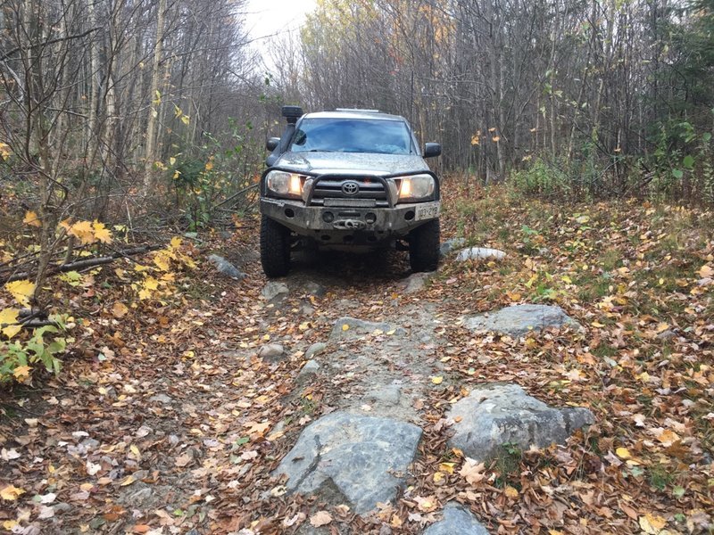

    Also went for a run on the voyager multi use trail system in north bay (vmuts)
    Pics of the run

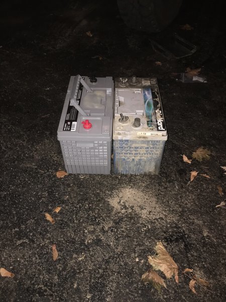

    diehard battery took a shit. Got another 31, not marine though but it has the exact specs of the marine diehard. Had some issues going from 4 posts to 2 posts but made it work

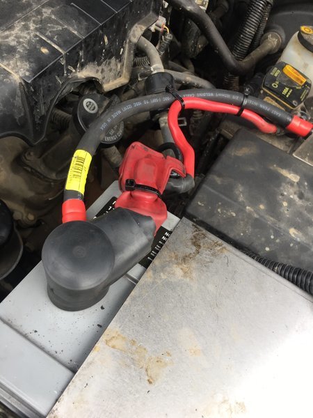

    And the new set up
    The stock wiring would not reach so I made a 2-3inch extension of 1/0 gauge and bolted using terminal ends. wrapped the rubber protectant to prevent shorts and good to go.
