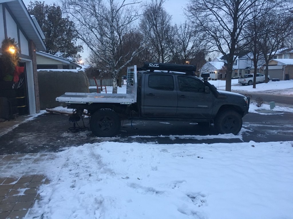

    This is without the flares. You can see the holes on the front.
    With the bed and no flares

    What happened to your bed makes me worried! I don't want that to happen to me!
  3. Feb 18, 2018 at 5:38 PM
    #383
    tacoma16
    tacoma16 [OP] Well-Known Member
    Mar 15, 2011
    #53109
    11,205
    Peter
    Ontario
    Double cab SR5 4x4
    Honestly I don’t know what I did considering how many people run the same setup...I guess it was the weight or something. Still though it isn’t ideal. The flatbed and the cap have been pricey but still cheaper that another bed, lighter cap and a drawer system which could break again...

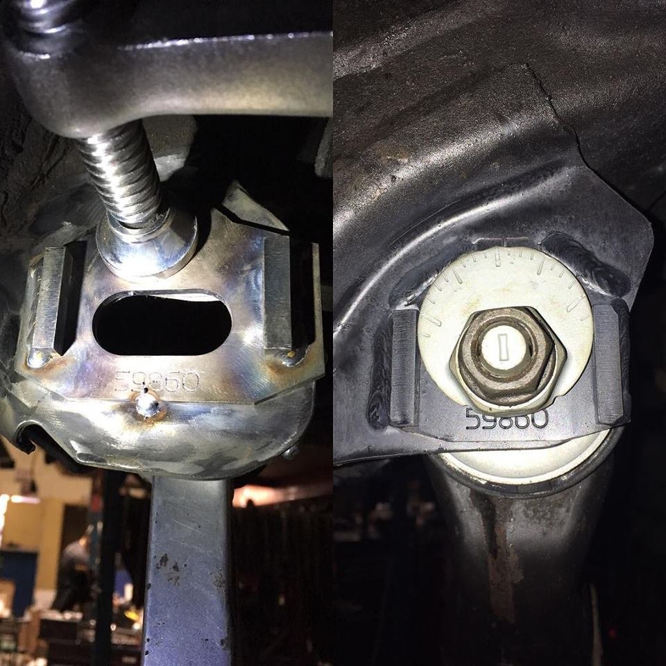

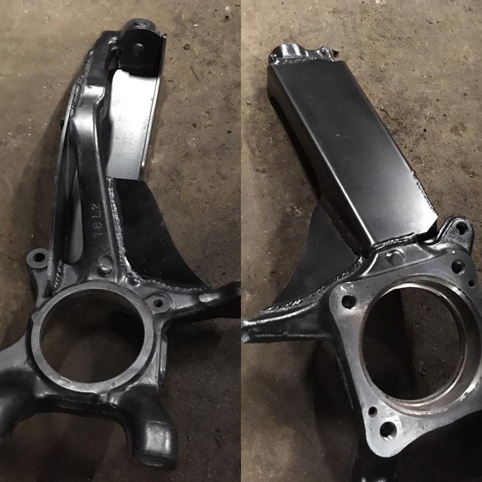

    Well the truck is back from the shop....need an alignment and to go through the break in procedure.
    So the truck just got:
    -upper and lower ball joints (greaseable)
    -LCA bushings, cams, sleeves etc
    -spindle gussets
    -Cam gussets
    -4.88s
    -arb lockers front and rear
    -new wheel bearings
    Pictures are courtesy of CT motorsports. Check them out if you need work done on your vehicle.

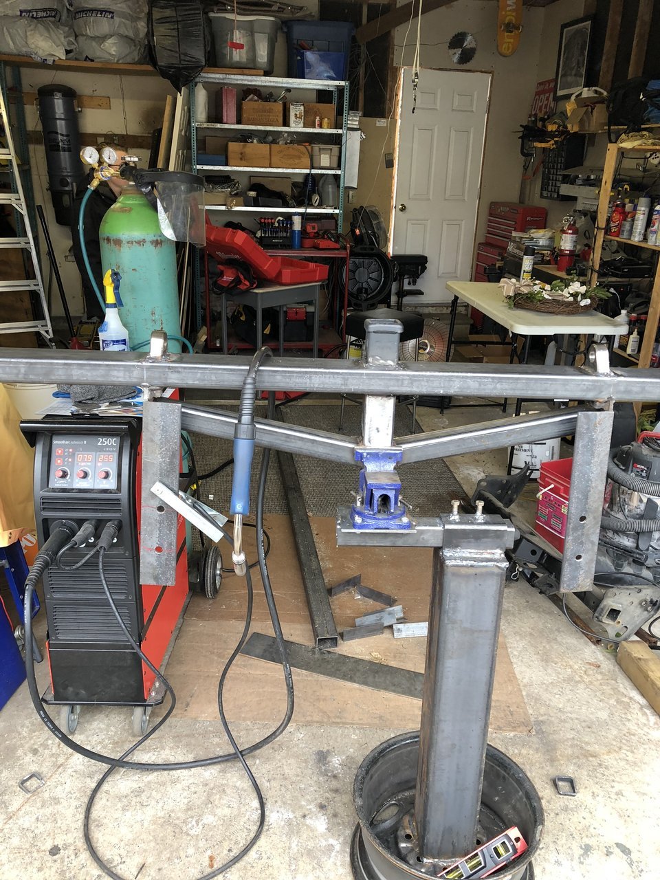

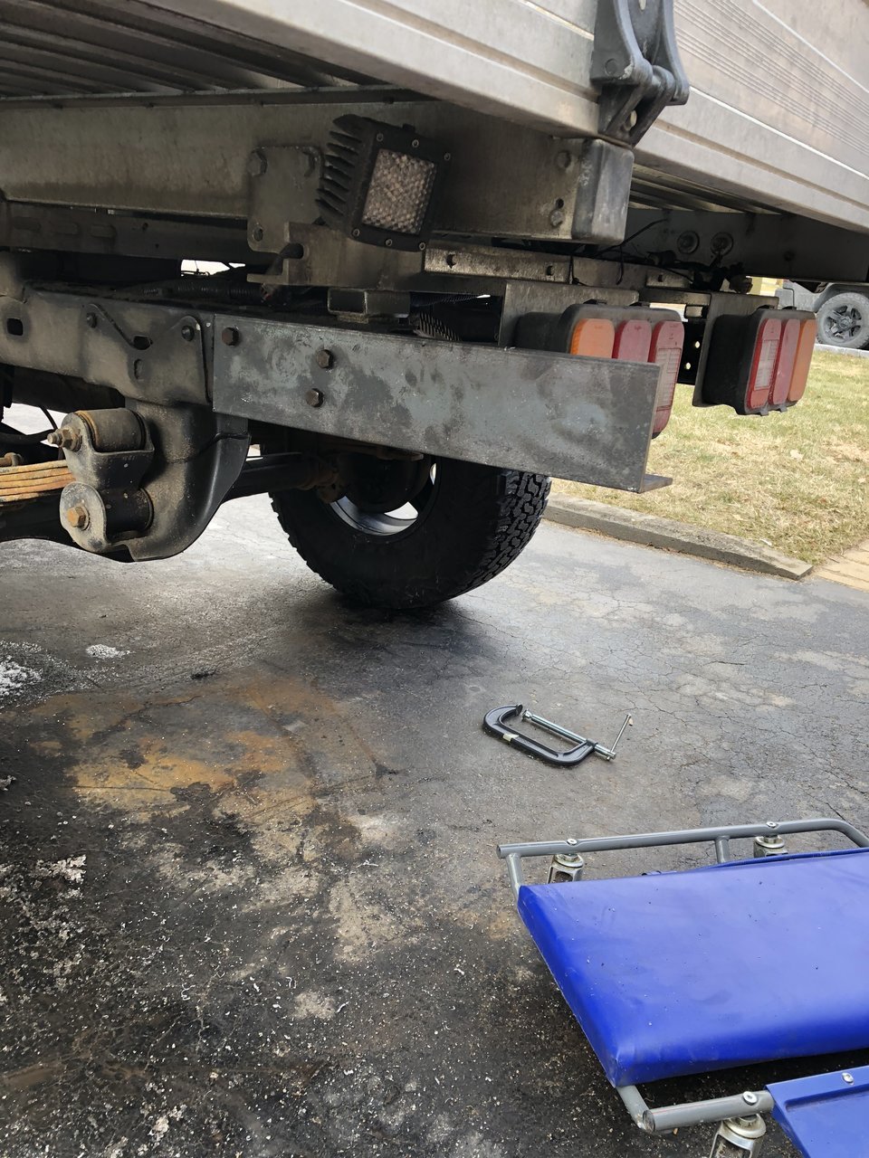

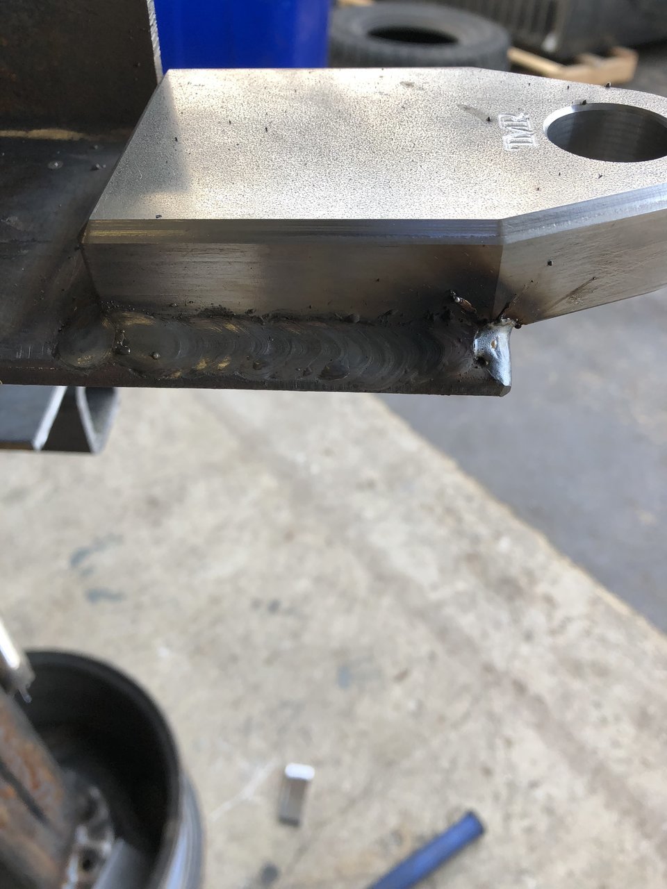

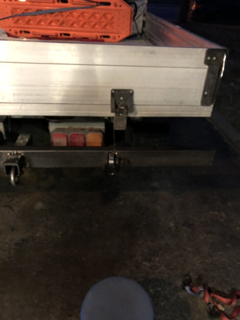

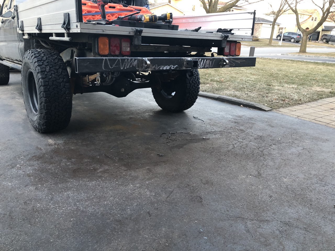

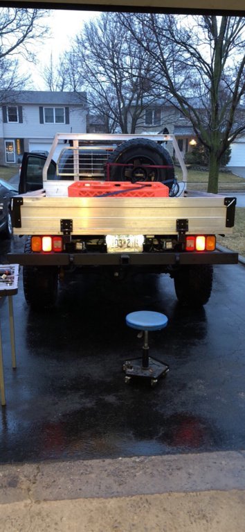

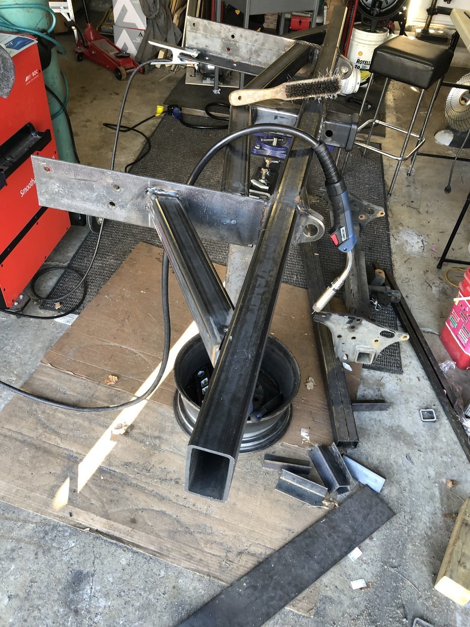

    Continuing with the gear break in. Almost half way there on the kilometre front. I have been building a bumper though.
    I used a lot of peoples builds to help. Using the 3x4 1/4 angle iron for frame plates for instance.
    In some of the pics it looks like my tails will be blocked. They will be moved afterwards.
    Welded recovery points to the frame mounts
    Then using a 2x4 3/16 tube that’s 76 inch’s long I fit the angle and recovery points through
    I’m at the point where I am bracing it to make it more rigid.
    Update:
    Added some supports to hopefully make the mounting system more solid.
    Moved the tail lights to make room for the license plate and junk that’s going in the middle
    I have capped the ends and added a few odds and ends.
    Bumper is done. I was able to use pelfreybilts camera mounts to remount my camera. Very nice to have it back.
