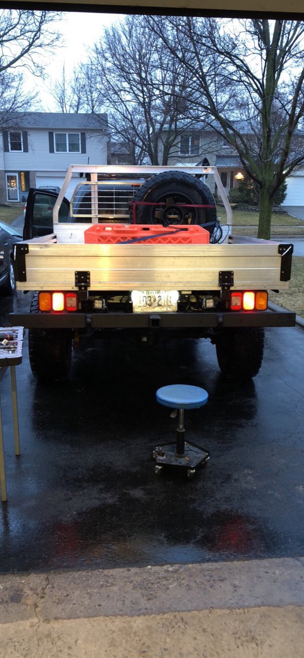

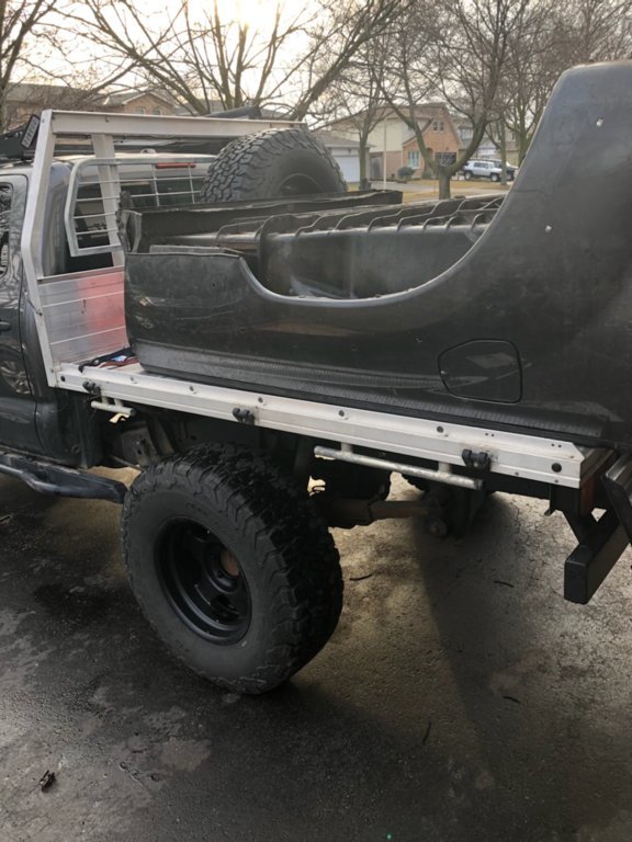

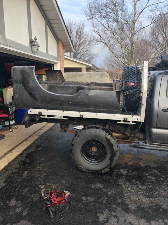

    Old bed is finally gone.

    FJ t-case with twin sticks, UTE bed, some other things :D
    That gives up some space for other stuff I bet. Just having an extra bed for the truck sitting around :rofl:
    Looks like you got some black paint on the rear bumper :spy:

    Yeah the bed was definitely in the way. Was hoping to sell it but meh.
    Bumper is painted and done. Was able to get the license plate lights, backup camera and backup lights all mounted too.
    I am hoping after Monday I can begin the process of the bamf hangers and boxing the back half of the frame. Have to take everything apart that I just installed, weld, and all that but it will be worth it.

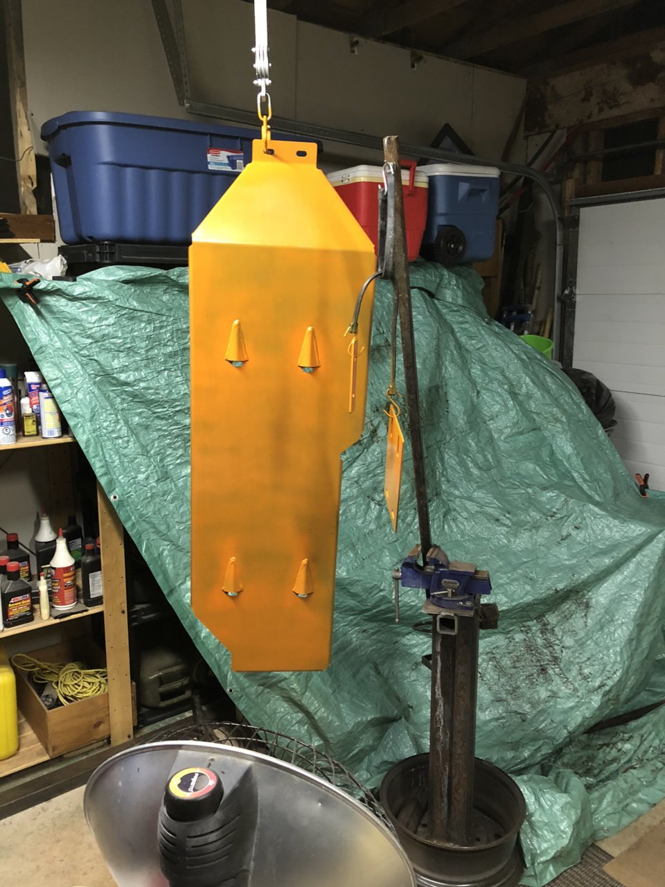

    Painted my gas tank skid that I got in the summer. Figured it would be a good time to paint it....
    Just used what ever paint I had laying around
    First couple coats
    Next colour/can on the shelf

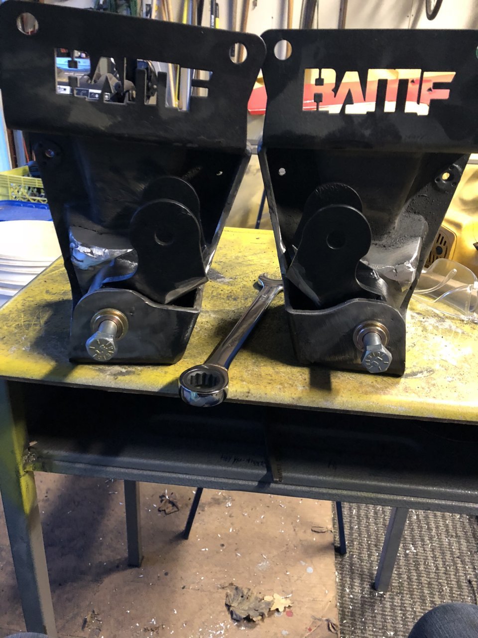

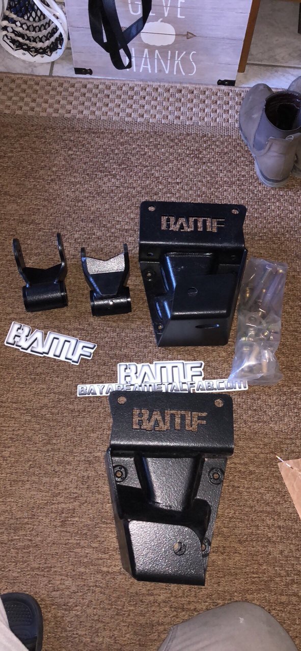

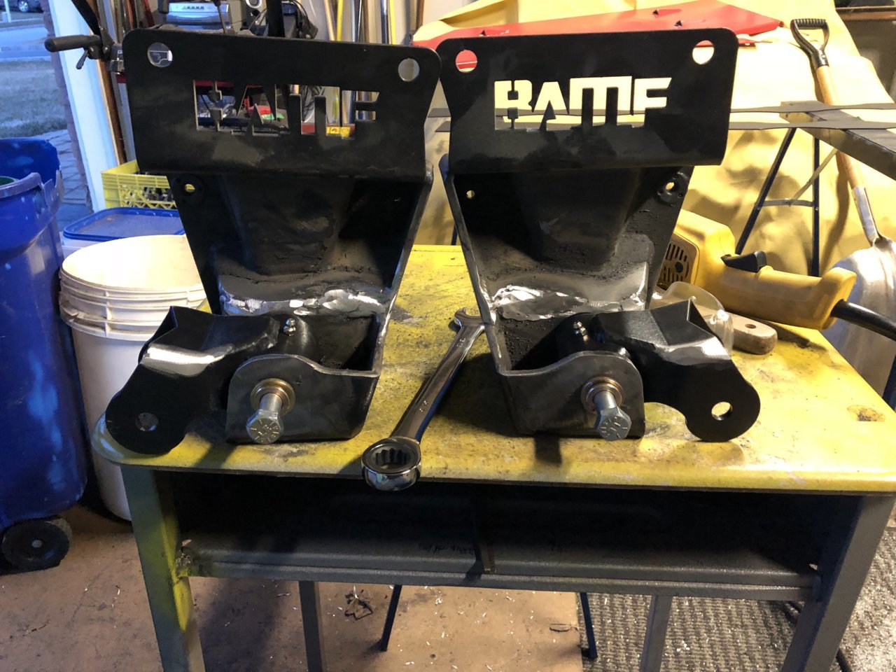

    Well since the weather is crap I may as well update this....
    BAMF Shackle hanger replacement
    Came well packed

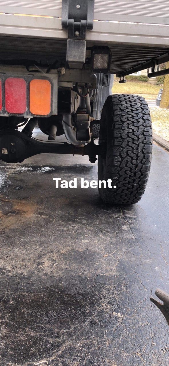

    using this to fix this problem

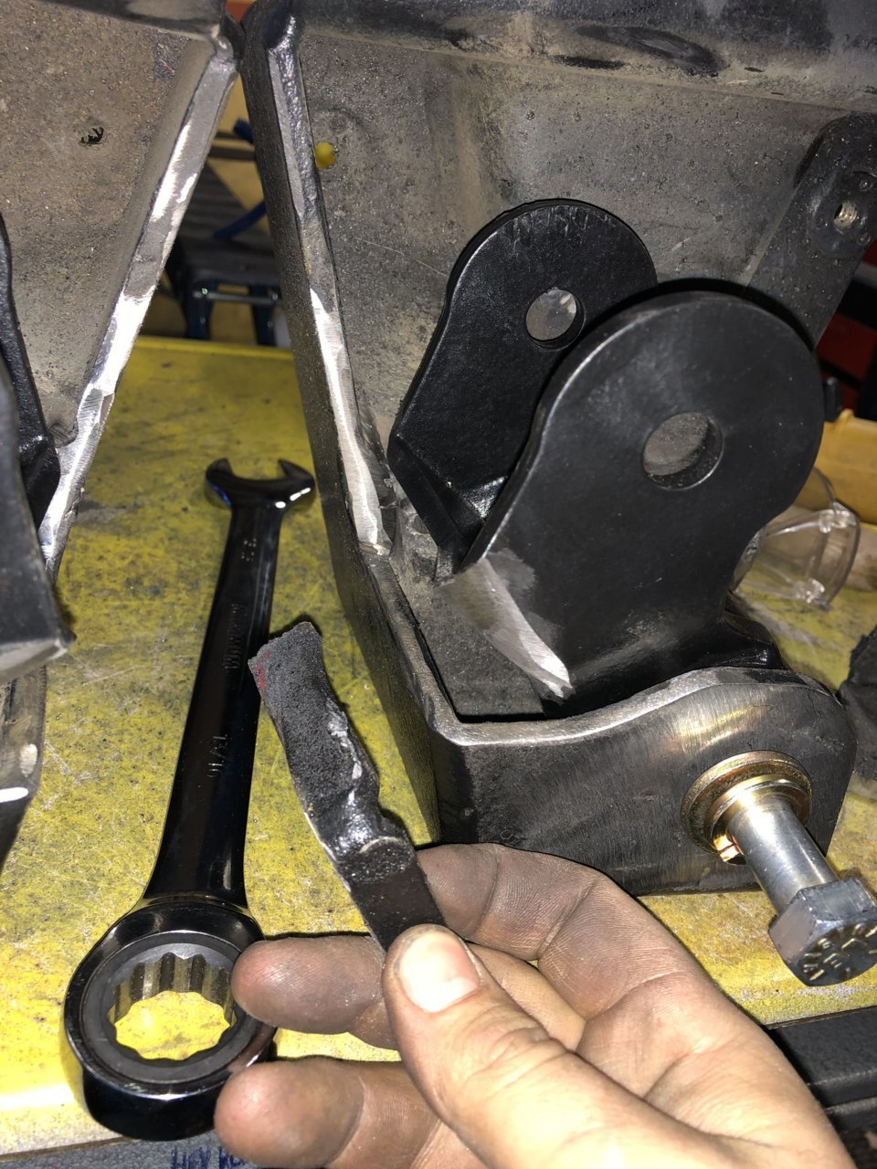

    assembled the shackles on the hangers and there was some contact so trimmed it up to make room. BAMF is fixing this issue but I needed this to work as my stock hangers (which would work no problem with these hangers from what I have read in the thread) bushings are shot from being bent in the hanger for a year.
    Have a little more work on this to clean them up and then get them re painted....hoping next weekend I can finally get them installed.
