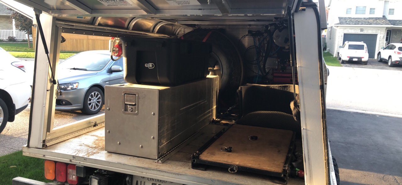

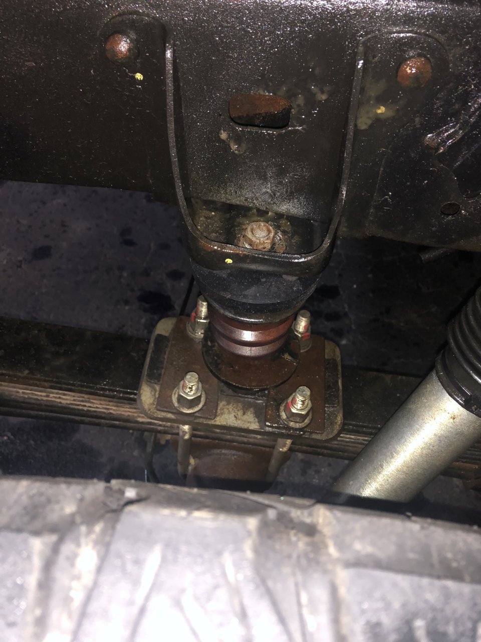

    So, after the trip I am looking for a new drive shaft as @Tridet167 busted a rear shaft. Mines made some contact so it’s a mater of time.
    Also, after seeing @Canadian Joe bed drawer setup I ended up grabbing this off of kijji for $50
    Going to solve a lot of problems I was having.

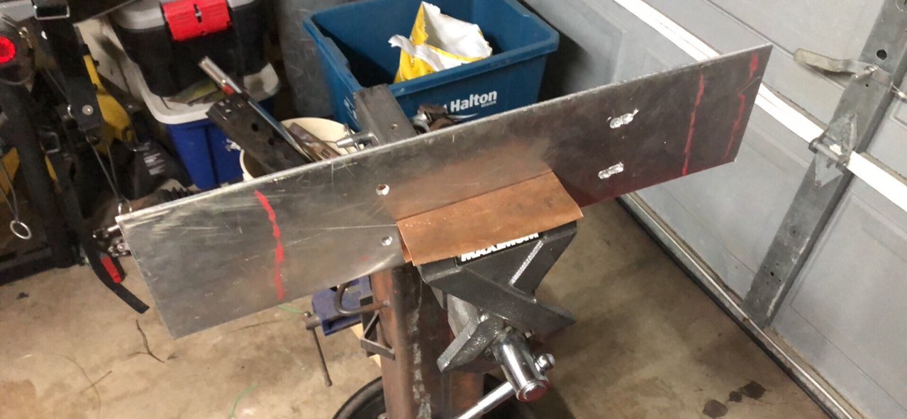

    I was wondering were to get this stuff, I really like the look of my rig with no front fender flares. I think I am going to get the 4" mount to the outside stuff, and use the holes in the fender's for the flares to mount this.

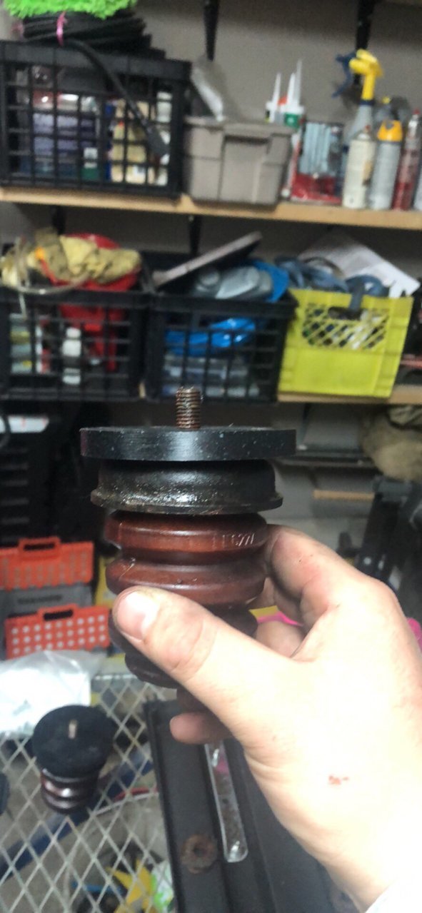

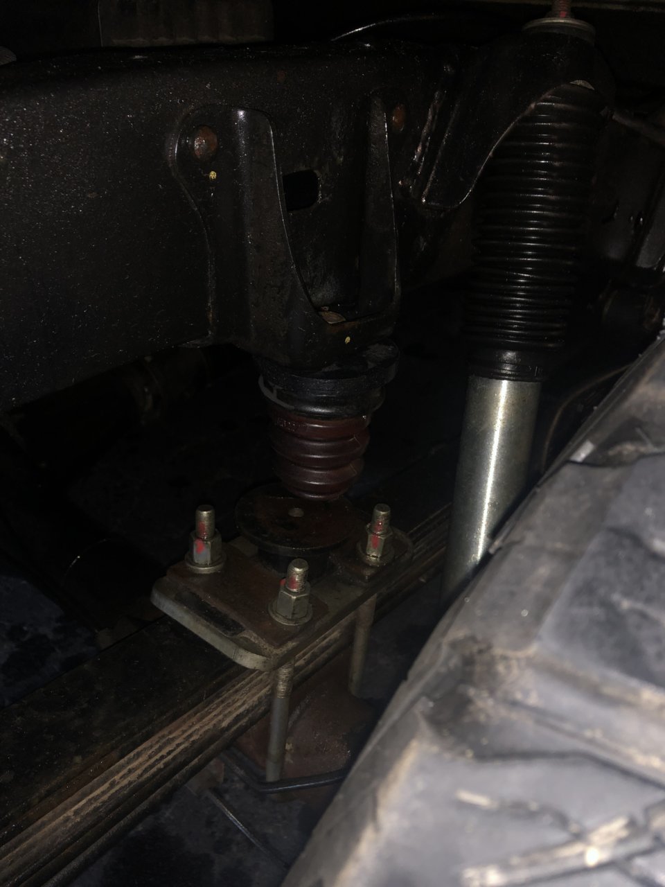

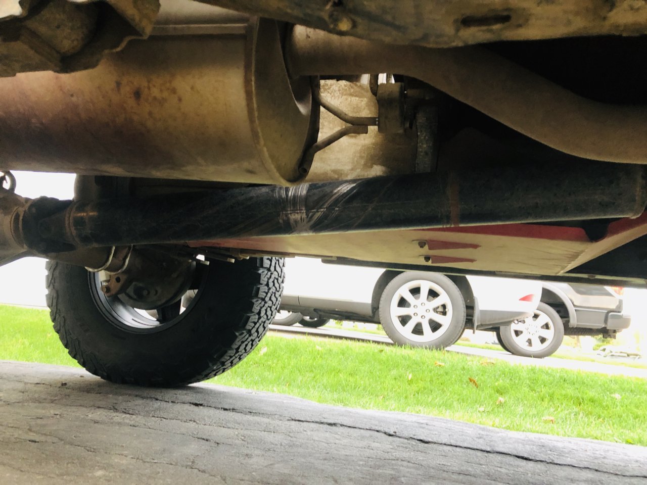

    Tested out the rear leafs to make sure everything was still good after everything has been used a bit. Ended up needing to add some extensions to reduce the uptravel.

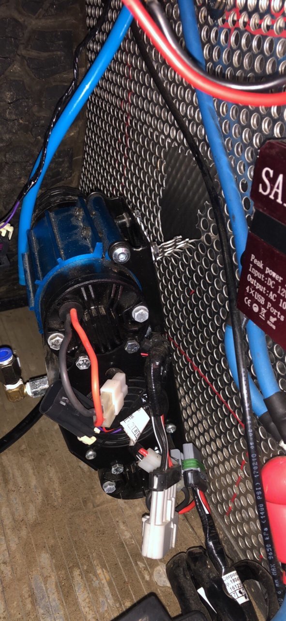

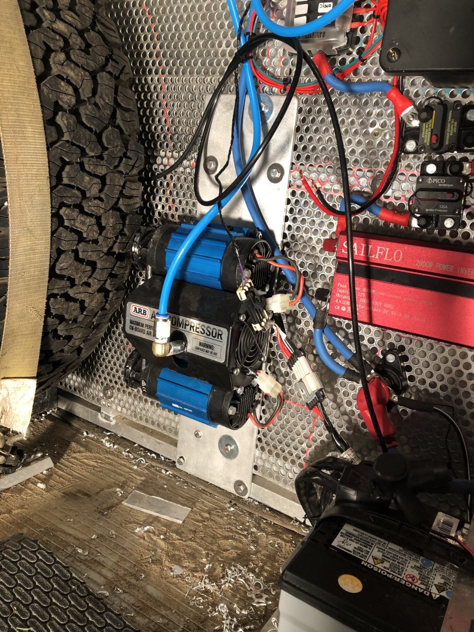

    Merry Christmas everyone. Had some time before Santa came and worked on getting the twon compressor more solidly mounted than before.
    Reason why I am fixing this
    My solution
    Drilled some holes and mounted some rovnuts and bam
    Will clean up the wires and air lines another day. Don’t want Santa to skip my house. Guy may have some long travel or other goodies I don’t need....
    Atlas86 and llamasmurf like this.

    That twin is a heavy pig, I just removed mine for winter. :militarypress:
    I was going to clean it to day but decided to be lazy and just tidy up the storage room instead.
    Your new mounting solution looks way more secure :thumbsup:
