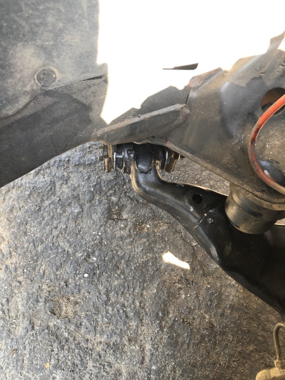

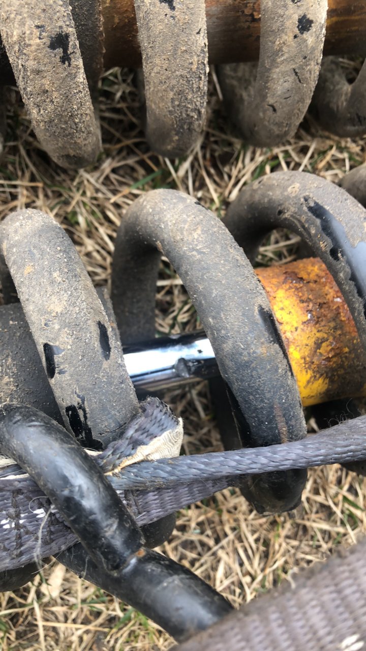

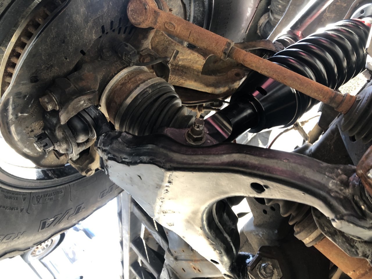

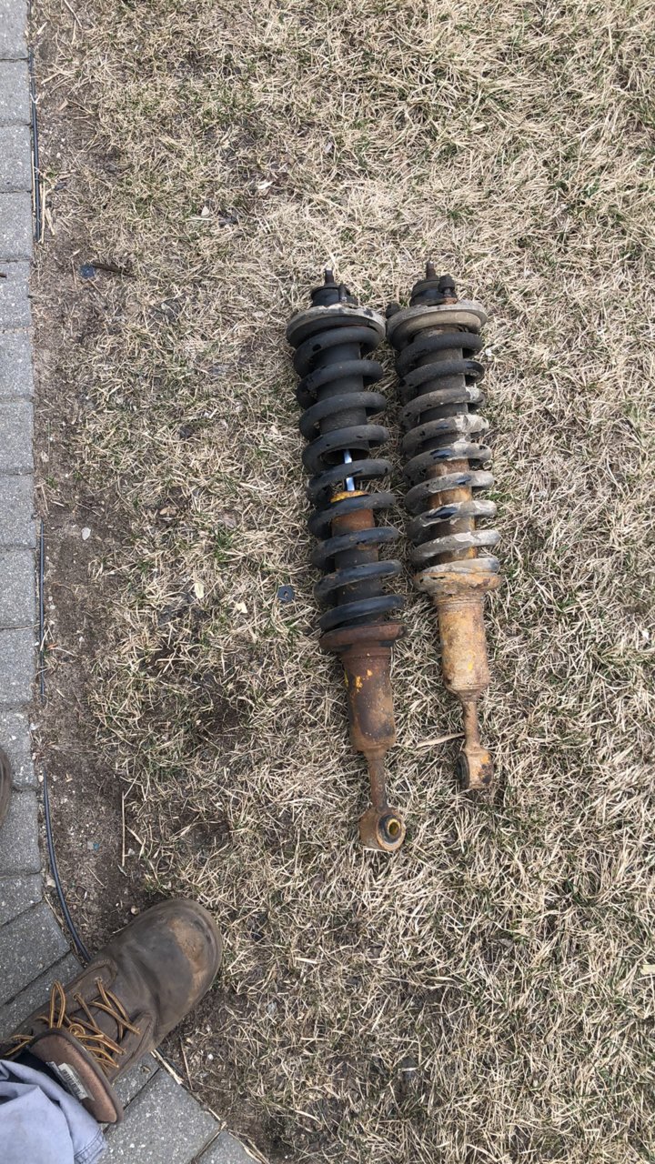

    And it’s done. Glad I got the shocks out as I believe they could have failed catastrophically.
    they are suppose to be the same length
    believe that the internal stops to prevent too much droop blew out. This pic kinda shows where I believe a weld or tab ripped out.
    And the rest of the suspension
    Also some pics of the beefed up lowers
    and beefed up at the mount
    Got the alignment at roughly 0 camber and maxed out caster with the poly cam deletes as well
    See how it drives and I’ll try to dial in the toe.
    not bad for a couple hours over two days.

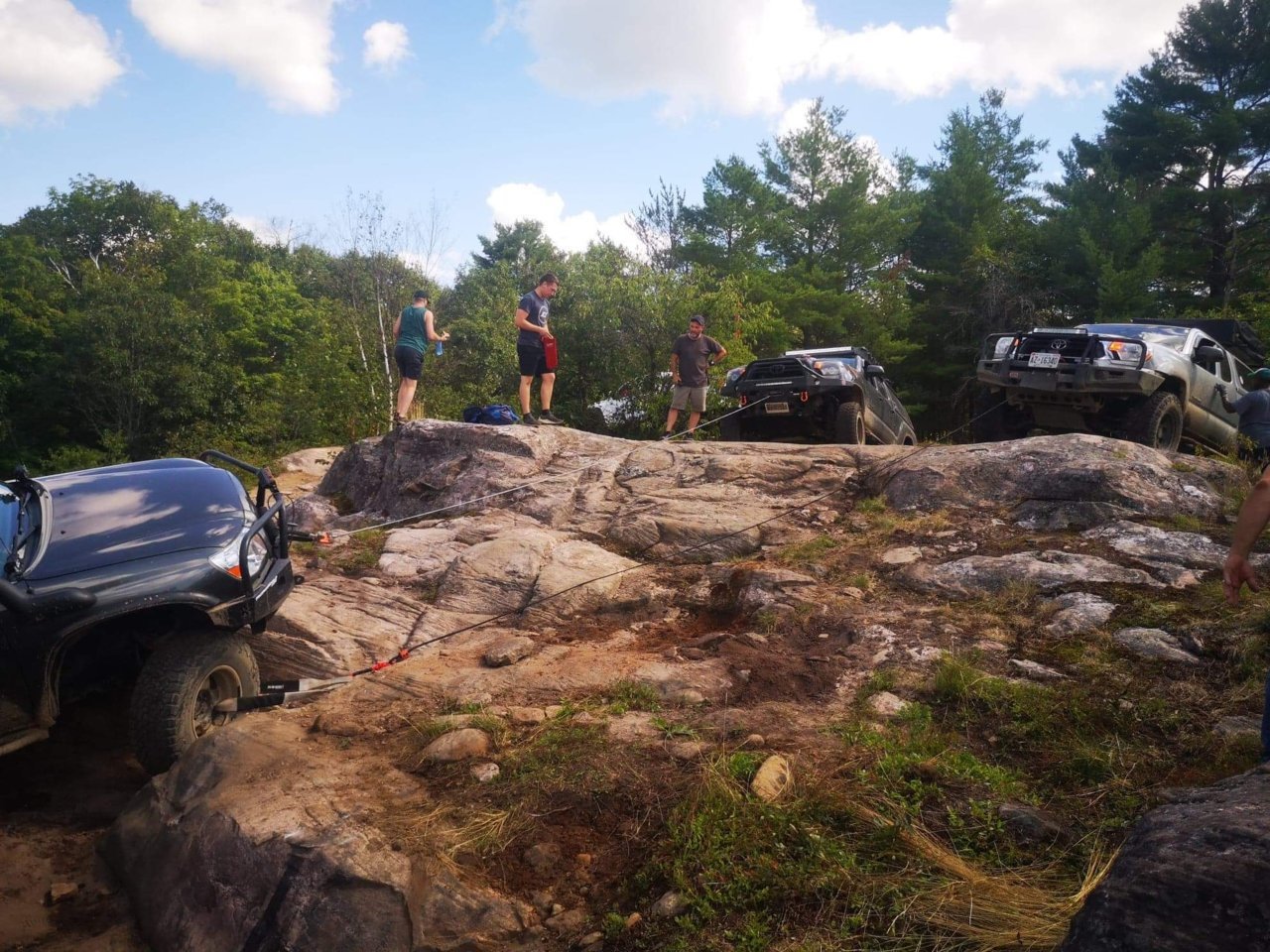

    I cant believe you were driving around on thoes coilovers. 10 lashes with a wet noodle. :)
    Are you going to return to the seen of the crime? I'm not injust got lucky....
    It looks great.

    by seen of the crime do you mean....
    llamasmurf likes this.
  7. Apr 4, 2021 at 4:06 PM
    #747
    Windigo
    Windigo Well-Known Member
    Dec 21, 2019
    #313884
    4,188
    Farook
    Toronto Ontario Canada
    '14 Acess Cab
    Yes that's it.
    It's the limit to my truck so I will not try again..
    Great pic BTW.
    llamasmurf and tacoma16[OP] like this.

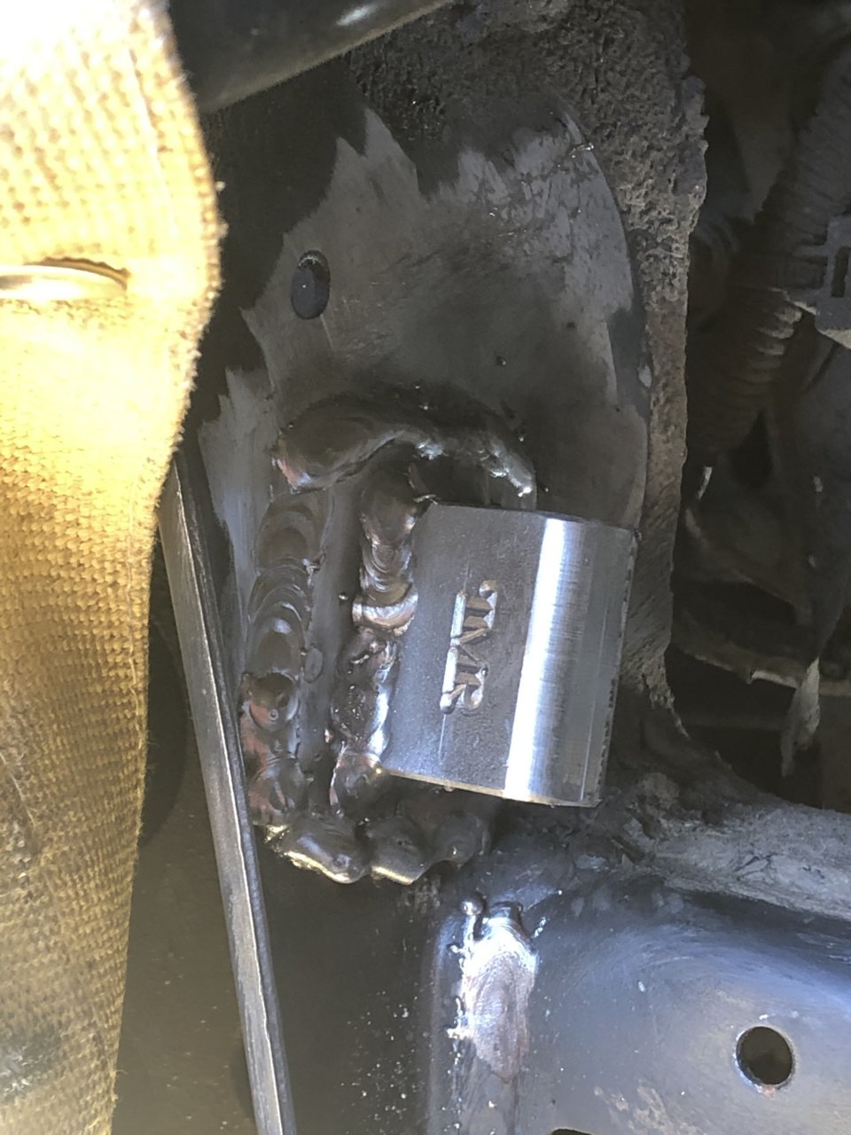

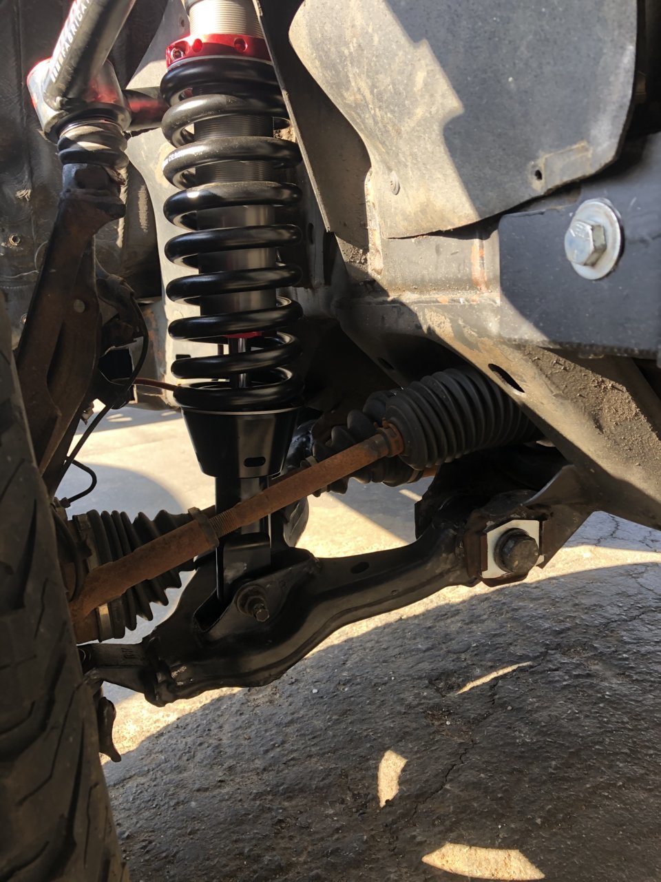

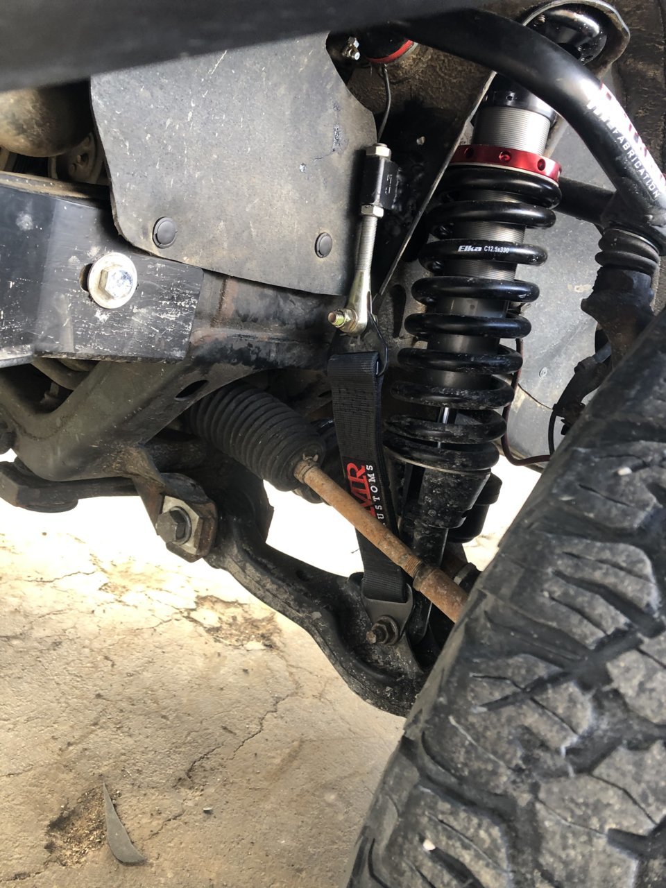

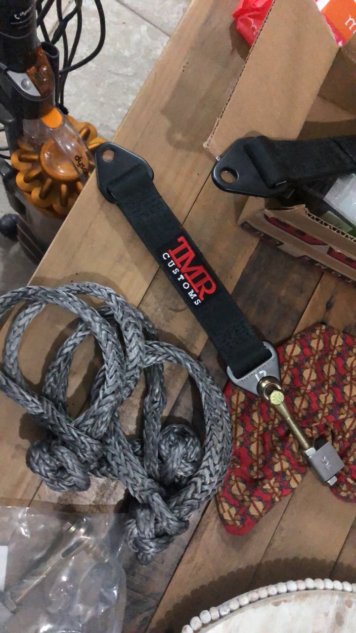

    With the new shocks and whole front end pretty much rebuilt, I decided to add limit strap to ensure I don’t have any issues any time soon. If I was running a sway bar I wouldn’t bother, but I’m not so I feel this is needed
    this is what I used all from tmr customs 184621EF-5EFE-4300-8224-C5FB15A9DD85.jpg

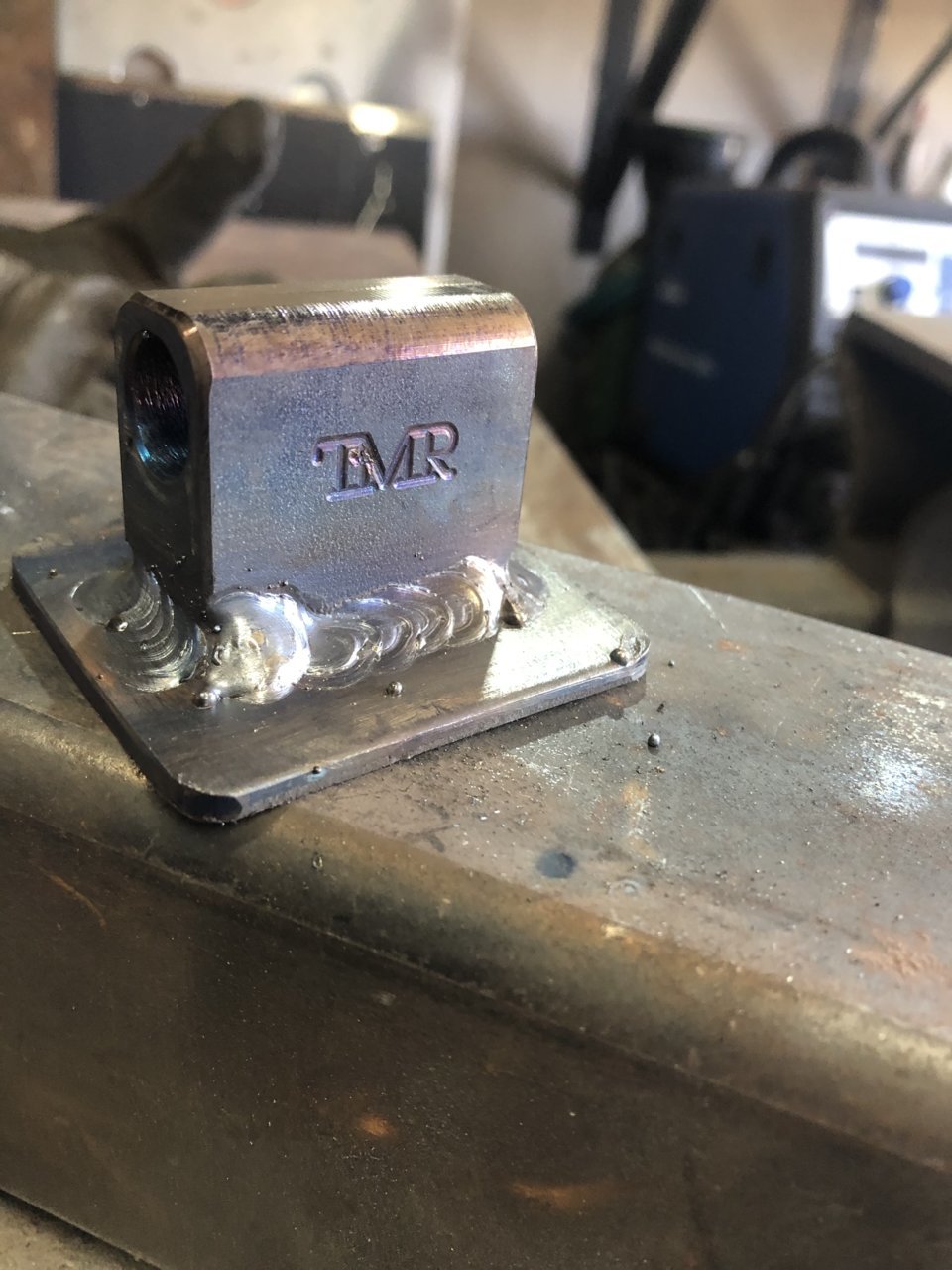

    added some frame plates to have a bit more surface area for welding
    Since I got 12” straps I went to the shock tower. Don’t look to close to my welds, it’s a tight spot with a welding helmet and what not. Should hold fine.
    All installed. These will stretch to 13” and I have plenty of room to adjust them
    This is at droop. I’m only trying to limit down travel a bit, and will have to readjust in a bit once these stretch

    Are the straps there to limit travel or is it a just in case something breaks again safety measure.
    After what happened its making me think.....
  15. Apr 17, 2021 at 3:26 PM
    #755
    tacoma16
    tacoma16 [OP] Well-Known Member
    Mar 15, 2011
    #53109
    11,152
    Peter
    Ontario
    Double cab SR5 4x4
    It’s limiting travel a 1/4” or so. Essentially ensuring my shocks don’t take the brunt of droop and saving ball joints. Since I’m not running a sway bar it should help a bit.
  16. Apr 17, 2021 at 4:10 PM
    #756
    Windigo
    Dec 21, 2019
    #313884
    4,188
    Farook
    '14 Acess Cab
    I think I'd go 3/4". Just for the stretch that might happen with the limit strap. Excellent idea. Better that breaking another axle tube.
    Great :frusty:another thing to put on the list.:)

    That’s the thing, I believe my strap will stretch 1” total. But I have read conflicting information if the strap stretches while in use or over time (12” strap becoming a 13” strap). Regardless I have about 1” of adjustment.

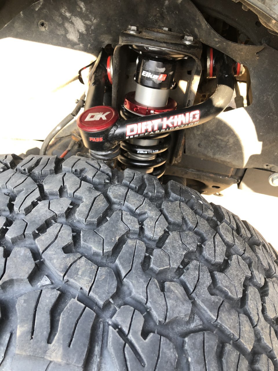

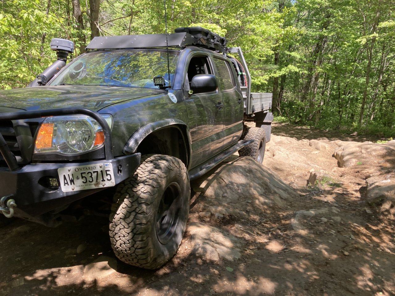

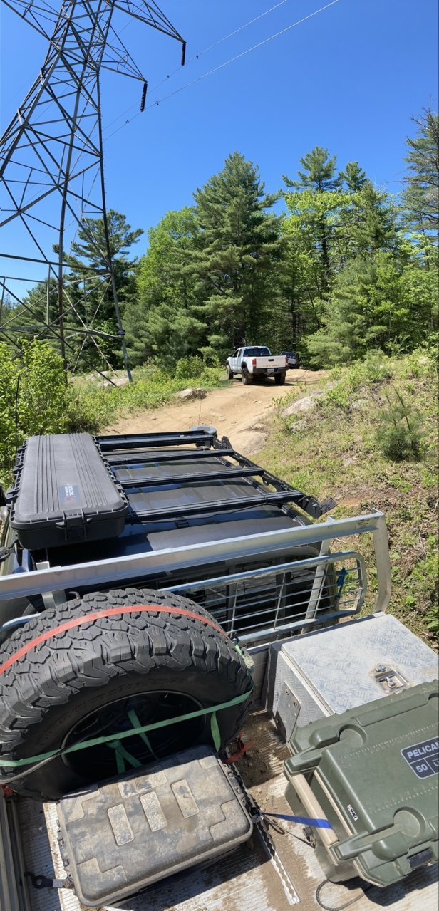

    Finally got to test out the suspension and was very happy with the ride. I am rubbing now with the caster not being what it was. Can’t max it out like I had.
    also really liking the empty bed for day runs. 82F6936D-4ABC-4374-A5D8-3C5C663262D7.jpg
    have to do some hammer work on the fenders and also double check my limit straps.
