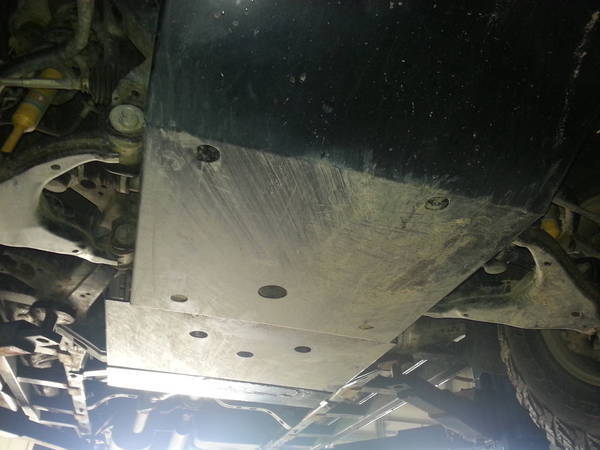

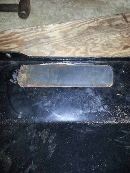

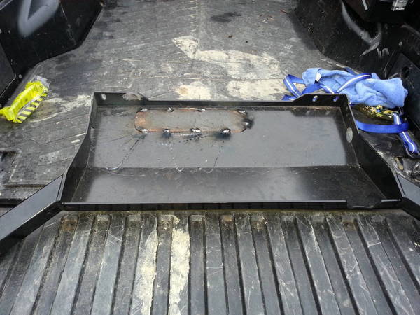

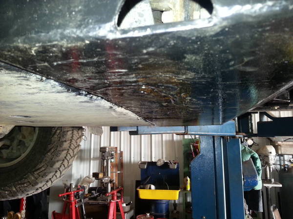

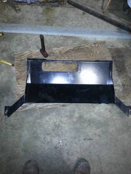

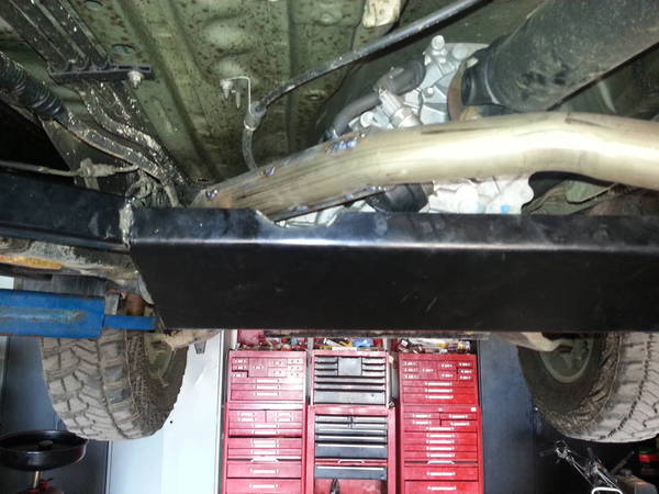

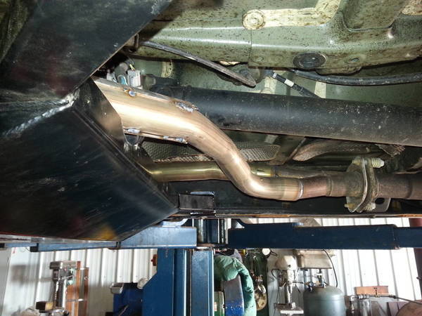

    So I got my exhaust rerouted, which meant I had to get rid of the crossover pipe accommodation on my skid. Let me tell you, this was a PIA to cut off, but after about 4 and half cutting disks it was gone
    Cut a piece to fit in the old place.
    some booger tacks (the lens on the welding masks wasn't charged so had to do it with out looking)
    Had to cut out this groove to make sure it fit and didn't vibrate against the exhaust.
    All flat now :D

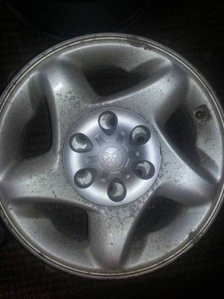

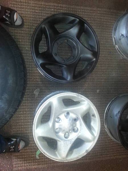

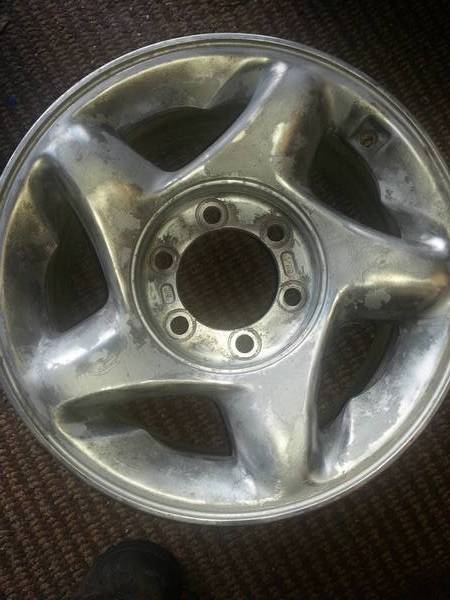

    As for work done for the truck, I painted some 1st gen rims. Was so busy this sumer it took me almost a month in a half to put 4 hours into these rims. Didn't even get to finish them, but that's life right.
    how they were
    all cleaned up. Just used a wire wheel to get rid of the peeling coat and used some light grit sand paper to try to have a smooth finish
    Painted them a matte black.
    I bought 8 rims for $250, where they all came with center caps, plus one set had lugs so I was pretty happy with that. Got 5 rims painted and still need to do clear coat and paint the center caps.

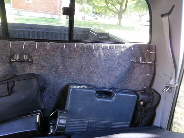

    As for my back seat storage I took out the plastic storage bins and used the seat brackets to bolt a piece of carpet padding and carpet to the back to keep the road noise down and to save the cab from getting scratched or dented from tools and what not.
    I didn't want to use any glues or adhesives so I used some lacrosse lace and sewed (to the best of my ability the padding and the carpet together)
    to give an idea how it looks with a seat up
    All in all the carpet was like $30 and the padding was $50 but I have enough to make a platform for the dogs so $80 for 2 projects isn't too bad.
