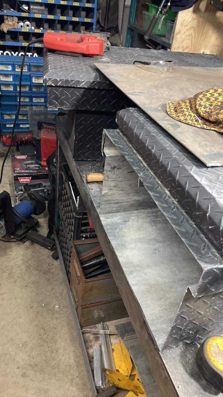

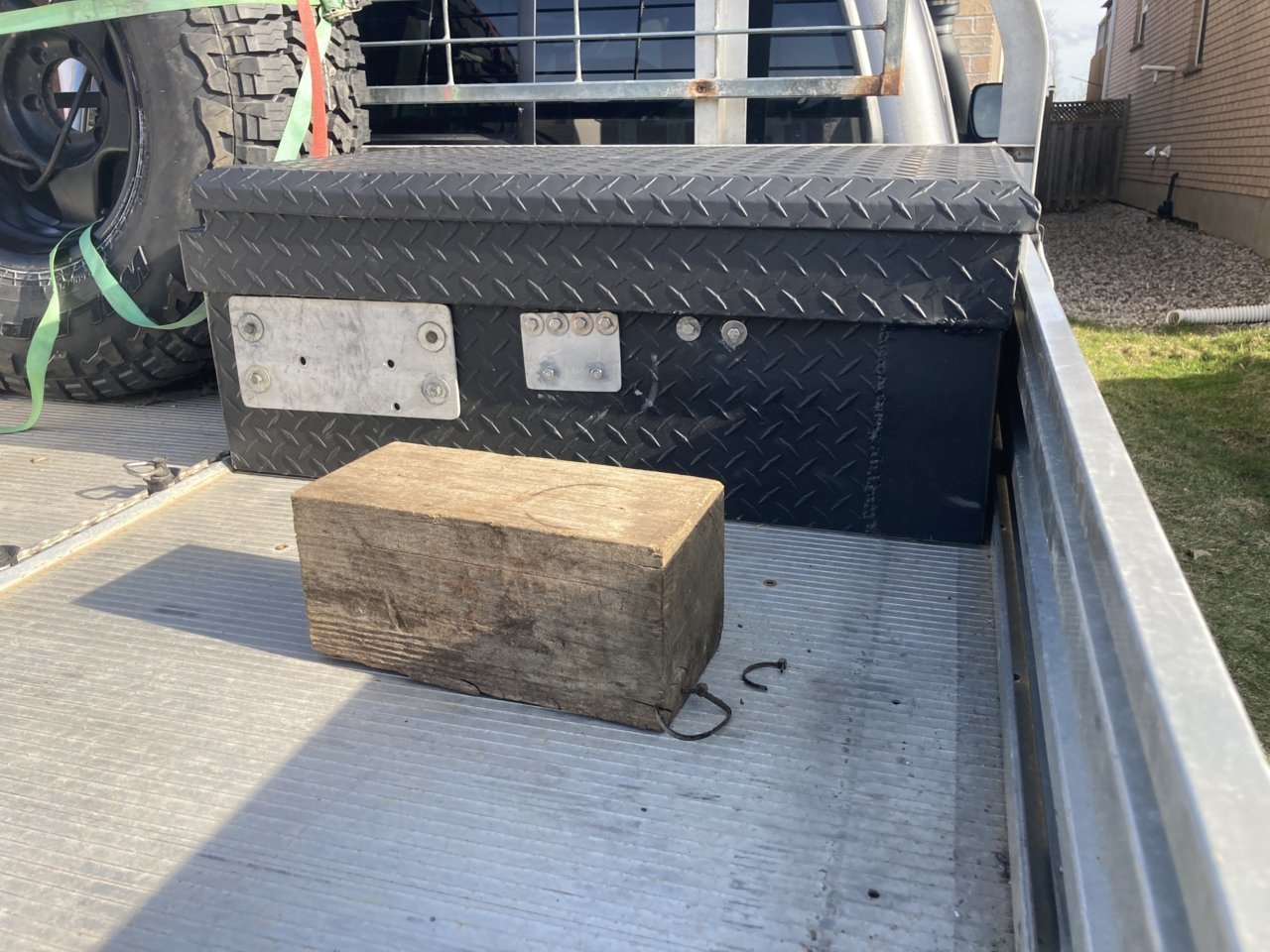

    Okay this took a long time to accumulate parts and figure it all out.

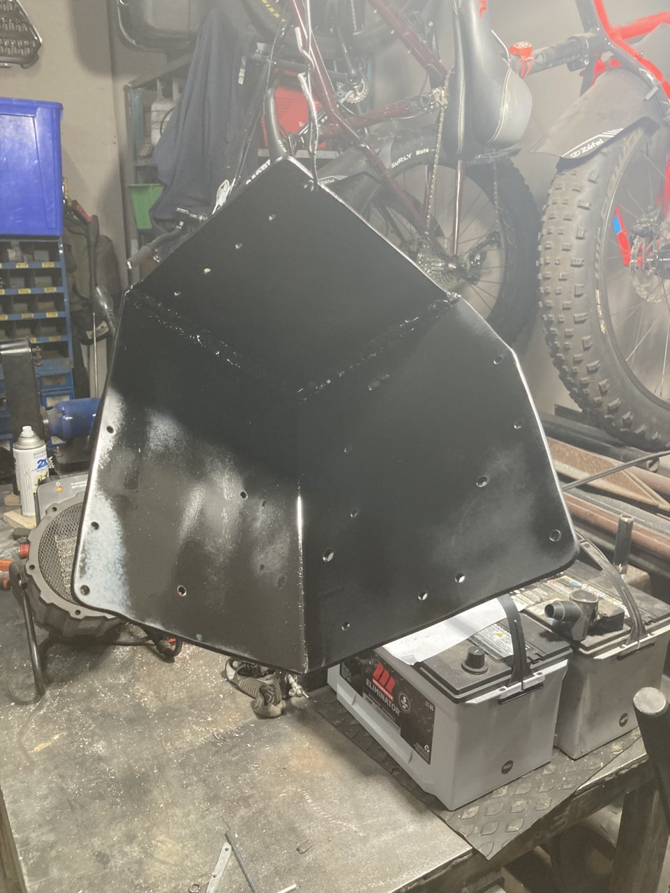

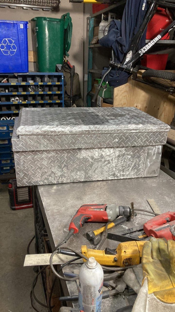

    First needed a spot for the batteries. Decided to switch the old tool box that I had and go with something with a side open.
    Used a full sized tool box that I cut in half and rewelded.
    All welded up and ready for paint
    and mounted.

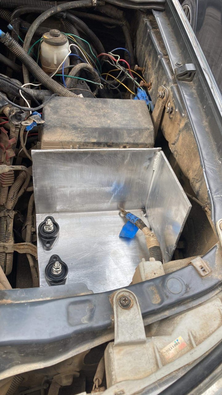

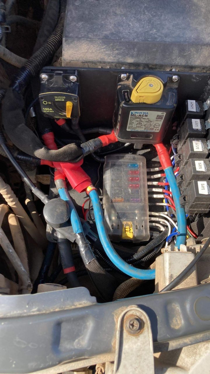

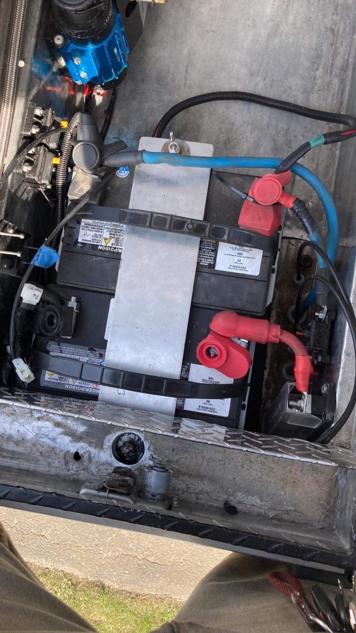

    For the wire, I ran 2/0 from the box into the engine bay. I already had a 1/0 cable running back there for the second battery I had. The 2/0 is fused at 400amps for winching. The 1/0 for the auxiliary is on a 140 amp breaker. This is all in the box with the fuses as close to the battery as possible.
    in the box I also have my compressor and will have a inverter as well. Working on that still.

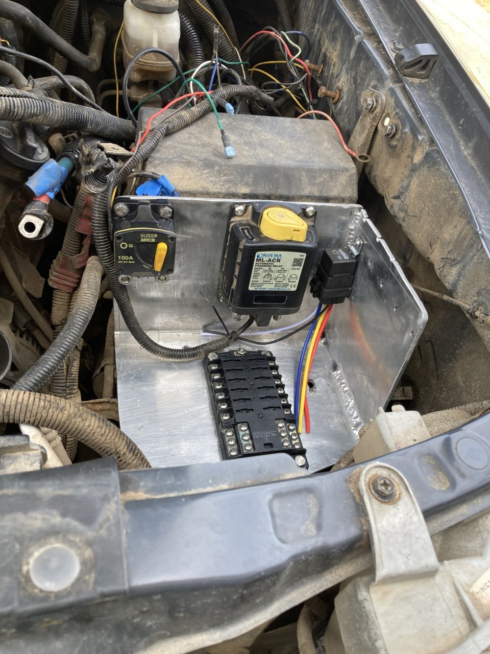

    For the engine bay I made a bracket to mount the relay for the dual battery charging, all of my relays for lights, a breaker for the aux panel and terminal posts. It’s made out of aluminum as well.
    you can see the rats nest I had in the back. Years of adding and running new wires. All consolidated and redid pretty much everything so it was organized and easy to diagnose if need be.
    1783B3F9-A8B1-4085-A6BD-0DB5DCD1B90C.jpg 62E7ACCC-5A46-43E4-8159-7ACA6BDBD362.jpg
    I used 1/4” aluminum so I was able to tap all the holes instead of using nuts which would be hard to access.
    I also made a bracket for the winch fuse as well. Opened up a bunch of room in the corner for the eventual tundra brake booster swap. image.jpg

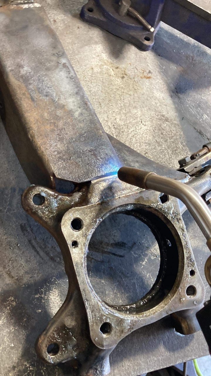

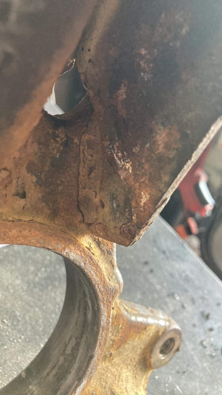

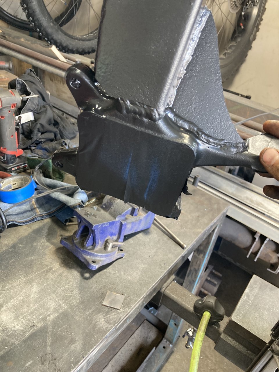

    Story time

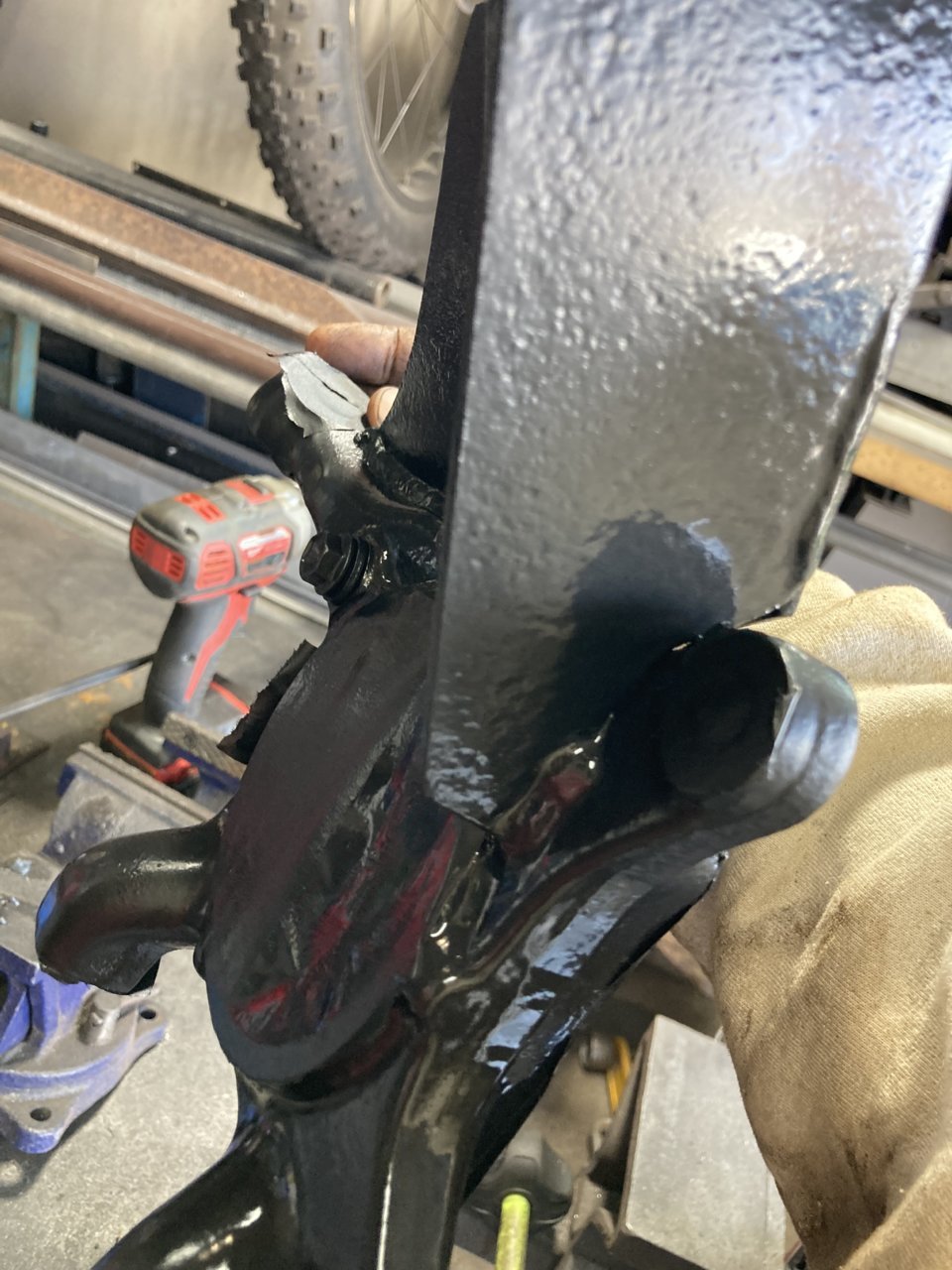

    Today I was planning on changing my wheel bearing. Purchased a assembled hub and figured it would be an hour start to finish.
    All going well until I found some cracked gussets on the spindle gussets. Okay not ideal but we are here so let’s fox it.
    38B55ADF-0F4A-47D0-9A20-4E617884C1A1.jpg 3D30EA06-B7D6-493E-8A15-F051F34BC83A.jpg
    Grund out the welds and crack with a die grinder till the two base materials were separate and the crack appeared to be gone. Little pre heat and some weld and good to go.
    Painted and waiting for paint to dry.
    C6F1A9D7-5935-4694-B779-5BCB5DA5ADD2.jpg 21637713-9952-44C9-8CC5-B2FAA1C54C77.jpg

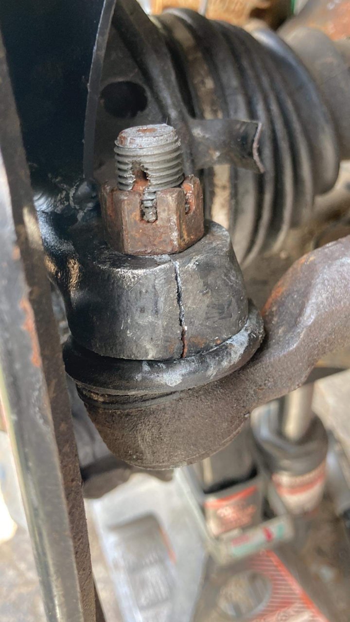

    Reinstalling it all with the new wheel bearing. Torqueing everything and I hear something…..
    At first I thought, it cracked because I over tightened….but it cracked when torquing with the wrench. Great.
    Thought it was the welding but it had cooled down and supposedly the spindles on our trucks are cast steel not iron so should be good.
    After looking at the knuckle I realized that hammering to get the tierod off all these years peened the knuckle and it finally cracked. Fortunately I have a second set of spindles so the trucks running. Interesting lesson (I’ll be buying a bj separator tool) that I’m happy happened in the driveway.
    So….my one hour wheel bearing replacement led me to reweld a spindle and then completely swap the spindle. Total time…. 5 hours (with waiting for paint to dry) and one trashed spindle. I’m sure I could wed the crack but I think the cost of buying a reamer I could have a second set of spindles for spares.

    And I thought I was having a bad day...wow what a stroke of co incedanses. Well better it happens in the drive way than on the trail. Tie rod separator is also in my future after I seen this.

    Yeah. Going to go and get one too Everywhere I looked said “hit it with a hammer and it will pop out”. But I guess they haven’t had to repair the front end as many times as I have.

    It's also 12 years old, and the number of times you "improved it" is far beyond of number of times engineers designed it to last.
