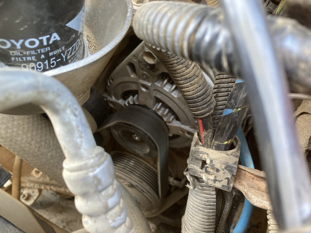

    New alternator with upgraded wire to the fuse box and main battery B5542EE2-CDB1-461E-8312-584D3559F554.jpg

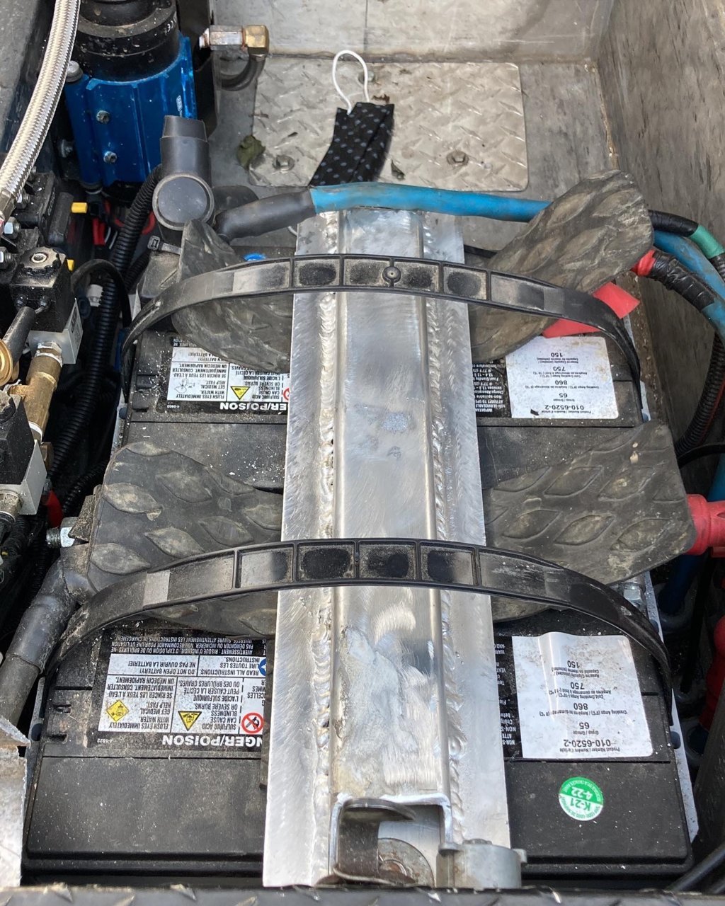

    Gusseted my battery tie down since the flat plate was flexing a bit

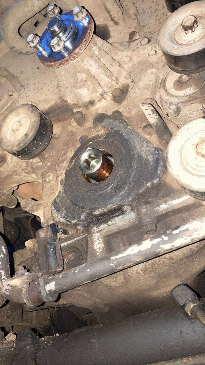

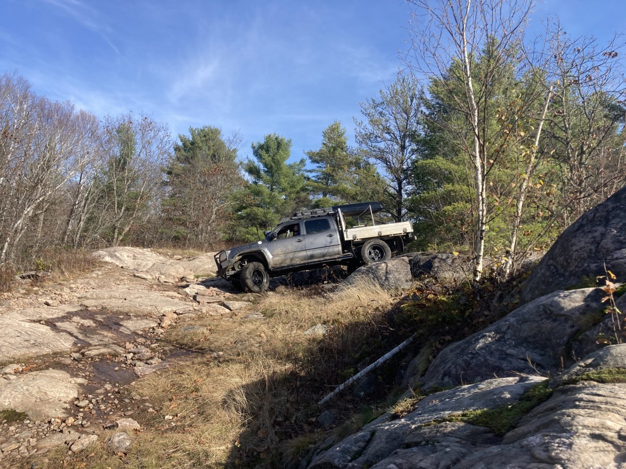

    and a few off-roading trips along the way too B151F9F0-0751-4A0C-BC7C-48DB487F9A36.jpg F82A4220-27D2-4E9A-A063-7DD2CE6DDCCC.jpg
    Remeber to clean up what you find on the trail E274BAAF-7D90-41B6-8A8F-508523BAC2E8.jpg

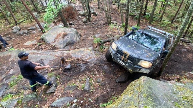

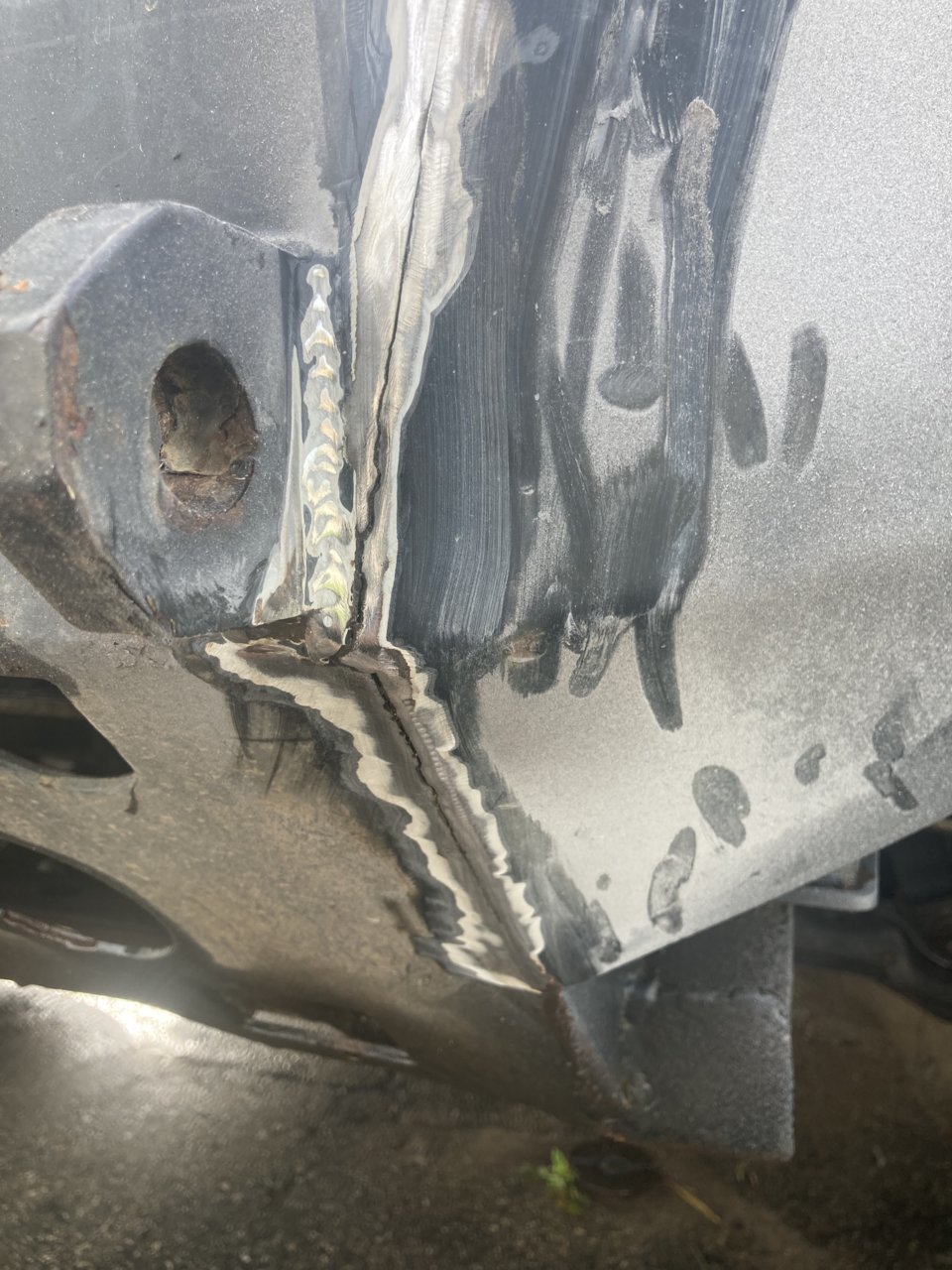

    truck did well. Trails were very tight which meant some wide turns using the bumper to push off things.

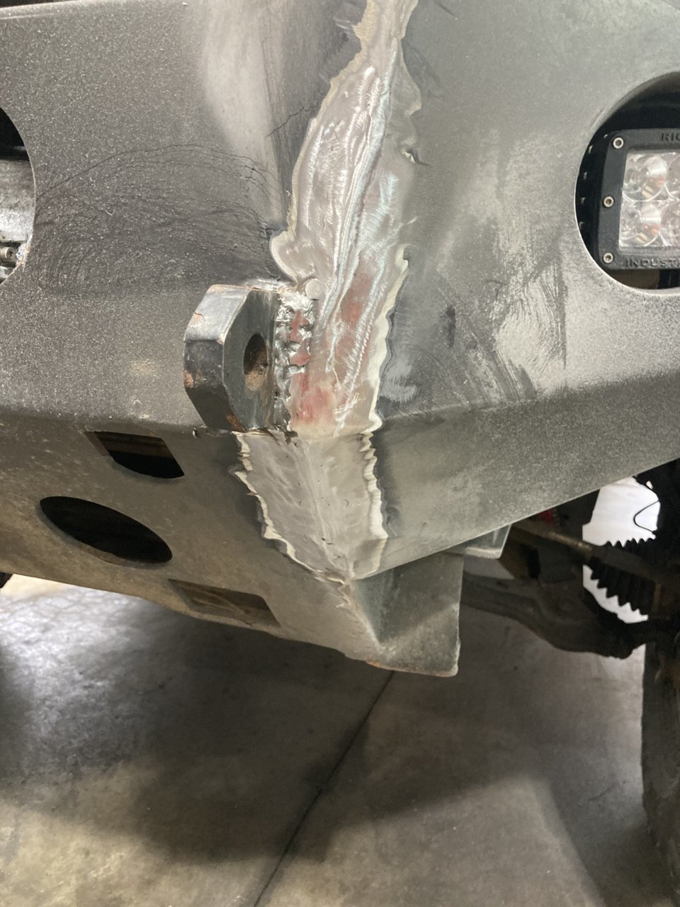

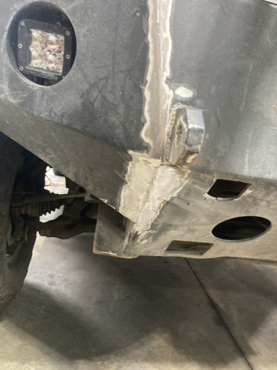

    ground out the crack and drilled it out at both ends. Then welded it up. I did build some material up over the crack for the time being.

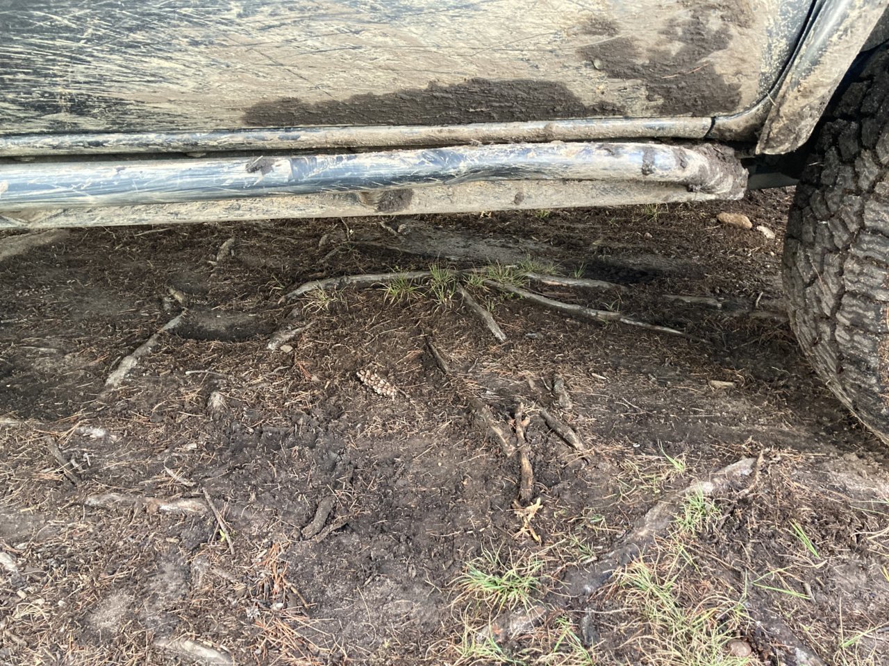

    Other then some door dents and scratches and the skids being used the only other damage from the yota crawl which isn’t even damage since armour takes hits, but was pretty impressed on bending a slider
    Was a great run!
    big thanks to @Windigo and @Norilsk for spotting and pulling line! Huge shoutout to my wife for being up for running some trails on our wedding anniversary.

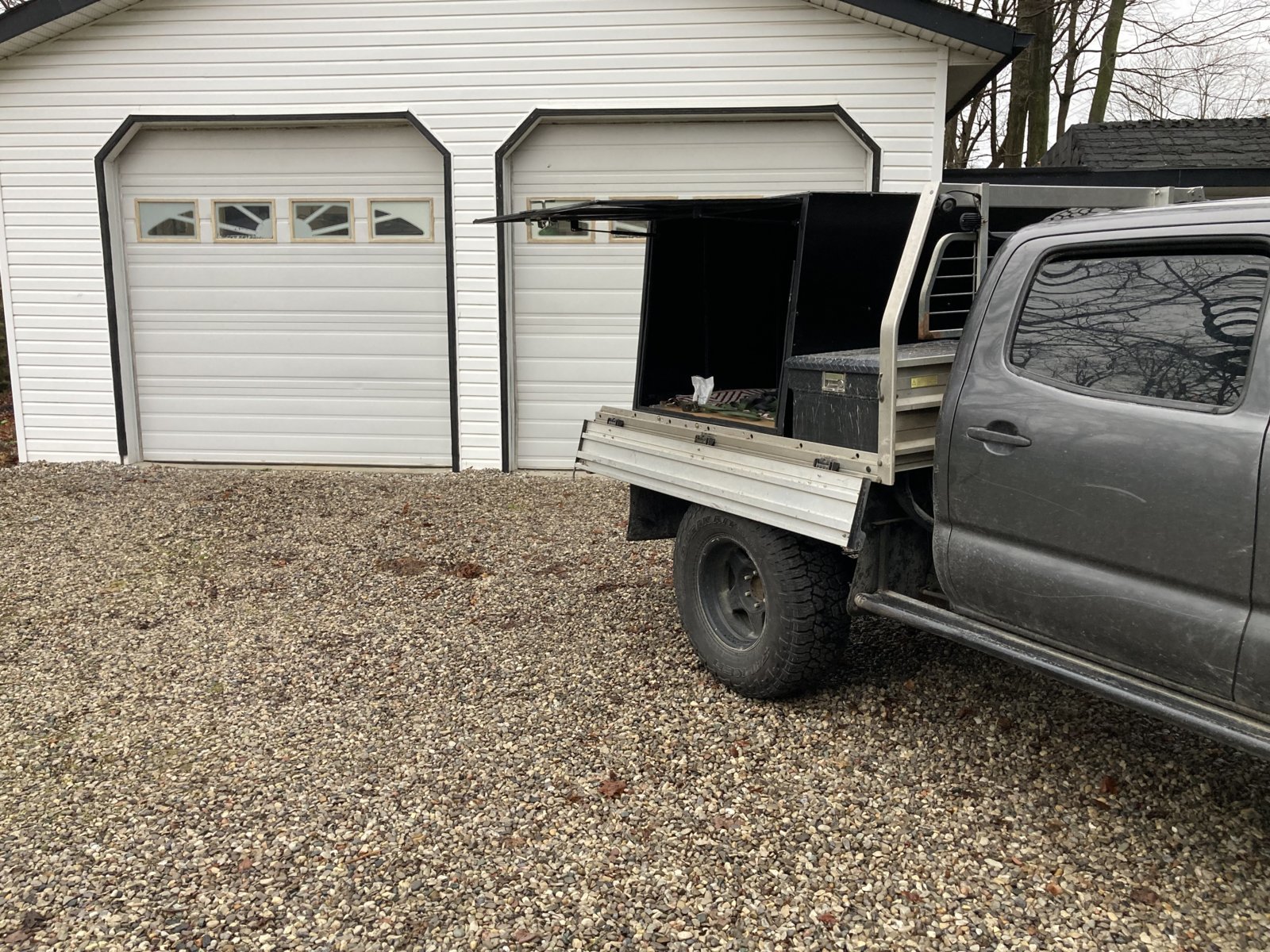

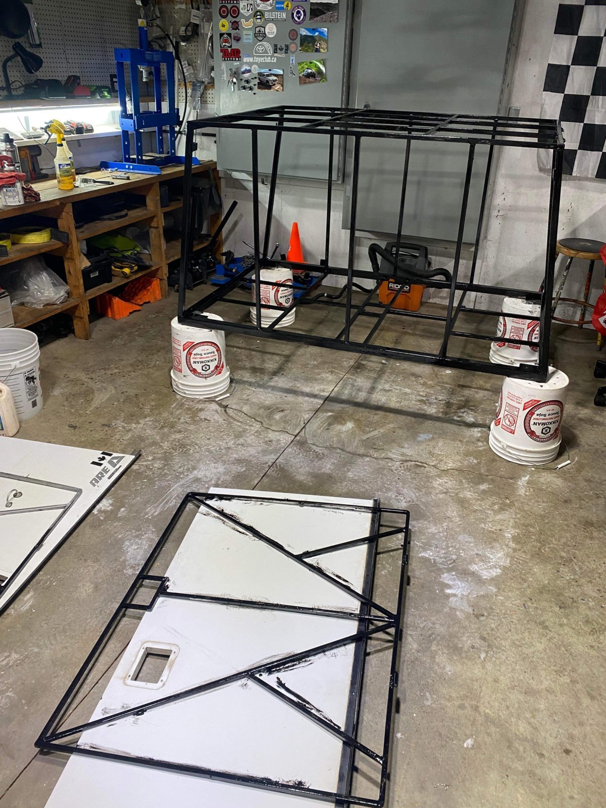

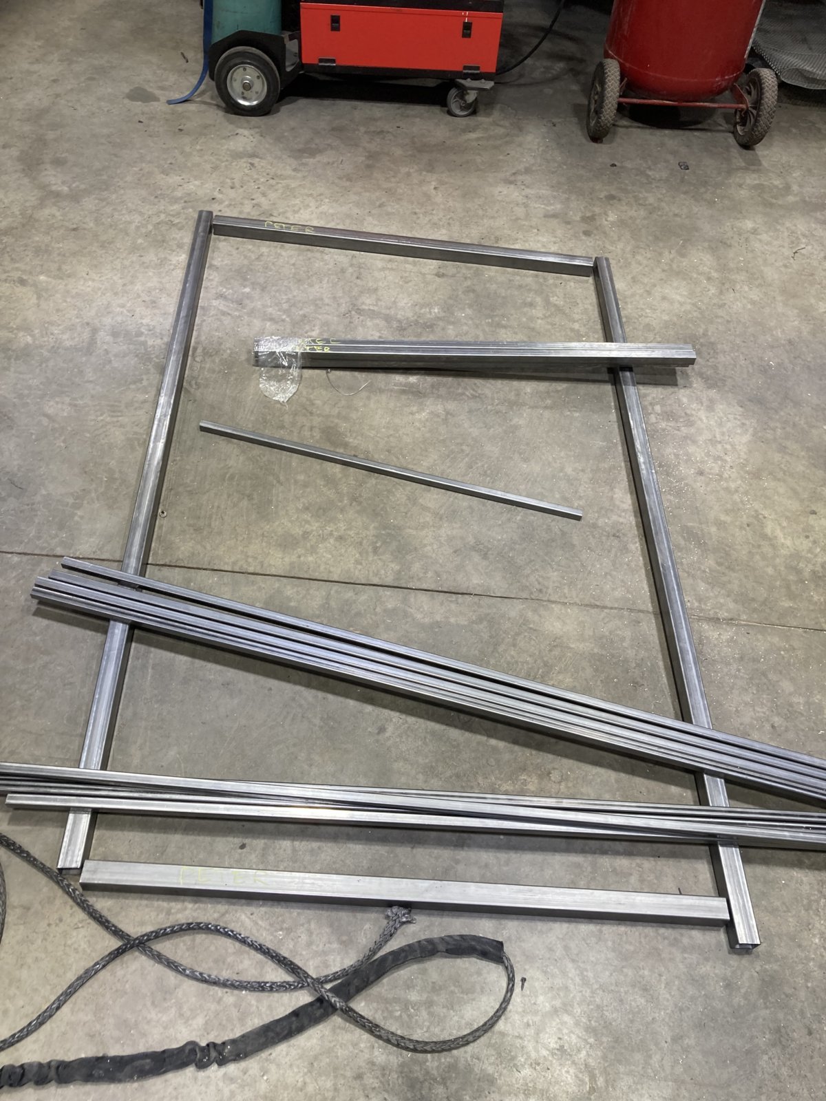

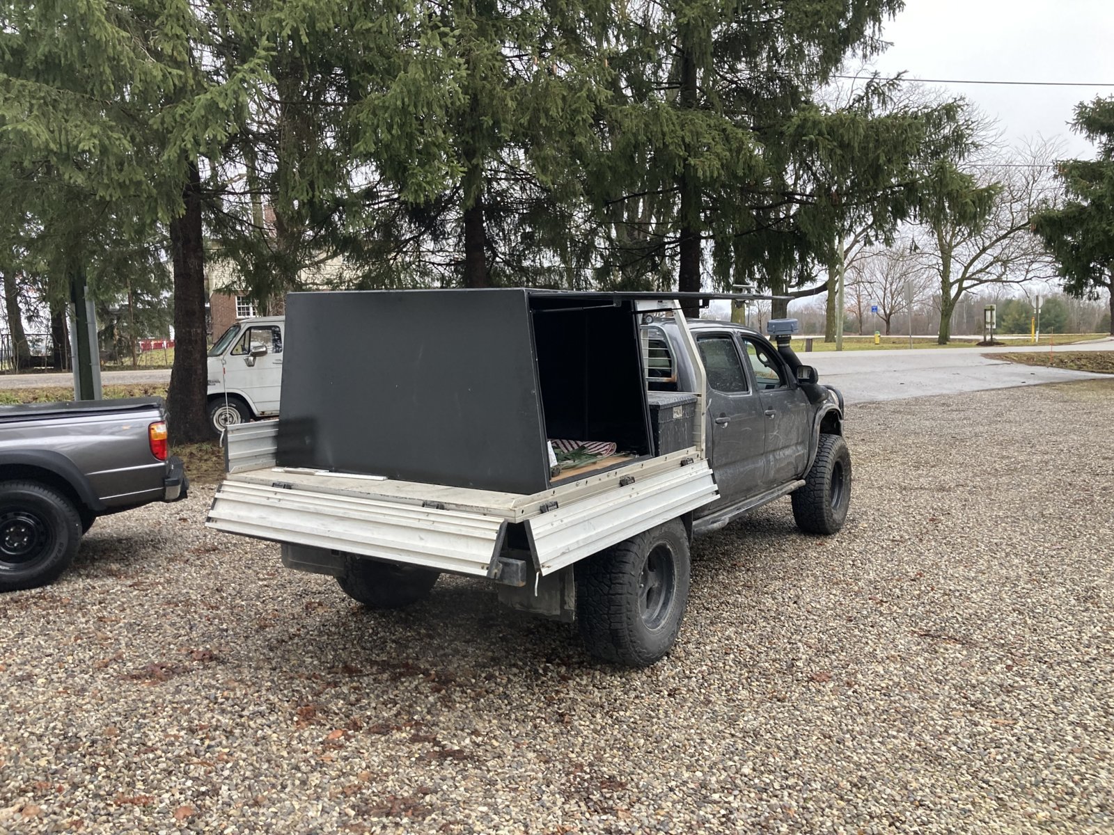

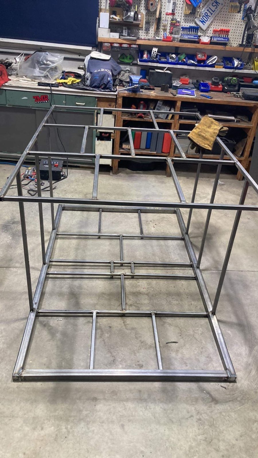

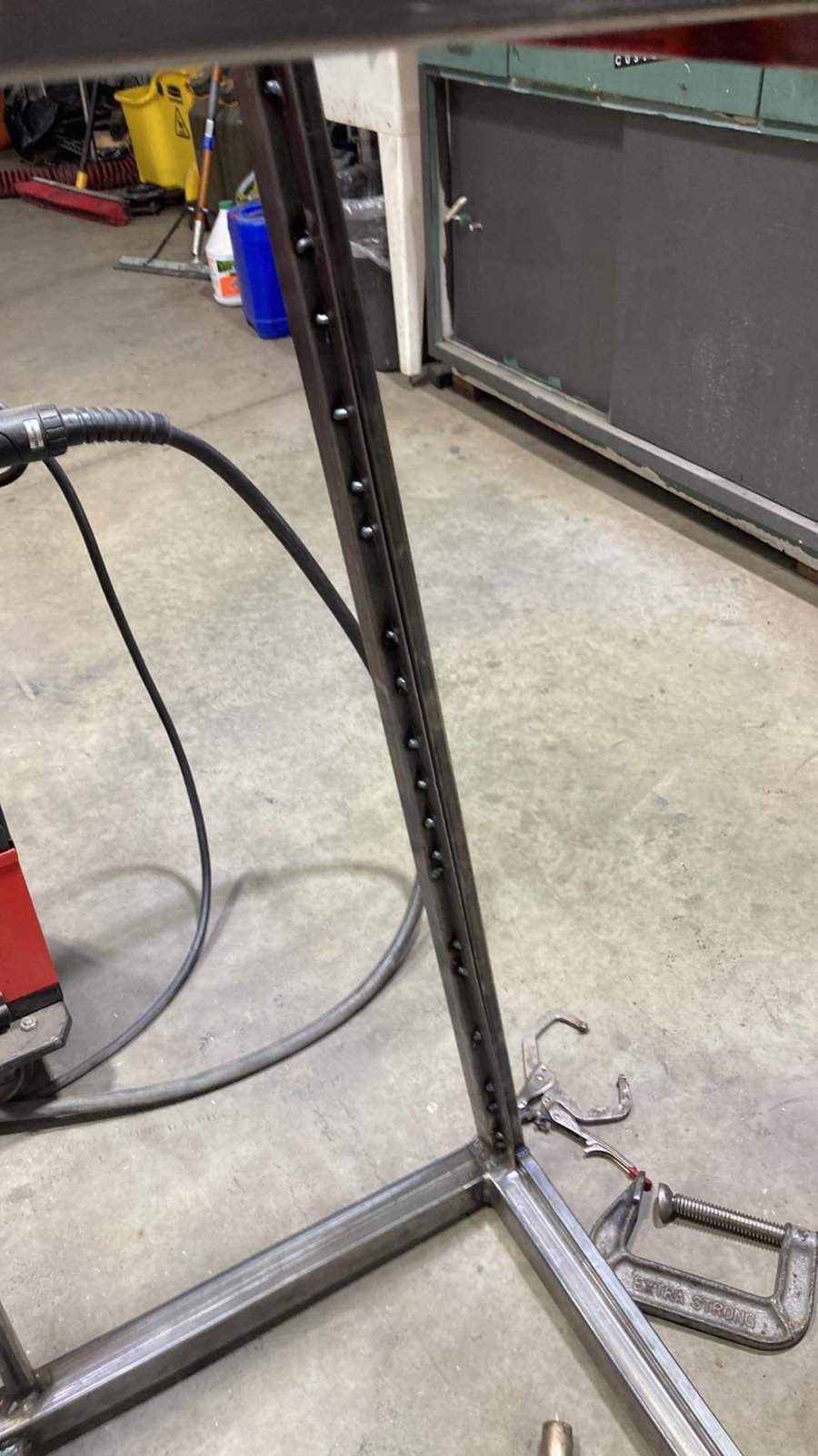

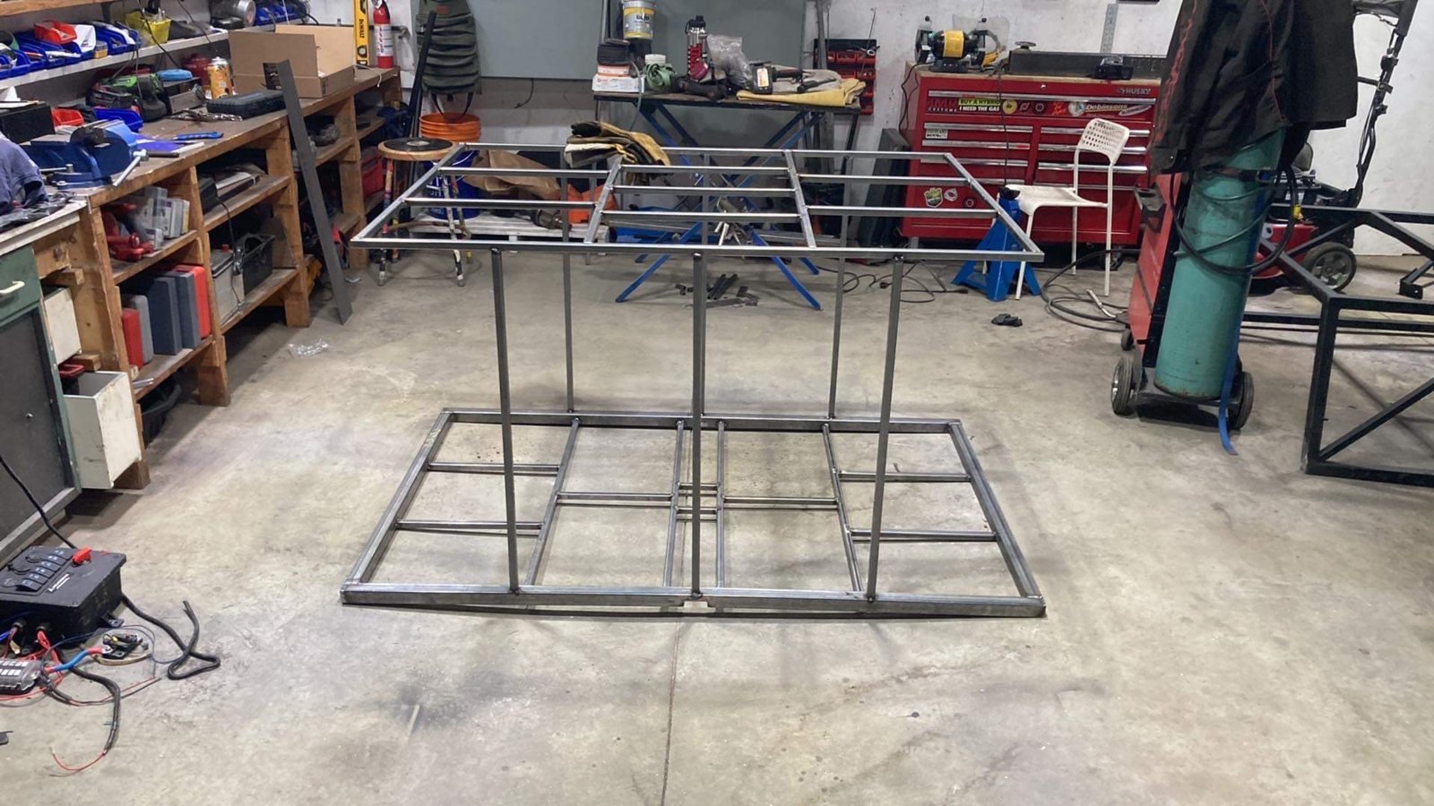

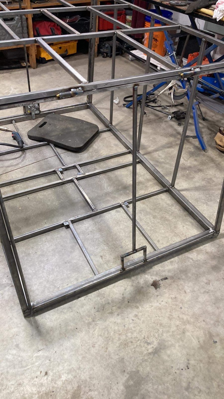

    Cap number 3 on this truck. After the first two caps, I wanted something that had a floor so it could be easily removable without jeopardizing the dust and water resistance of the box. Steel construction for strength and easy to repair. Wanted some space outside the cap for items that I didn’t want with my camping gear like garbage, wood, fluids and gas.
    used 1/8” for the main frame. Everything in the middle is thinner guage to save weight.
    70165405429__06A5C9B5-D1E9-44BC-94F2-100BB91BEB39.jpg IMG_8755.jpg IMG_8756.jpg
    I used bullet hinges from princess auto as they are strong and inexpensive. These aren’t the right use for them but so far so good.
    I tacked thin strips to create a drip edge and a seal surface for the door to mount against. It’s around the perimeter of the door opening
    this project was split up over many months so frame getting some good scale on it.
    Just used some rustoleam and a brush to paint this. Afterwards did a spray coat to get into the nooks and cranny’s.
    skinned the panel in aluminum composite panel. Was the best bang for the buck on a 4x8 sheet that was light and weather resistant.
    mom the picture below you can see the tool box which is mounted all the time. It houses my batteries, arb compressor and locker stuff. The cap buts up against it. The other side has my tire with enough room for a 5lbs propane tank and some other odds and ends.
    I have about 13” at the back for 5 gallon buckets which is great for trail cleanups. Still working or some details but after a weekend trip, gear was dry and nothing broke.
    Cap came in a bit heavier than I wanted at 190lbs. I used a 3/4 “ piece of wood for the floor that floats on some steel. That added the 35lbs which I wasn’t expecting. Heavy for what it is but it will be durable

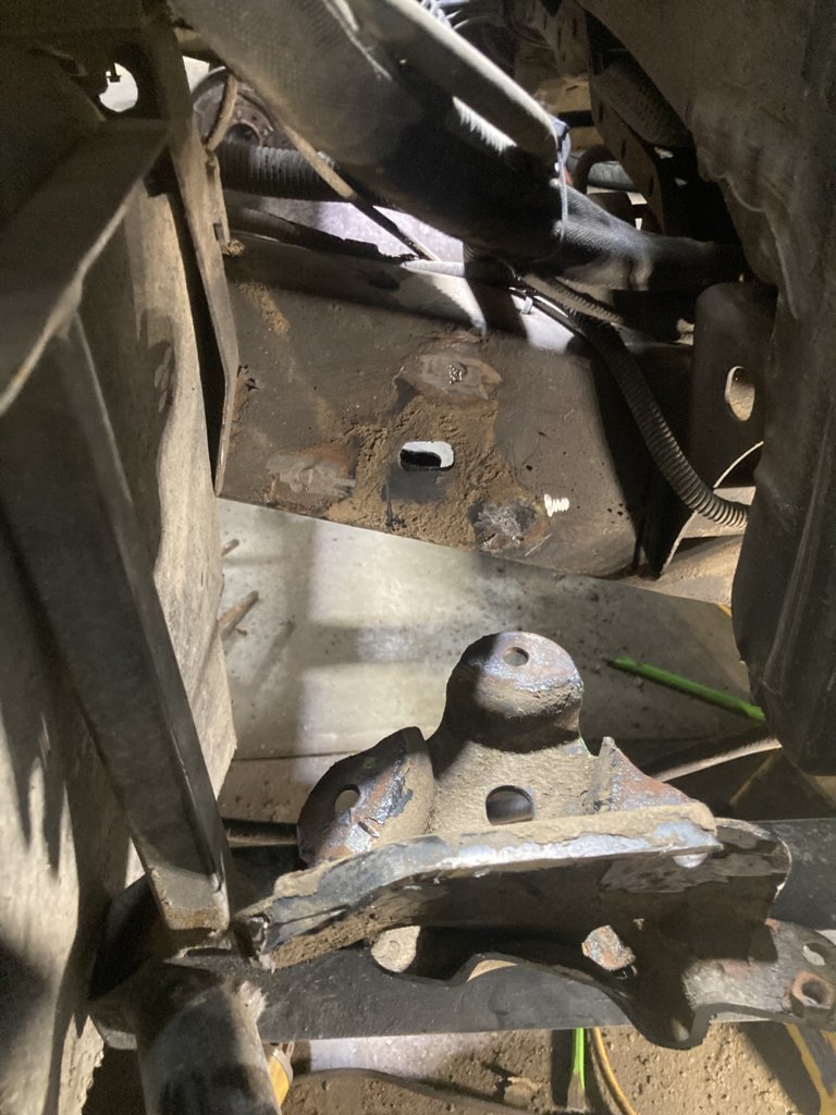

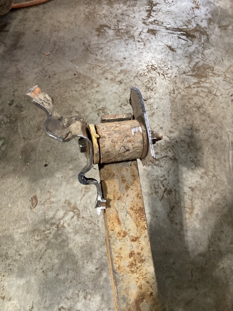

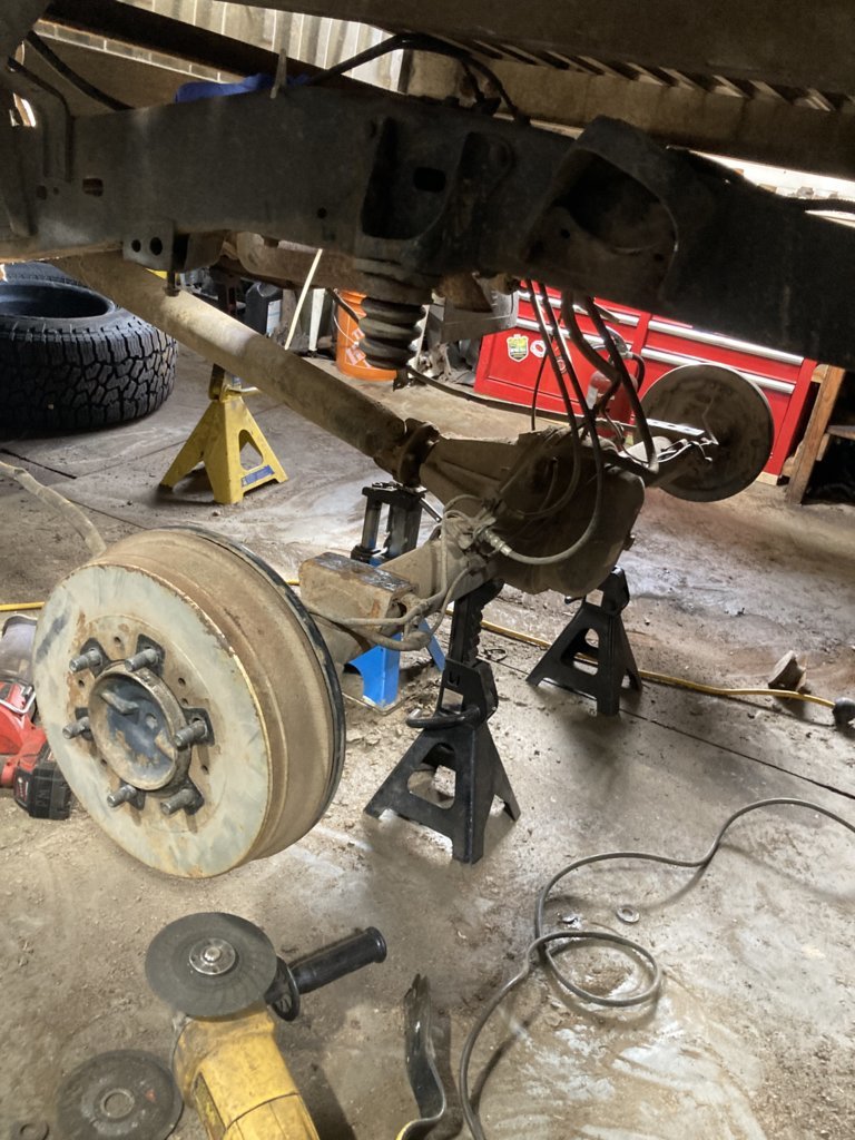

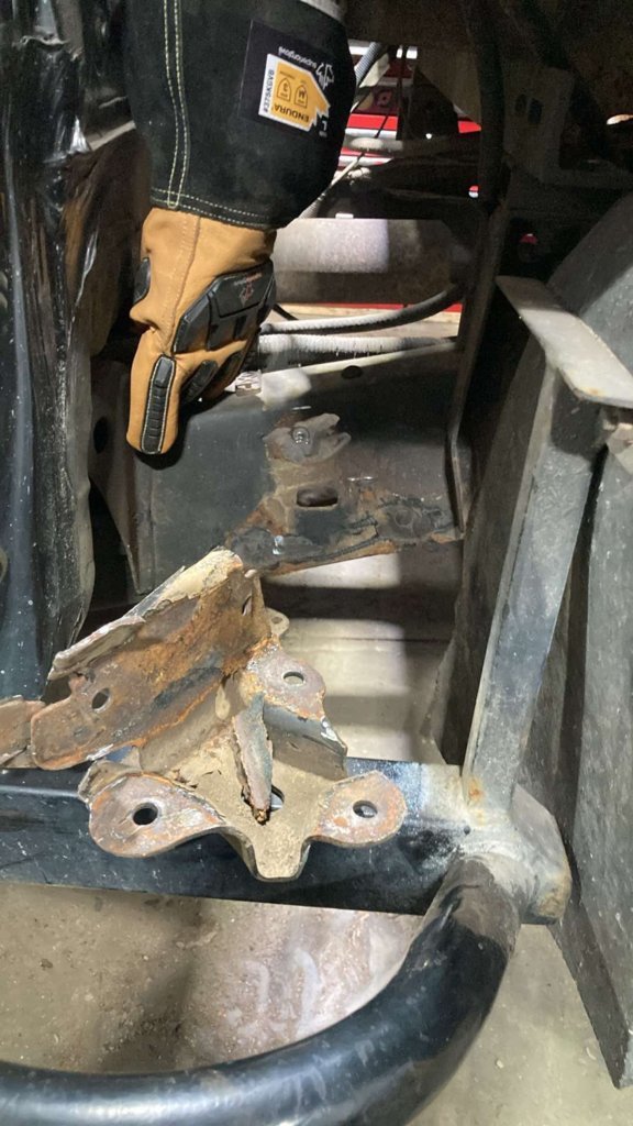

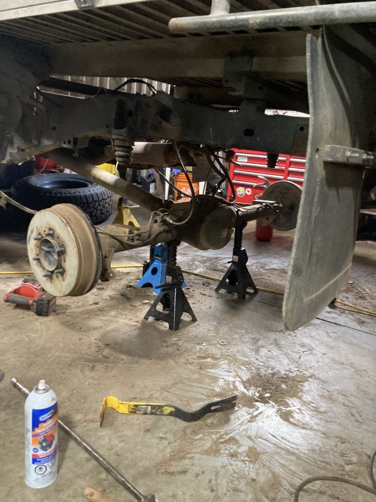

    Okay, in 2013/2014 I put the OME Dakars on, then added a leaf in 2015/2016, and redid the bushings and what not in 2017. That was the last time I touched the rear suspension other then adjusting bumps and what not.
    Today I removed everything in order to prepare for the Chevy 63 swap, and with the rear not being touched since 2017 it was a pain. Everything was hard to get out.
    how I left it
    had to cut the front hangers off anyways but still had to cut the bolts since the bolt was seized to the bushing
    I knew the bushings were done which is one of the reasons for the swap now.
    I’ll be using a mix of Barnes and Tmr parts to get the new leafs in. One of the shocks had to be cut out too so will figure out relocations which I have half the brackets for.

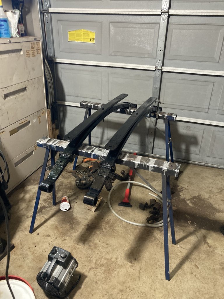

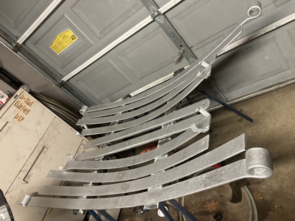

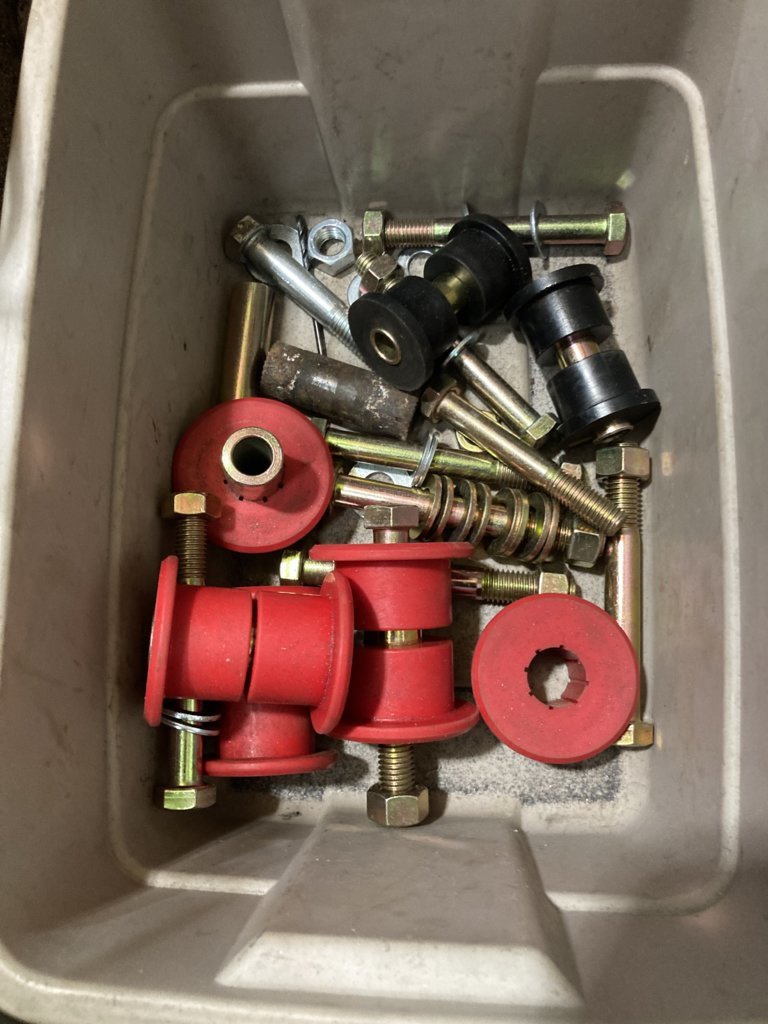

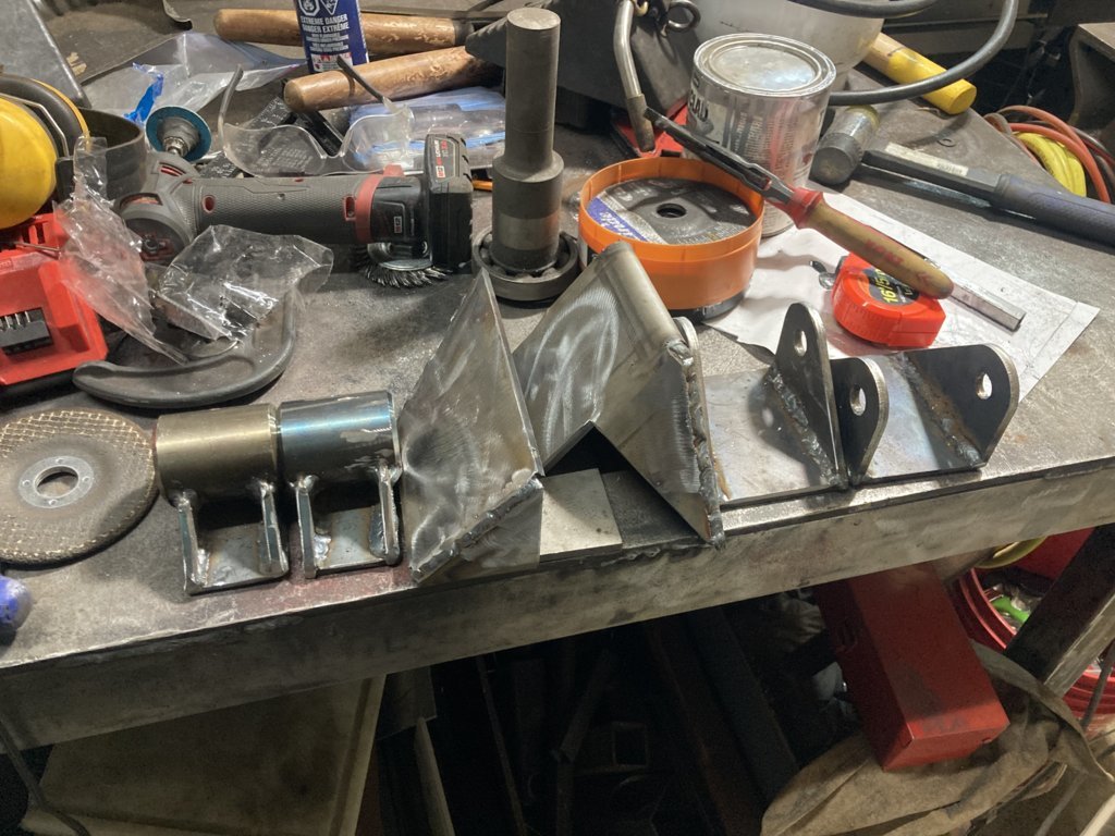

    Little more progress this week. Just got the leafs finally prepped, brackets welded and prepped and all the nuts and bolts sourced for mock up on Sunday.
    wired wheeled
    Two coats on some random paint I had.
    Assembled and painted black
    all grade 8 hardware. The grade 5 stuff was for welding.
    my mess of a work bench with some tabs if you look closely. Lots of projects at the house and now the truck. Need to find a day to clean up.

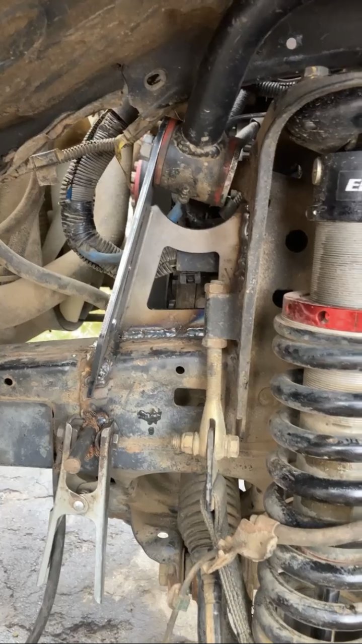

    Posted for shock relocation
    from tmrs site

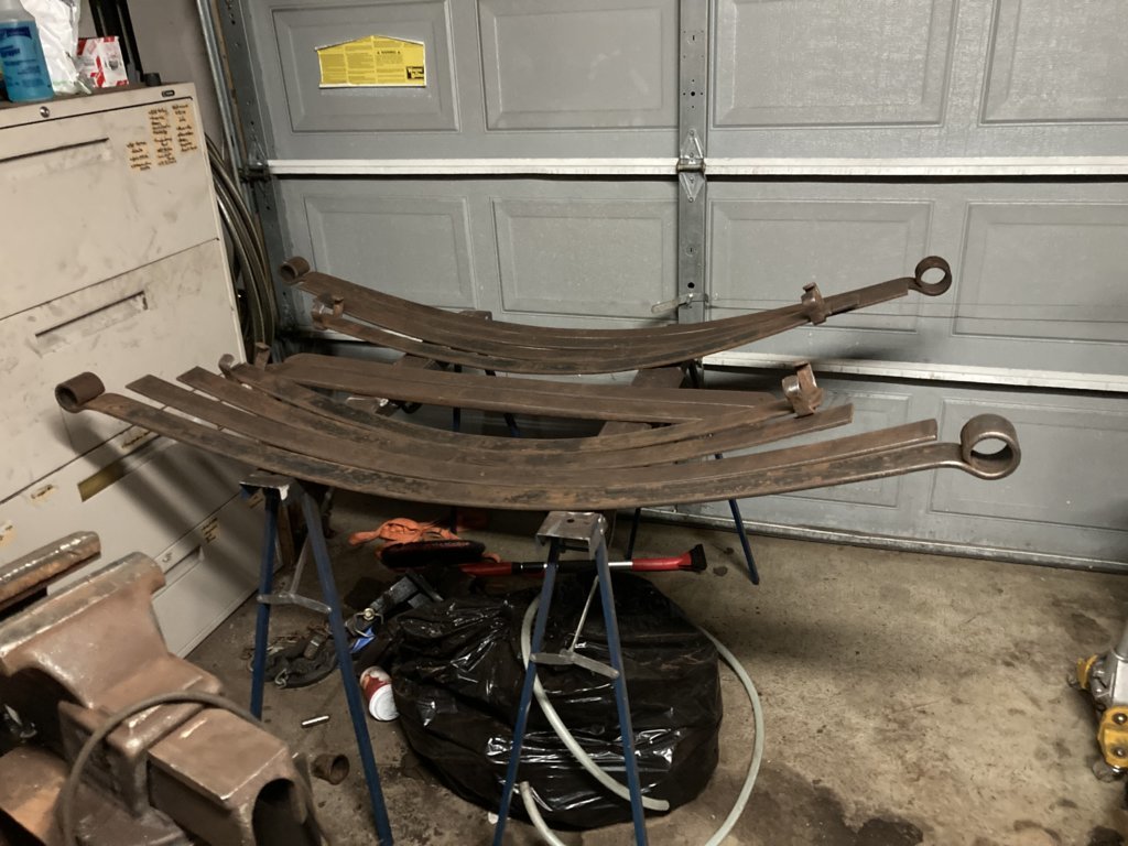

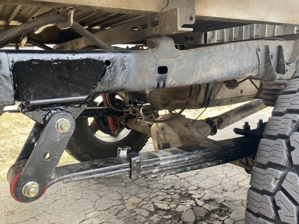

    trucks on Chevy 63’s out of a 2500hd Chevy truck. Got the leafs for free out of a salt truck our family friends had.

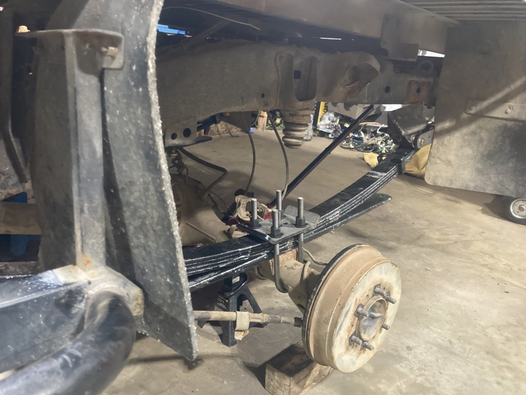

    started cleaning them up and paint with new bushings

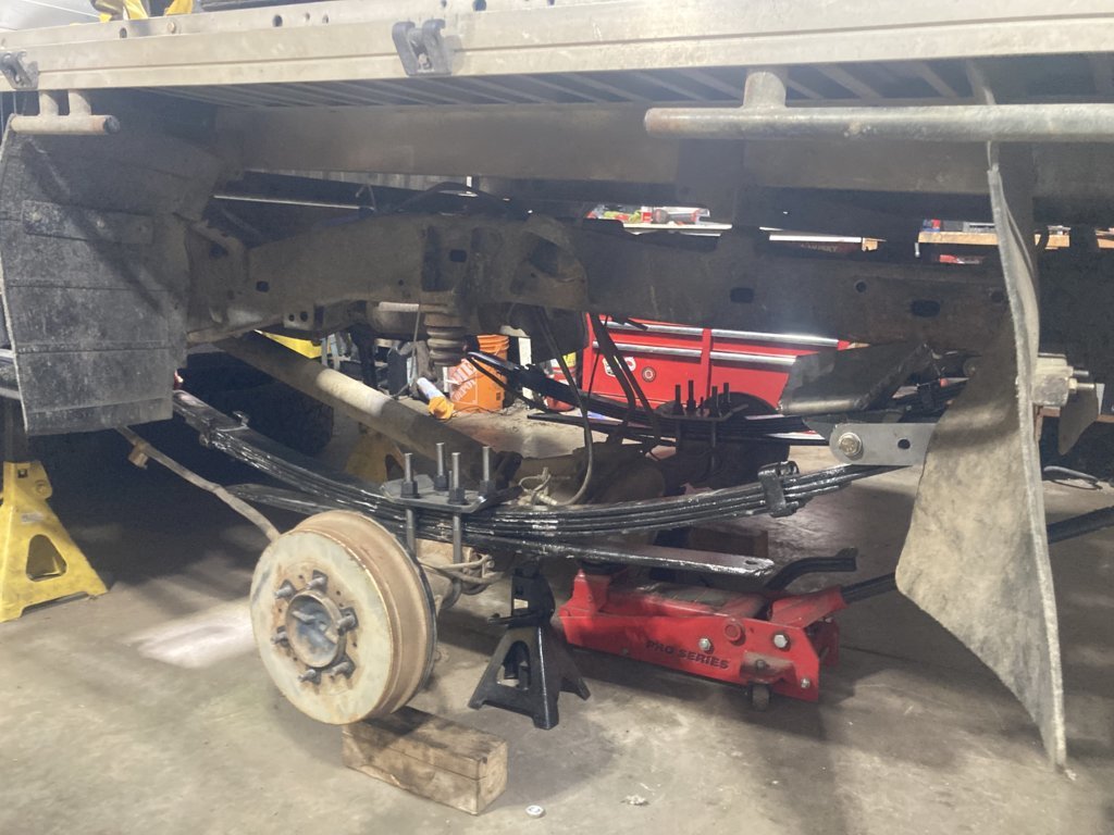

    then started to get the old stuff out. Last time I touched the rear end of the truck was close to 7 years ago. Needless to say stuff wasn’t coming out easily.

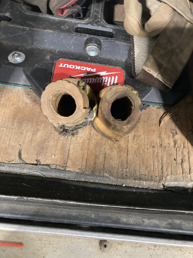

    just floating

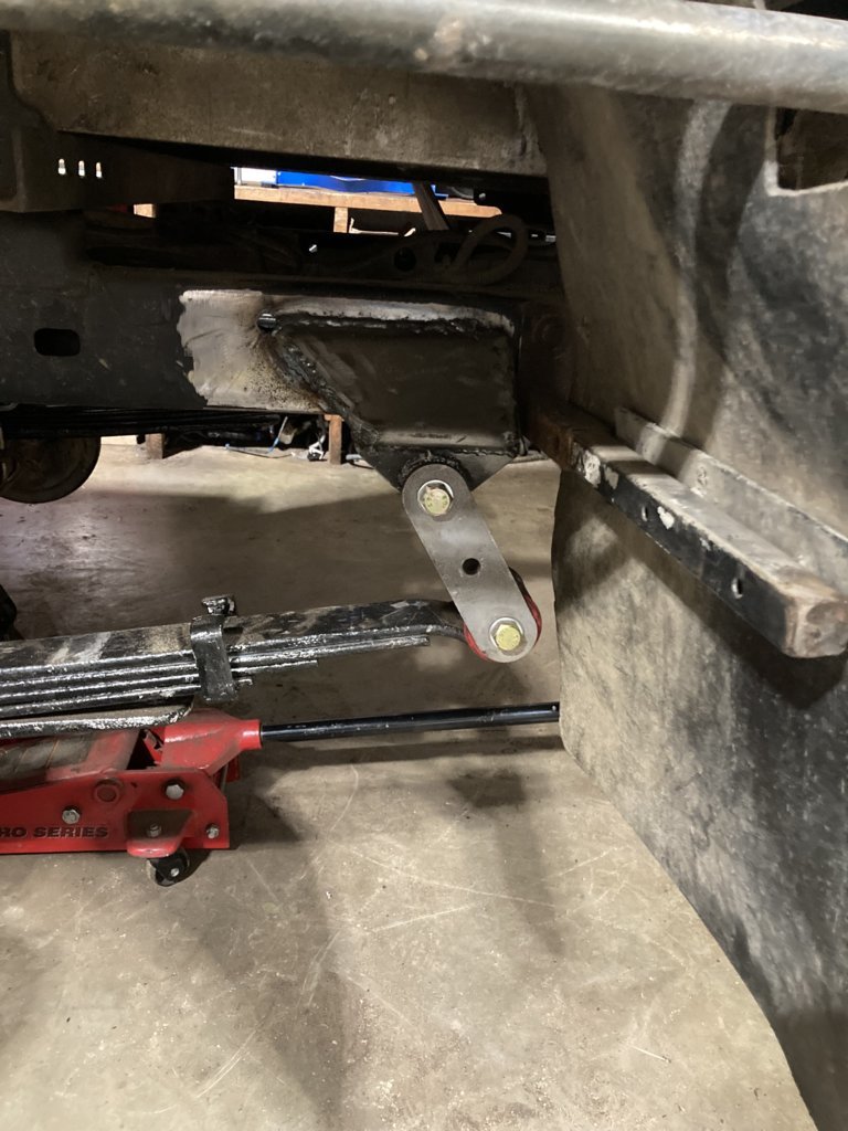

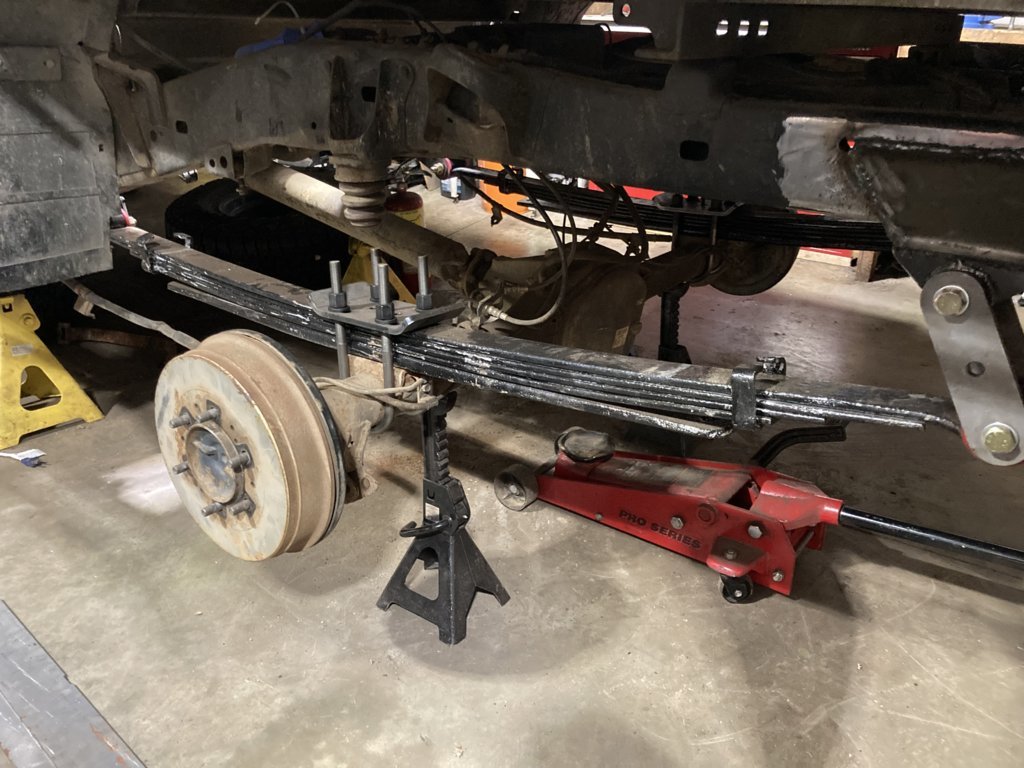

    mocked up the front hanger which took forever to make sure everything was square. IMG_0470.jpg IMG_0472.jpg
    Used the Barnes offset frame mount and everything else for the leafs are from Tmr customs (ubolt plates, front hanger)

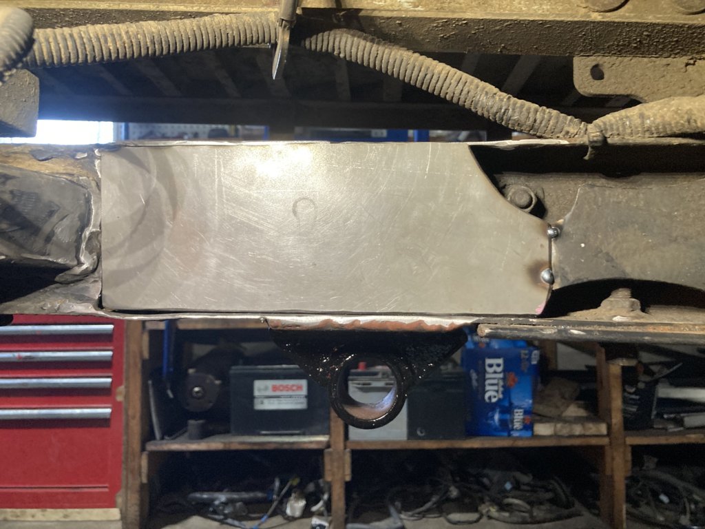

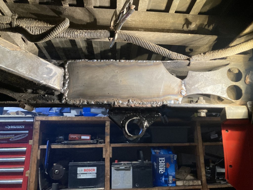

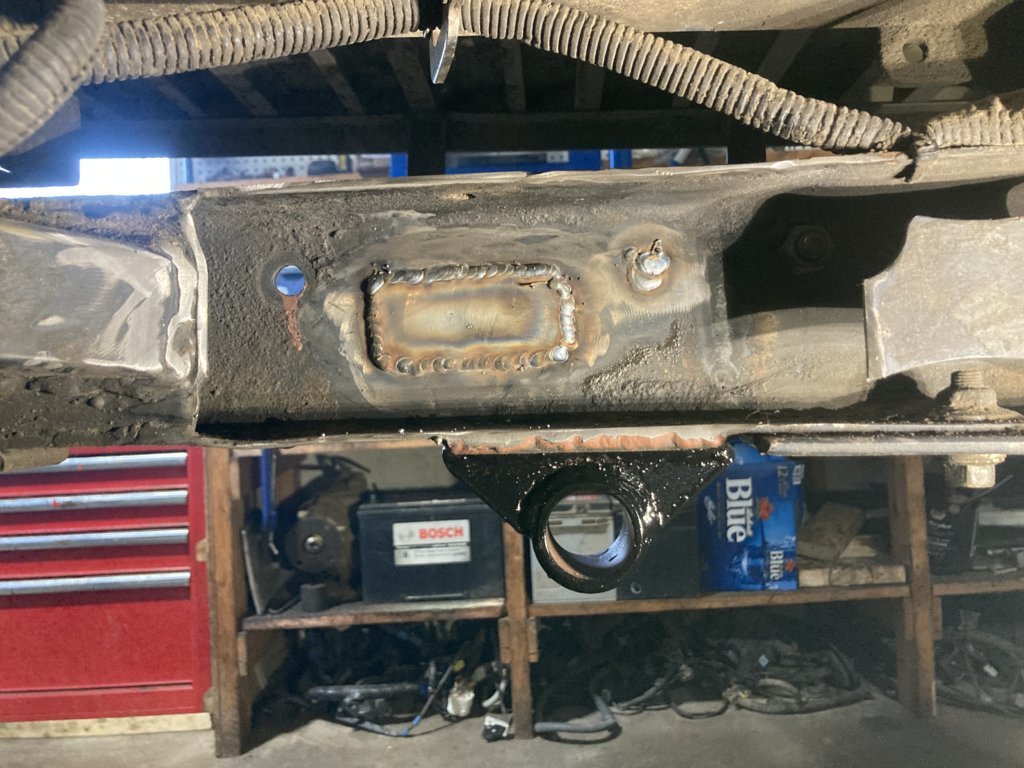

    Since I didn’t need to access the holes for the hangers anymore I plated them and then reboxed the frame.

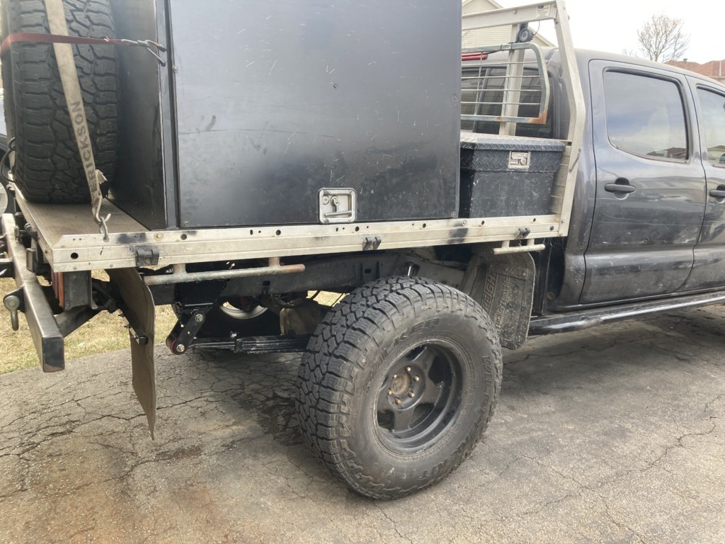

    Painted everything, reinstalled the gas tank.
    At this point I had to move the front hanger over a bit since the gas tank wouldn’t go in. Lovely. Worked out and everything’s still square. Was not fun though.
    back on its wheels and at home from @Norilsk warm shop.
    Still have to measure for bump shocks and see what my options are. Think I’ll be frenching in Tmr hangers that k have for 14” billisteins.
