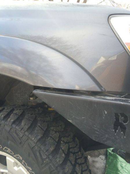

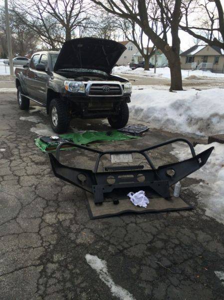

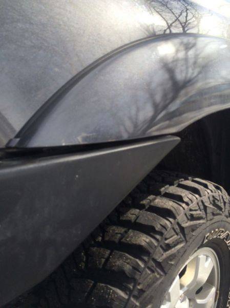

    Well I tried to readjust my front bumper today because I didn't think there was enough space between the fenders and the bumper. Well, 3 hours later and I don't feel like I did anything except tire myself out. Ill post some pics, and maybe someone has an idea of what I can do.
    Driver side before
    Driver side after
    Passenger side before
    Passenger side after
    Wish I had my garage back at home. I must have had the bumper on and off at least 5 times, and I don't think I did much. Time will tell as paint will rub off where ever it rubs.

    Yea group buys are killing me too! lol Just looking at those pics of your bumper there Peter and I'm willing to bet you'll definitely be rubbing off road. As soon as the truck starts really articulating that bumper will push up on the corners and snap the clips holding the flares on. Happened to my truck with the allpro as well. Did you try inserting a washer on each side on the bottom bolt to help push the bumper out and get it a little more straighter?

    Yeah it will rub, its already starting to just drivimg on the road. I did try putting washers on the bottom, of the 3 main bolts, but im going to have to try again. I was cold and getting a little frustrated/tired so my patience for lining up stuff wasnt the best haha. Ill try again when weather/school isnt as crazy. Thanks for the tip: :thumbsup:

    Well took another crack at it today, and its as good as its going to get for now, atleast it wont rub while driving for fack sake. haha. I also bought ome more washers and put them over the 3 main bolts, and 2 on the bottom cross member, since I didn't have enough before.
    I have a little over 1/2" driver side, and about 5/8" on the passenger.
    driver=better
    passenger
    Overall
    And to make sure I wouldn't rub too much while flexing.....:cool:
    more like :anonymous: but had to make sure. When flexing I has as much room as I did prior to adjusting. It will do lol. Now I can finally focus on my work haha.

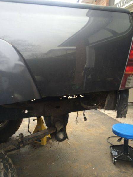

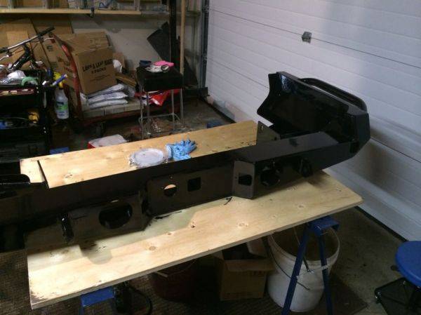

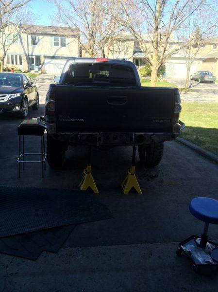

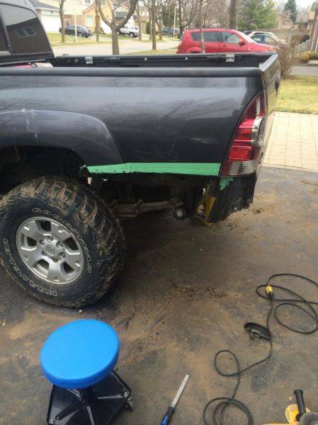

    So this summer I got a lot done. Started off by getting started on the rear bumper install as soon as I got home
    Masking off
    No return
    Kinda straight. Not to bad with a grinder and a shaky hand
    Other side
    Mock up

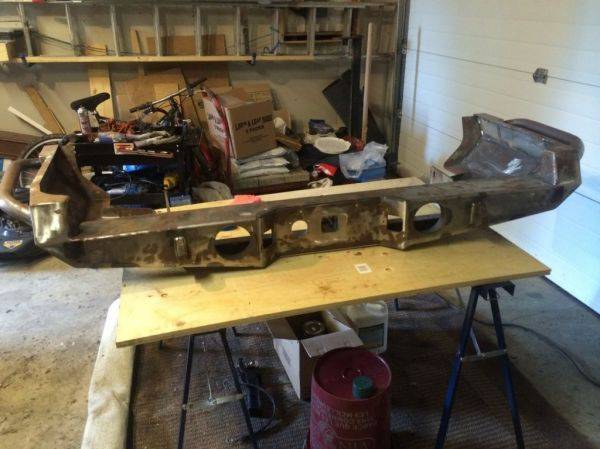

    Here I prepped the bumper with marine clean and metal ready from por15. The metal ready leaves a dust like residue on the bumper. I talked to a body shop guy later on and he mentioned it might have been some kind of solfate that promotes paint adhesion.
    4osh coats of Por then 5 of tremclad spray paint.
    Drove around like this for a couple weeks while I was painting. Was only able to work on projects on the weekends.

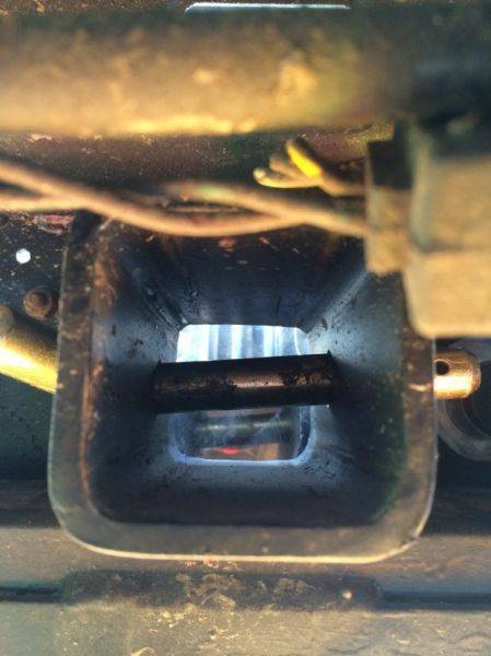

    Bumper went on, and prior to install I made sure a hitch would fit in the receiver. Well, that was an issue so after fileing the receiver down to allow for a hitch to slide in smoothly I was laughing. I figured once the paint went on it would snug up a bit. First time I put a pintle hitch on it went on smoothly and all was good. Then went to put the pin in and this happened.
    So pissed about that as I couldn't put a hitch on the bumper since the hole should be straight. Anyways, after a couple passes with a dremel I finally could got the hitch on and proceeded to test it.
    The bumper kinda tilted due to the tongue weight. Have to fix that still

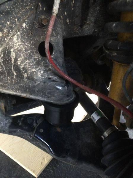

    Got my front super bumps mounted as well

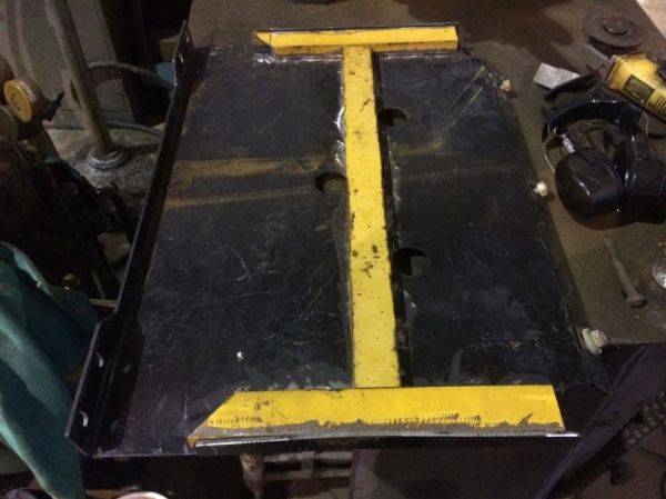

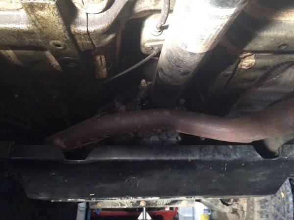

    Worked on my trans skid and reinforced it with some channel

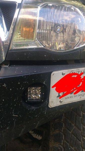

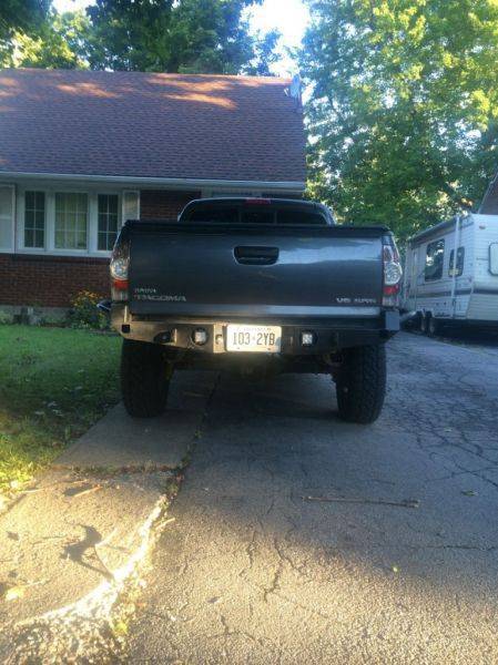

    installed my dually amber fogs, as well as mounted my incense plate. Took 4 months to permanently mount my license plate. Terrible
    Rear backup duallys. These are diffused lens and they are awaken for backups

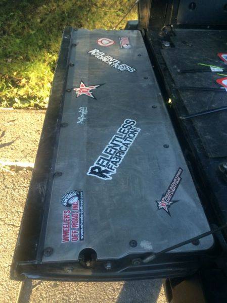

    Installed my tailgate reinforcement plate

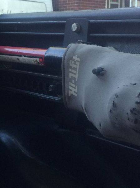

    More tie downs. Added 3 per side on the bed bolts.

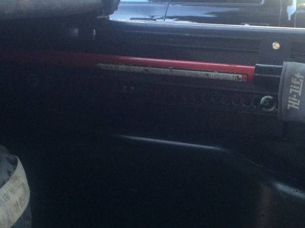

    Made some hi-lift mounts. Pretty much the same as relentlessness and ato's

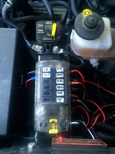

    And wiring. I just tried to make the wiring more efficient. Instead of 8 grounds I tried to have one common ground and soldered everything together. Also, i daisy chained all the grounds for the relays, which are now mounted on the side of the panel. I still have to put loom around the loose wires you see on the side of the fuse panel.

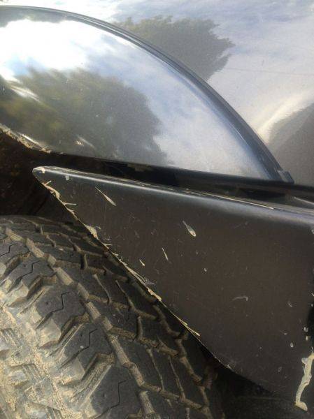

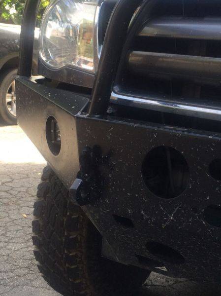

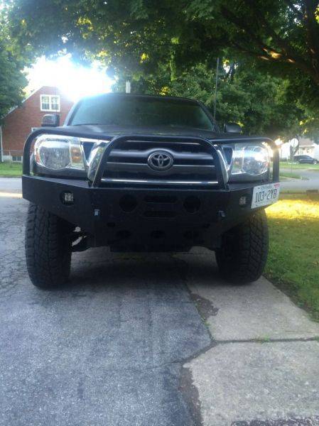

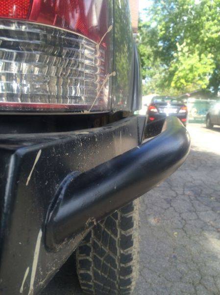

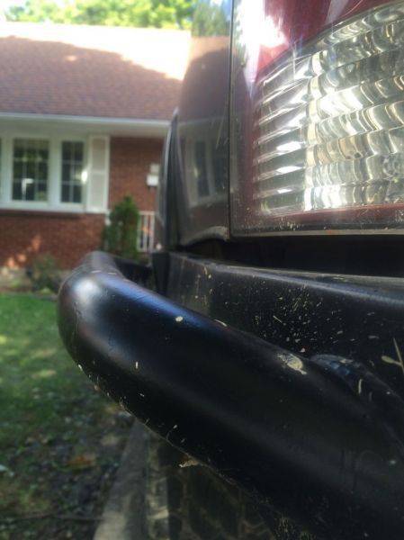

    My rear bumper shifted while I was towing a trailer in the summer. Well today I re-adjusted the rear bumper, since it was rubbing on the bedsides since.
    Can kinda see how it was in this pic:
    Gaps much better.
    Passenger side:
    Driver side:
    I tightened the shit out of it, so hopefully it wont move when I have a load on or pulling someone out. Btw I know my cuts are haggard. They look good from far I promise.
    I still have to figure out the front bumper since its still rubbing during daily driving. Not bad, but once the truck gets flexed out on the trails, my fenders will hate me.
    Driver:
    Passenger=tons of room:
    Gaps I Have below the grill.
    I have to figure out how to get more gaps between the wings and the fender, without having to shim it. Right now the mounting face of the bumper isn't sitting flat against the cross member. I think I may have to make the mounting holes on the bumper bigger like PSUTaco85 suggested (thanks btw).

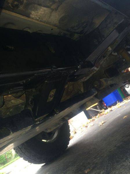

    Well while I was on reading week I got a bunch of little maintenance stuff that I have been putting off.
    From my list in the op.
    -finish cleaning up electrical-->split loom loose wires.
    -re-adjust front bumper
    -Remove Transfer case splash guard to be able to get grease fitting with skids on
    -Front brakes-EBC slotted rotors and green stuff pads?
    -wire 2 switches below hvac
    -re-paint sliders/frame, touch up wherever else

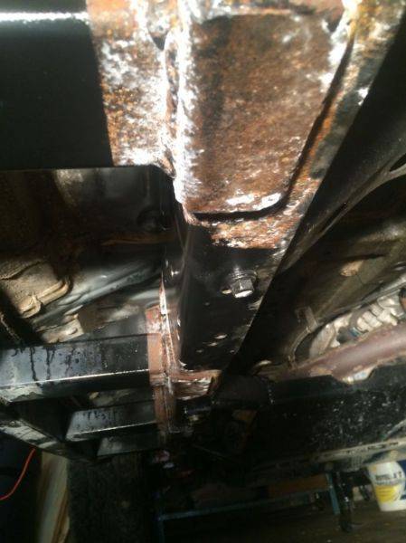

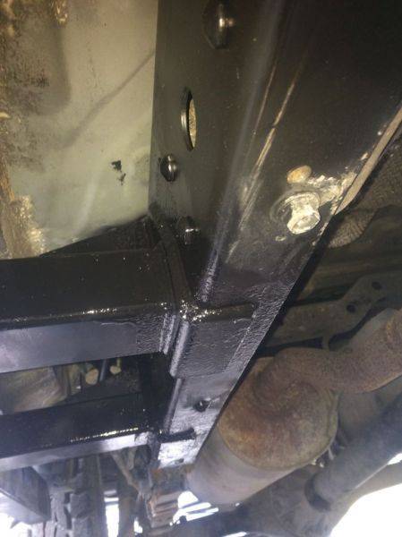

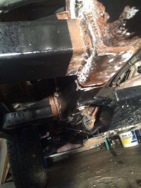

    When I got the sliders burned on, I wasn't able to properly paint them afterwards.Well before winter came around I gave them the por15 treatment. Took me a year to have time to get to this. Was a easy job but a real pita doing it on your back.
    Before
    You can see a white substance on the rust which is from the metal ready from por15. Those pictures were taken after degreasing with marine clean, and metal ready. Longest part of the job.
    After

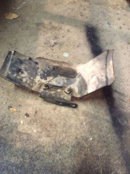

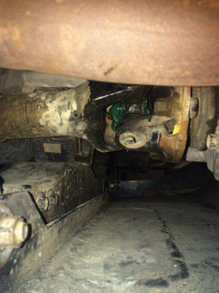

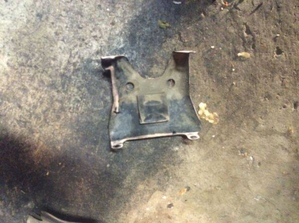

    Also some other little things like removing my transfer case skid and clearance it a bit more for my exhaust crossover. Cut my skid a bit more on the left.
    While that was off, removed some stock skids to give me a bit more room to grease the driveline and clearance skids.
    Allowed me to get to this grease fitting without taking off the t-case skid every time.
    Other than that, just did a oil change and tire rotation. Really looking forward to snow though. Plan on going to my uncles property to plow through some snow and test the tires. That's on the next break though.
