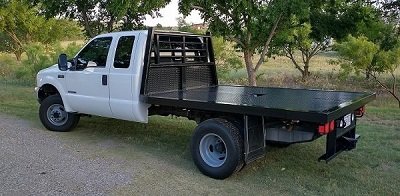

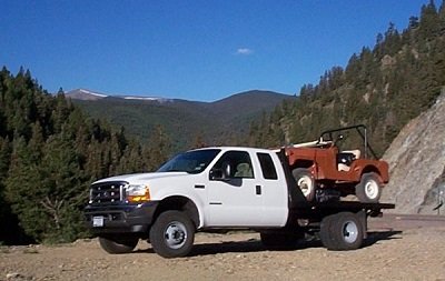

    I've built a few flatbeds. This relatively plain one weighs 1520lbs:
    (it was "overbuilt" a bit to allow it to carry short wheelbase vehicles)

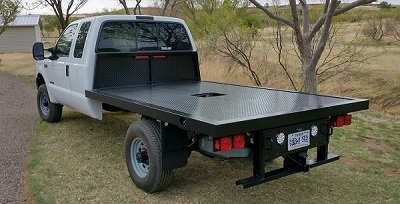

    I built a smaller, lighter bed for a SRW truck with the goal of reducing weight and ended up with this:
    This smaller/lighter bed removes most of the headache rack and much of the internal structure is removed or replaced with lighter members. After all that, this bed is 920lbs. Yes, these beds are for full sized trucks, and it would certainly be possible to halve (or more) the weight of these beds when building for a Tacoma, but even at that, know that every handy feature will add weight at a rate that might surprise you.
    I would suggest that you use 14ga square tubing whenever possible and avoid channel iron and angle iron. The tread/floor plate for the deck is also very heavy. You might consider a wood deck or if steel is a must have, 14ga tread/floor plate is available if you seek it out.
    Best of luck, and be sure to share a pic of your bed when done!
