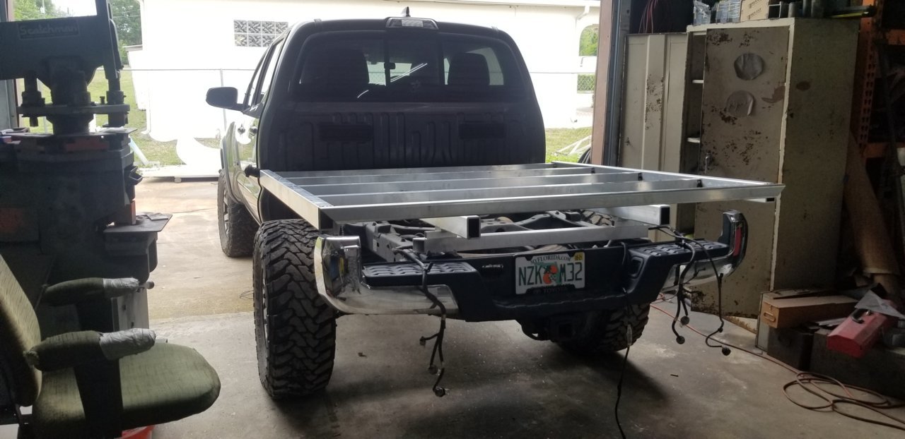

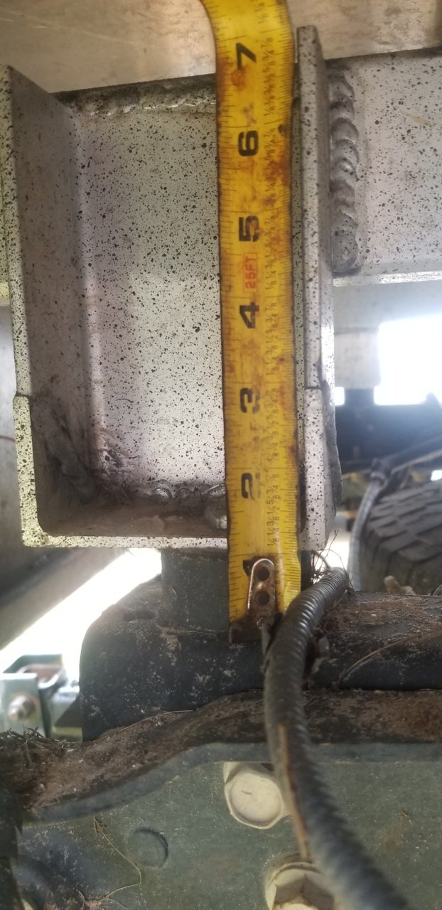

    Some pics from the build if interested. I used 2x3 3/16 wall for the inner beams and sides. Above that is 2x2 3/16 wall for the cross members and rear. I used regular square tubing for cross members, but chose architectural tubing for sides and rear for a softer edge.
    After installing the flatbed, I checked tire clearance and needed to but 1" spacers to lift it, as well as shim the bomb stops 3/4" to stop rubbing. I have 295/70/17 on 4runner wheels. I will be removing it in the summer to extend the mounts and possibly reducing the hight of the rear. I like the flatbed at this hight, it's the best for offroad or traveling with the family.
    Phoosa, Oldasmud, jpereira2 and 2 others like this.

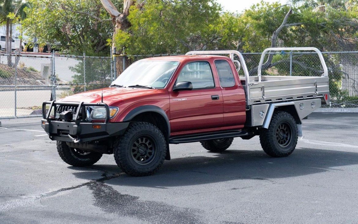

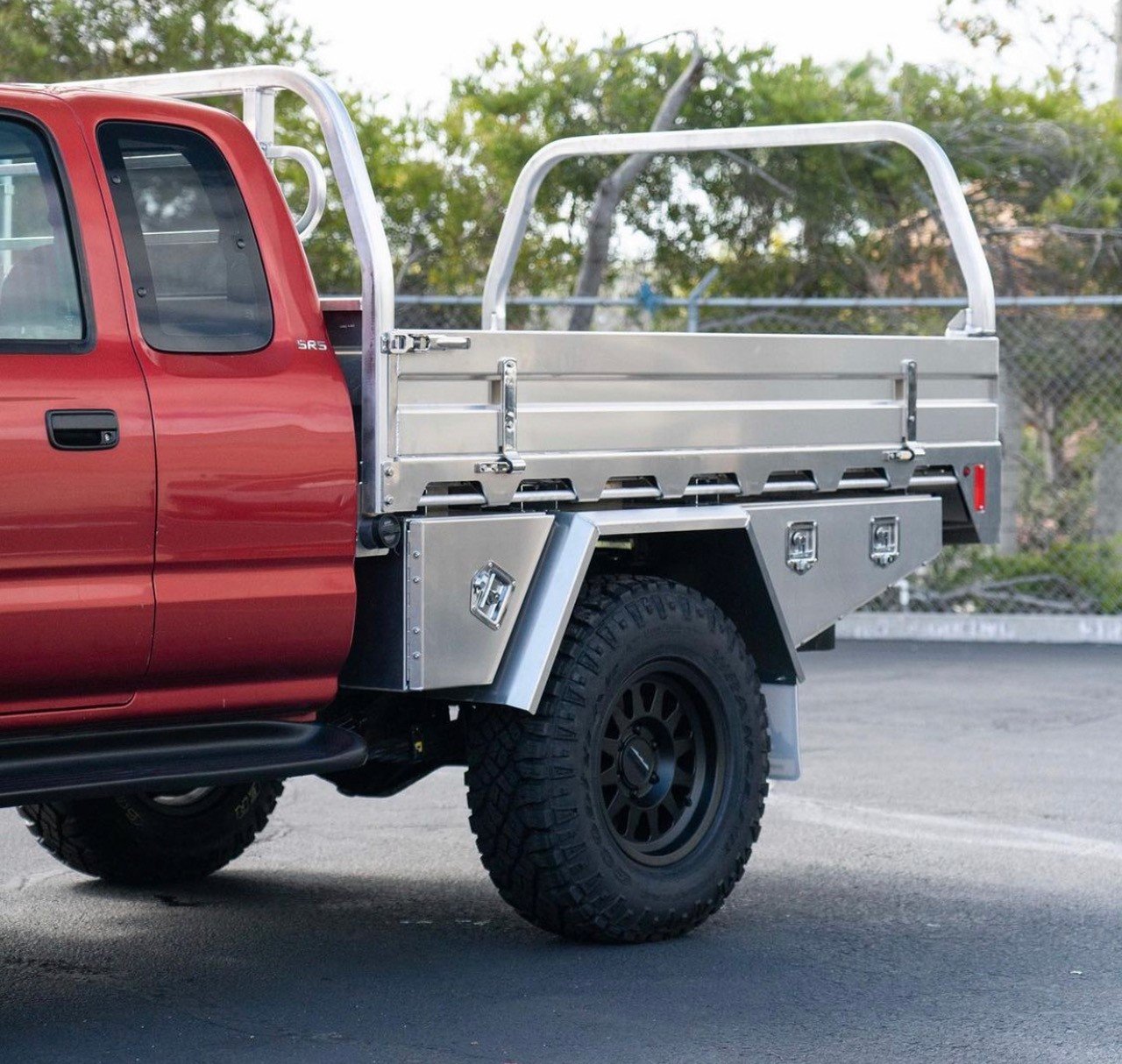

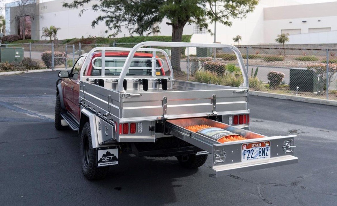

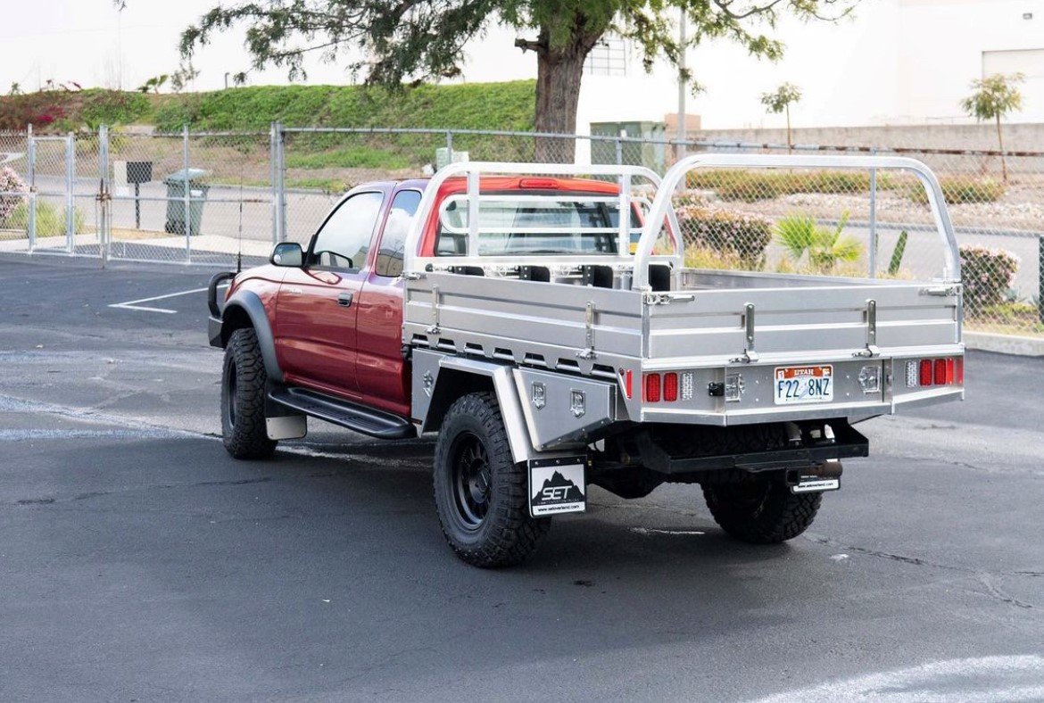

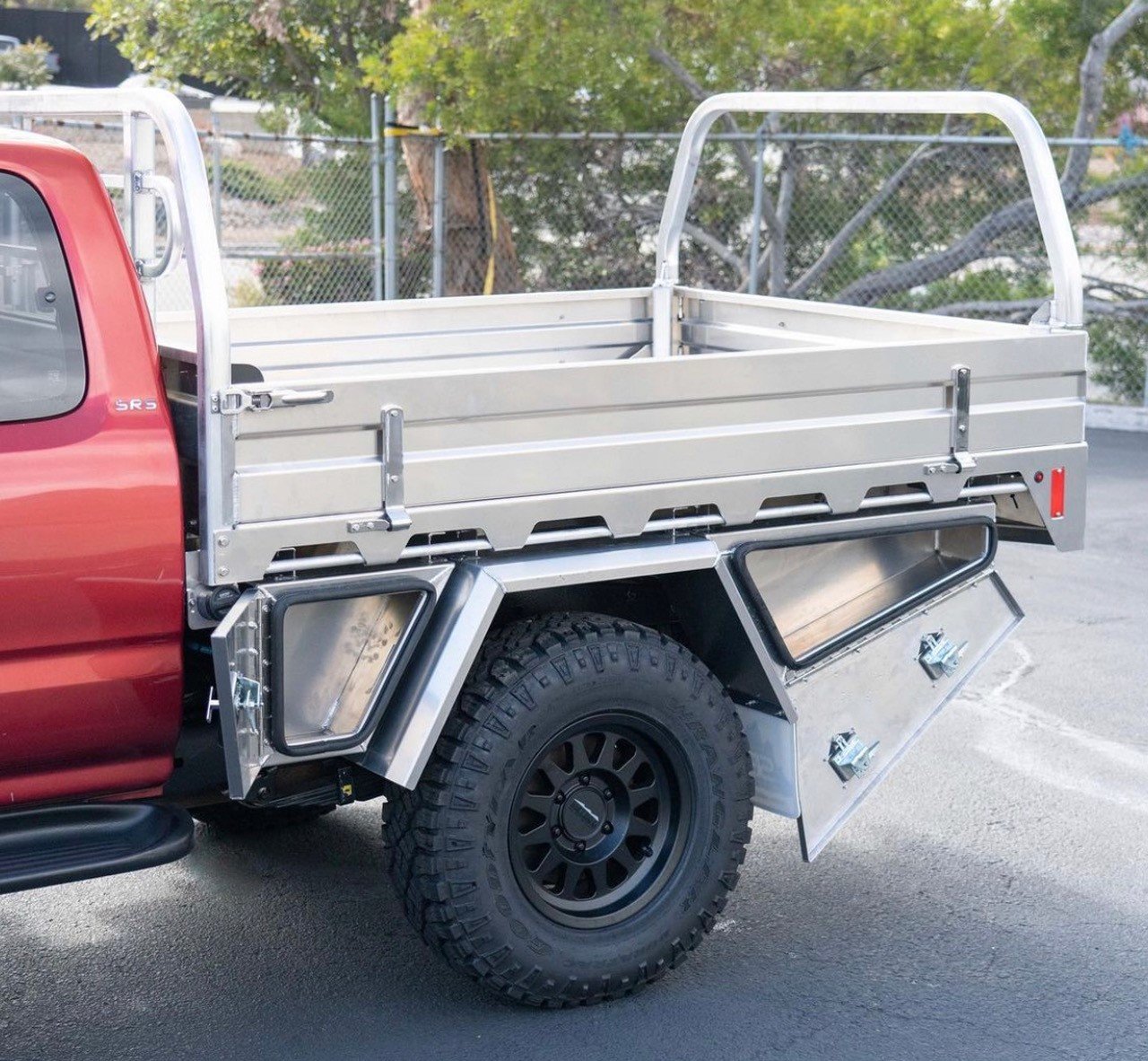

    I know we mostly see 2nd & 3rd generation Tacoma's in this thread, but check out what we offer for the First Gen Trucks!
    Summit Expedition Trucks is proud to manufacture a high quality flatbed option for the smaller First Generation models. Looking forward to doing a double cab short box later this year!
    This one is equipped with the following options;
    • 84" Tray (66" wide)
    • 66" Wide Headboard
    • Side Gate Kit
    • Ladder Rack
    • Front & Rear Underbody Tool Boxes
    • 48" Rear Pull-Out Drawer
    • 33" Clearance Fenders
    Additionally, we included a full plug and play wiring harness so the customer can always go back to his factory box without any rewiring! This is a standard feature with all of our products!
    SUMMIT EXPEDITION TRUCKS TACOMA TOYOTA 7FT 84 FLATBED UTE TRAY FIRST GENERATION 1.jpg SUMMIT EXPEDITION TRUCKS TACOMA TOYOTA 7FT 84 FLATBED UTE TRAY FIRST GENERATION 2.jpg SUMMIT EXPEDITION TRUCKS TACOMA TOYOTA 7FT 84 FLATBED UTE TRAY FIRST GENERATION 3.jpg SUMMIT EXPEDITION TRUCKS TACOMA TOYOTA 7FT 84 FLATBED UTE TRAY FIRST GENERATION 4.jpg SUMMIT EXPEDITION TRUCKS TACOMA TOYOTA 7FT 84 FLATBED UTE TRAY FIRST GENERATION 5.jpg
    DarkWoods04, TRD_IV, Shveet and 8 others like this.

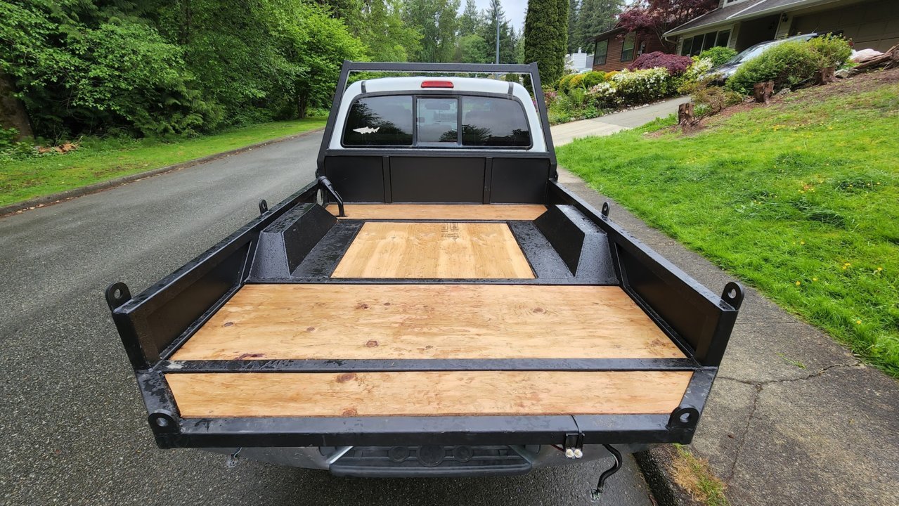

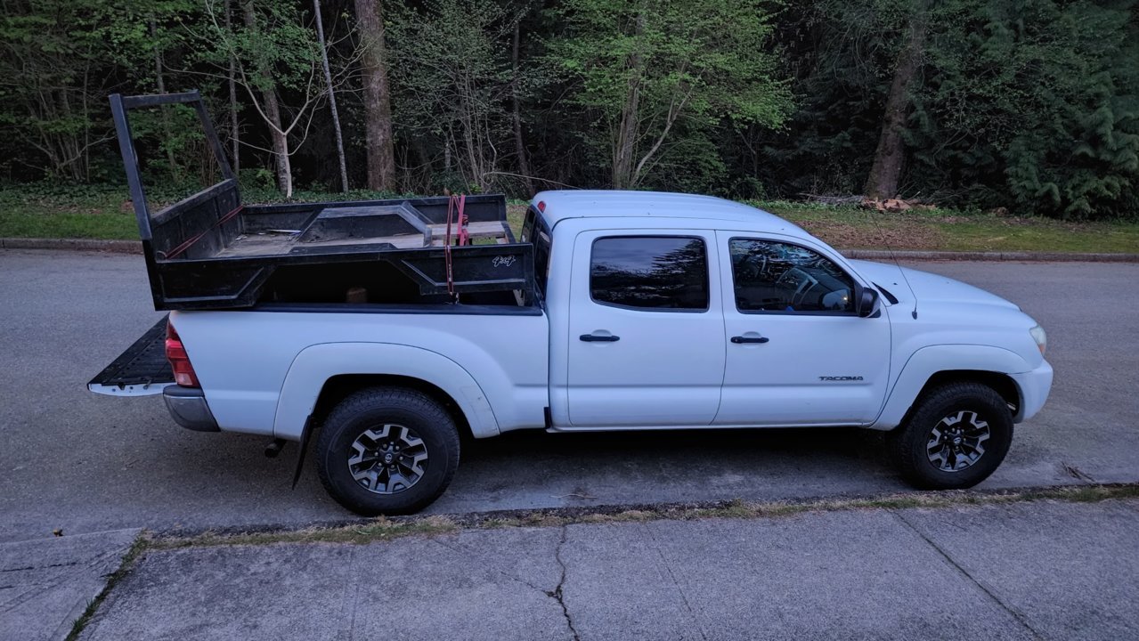

    Never thought I'd own a truck, and definitely would never imagine converting the bed so soon after getting it.
    q78KFJ7kZ5RgxUicARiPhOWbr0fj-7RqDBH5iJdt_4cfb8fb5774f03e568a9a07d6f241ec5ba2f0f3d.jpg
    Not sure how we managed to move the bed with just a few wimpy people.
    caTJbQEvBMCbj-2qJkcKKdDZDbogQVMcPZOOS-lS_b2f19ca7bf6d9b85b522442182bf2aa929a2f37a.jpg
    Looks better but still not quite right. I should check the instruction manual.
    IYuCY28uXRgesNeh7QEsrMh6SKyFluvI_GB--QXK_033429dd441d333cf2f0e4c2aae0b0a8baa9f20d.jpg
    Test fitting the plywood deck. I've it made to accept 1" decking as I would like to use some marine grade aluminum decking in the future. Still need to figure out the fuel filler neck and install proper taillights.
