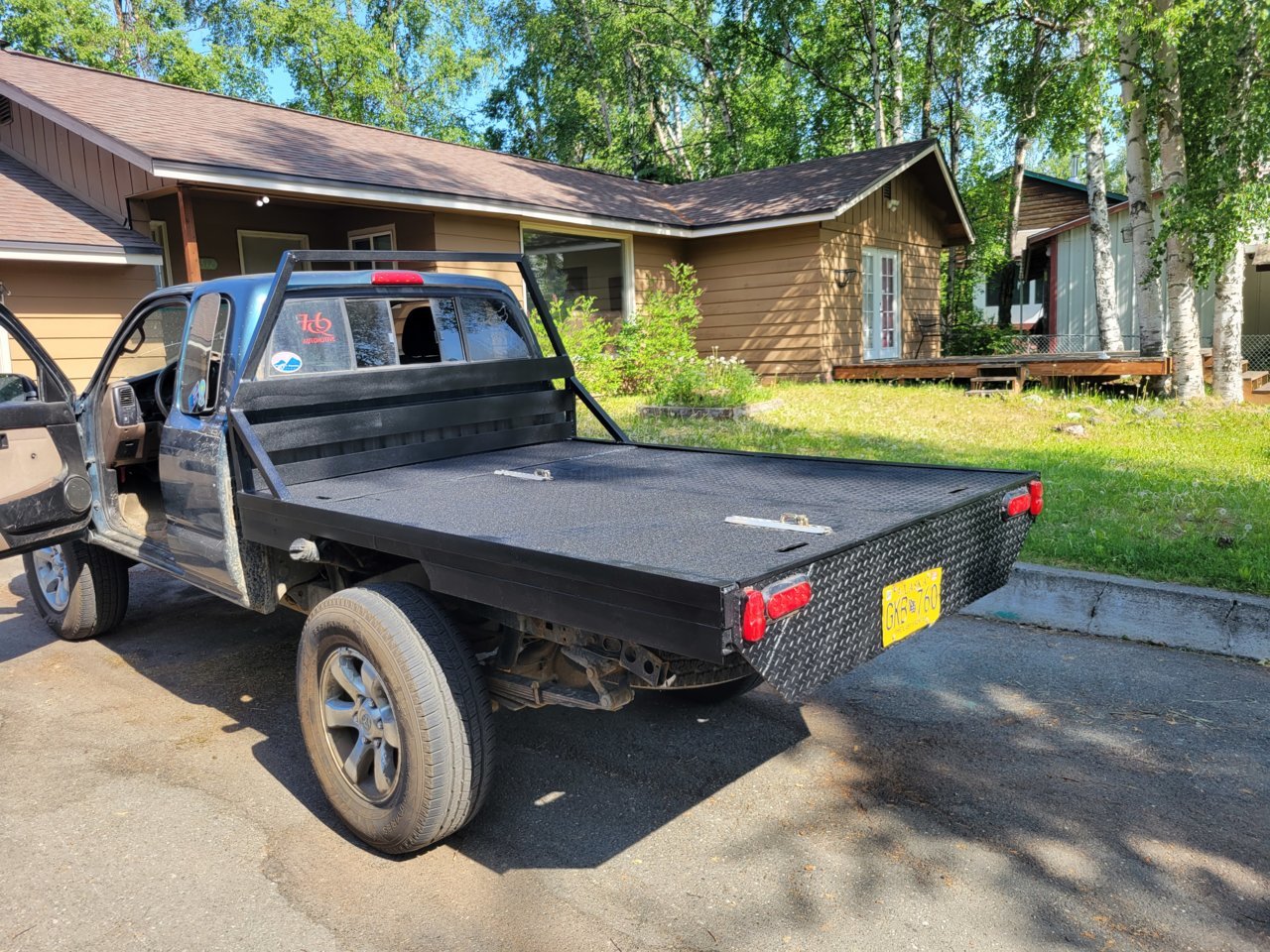

    Ive been waiting a long time to make this post. Time to whip it out. Rolled it, did a cab swap and finally finished my flatbed. Almost a year to the day from when i rolled it, shes finally looking good again.

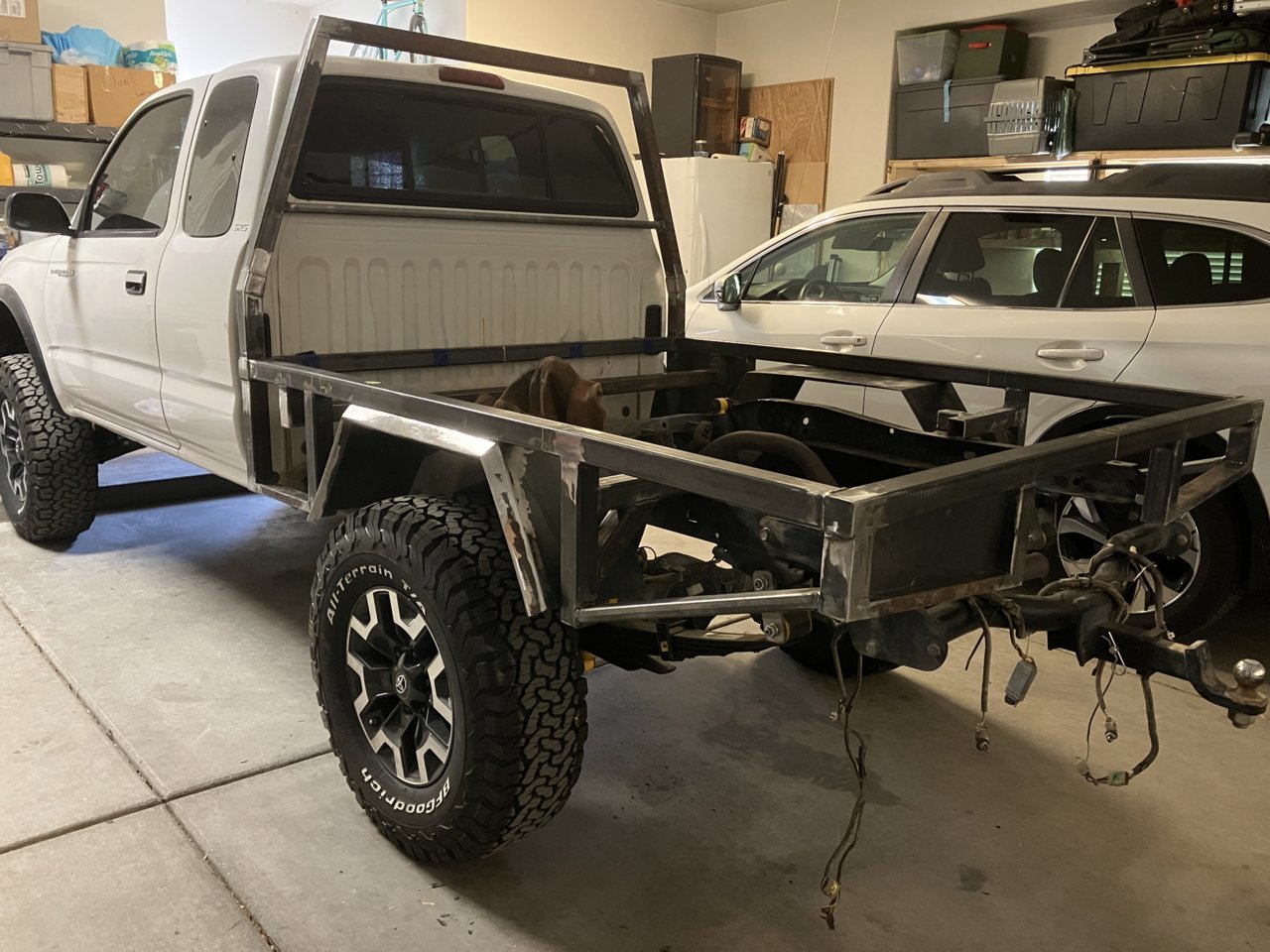

    1999 trd manual 4x4 ext cab

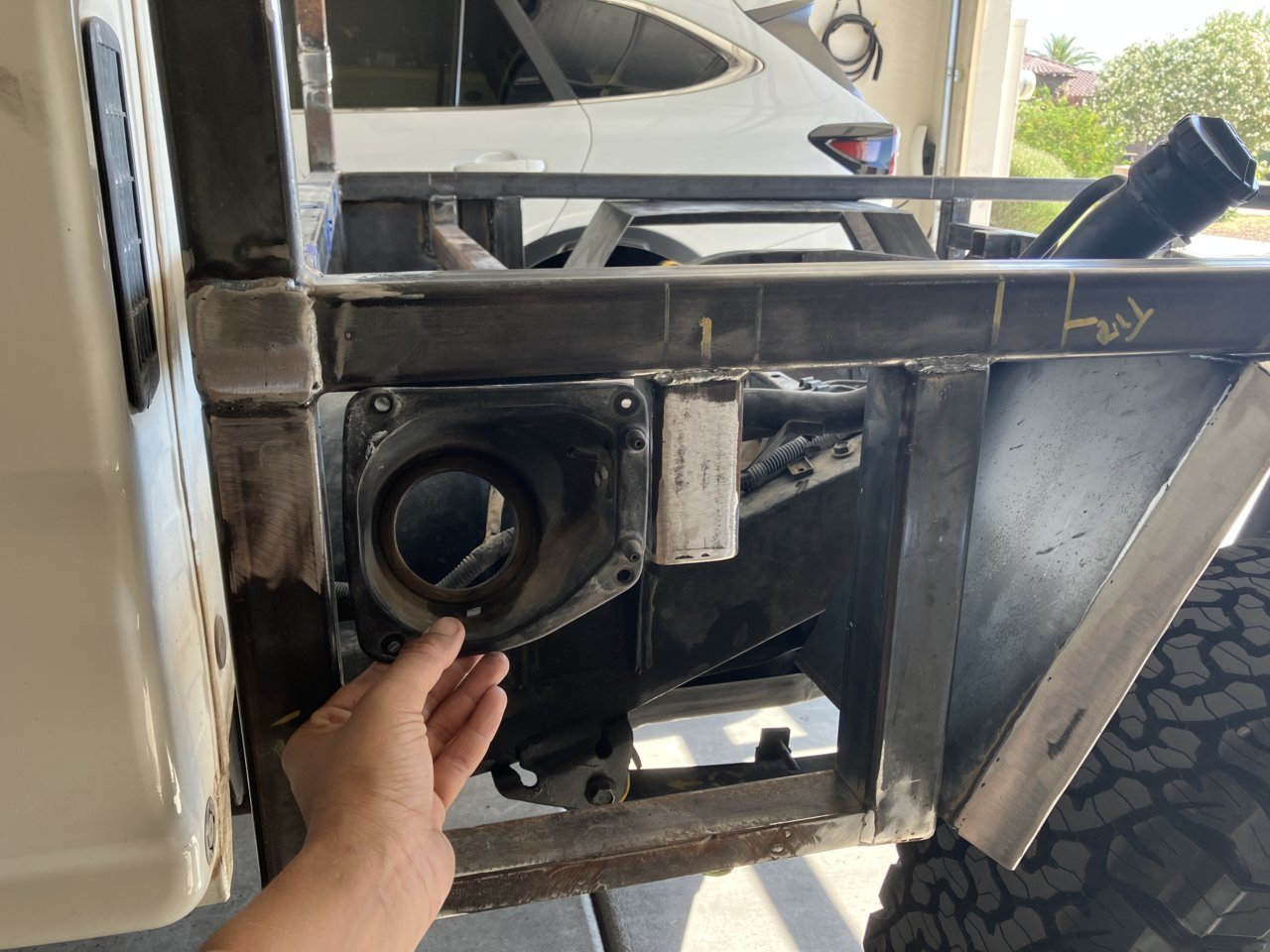

    Here's another entry. I've got the frame and mounts done, working on underside drawer and taillight placement before I start welding in the bed support. I've run into some issues with the gas filler nozzle placement. The bed is raised a total of six inches off the original bed mounts; I had intended to rotate the filler nozzle 180 degrees and install it into a plated box closer to the cab, so all that would need modification would be a longer breather hose. Once I test fit the bed on the frame I think that the oem filler hose does not have the right angle to have gas flow into the tank from the position I wanted. I will have to research some other options for filler hose shape. Any suggestions are welcome!

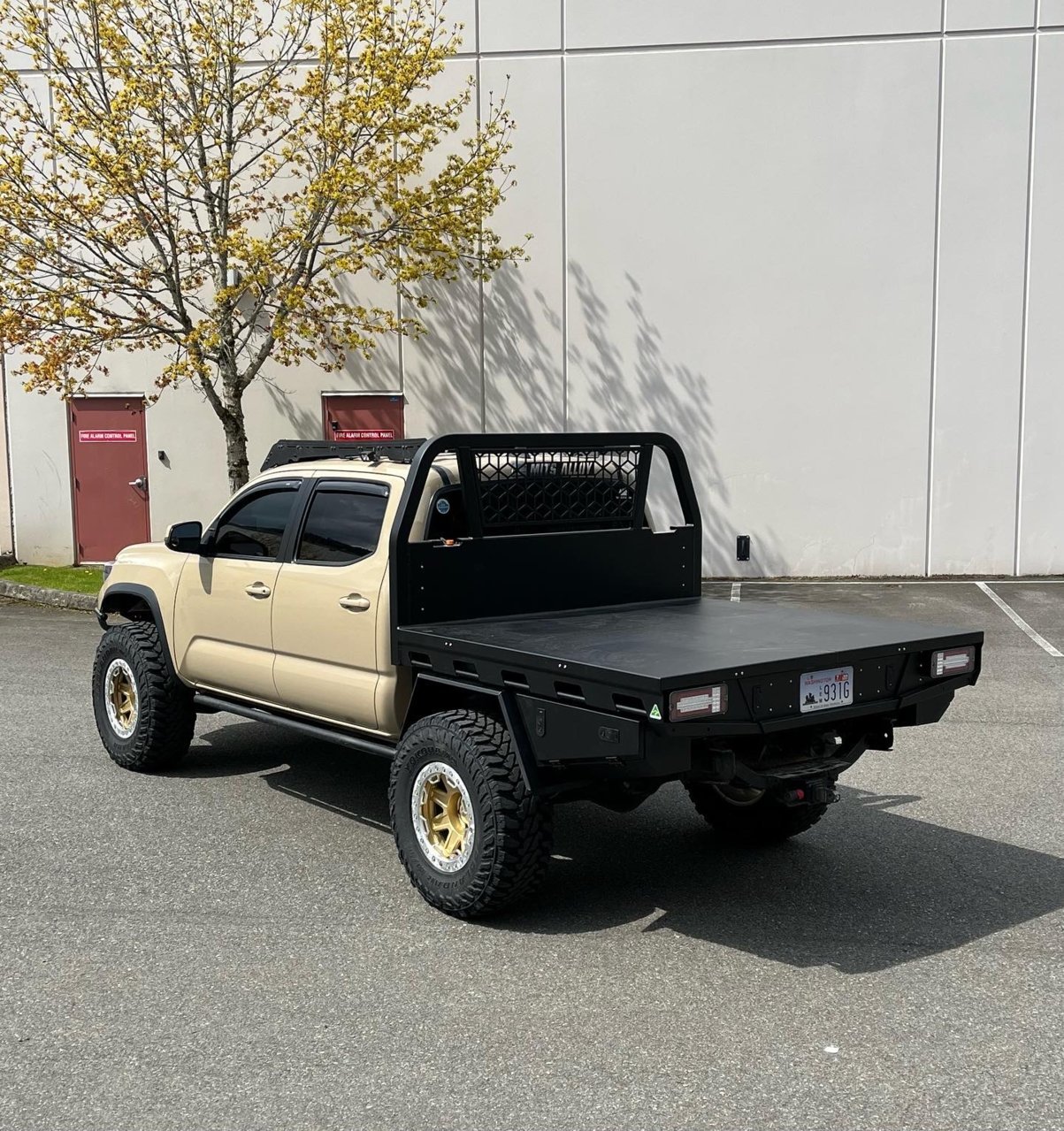

    Bought not built :spending:

    Details?

    Ralf and Naveronski[QUOTED] like this.

    Looks so good Jon!

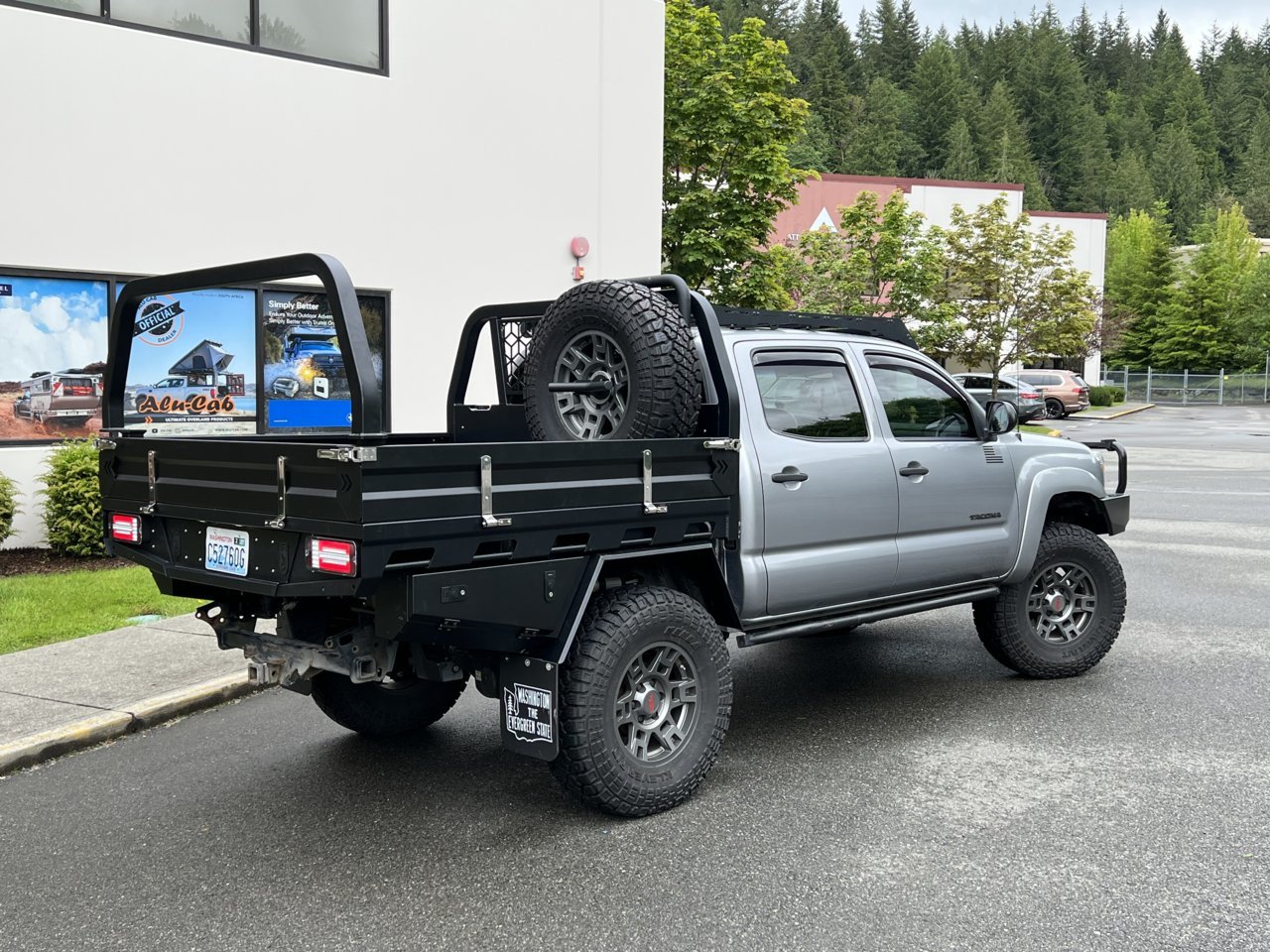

    I got it from the best! I wanted to tag you but your user name is not very friendly for that lol

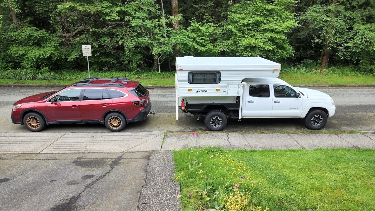

    I see you have an Outback as well.

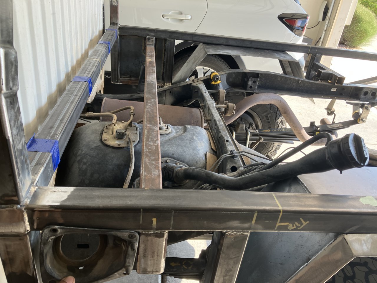

    47M2O-6Yys6efwqiUt4ovMog3aKIqXwbsdaeMHtI_48290cf8bfa8aa270af5ffedd31a7e8f0da7c4a1.jpg
    I am mounting my filler neck above the bed floor. Have to shorten the metal pipes and replace with longer/flexible fuel lines.

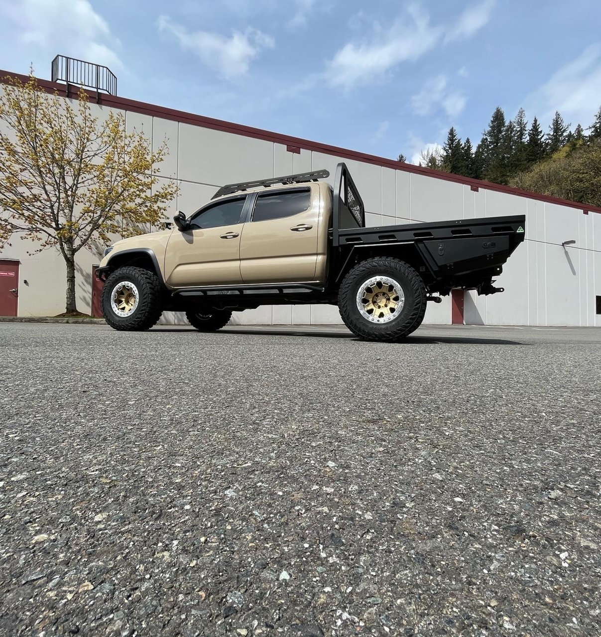

    I'm jealous of your sideboards

    I was wondering why you didn't get any, or is that because you're going with a half canopy?

    I get a lot of compliments on them. I’m glad you’re jelly lmao

    I’m having a hard time with the filler neck, I just don’t have enough space with a 6 inch bed height from frame.
