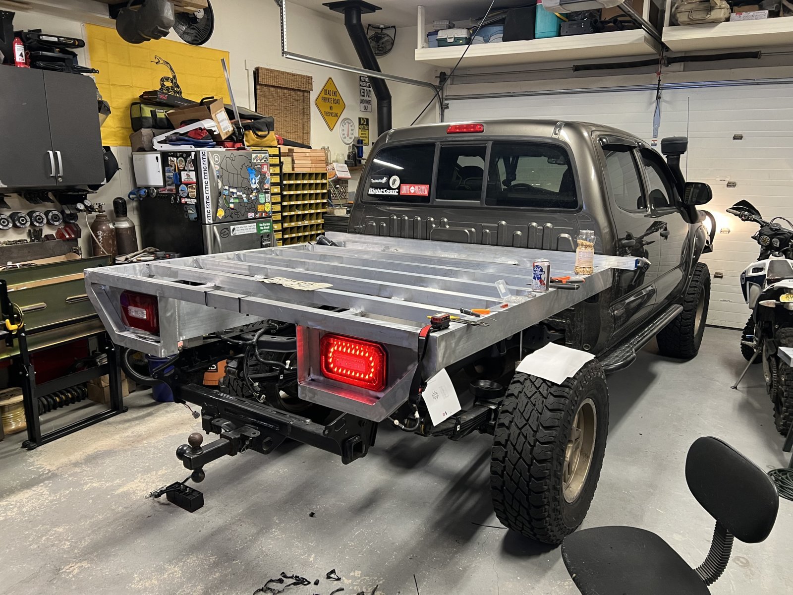

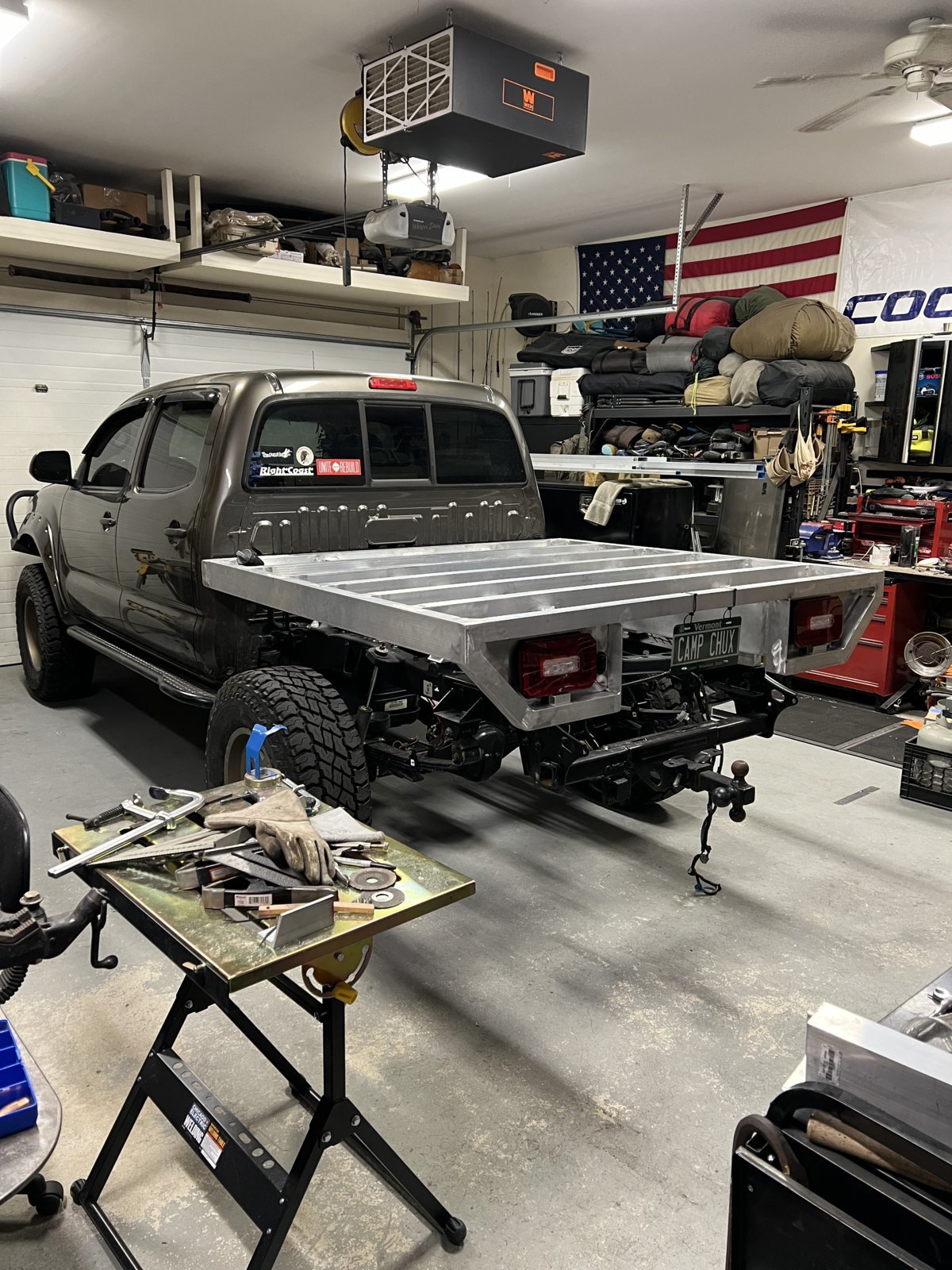

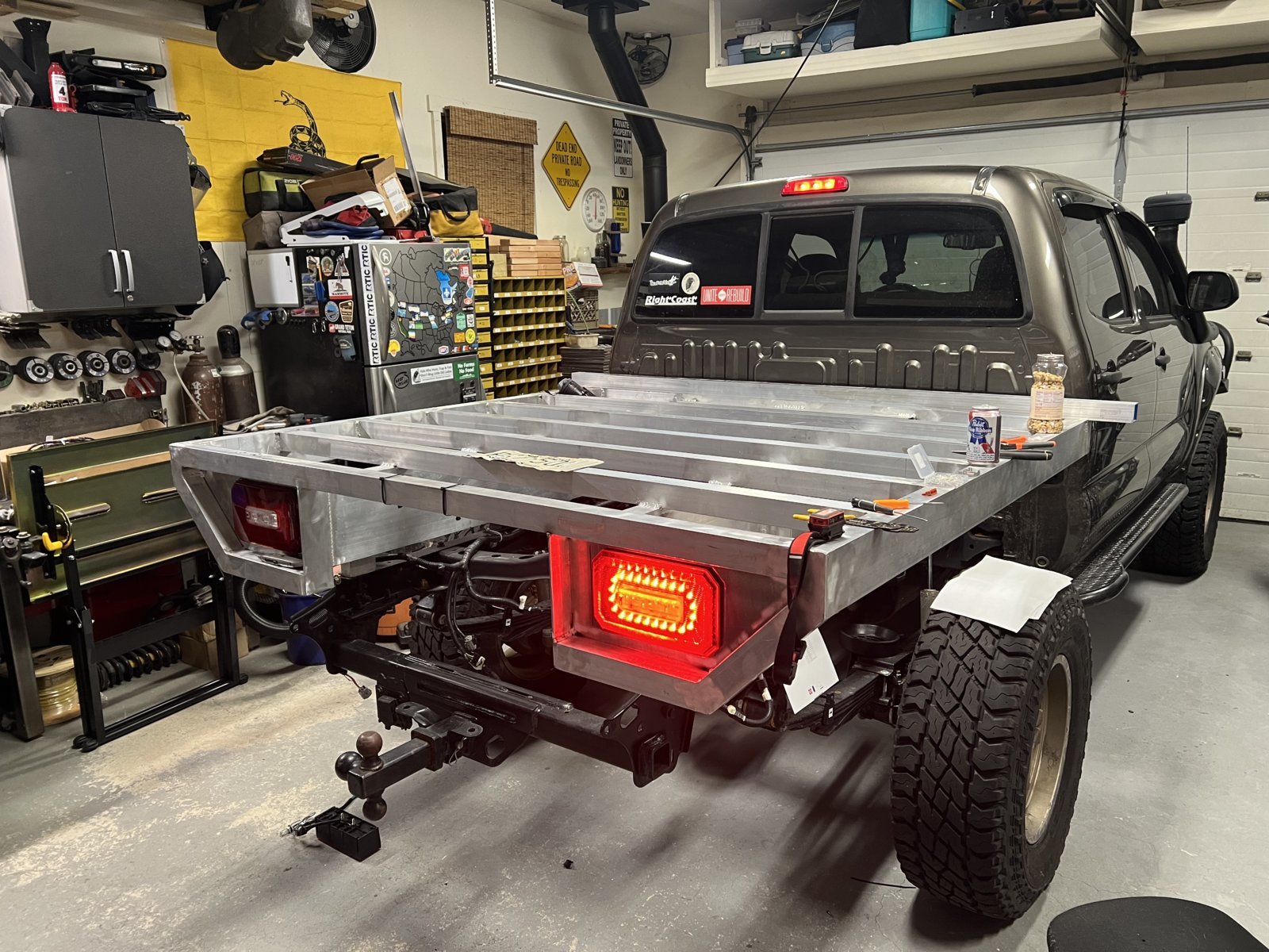

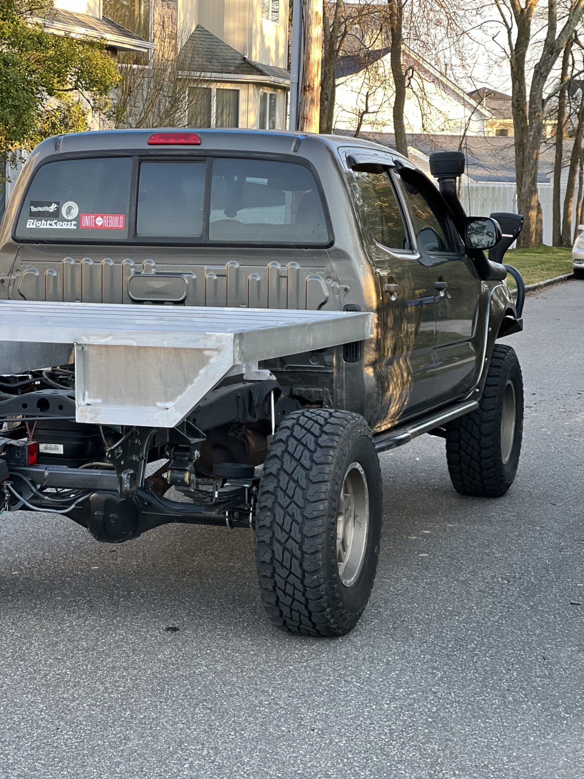

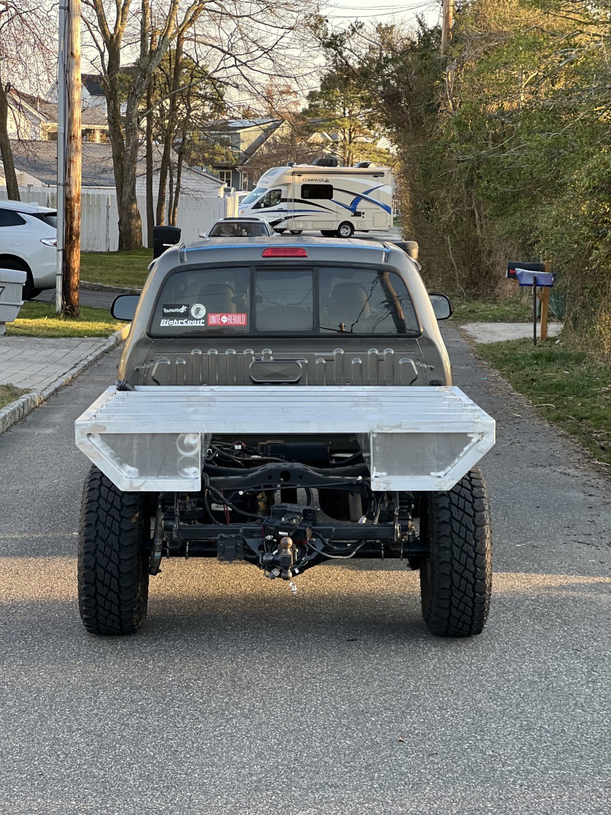

    100% DIY. Been looking at them for years from the Aussies. Thought I’d get to building one sooner but Toyota put a brand new frame on my 2013 truck last year so I waited it out and used that as the turning point of my build. Got a few spool gun projects under my belt so time to give this a red hot go. I always knew I wanted a full aluminum tray. Besides weight, I’m on the coast and you can’t even get away from the salt in the air. Plan on doing tool box sides on the tray, passenger full 5’ long box and driver side broken into a 3’ box for camp kitchen and a 2’ (gonna make custom box) for a fridge. Maybe run my old CVT tent on top not sure if it’ll be all the time. Would like to run a tin boat on top for some trips.

    Very cool. I will say I have been pretty happy with how well the aluminum has held up in the Canadian winters where road salt is pretty bad. So far no galvanic corrosion or any issues that way.
    sounds like you got some great plans ahead. The tool boxes or covered storage is a great idea. The biggest thing I noticed was the loss of a tailgate as a prep/table surface. Not sure if the doors of your tool boxes can be used as a surface. Something like this where the door could be used as a table.

    Drop down tool box table be fine for me… The wife will need a step stool lol.
    Probably end up doing a trundle table like this
    Frame mounts

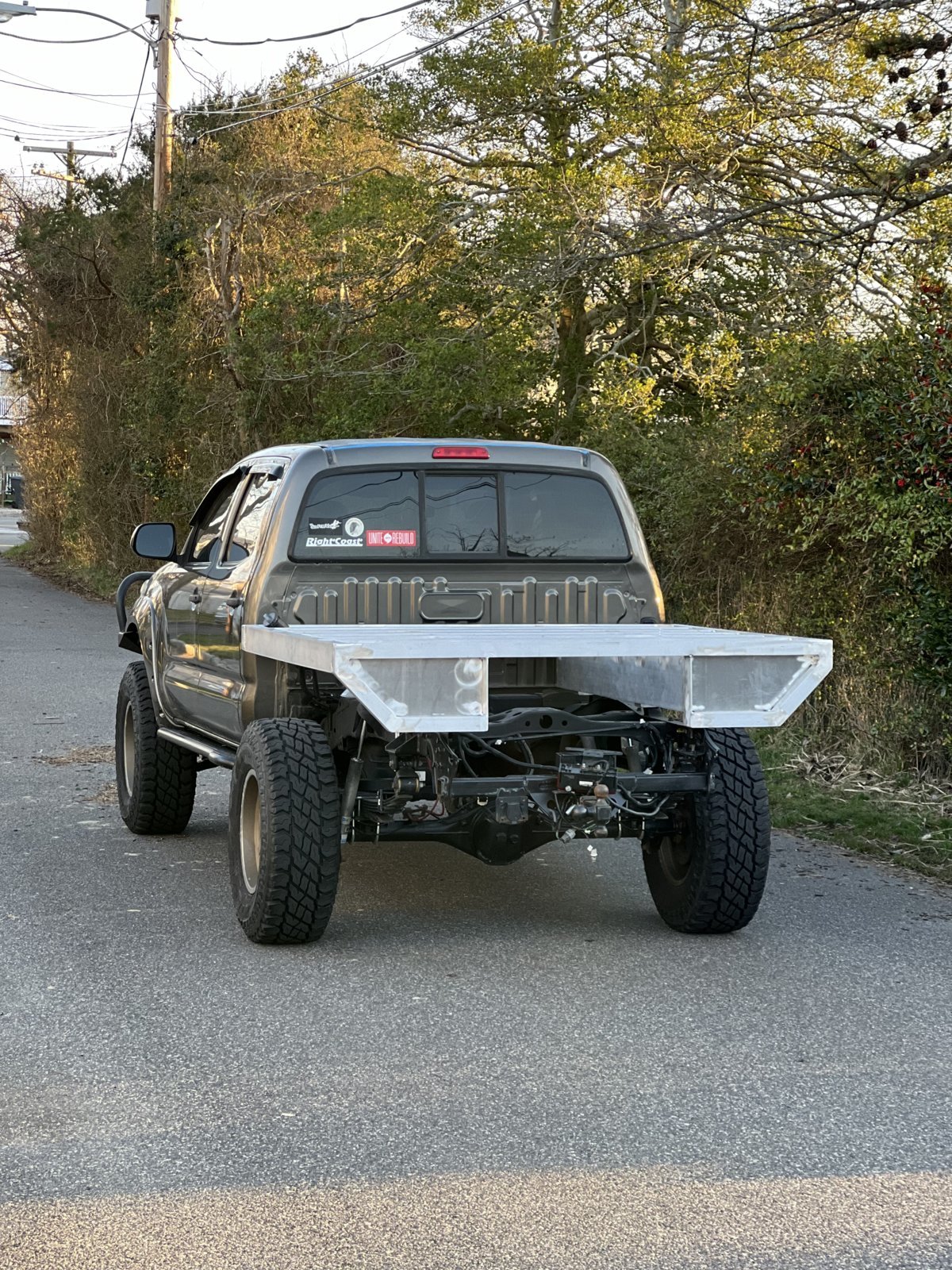

    Awesome build and progress!
    I like where you’re heading with this and plan on copying at least a few things you’re doing when I start mine.
    Edit: not sure on your laws but you may need the tail lights to wrap around or add side lights at the rear:notsure:

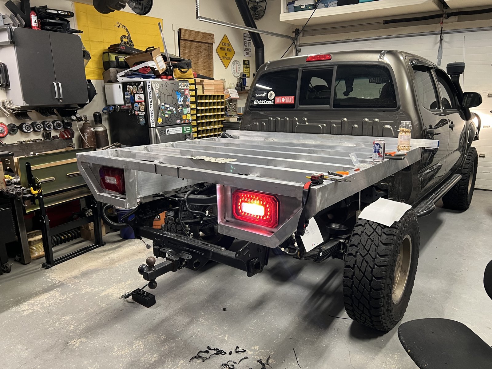

    I can lay out a basic material list if you want. I went into it with no plans just the idea and worked it out as I went. Looking back it was easier than expected once a few things were layed out.

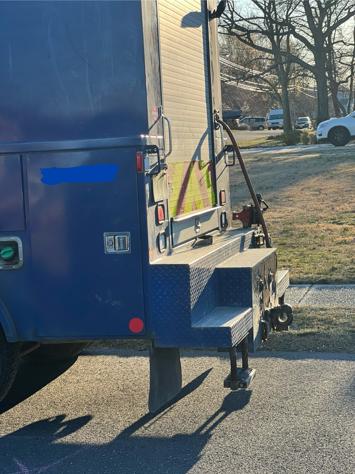

    Interesting outlook on the law with tail lights. And you may be right, I'm not sure. Since reading that the other day I have been looking at a lot of cars and trucks around town. The cars definitely have factory taillights that wrap the rear corners but work trucks with utility bodies you can only see the tail lights from the rear. Even my work truck, only light on the side is a marker light.. Should be ok in town.. May have an issue with out of state trooper. We’ll see.

    I am quite sure the vehicle lighting specification is federal, not state. Some states do not police it as much as other states (Cali is strict, Georgia doesn't seem to care).
    IMHO, you need rear, red illuminated side markers in addition to the reflectors.
    Aside from the legality, I like to have markers on all my vehicles and trailers - people are so distracted while driving, I want to give them every opportunity to see and not hit my vehicle.
