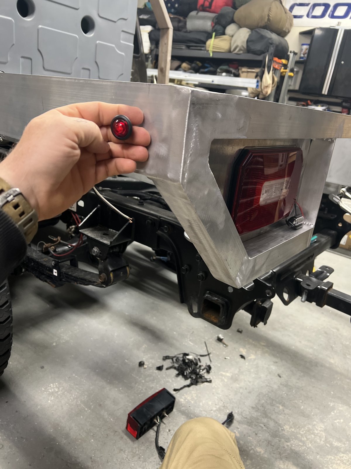

    It’s funny I was dead set on not bothering with marker lights but the harness kit I got with my tail lights that are for a utility body came with marker lights and grommets so I started looking at them mocked up and don’t hate it. Might end up doing it once I’m done with the build mostly because the tail wires are right next to the tail lights easy enough to tie in. I considered the third brake light too at some point. I’d wanna run the wiring in the rack to keep it clean so if it’s not so easy ain’t happening haha

    I have to find a spot where the side markers won’t get broken. My bed has plugs meant to be filled with marker lights and I have already broken those on trees. May make some brakes that mount them in a more protected spot. Won’t look great but will be legal.

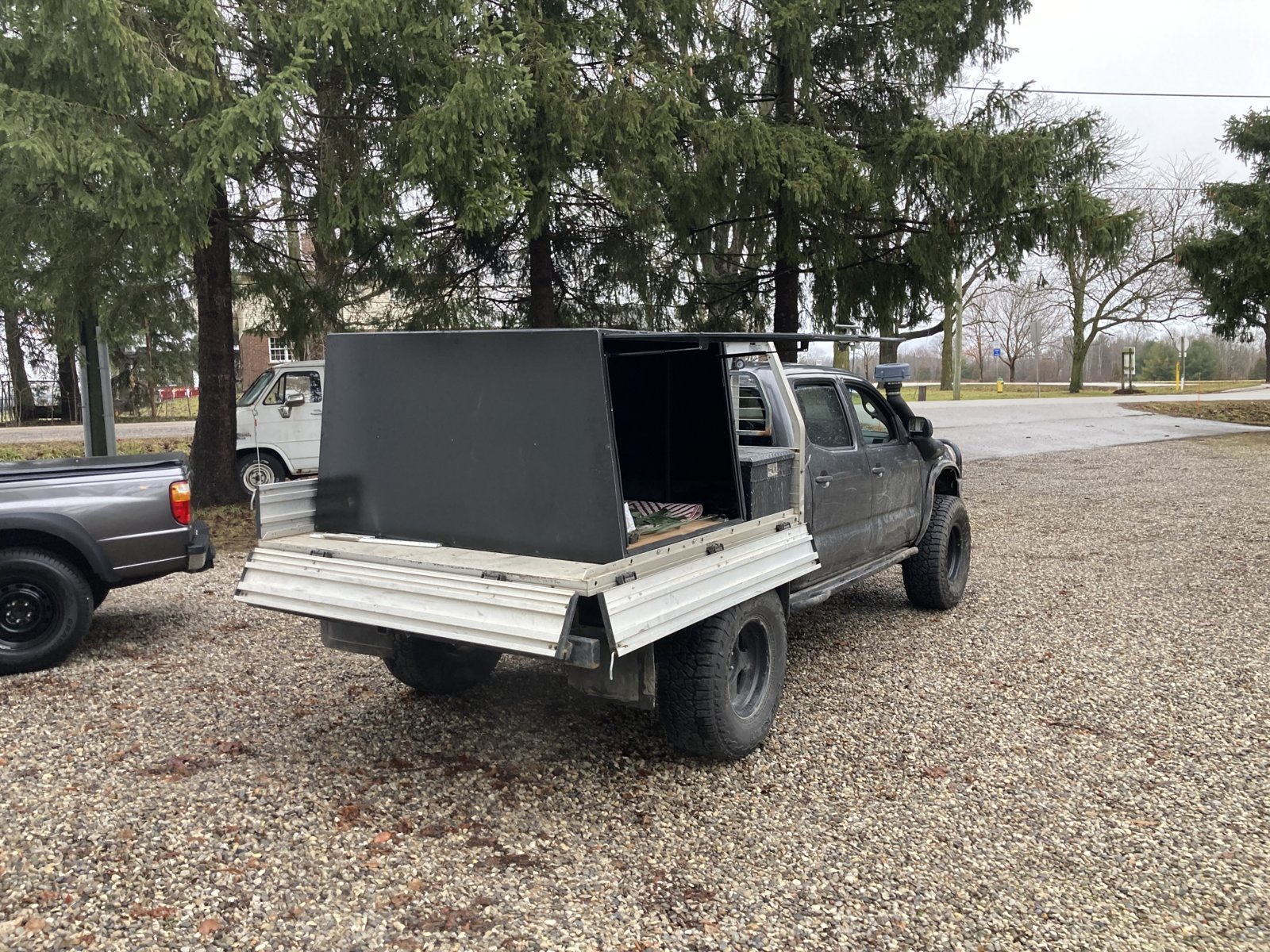

    I was going to put my third brake light in the middle of the bed on the bumper end. Currently my cab brake light is blocked with the cap.
    Not the best picture but can kinda see what I mean. Don’t want to bother installing the light in the cap since it will be in and off so much and I’m trying to keep it as water tight as possible. IMG_9512.jpg
    Do you have a link to your lights and harness you got? I may be redoing all mine so would be interested with what you went with.

    Went with Knapheide after trying to source some Australian lights I would see on most tray videos I watched and seemed difficult to get what I wanted. One day saw them in person on a new mechanic truck at work and liked how flat they were, then started noticing the same lights on other work trucks as well. I ended up only using the taillights and the direct connection plug I removed from the harness. I will reorder the connector and put the full harness up on eBay at some point. I was stock piling parts long before I started the build so really didn’t need the full harness kit once I got into it.
    https://parts.knapheide.com/knaphei...5-light-surface-mount-light-kit-knap-20128850

    Oh that’s neat. Thanks for the link. Looks like some really good commercial lights.

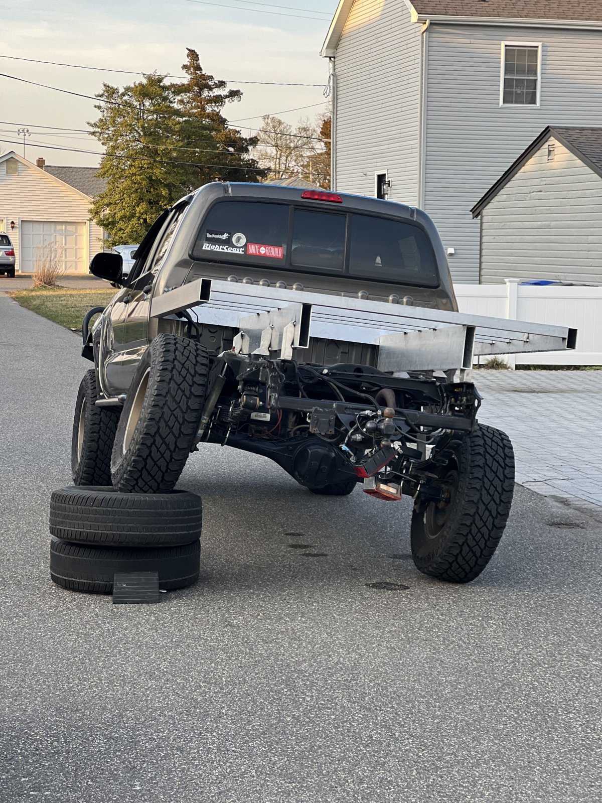

    Looking clean! Excellent work, Chux.
    Is that 8”x2” R’ tube you’re using for the runners?

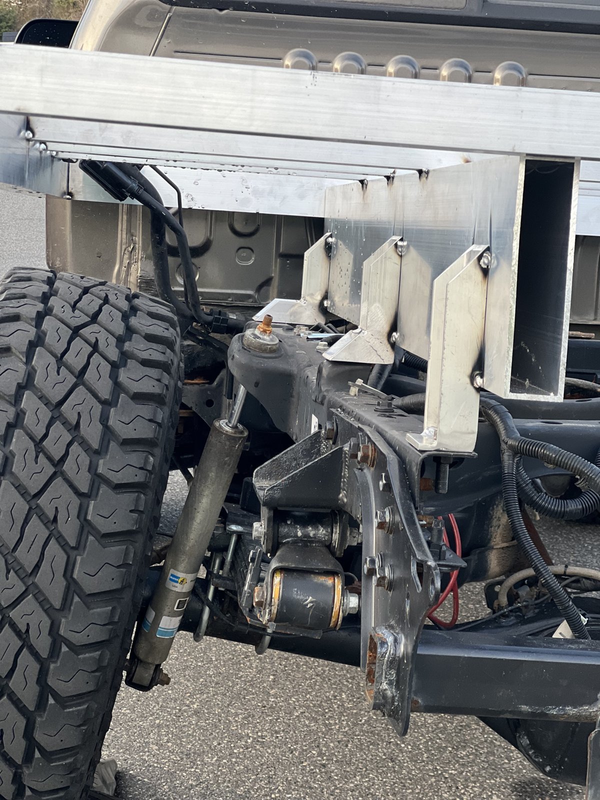

    Yea 8x2x3/16. Originally gonna make a rear bumper with it but then decided to recess the tail lights. I got most of the material well before building, without an actual plan just working with the idea I had several changes along the way. Glad I was able to use them cuz I wouldn’t be able to return them and had no idea what I’d do with a 12’ piece of 2x8 aluminum. Using them as the rails worked out better than I coulda planned making it easy to add a trundle drawer later..
