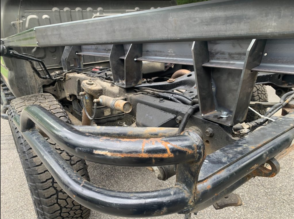

    Nice. Definitely helps speed a project up too. Was going to say got a lot done for a day and half. Those brackets would have taken me a better part of a day to get cut out and fit that nice with a grinder and porta band.

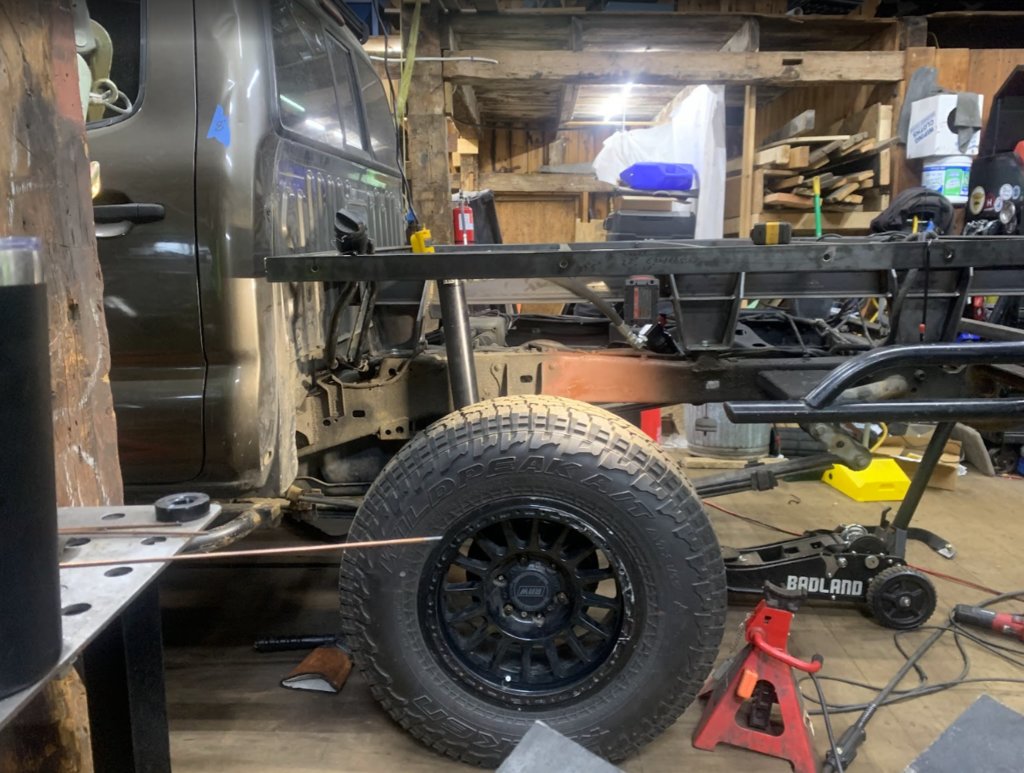

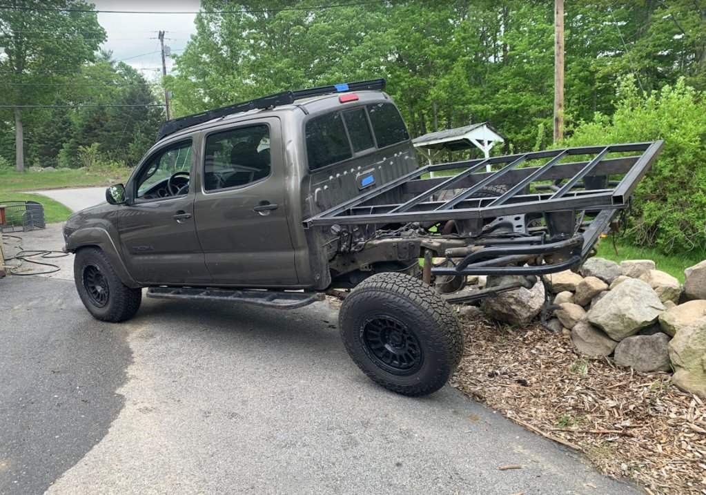

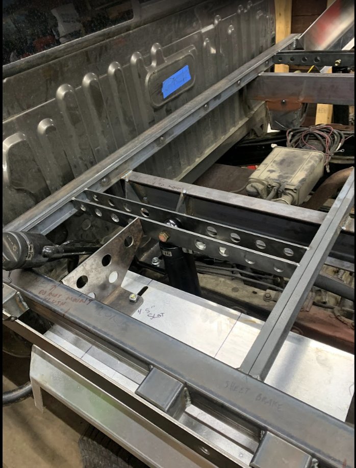

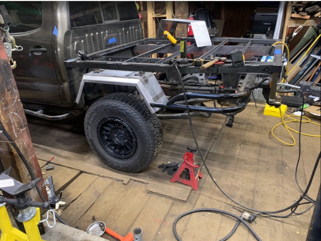

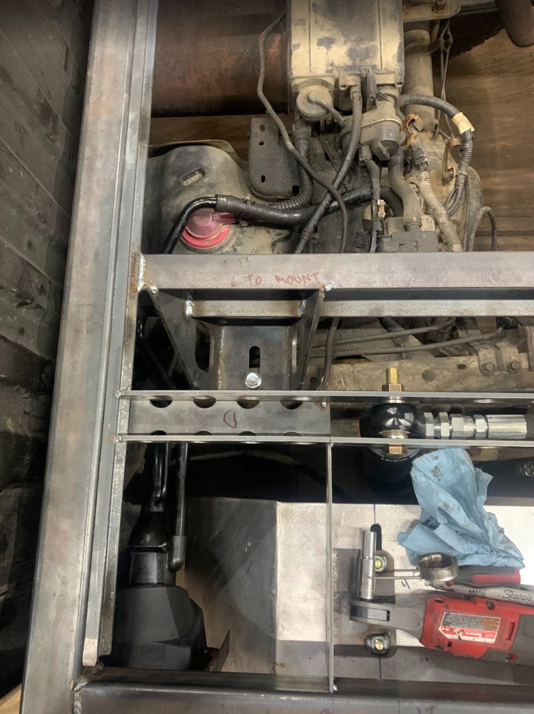

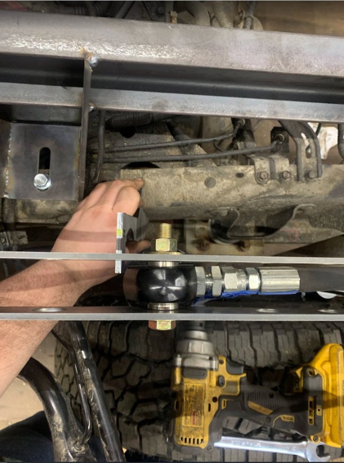

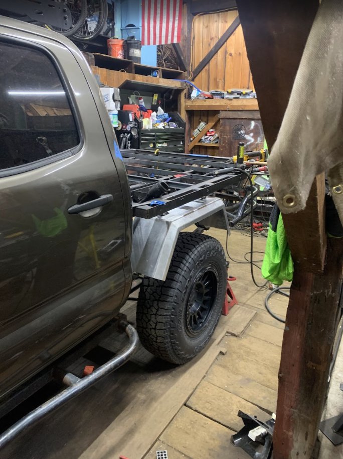

    Got less done yesterday, did the other 4 bed mounts and cut out the upper shock mounts. Now I have to figure out how close to put the shocks to the frame.
    Also one of my first posts I had the measurements wrong. This flatbed will be 72" wide by 74" long. Rear mount to deck surface at 11.5"

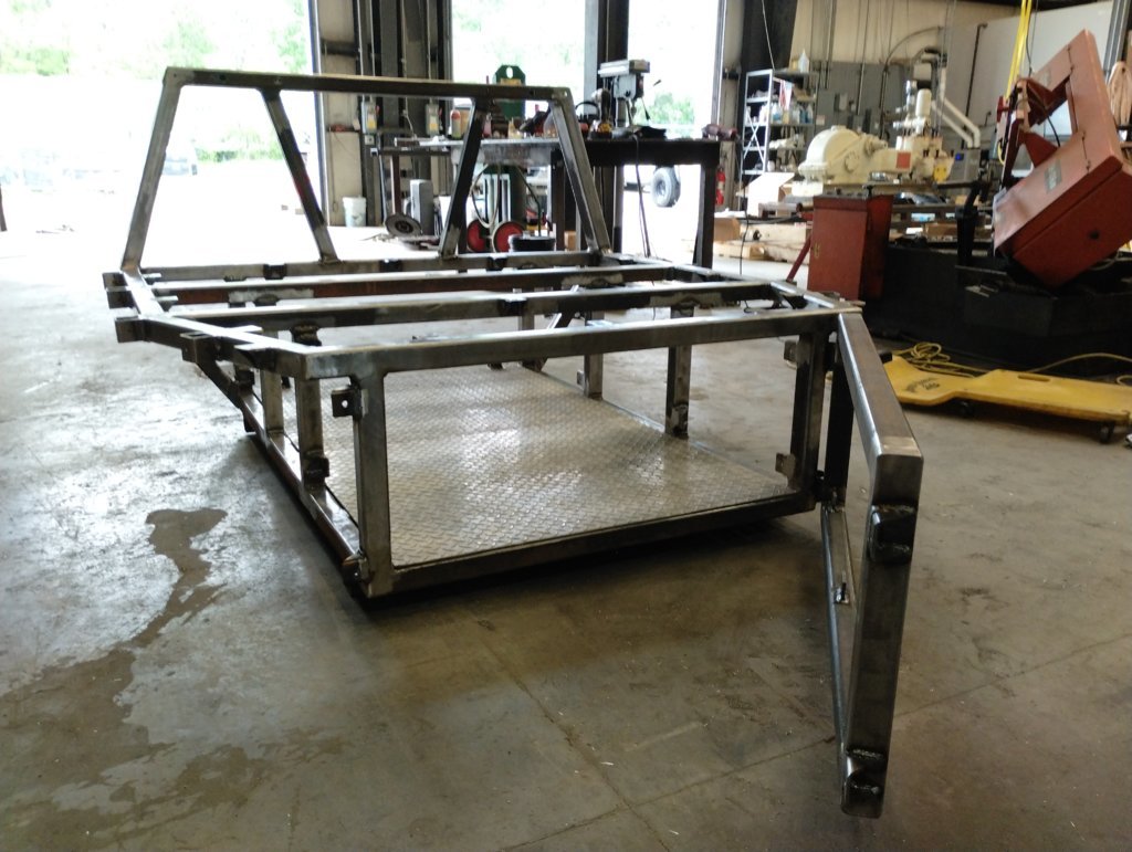

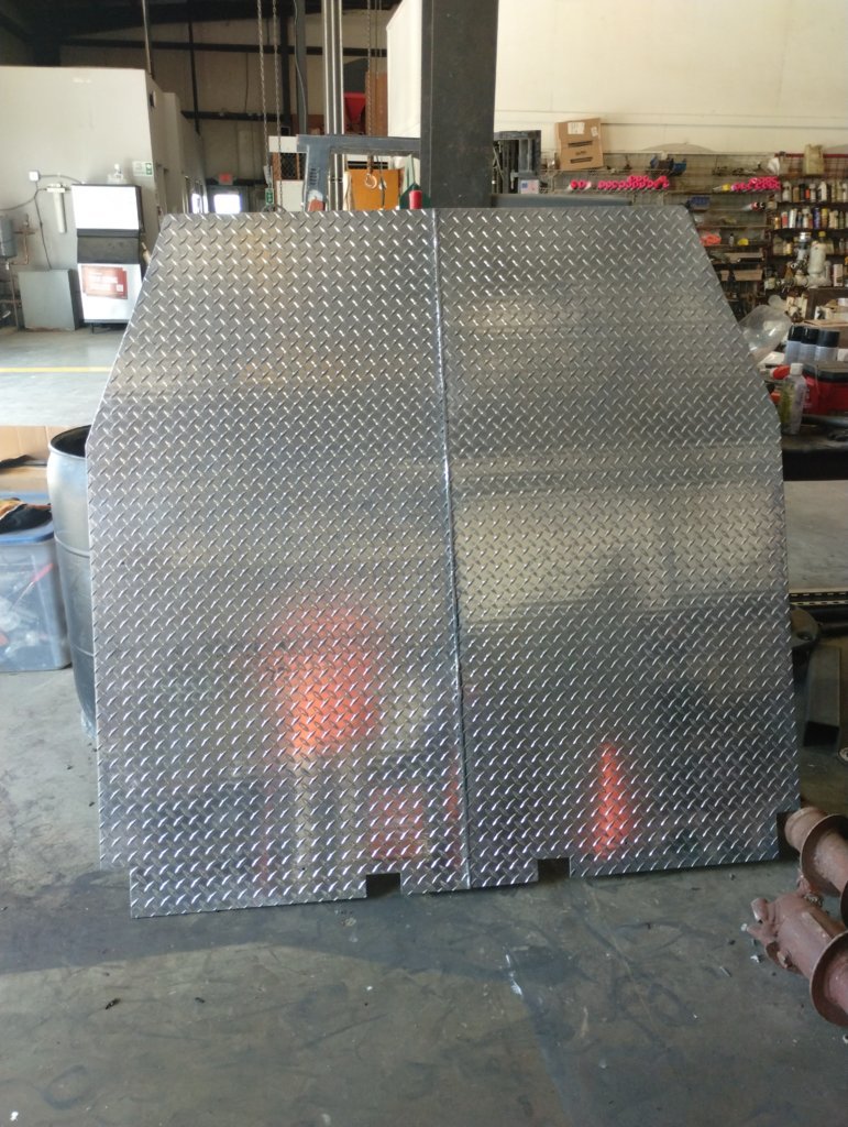

    Whew.. this project is taking longer than I wanted ahaha.
    Getting blasted and coated today. Ended up going with a 1 piece swing out tailgate. Just easier and quicker on my end to build. Can always change it later.
    Oh and this was a pain. Couldn't get a piece of diamond tread wide enough to cover the top so I had to weld 2 old pieces I had together. Was super corroded. Found out... I do not enjoy polishing metal. Not perfect, but it works for a Tacoma.

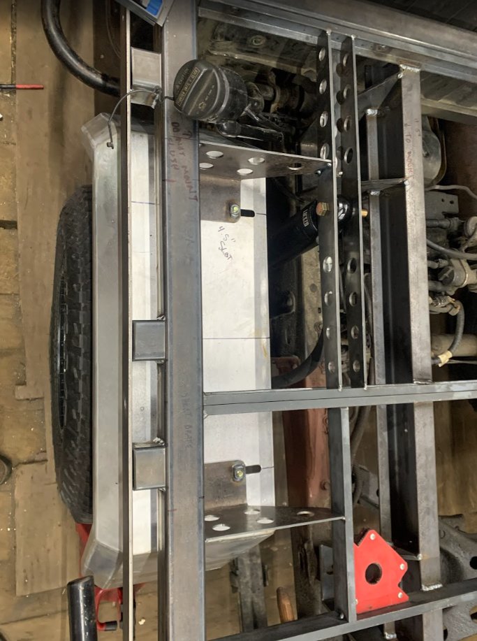

    Looks awesome. Love the shock tie ins to the bed.

    Im lovin how it is coming along. Yeah decided to go that way to get the shocks as high as possible. The top of the shock eye is within 1/4" of the bottom of the deck surface.
    This thread made the taillights so easy. I just used the harness off the old lights and put resisters on the turns. Stock wiring was long enough so itll be clean.

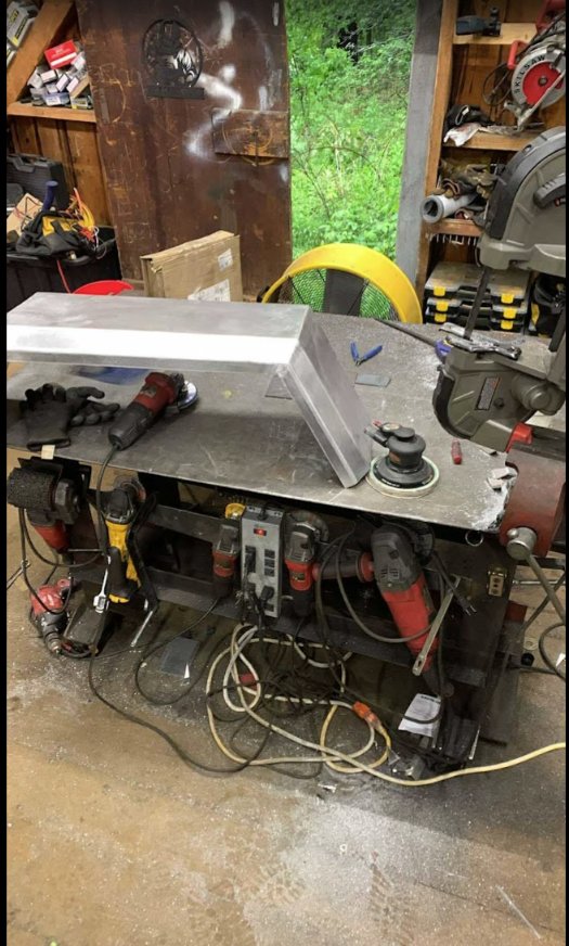

    Where did you source the fenders?

    I just made them. Bent up some 5052 at work and welded them together with a spoolgun. Lots of grinding.

    Sweet! They look very similar to the Summit Expedition fenders but undoubtedly much less expensive.
