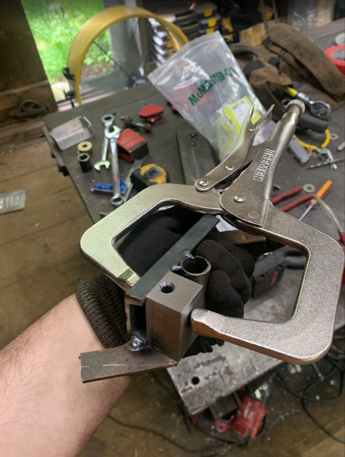

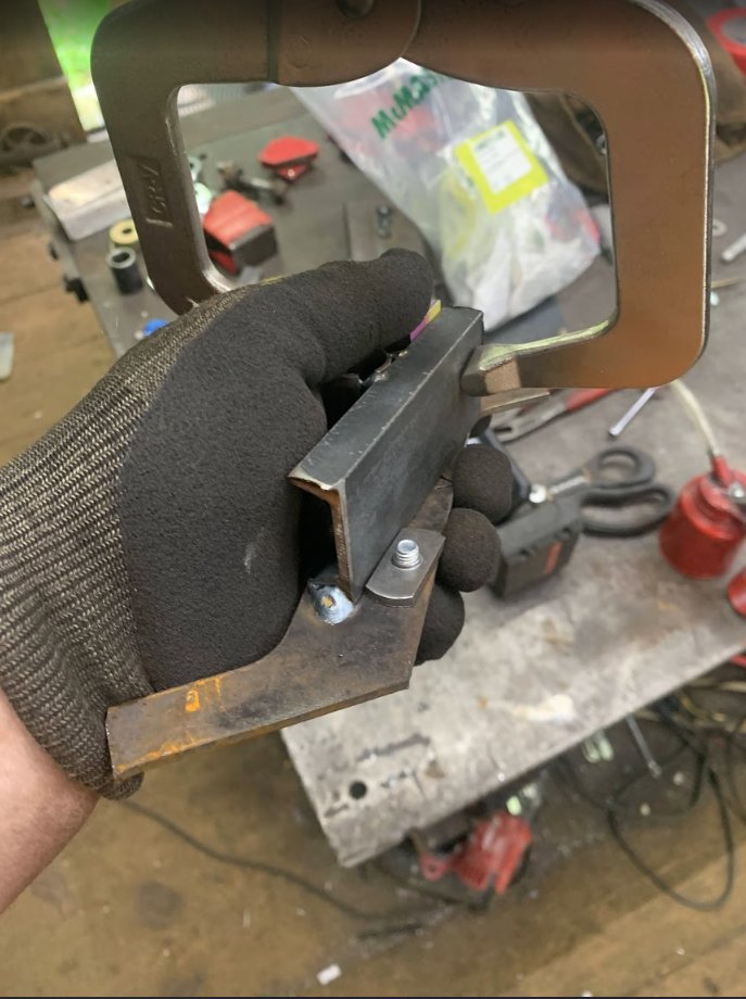

    Getting most of the deck on feels good. Made a little drill guide at work to drill the hole at the proper distance from the channel for the weld nut.
    Now I gotta decide what to do with the front section. I am thinking two separate panels. A small one to be able to take off and access the fuel fill lines and a bigger one covering the rest.

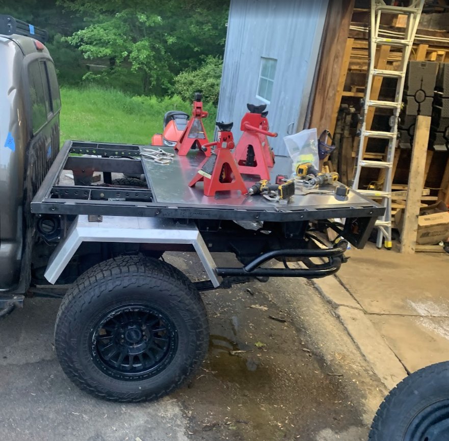

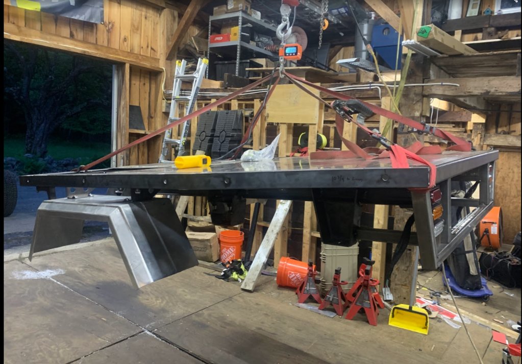

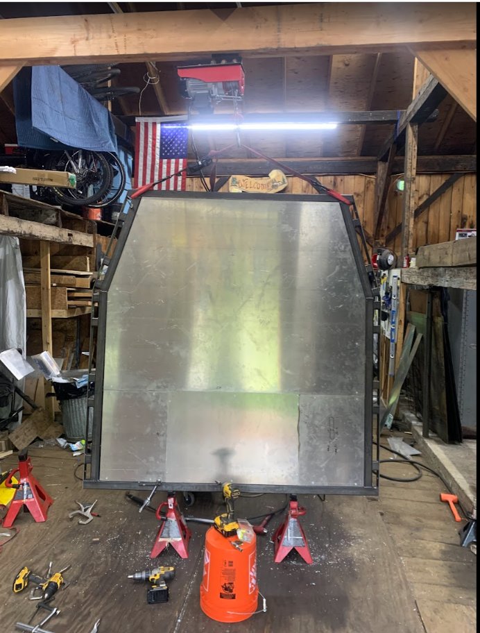

    Final weigh in, 332 lbs. My stake pocket setup added alot of weight.
    Still pretty reasonable seeing my stock bed was 280 lbs and the rear bumper will be lighter than a normal one.
    Deck all sheeted. I used 1/8 5052.
    Even has a tailgate(this is temporary though). Came out a little wonky but I dont have any more aluminum to recut it.
    And the wife got it all painted. Looks so much better than if I painted it.
