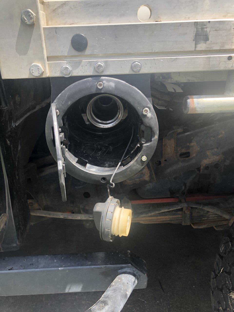

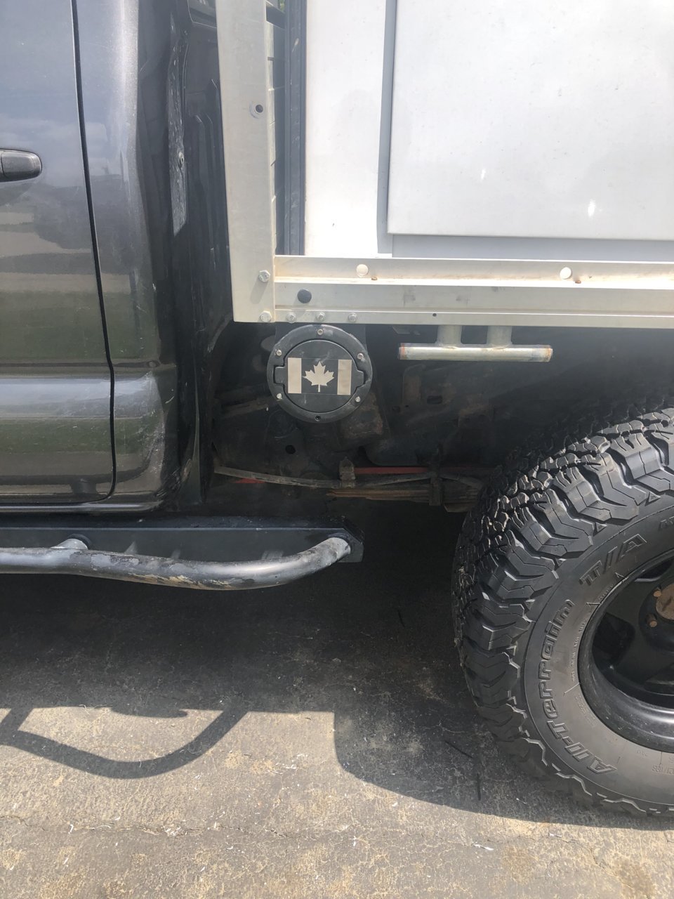

    Couple updates on my flatbed progress if anyone is interested in the DCSB and a Ute Bed:
    Rough look of the toolboxes on the Ute Bed, still a couple inches down from where they would be, simply a mockup (this is the 30ish" long box):

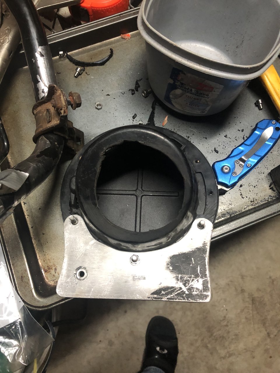

    Also finished my fuel filler neck mount, thought it may be helpful to share for any DCSB folks out there. 2.5 inch (if memory serves) u-bolt from ace, works a treat on an aluminum plate I fabbed up.

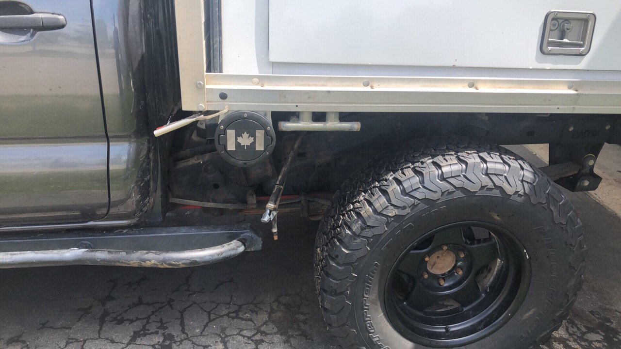

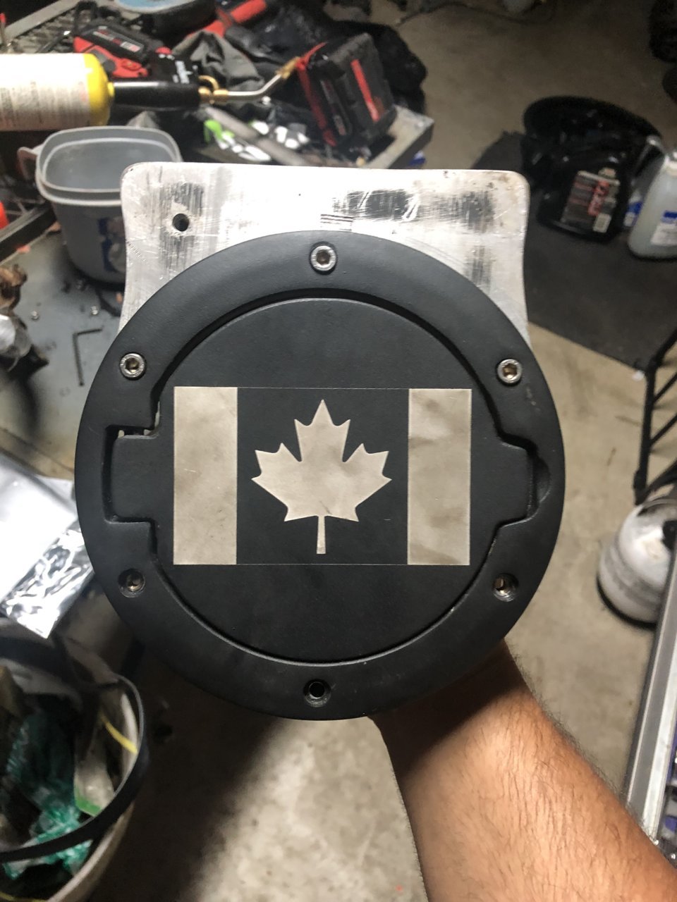

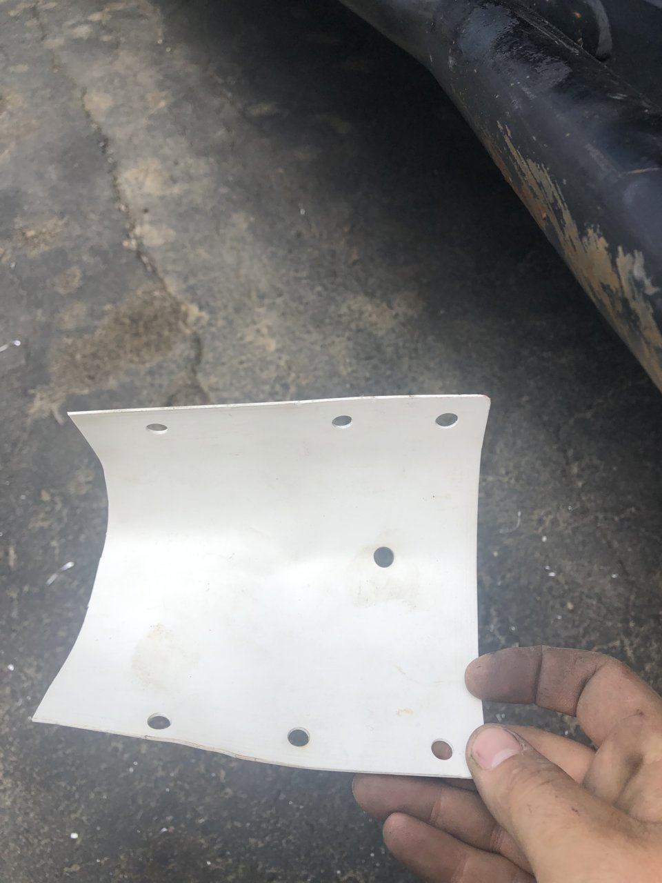

    Finally found an hour or two to continue working on this project
    3D29D578-FCE1-4F89-9EBE-B32133C362E1.jpg 65CD9DAB-7FD9-4004-B7DB-A092E4859E82.jpg 4E61CADA-442F-48C7-AB99-5999902D420D.jpg
    I’ll have to cut the curvature out of the stock filler neck to make it work.
    Little update nonetheless

    This method didn't work, and I went back to method I had originally, and using a u-bolt like @danrogers
    And done photos of it all finished

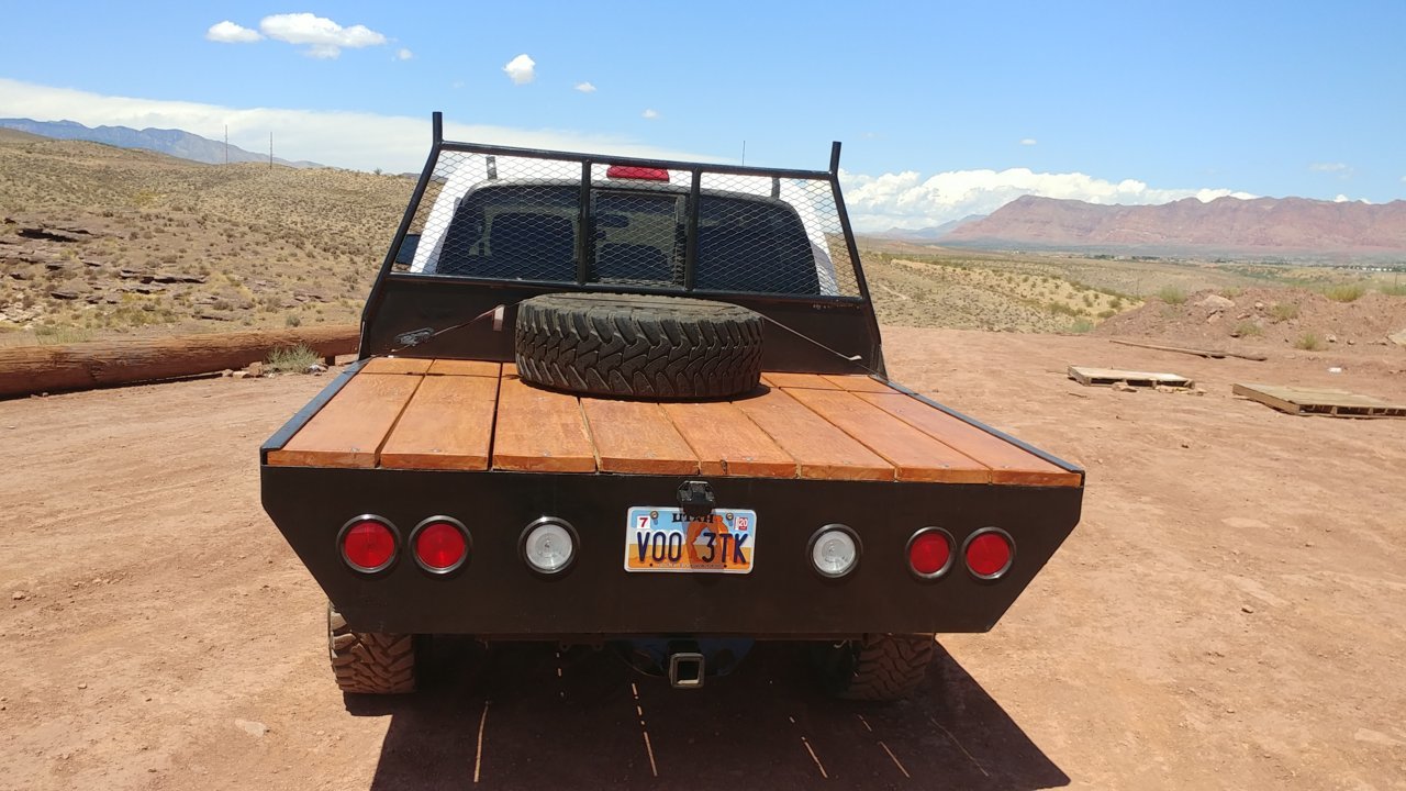

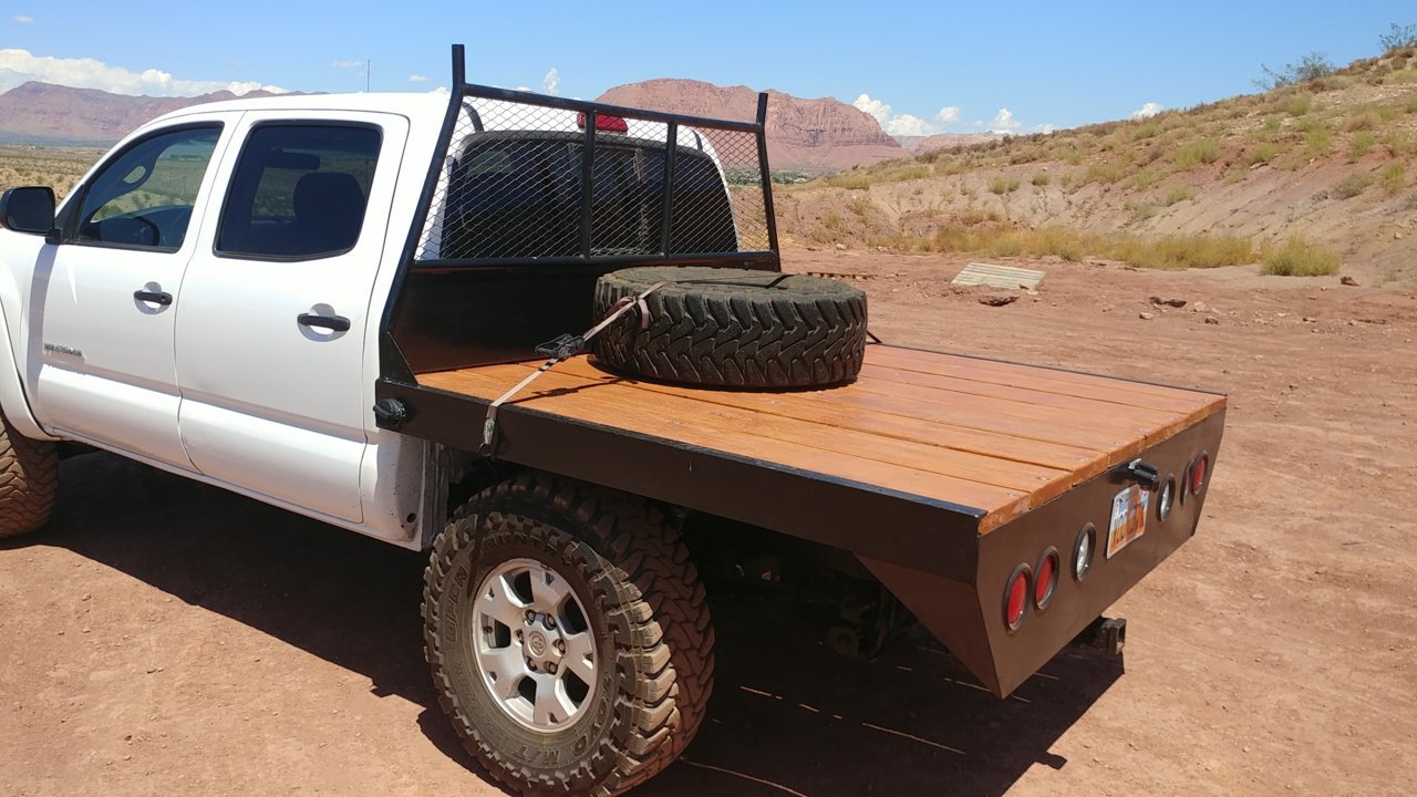

    Been interested in those Ute Beds for a long time. Wanted one on my old first gen I had about 6 years ago. Never found the coin to try one, but they sure look great on the 2nd Gens in here.:cool:

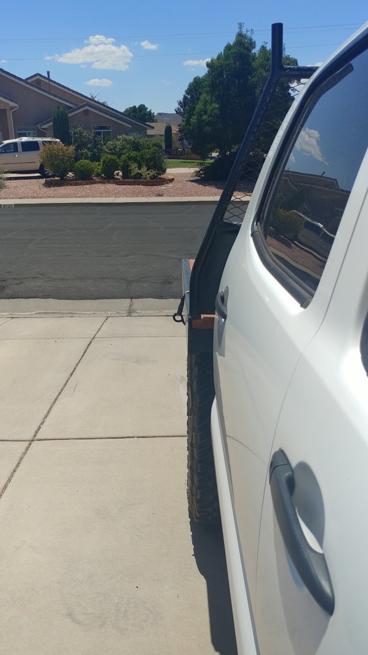

    So also, figured I'd throw my current flat bed setup on here as well. I just picked this truck up pretty much as-is with the flat bed. It appears to be home-built from c-channel steel. The headache rack definitely is home-built. It needs a little help, but overall its pretty decent. Size-wise is great for what i want to do. It measures 76" wide by 65" long.
    Heres a couple pics (riding on blown out shocks and flat springs--waiting for my new suspension to arrive :D )

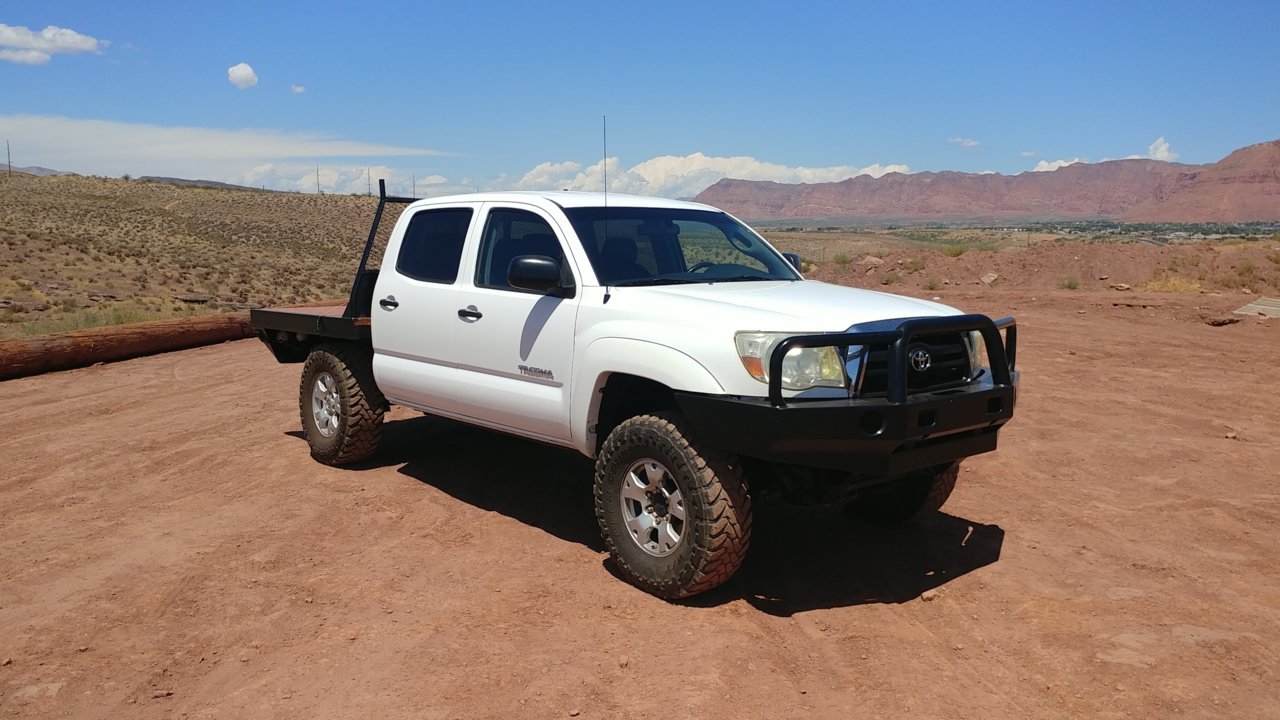

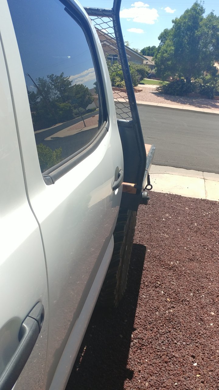

    Can you post pictures from the front down each side so we can see how it looks sticking out from the side of the cab? Thanks
  19. Aug 10, 2019 at 1:14 PM
    #59
    digitalferg
    digitalferg Well-Known Member
    Aug 10, 2012
    #84494
    434
    Southern Utah
    2006 1G Tundra DC TRD 4x4
    Doesnt seem any further out than the front fender flares and front bumper corner under the flare...
    I dont like the gas filler neck protruding out though so I may try to do something about that.
