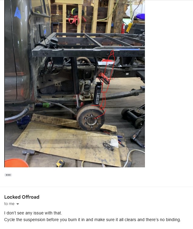

    Well you would be using the rebound valving instead of the the compression valving to counteract the axle wrap. What difference does that make? Not a clue.
    Asked Riley at locked and he saw no issues with my plan.

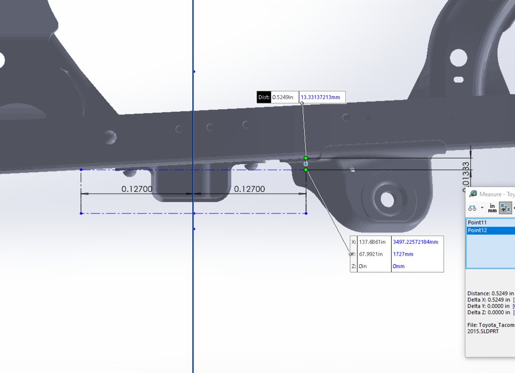

    Where did you get that CAD model? Is it for a 6 ft bed?

    I paid for it through here, I believe it is for a DCLB but that didnt matter for my purposes

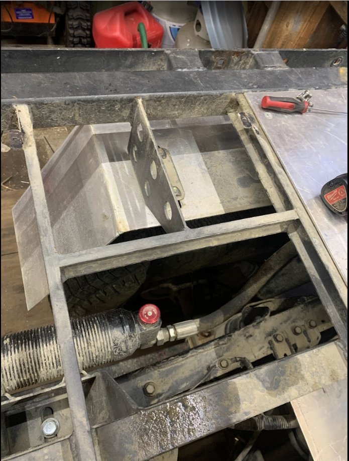

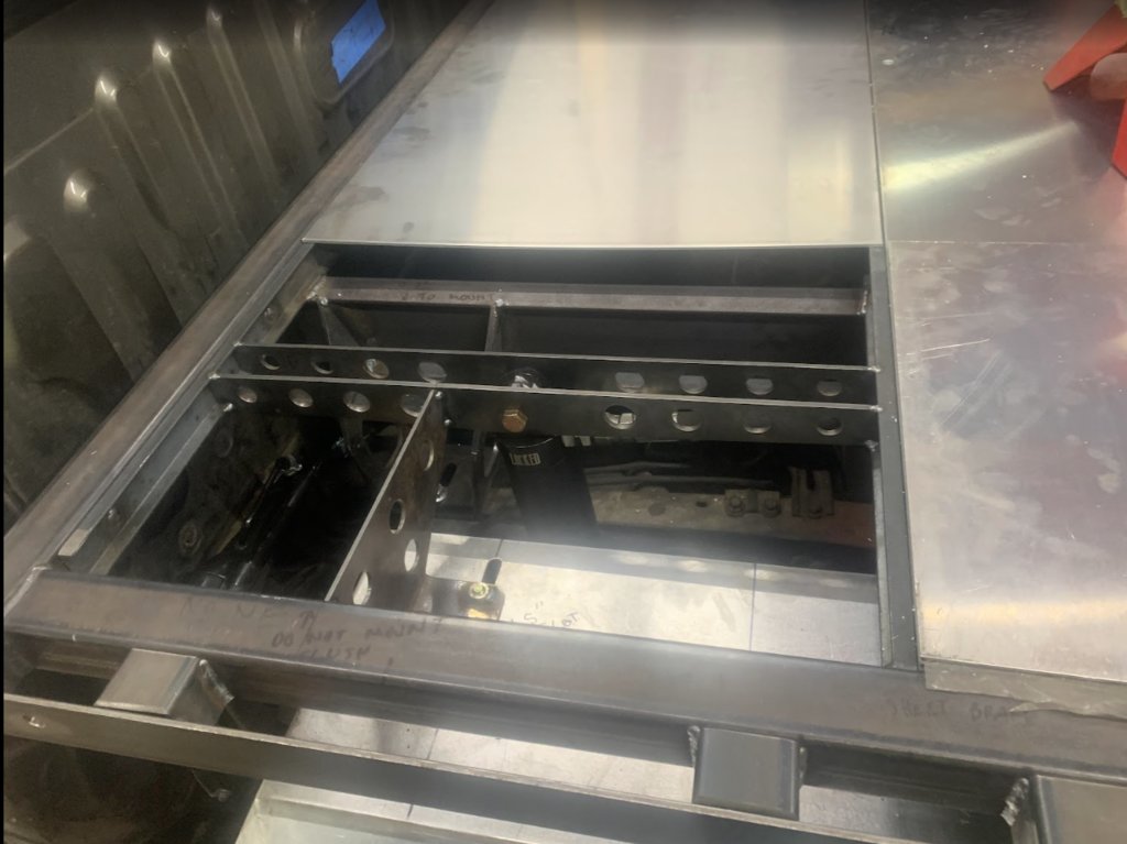

    Popped off the deck and I do have room for these new shock mounts. Will need to redo my fender mount too but I think its worth the tire clearance gains. Resi would go up front. I actually like it better strength wise cause the span is 12" instead of 22" like my current ones
