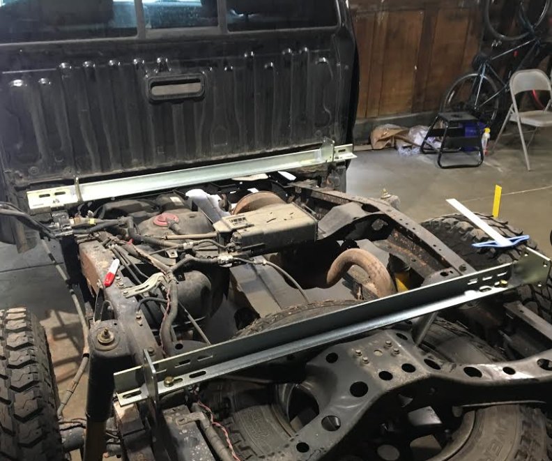

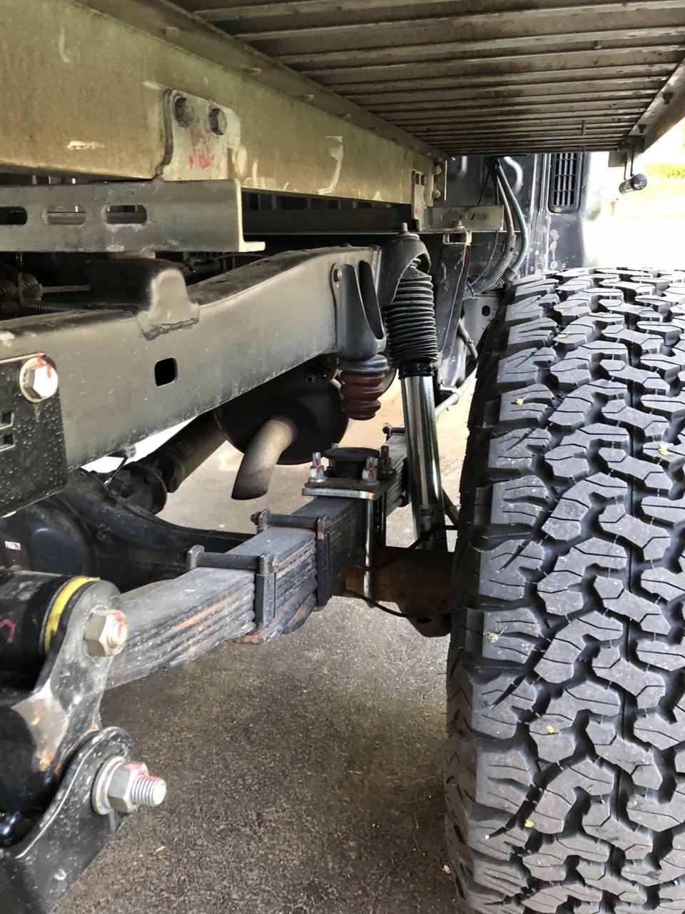

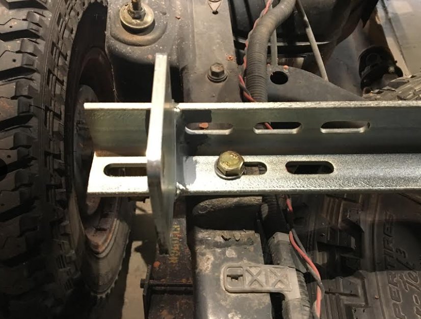

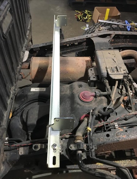

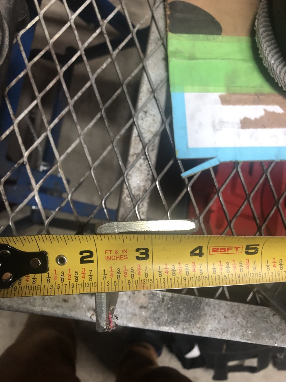

    Here are some photos that I have. If you need more detailed photos, let me know.
    These crossbraces attach to the stock bed bolt location. The plate then attaches to two main rails on the flatbed.
    This kinda shows the rails on the flatbed going into the braces
    As for the filler neck, I am going to try and organize something in the first page. I will highly recommend getting rubber tube that does not kink. I am going to have to redo my tubing as my main hose and the stock hose is kinking based on where I have located my filler.

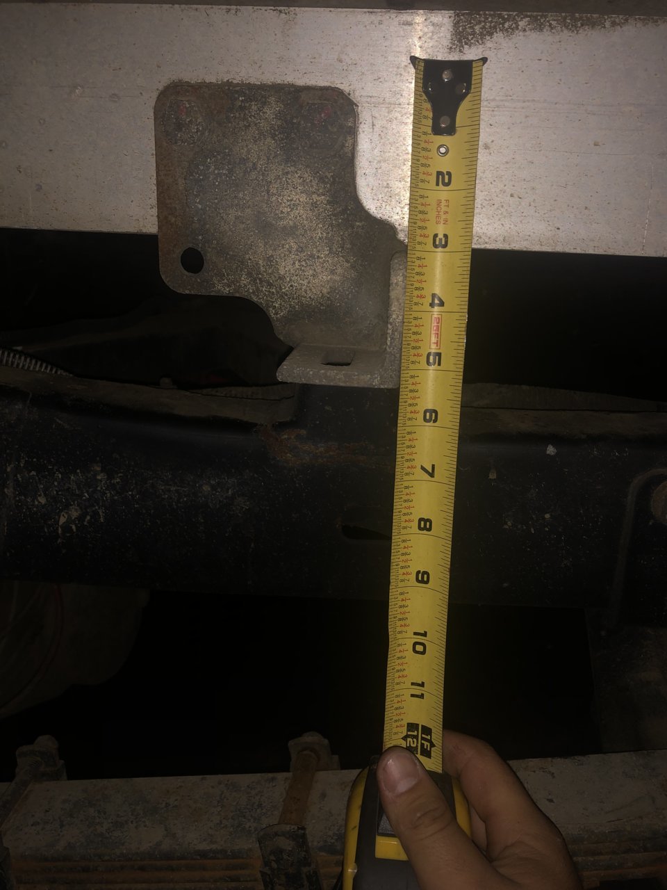

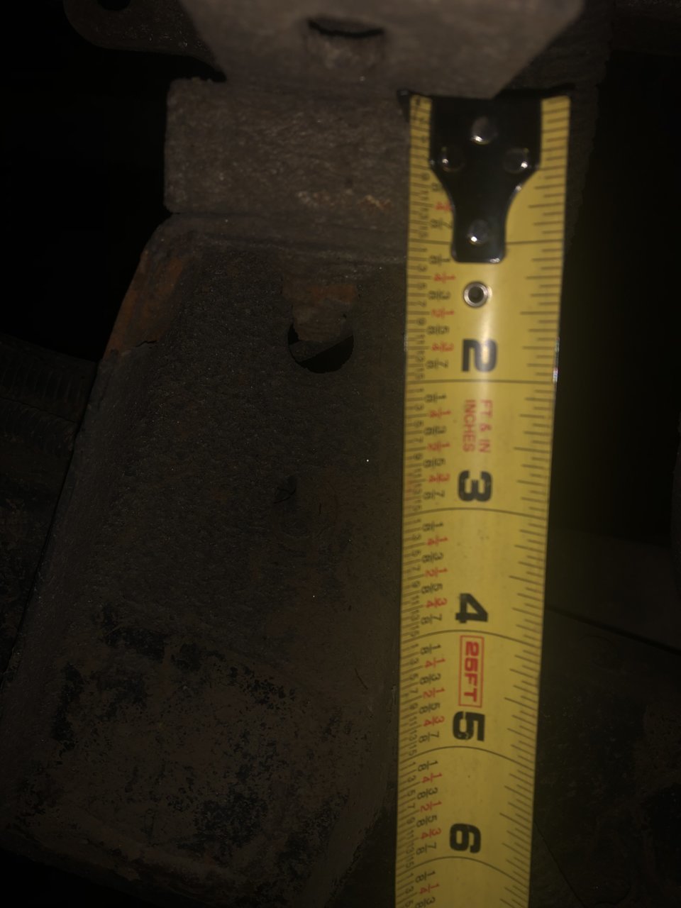

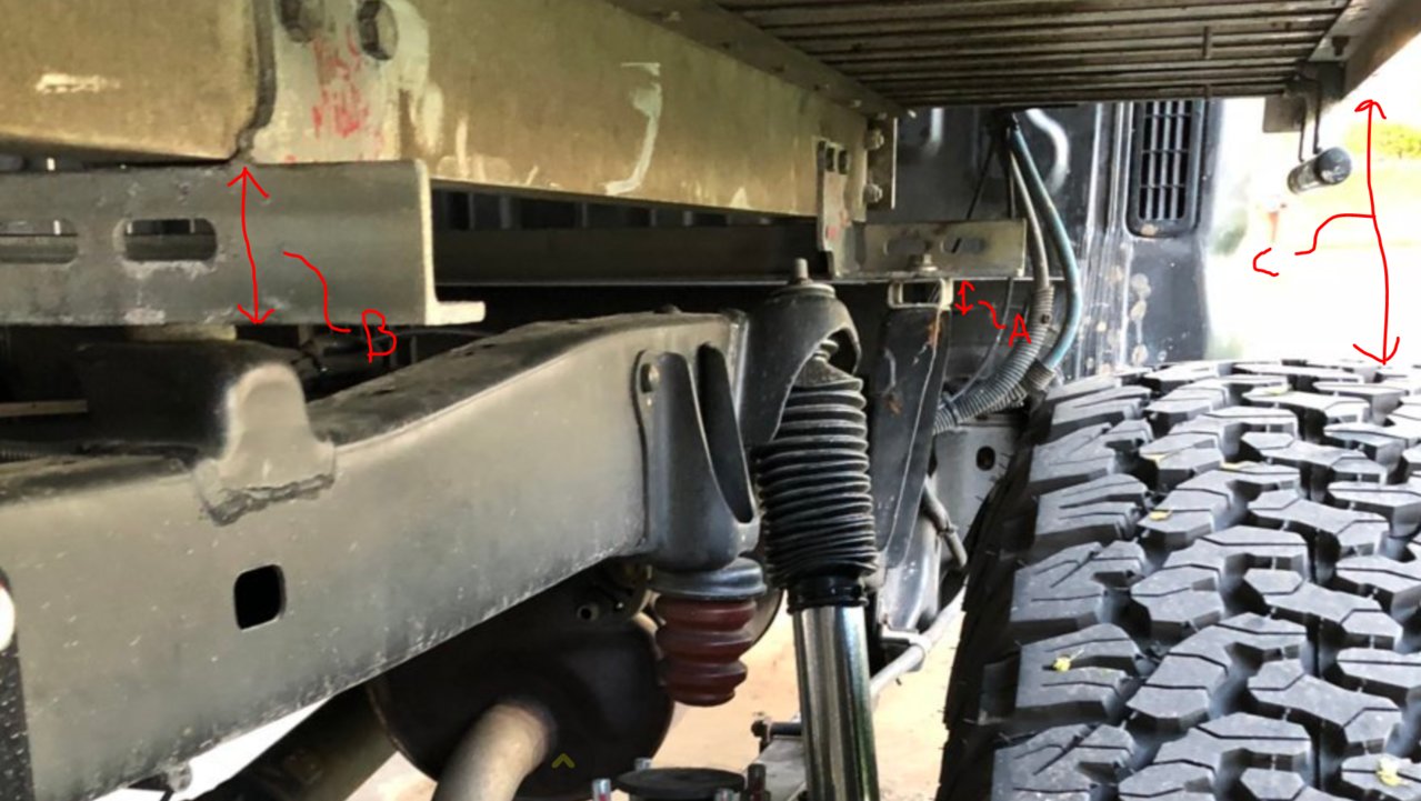

    Looks like yours is from UTE LTD? (With Tacoma specific brackets?)

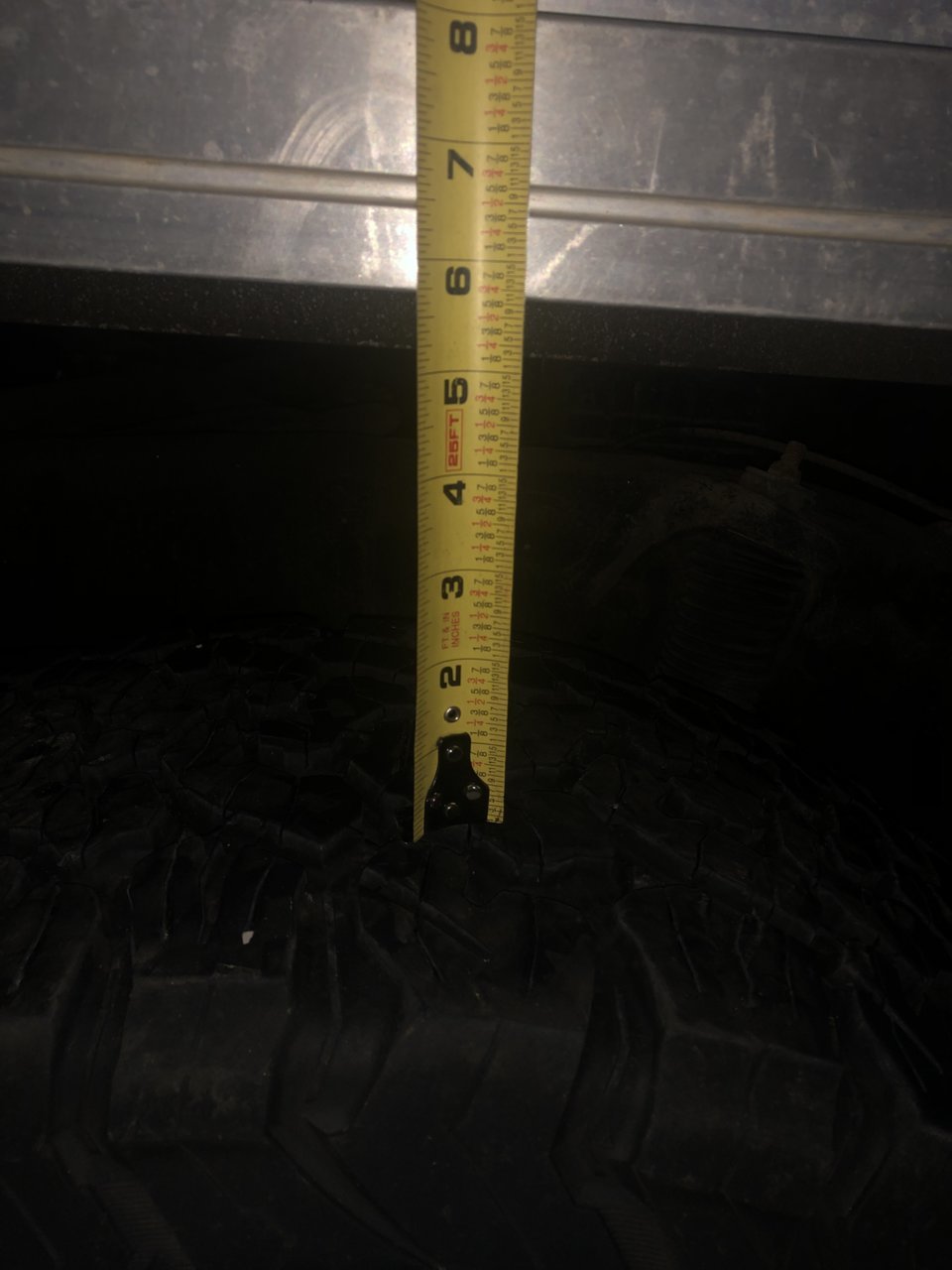

    Any chance you could take some measurements when you have a chance?
    A: Spacer height @ front bed mounts/ front cross-brace (under cross-brace)
    B: Cross-brace height
    C: Tire Outer Diameter to bottom of bed clearance :)
    Thanks!

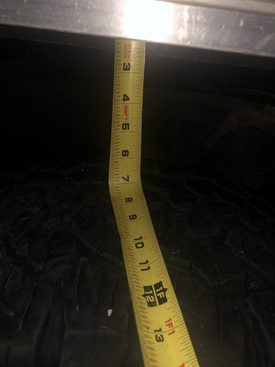

    Spacers height at front of bed are a approximately a 1” tube
    The spacers at the back are approximately a 1/8” washer
    The main crossbars are 2x2” angler steel that is approximately 3/16”
    The main brackets are like this
    I am on 35” tires (ko2’s that are 315/70/17) and I have about 5 11/16” from the top of the tire to the main rail.
    My tires do tuck up on the inside which gives me 7ish”
    Sorry for the crummy photos but it’s dark out. Let me know if that answers your questions.

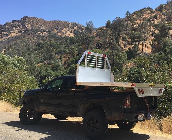

    I contacted Randy @ UTE LTD to see if I could buy some of the cross-braces to mount my flatbed. He seemed optimistic. So I'll wait to hear back, otherwise, I'll mount it in a couple of weekends.

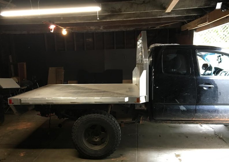

    Here's a picture of the bed when I picked it up.
    I'm in the middle of a camper restoration right now. The intent is to mount storage boxes along the side and have the camper slide in-between.
    I'll start a build thread soon to track the evolution of the truck. On my 3rd setup.

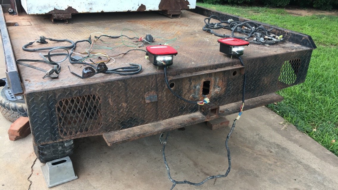

    Not trying to thread jack you 2nd gen guys here but I’ve been trying to solve this tailight wiring issue for some time.
    Recently picked up this 99 flatbed. A shop wired it with trailer lights but the truck had been dunked in a puddle of mud for a day or so. They had stopped working when I bought it.
    Toyota uses a 5 wire taillight harness and doesn’t combine brake and turns. So a 4 wire trailer light isn’t exactly a solid option on a Toyota. But my flatbed isn’t setup for anything but trailer lights. Wish I knew what the shop that built the bed did to wire it.

    I've tossed the original trailer wiring harness as the previous owners had spliced it to death. The truck had a wire and switch running to the battery to power the old lights as just running lights. I assume to prevent cops from pulling them over at night on the highway. All I know is that at one point someone had 4 wire trailer lights functioning off a Toyota 5 wire/pin harness.
    And looking at 99% of flatbeds on Toyota trucks I'm in a weird spot. No one sets these trucks up for trailer lights because combined brake/turn signals makes for a difficult wiring situation on a Toyota harness. I could add a separate turn signal bulb on each side but it would look odd with my flatbed design.

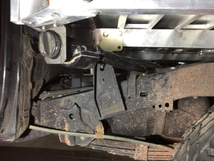

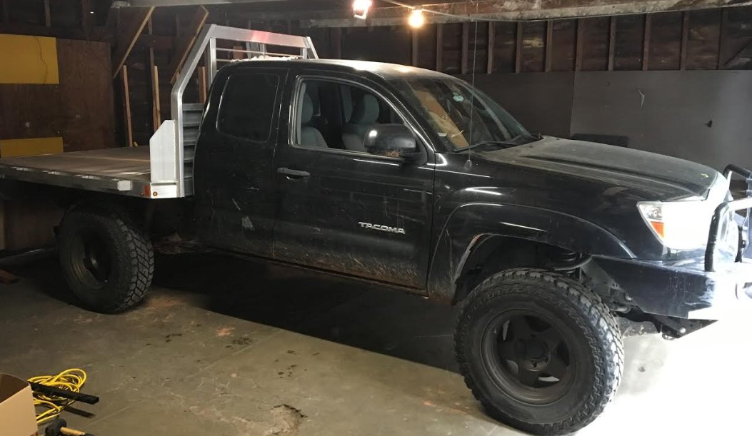

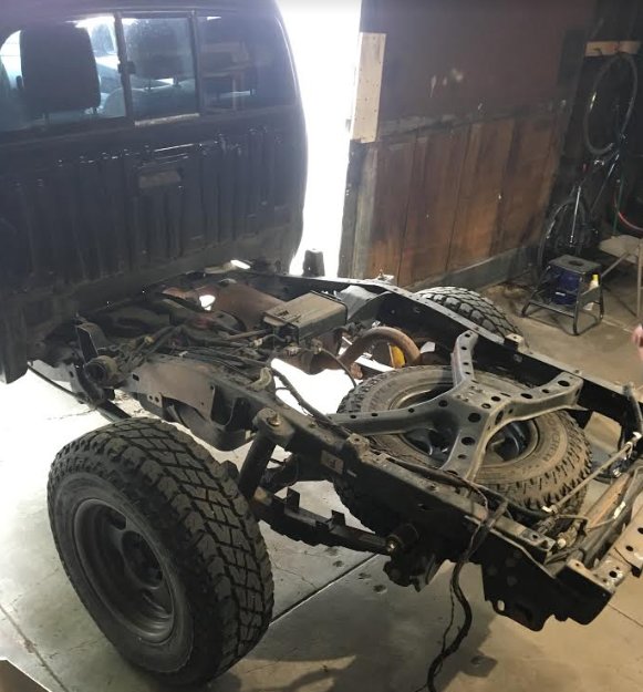

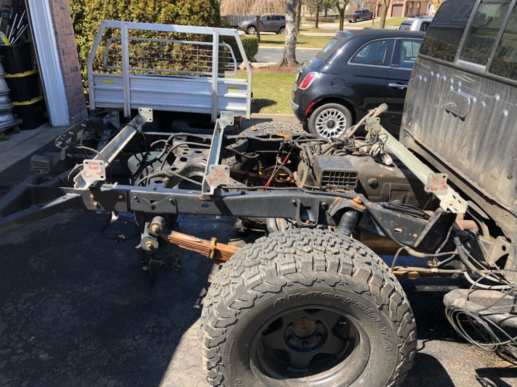

    Finally got my Flatbed installed this weekend. Couldn't be happier with how it turned out.
    Just to summarize, the flatbed is an Aluma 81087 (81"x87"). I used ute ltd mounting brackets.
    Still need to troubleshoot some electrical gremlins, and potentially cut the headache rack down.
    Pictures:
    UTE LTD Brackets installed:
    M12x1.25 hardware into the frame mounts
    Hard to tell, but I used a 1" x 2" rectangular SS tubing to raise the front mounting locations. Similar to what Tacoma16 showed in previous pictures.
    I have the filler tube mounted w/ stock length hose right now (Just loosened and rotated the tubes). Just a mock-up at the moment and hoping to adjust the hose length soon.

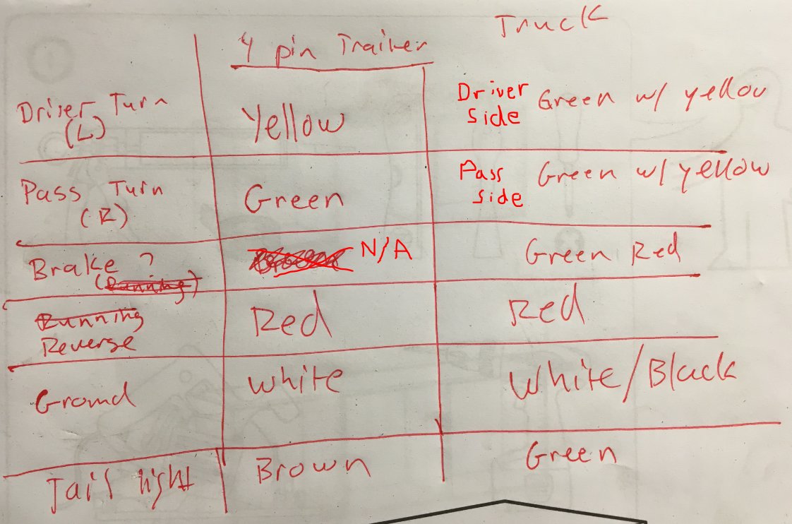

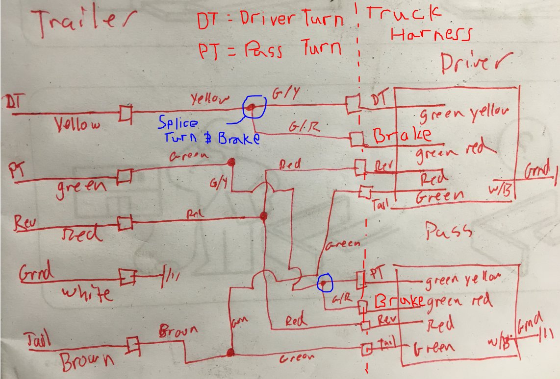

    So I'm running into the same issue. The Aluma flatbed I just installed uses a 4 wire trailer harness. I.E. No discrete wire (or bulb) for the brake light; the turn signals are used as brake lights.
    Currently, I have the harness set up so that the brake signal is spliced into each turn signal but this is causing both turn signals to come on when I use my blinker. I thought there would be some isolation in the stock electrical system...guess not.
    I think I'm going to try and add some sort of diode or isolation on the brake signal and turn signals. Going to order them next week and hopefully have an answer by next weekend. I'll keep you updated.
    Here is how I have things wired up (and yes, that's on the back of Ikea instructions :) ):
    *EDIT: This setup does NOT work when installed on the truck, but works fine off the truck. No Isolation in the brake and turn signal circuit upstream of this harness.

    Re: tail lights and turn signals.
    If I’m understanding the problem correctly, some of you guys are wanting to use a combination brake/turn signal bulb in place of the factory separate turn and brake light configuration.
    Trailer wiring adapters for 5 wire to 4 wire are readily available. No need to reinvent the wheel to work around this issue. You could use the adapter for bed or trailer lights, or even both. They are about $15. It’s an easy way to solve the problem.
    https://www.amazon.com/iit-16690-II...0465&s=gateway&sprefix=5+to+4+,aps,245&sr=8-6
    Or a direct plug in version for about $40
    https://www.amazon.com/CURT-55513-V...-8-1-2229-272-&vehicleName=2008+Toyota+Tacoma
    Hopefully this will help someone.

    Ahh, doh! Thanks for pointing that out. That's definitely what we need.
    Going to order one today.
    Otherwise it's:
    A) Add a separate turn signal light to the back.
    B) Add diodes to Brake and Turn signal lines.
    tacoma16[OP] likes this.
