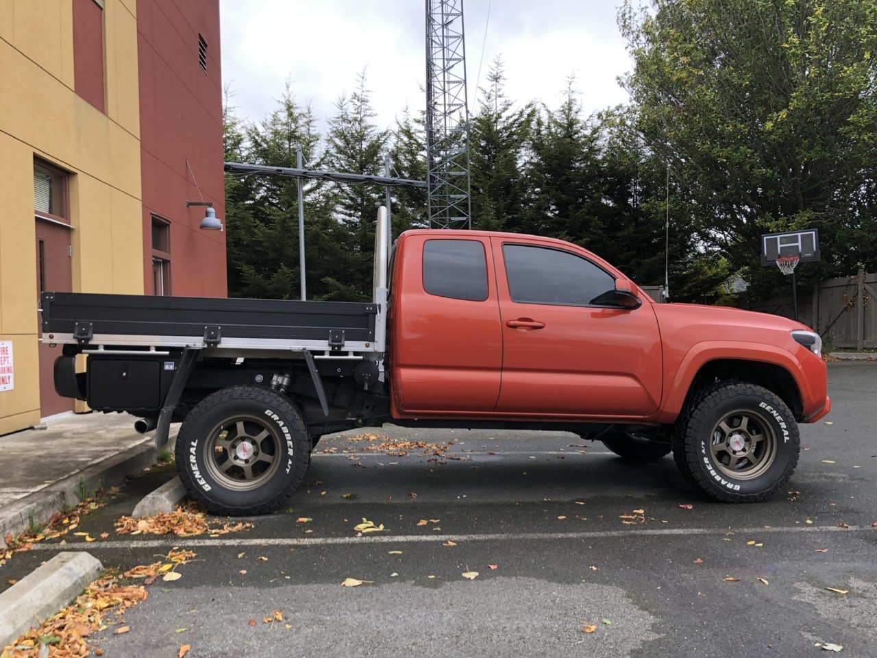

    Had the Ute now for two years and love and use the hell out of it. This summer I worked on filling the dead spaces underneath. There is an eight gallon grey water tank up front, made from 7” sewer pipe. Behind that an Aviair compressor with 2.5 gallon tank and ports on both sides. I just installed the side boxes from Triple M, and between them at the rear is a two by two ish flat shelf for throwing in fire wood or the grill.
    Lights were a problem too. I get a hyper blink when I use the brakes and signal at the same time!

    As far as adding resistors to stop the hyperflash, you can try asking @MESO or the VLED guys here. Bed looks great by the way!

    I tried resistors with no luck. I think I need to find a five wire light or add another brake light. Just not super excited about tearing into the wiring again.

    I stopped my hyperflash completely with a different flasher under my dash. Not sure if that's a thing on a 2nd/3rd gen.

    That's a thought. I did read somewhere about modding the resistor in the flasher unit. I hear the unit is a pain in the ass to get to. It's on my list..

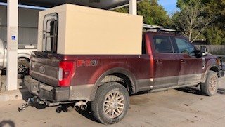

    Although I don’t wrench, I do build other things. I made a topper last spring for my big truck. It worked well enough for a 3500 mile trip, which included some overlanding (and probably a 3k+ trip work trip coming up after Thanksgiving), but I want to steal the hardware off of it and build a new load bearing body for it (it was not strong enough for a roof rack). While sized to fit inside a F250 bed over the wheel wells - I think it will be a pretty good fit for for the 66077 (other than height-which was great inside, but a bit much on the road). Having 1 topper for both trucks is a nice bonus. Will test fit it once the bed is on the truck and then start that rebuild. I also have trailers it fits on, but it wastes a lot of space doing that.
