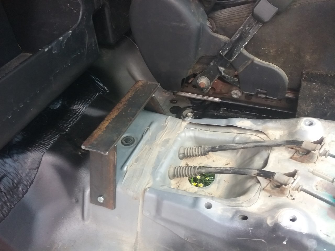

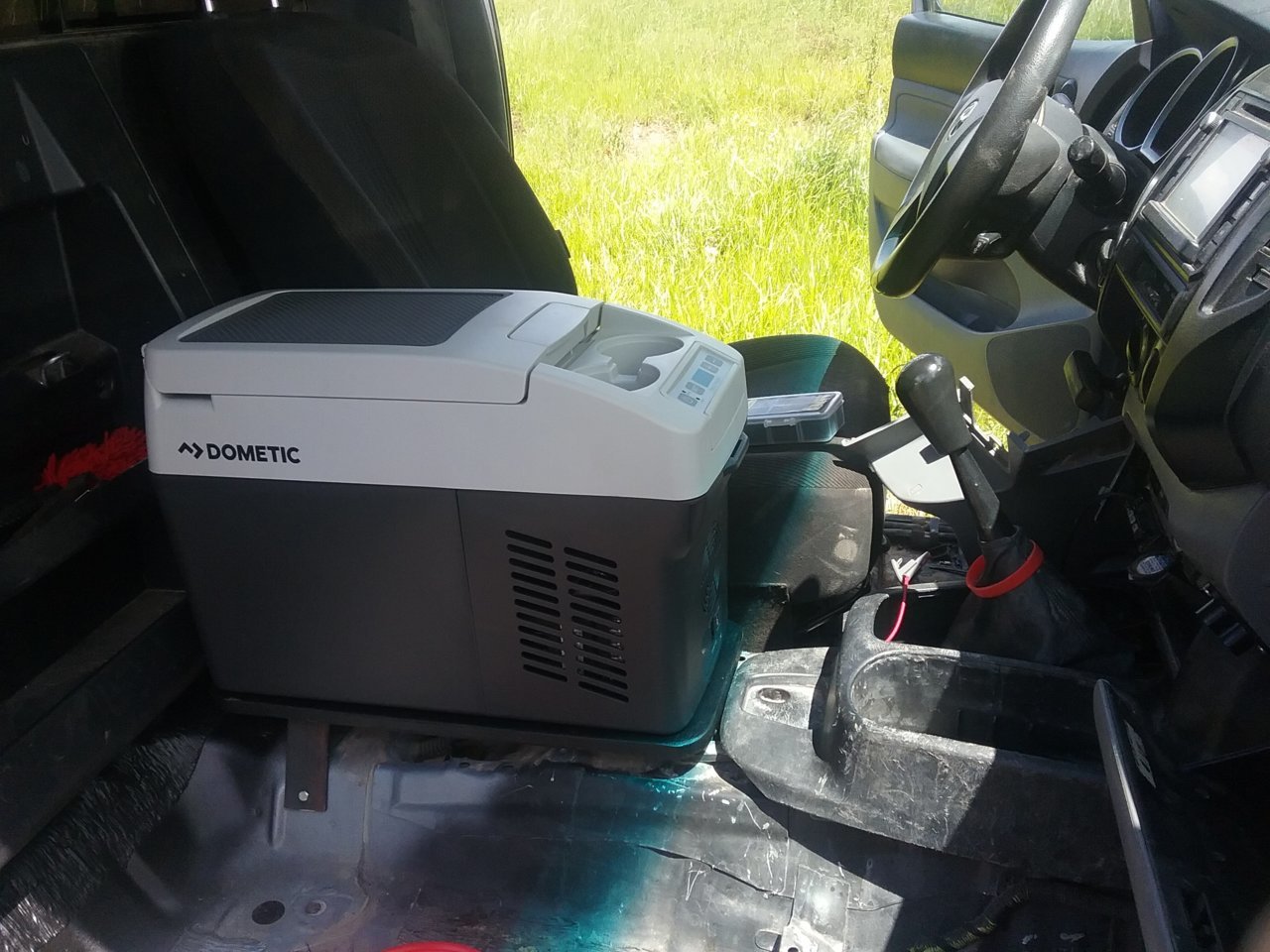

    Some updates on the truck. I have done a few mods to it. Including bucket seat swaps and center console fridge. But most impressive was the deep water mod. But, after it gets out of the shop. I have some dakars and a u bolt flip kit to go under it. If yall want pics I took some.
    Here is just made a bracket where the factory console bolts too, then just set a piece of plywood on top that I painted with bed liner. Then the fridge sits on that with industrial velcro at the from, and a bungee at the back to hold it down20180426_142414.jpg

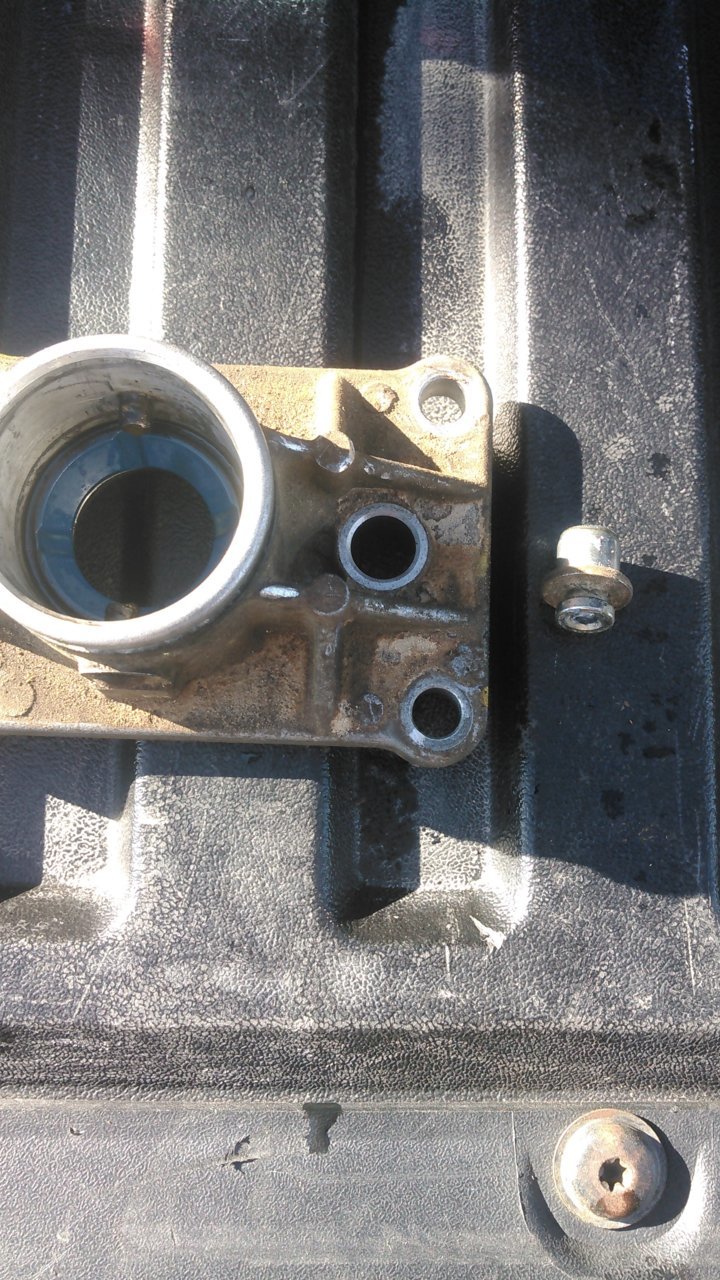

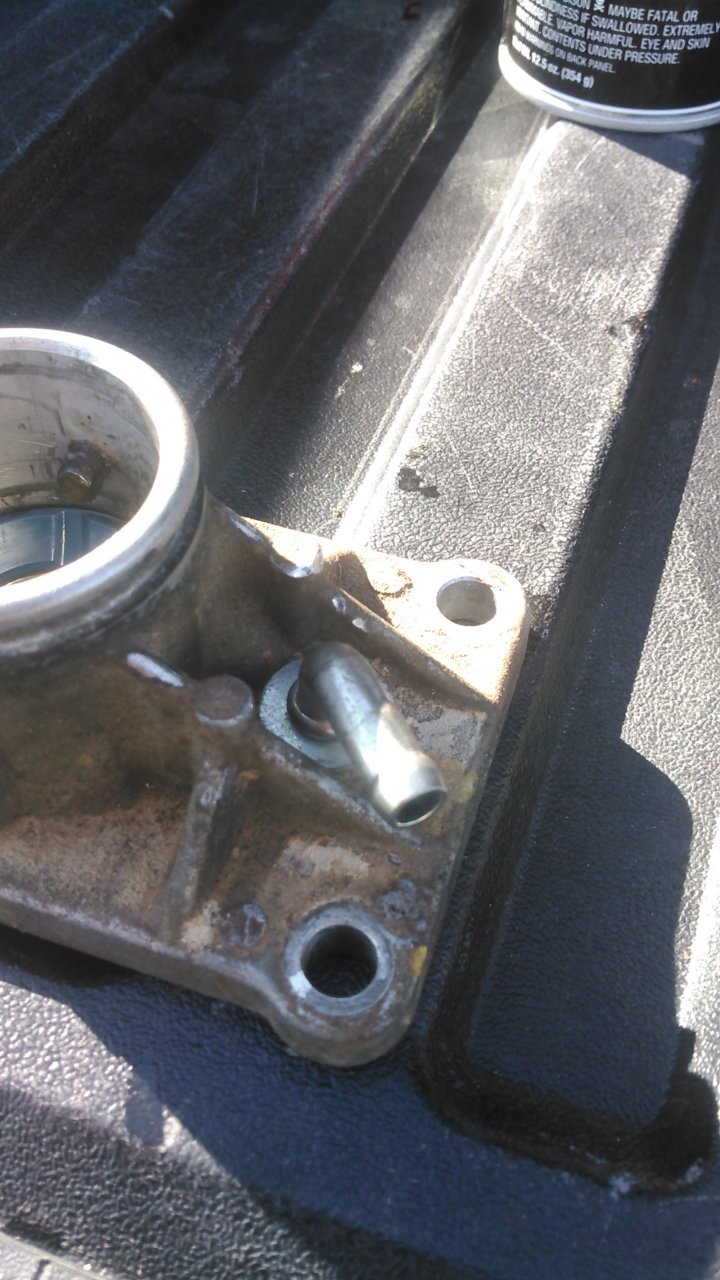

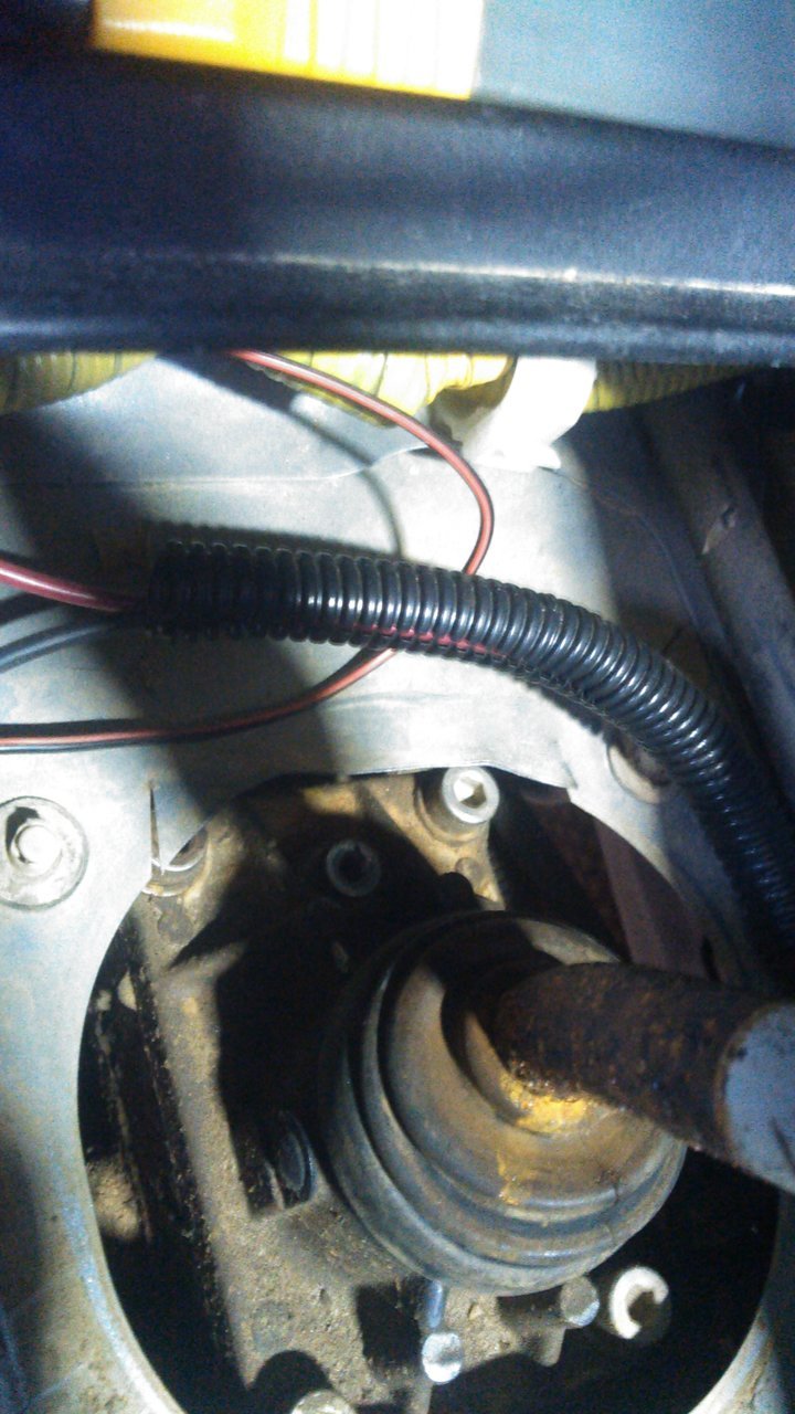

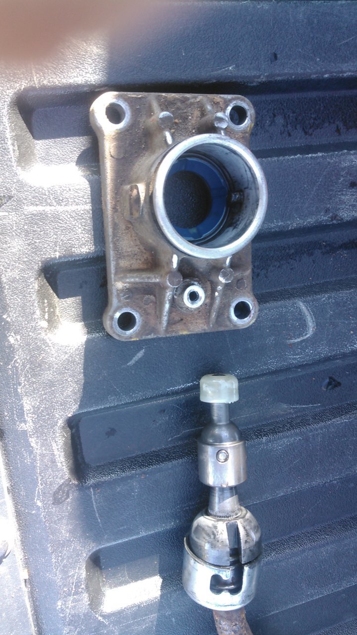

    Extending the transmission breather today
    1552832223847-455662367.jpg location of breather
    1552832877737-1602612421.jpg remove assembly
    1552833208056408121184.jpg remove breather

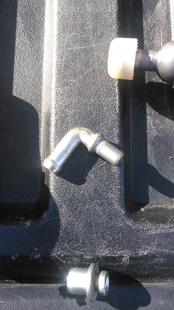

    So the inner boot sits right above the breather, so it can't stick straight up. So I got this part.1552834202787-2069806496.jpg it's the brake booster vacuum fitting off of a first gen throttle body. So drill out the original breather to a 5/16 hole, press new breather into hole, and you should end up with this.1552834421691-171289462.jpg
    Breather sits below boot hight. Then connect your hose and run to your desired location. The press fit of the original part should squeeze the vacuum fitting and hold it in place, I will check it later to make sure and if not I will weld it in.
