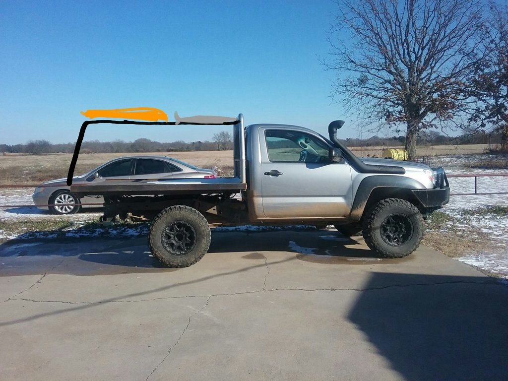

    Ok so I am starting my transition on the bed towards vehicle based living. What yall think about making something like this? gray is solar panel, orange is a set of larger TREDS. I would put a arb awning on one side or the other. I already have a second battery under tray. Eventually I would like to learn how to sew and make oil canvas sides for it.

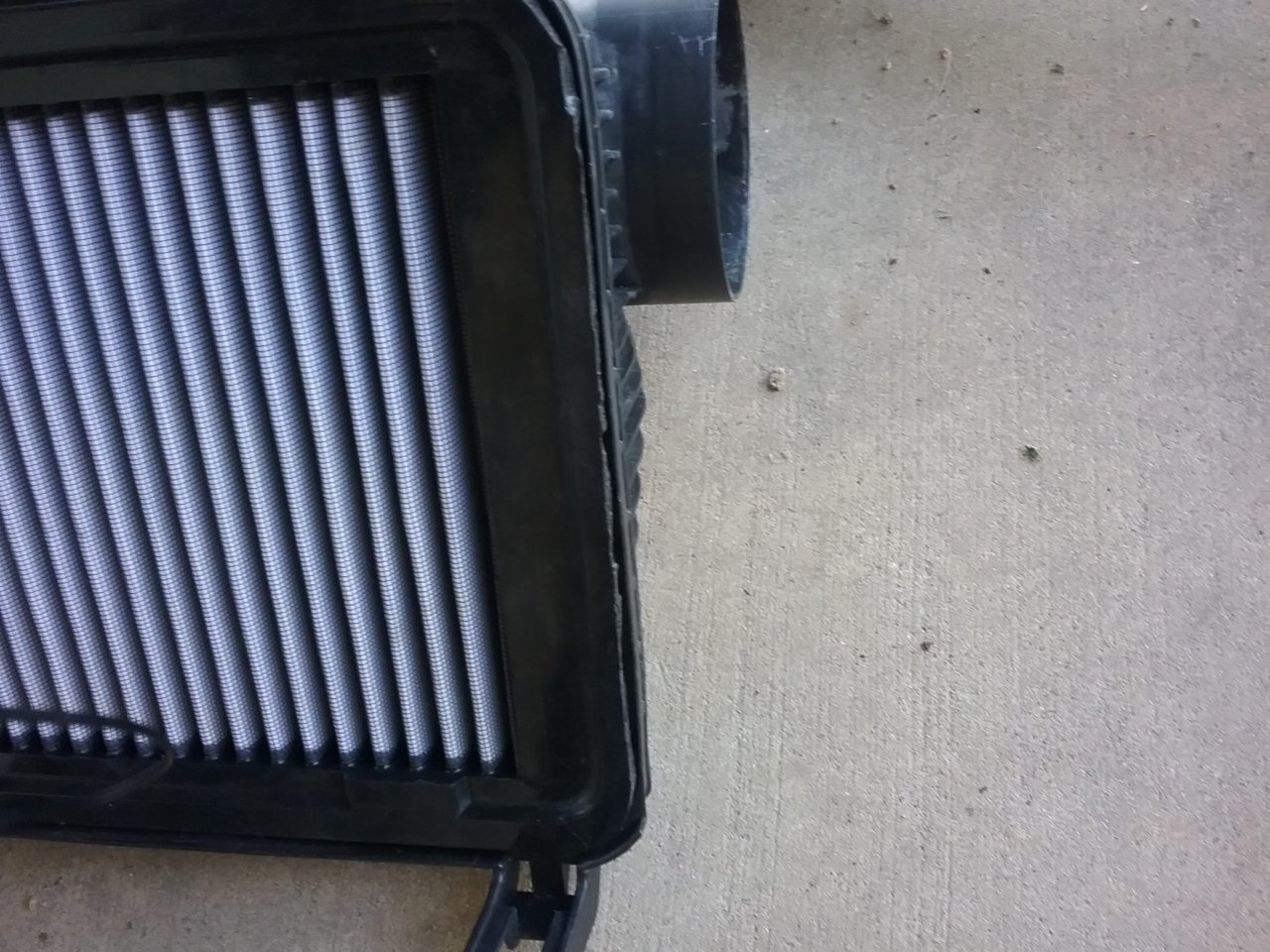

    Well I got seats and fridge installed, write up with pics coming later.
    with my recent water action, I noticed the airbox wasn't sealing worth crap. The afe filter was too long, and the edges were riding on the lid lip instead of the inner lip like the stock filters do. So I trimmed about a 1/4 inch off both ends with some scissors. Now it rides all snug down in it like the stock one.
    While it wasn't allowing dirt in the top past the filter, it still allowed dirt and water into the lower part of the box.
