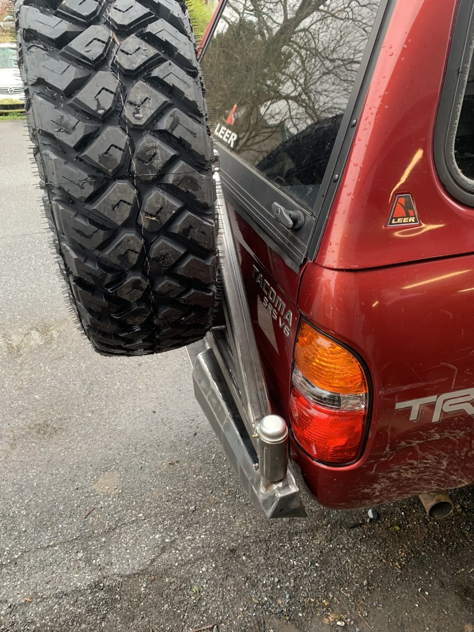

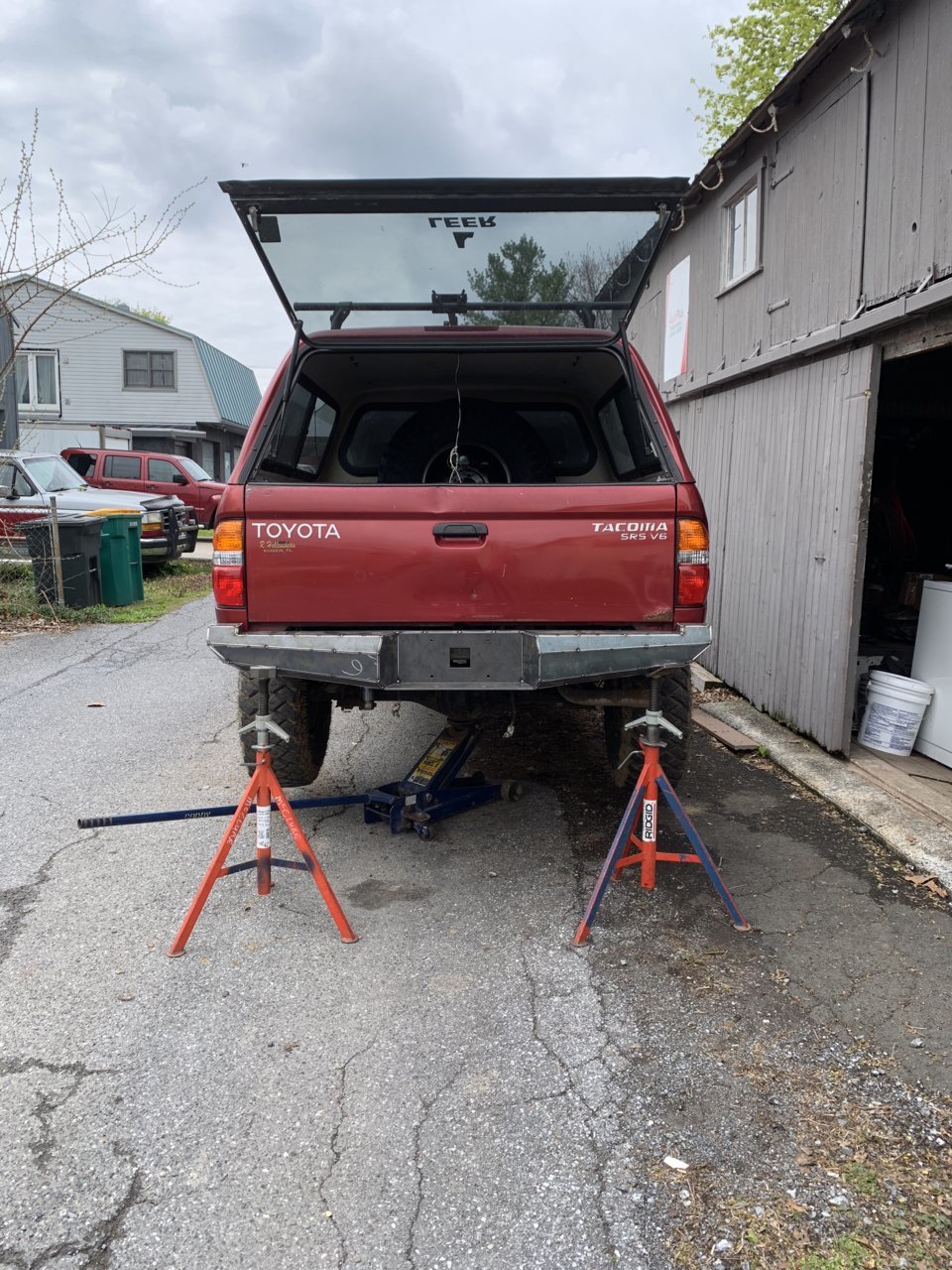

    Just finished building my rear Flatland 4x4 bumper. I also made a swingout for it. I researched before i bought the CAD drawings and haven’t seen anyone who’s build one on here. So figured i would post it up if anyone is Interested in building one. The bumper was super easy to fit up and weld. I would recommend waterjetting the parts, rather than a plasma table. There are quite a few holes that will
    be cut out and the waterjet does a much nicer job. Overall i’m pretty happy with it!

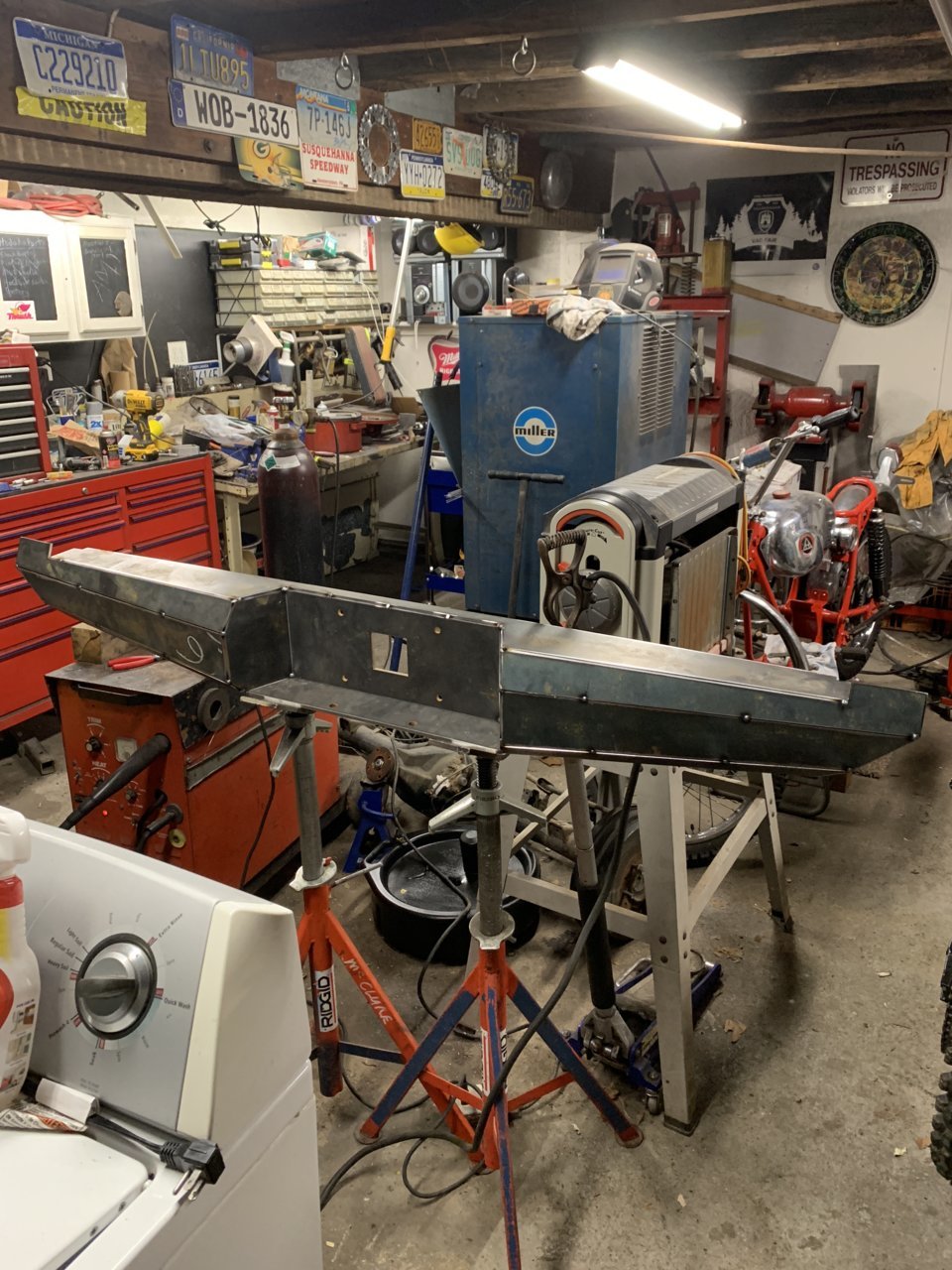

    Very Nice, maybe a little off topic but what set up did you use to weld up your project.

    used an old snap on welder. it is a miller systematic made for snap on. it welds really good for what it is, and had no problem with the 1/4” plate. I am also a welder/fabricator for a living so that helps. I don’t know how people use a 110v flux cored welder for these bumper builds. imo that’s dangerous because it is NOT strong. Especially not for a tire carrier

    Now that is a Normal looking shop Is that a 300 or 500 in the back ground??
    We tend to get spoiled with better equipment then the skill level plays in I would have no problem with a Miller or Lincoln 120VAC running self shielded wire welding (even hating self shielded wire)on a tire carrier.

    The self shielded wire is okay to a point, especially if you have a higher powered welder that can actually get hot. But most of the time if you have a competent machine, it will have a gas hookup, so why even use the self shielded wire? Tire carriers are under a lot of stress especially when bouncing on the highway and stuff. To each their own though!

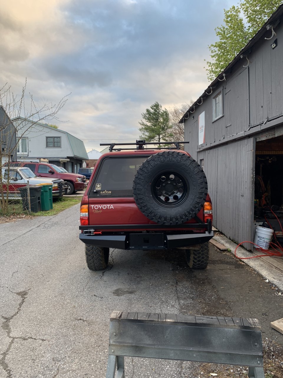

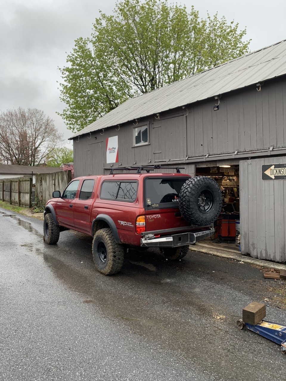

    all painted up and finished, going to end up getting this powdercoated. i needed it protected for this weekend for a cabin trip so a shitty paint job will have to do for nowE34B2651-0DF3-4F0E-9CB4-51BFE75A34BD.jpg
