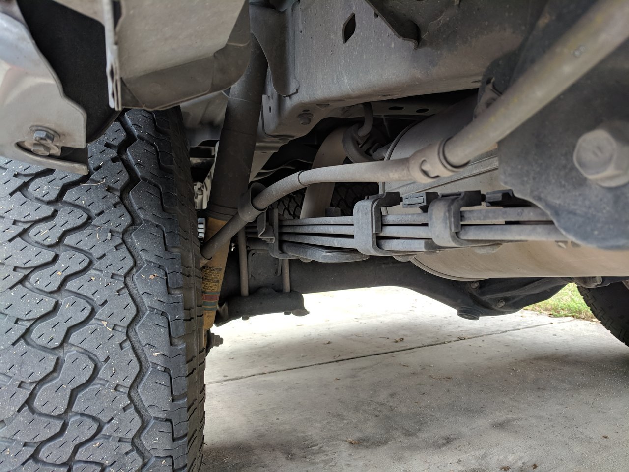

    I couldn’t find one either but I called and asked. They set up an apointment to check them out for the tsb. I bring it in Friday so I guess I’ll see what they say

    What’s your source? I couldn’t find this.

    Those are official toyota charts from Toyota themselves on how to identify whether somebody has new leaf packs already or not. Unsure what it is for 1st gens though! As far as i know i thought the TSB was for second gens only 05-15. Im interested on what your dealer has to say about them, let me know!

    Its for my GFs second gen. She has a 2011, and her leafs are shot. Ive identified them as the 3 clip leafs shown in the diagram. Im hoping they replace them and then ill most likely add an AAL for the additional weight she has (camper shell and bed platform). She doesn't want the ride to change to change much, she has kings all the way around and the front are set to about 1/2" lift. Shes a bro lean right now for sure tho! lol

    I bet that thing does have quite the lean with the cap on it and the weak leafs. Yes if its anyone of the red ones it should be under the tsb. I bought a 2" aal off Amazon for 50 bucks shipped to my house. Threw it in the tab pack and it has served me pretty well.

    The TSB is mainly for us early 2nd Gens. They caught the problem and issued the TSB for 05-11 Pre-Runners and 4x4s. 2012 and newer already have the 4-leaf packs.
