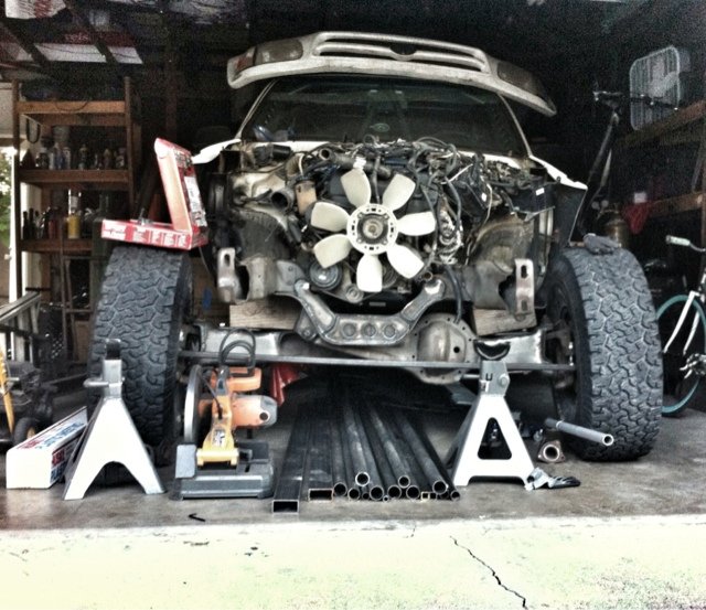

    Well now that i had the fuel cell, it wasn't race truck enough, so I went to the next stepped and starting stripping the interior.
    Then it began..
    Finished the cage, laid down some paint, and also some "peel and seal"

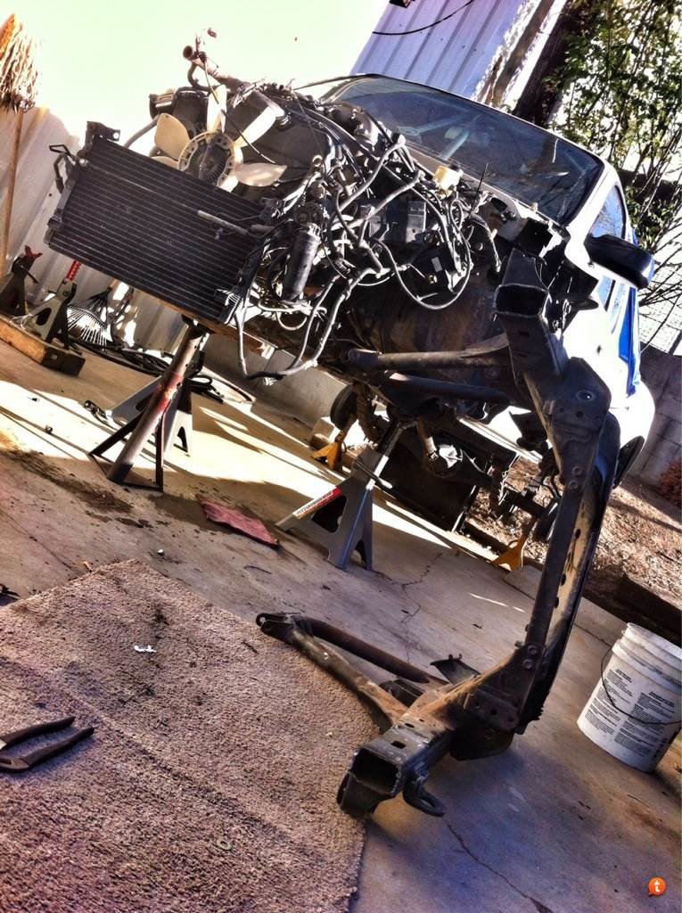

    The run went great until on the way home i was dropping off a friend that had a dezert house out there and apparently didn't take the same road i picked her up on.
    Ended up breaking the inner tie rod, ripping out the heim, and tweaking the upper arm mounts, it was a rough hit. Note to self: never be in a rush in the dirt.
    So that all had to go! And a good thing i decided to.
    Ended up doing a upper bushing, lower balljoint, and 5 lug spindle delete.
    Must of been welded on a monday..
    Next that had to go was the crappy 5 lug lift spindles and ball joints.
    So i cut out the lower balljoint slug and fit a uniball and mocked up some 84-95 Pickup 4x Spindles.
    Pretty stoked on how they came out
    Finished product.
