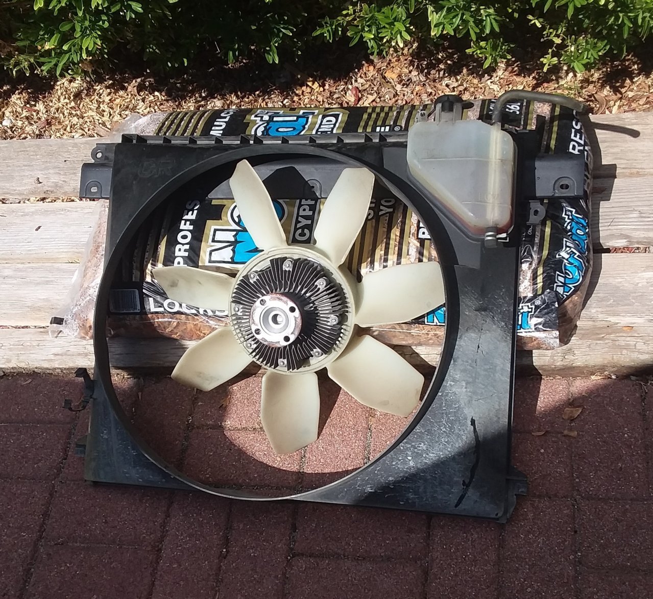

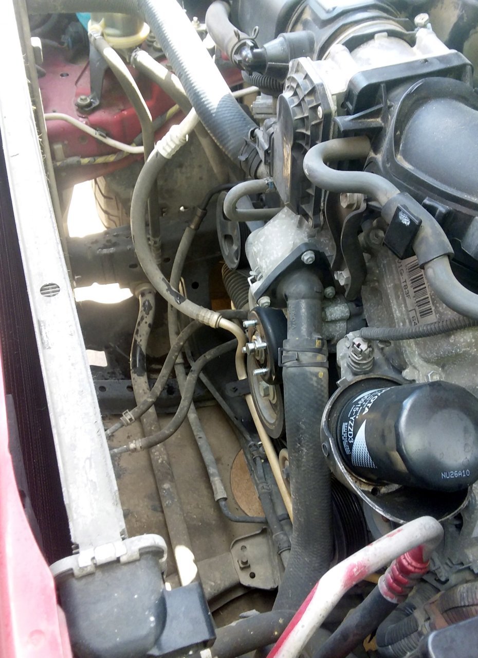

    I am very out of practice in creating anything.... Here goes. My fan clutch sounded like it was dying a grinding death, so I read the FORUM about anyone doing this - and I have to thank "loginfailed" right off the bad for helping me locate a wire. So, given I found the fan at half price at Amazon Warehouse, it seemed like more fun than just a new expensive replacement. ADVISE: I'm old, it's hot, I work slow, and take pictures and breaks! So, off the bat, I was only missing one 10 mm nut, you WANT more #10 wire (8' rolls will do, match your fan color wires), have tie wraps on hand, and if you want shrink wrap (I do), get plenty. Then, it will go fast. Also, I inserted pictures OUT OF ORDER that make the install go faster than mine. Yes, it is quieter. Yes, the engine is more responsive. Yes, it is running cooler, which helps the AC very much here in TX. Will it improve mileage? I log everything, and it runs a pretty controlled environment. I will know soon. Hope you enjoy.

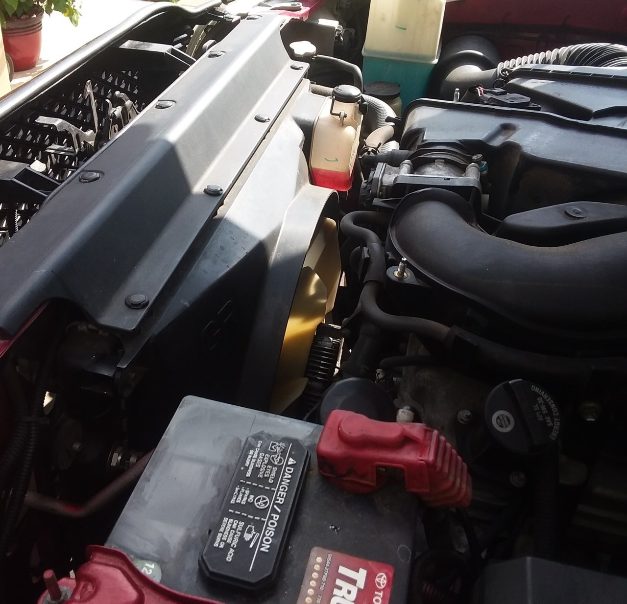

    Remove the covers, and then unbolt the fan/clutch from the pulley.
    Tip the shroud back, and grab the fan, pull them both straight up. Look at that room!
    What got pulled out

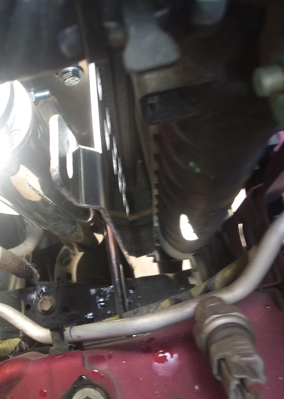

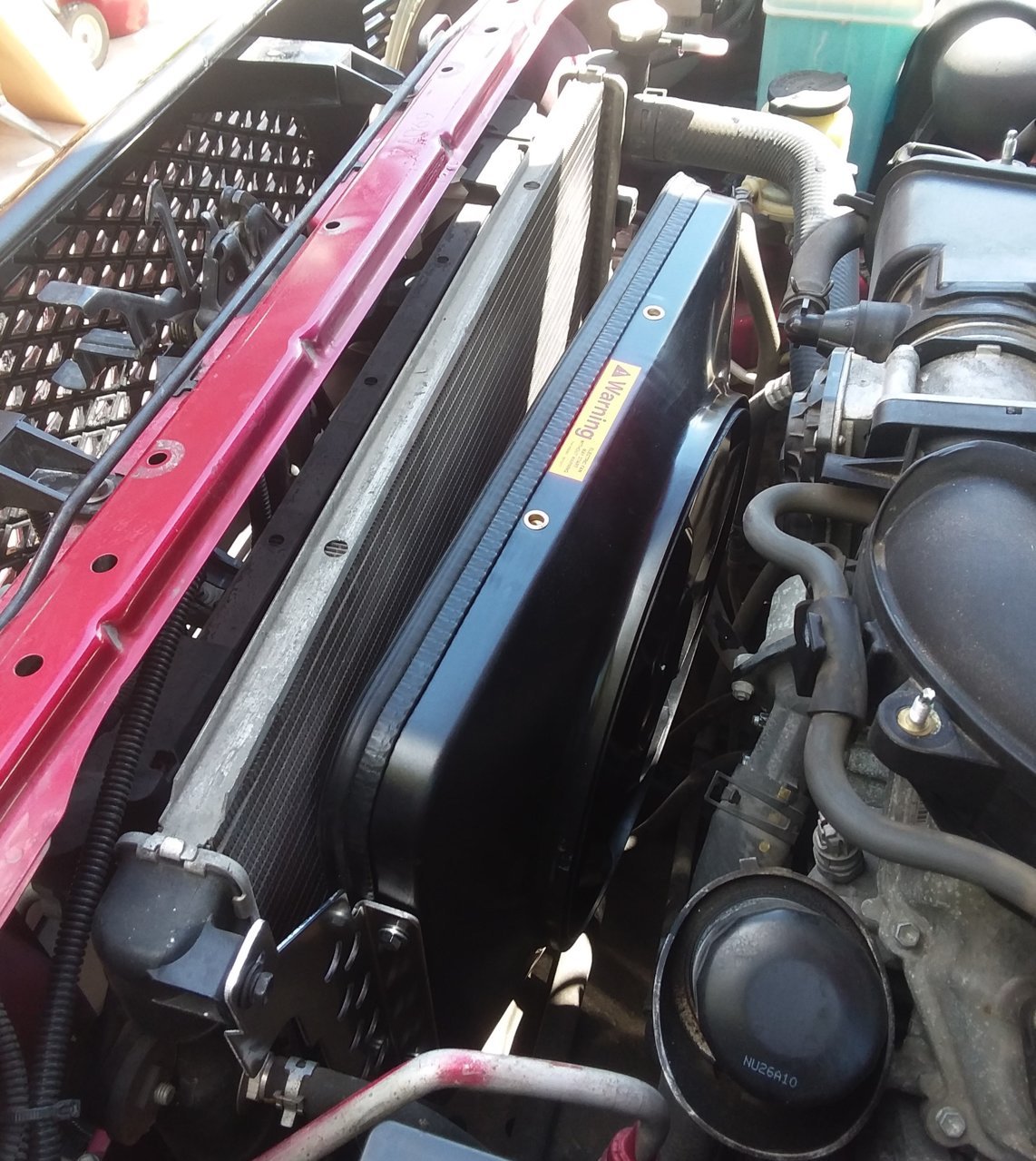

    NOW, you can install the drivers side. There is a SLOT at the bottom of the radiator that the bracket will fit in - then loosely install the bolts, including the top shroud bolt you removed.

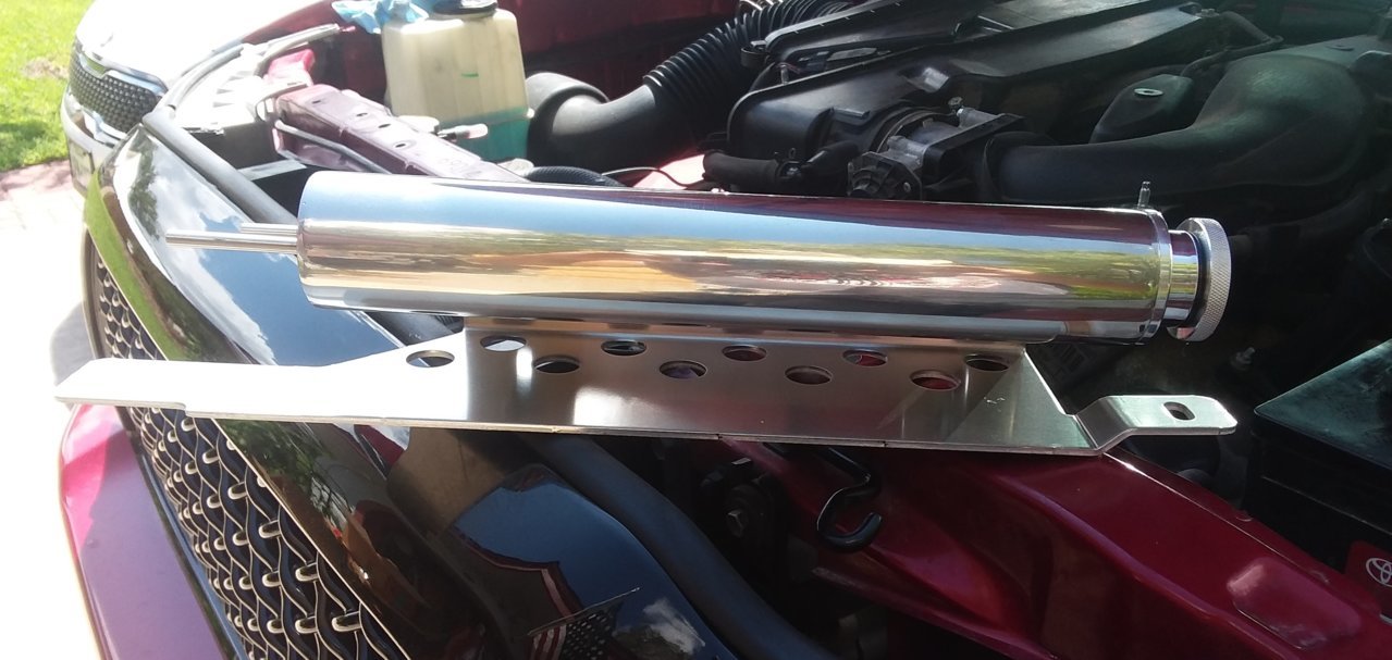

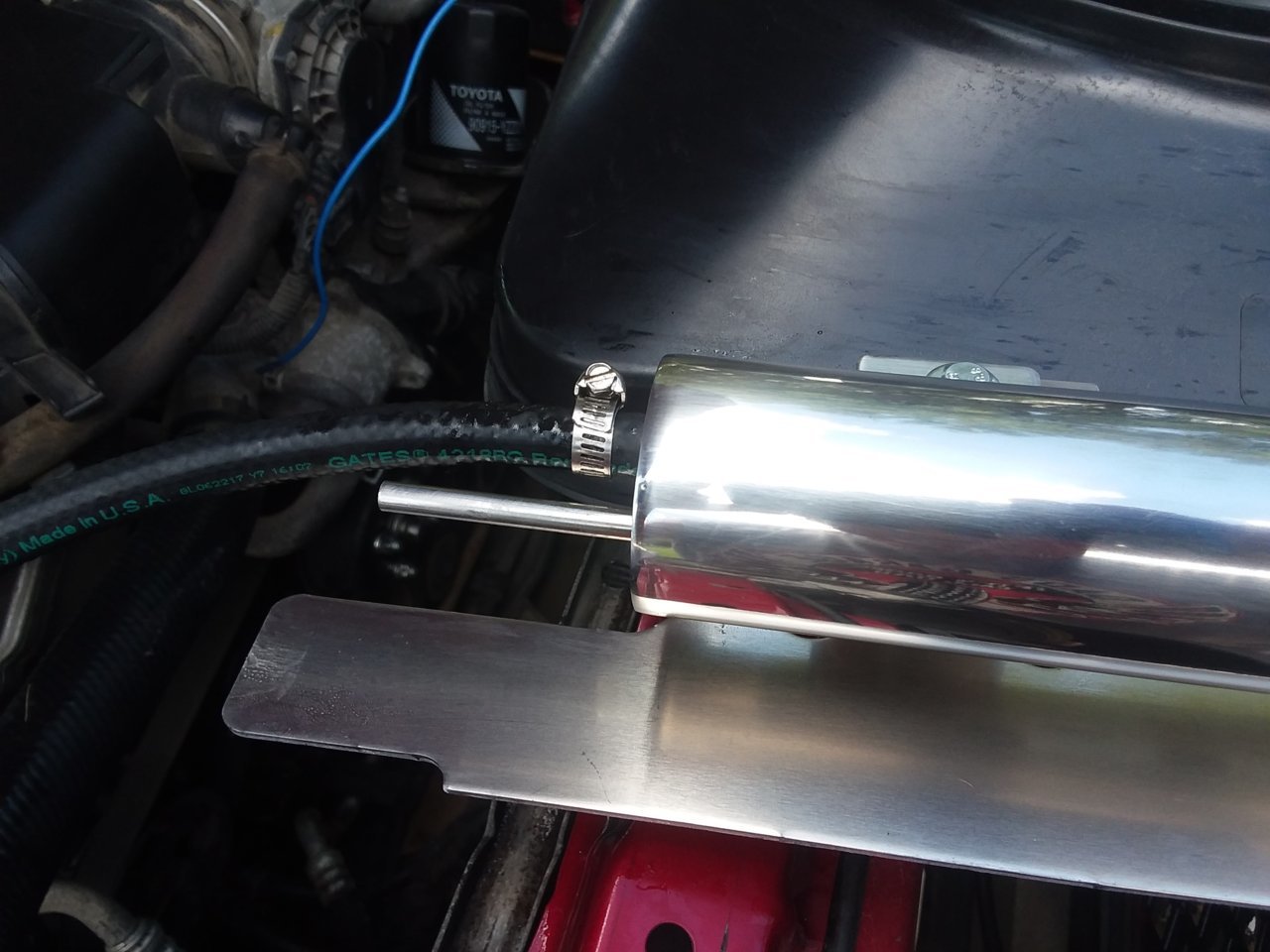

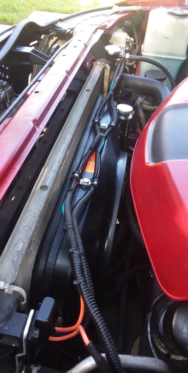

    Next step in the install is to mount the overflow catch can to the passenger bracket.
    NOW, AGAIN, AVOID THE INSTRUCTIONS. You need to install tubing onto the SHORT tube at the bottom, and secure it. DO IT NOW! (You can't see the connection when you install, and the coolant you pour in will leak right out!)

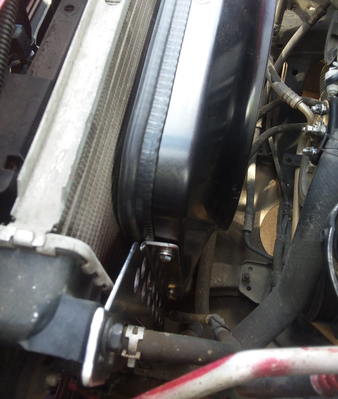

    Now, you can install the passenger bracket the same way. Loosely attach the bolts for the bracket and the top shroud bolt. Again, the bottom fits in a slot at the bottom - if the shroud gasket isn't up against the radiator, you missed.
    Then, go criss-cross to tighten the bolts, pressing the shroud to the radiator. They say if you compress the gasket 50% you are good. I'm not sure I got that far, but it was even and consistently closed.

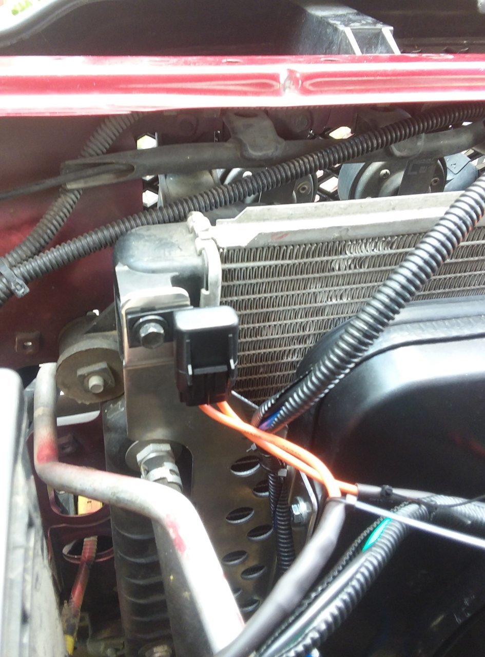

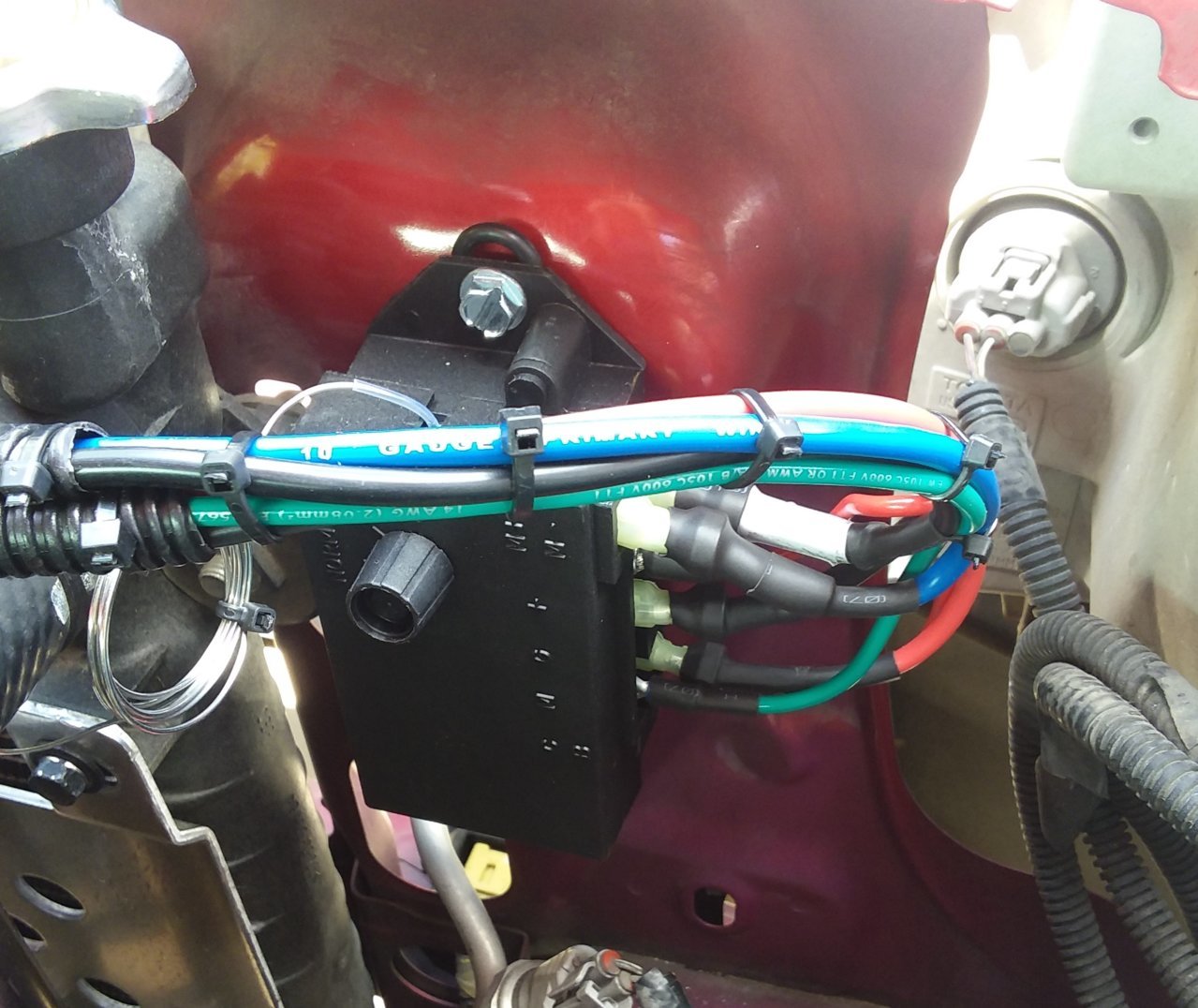

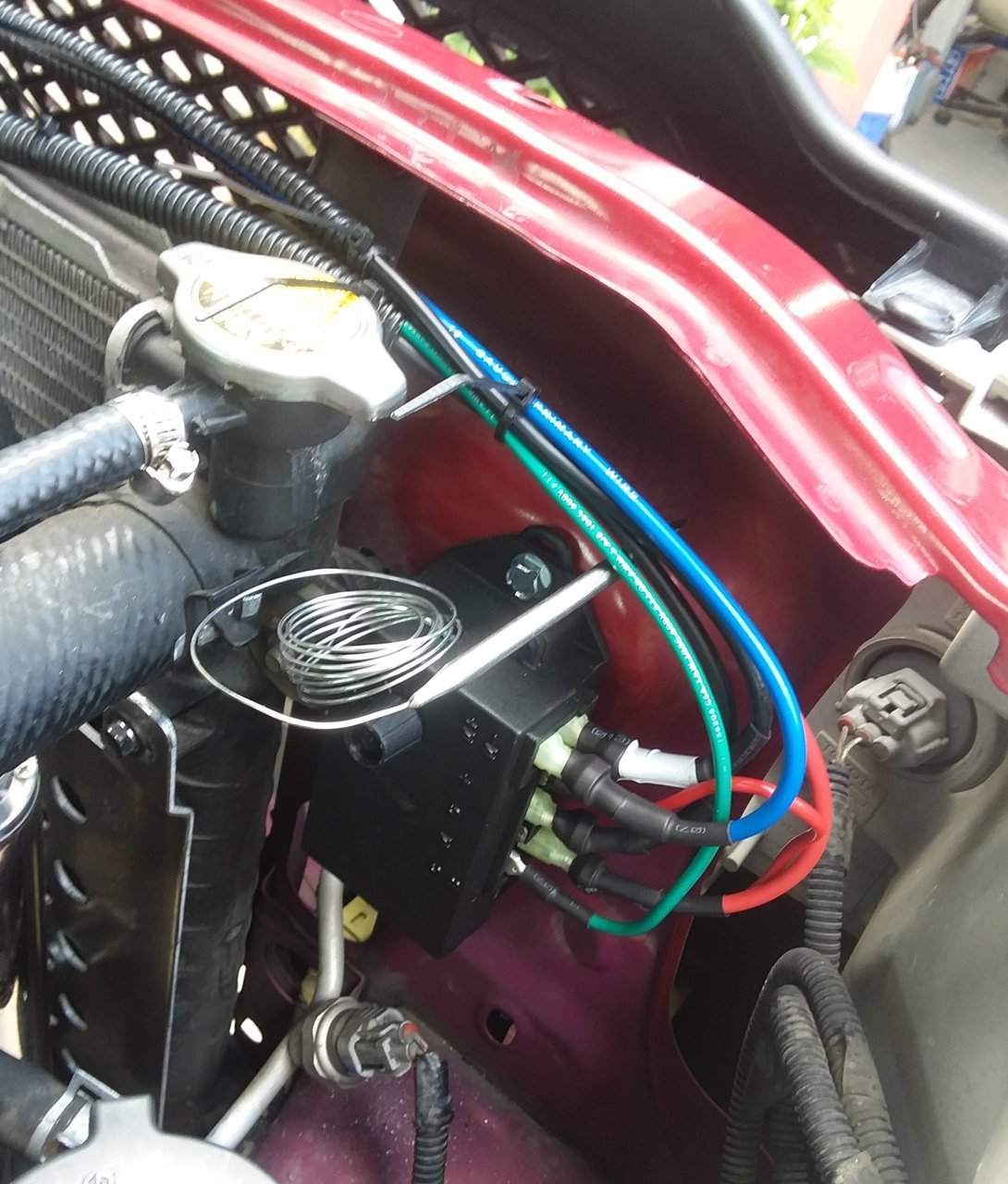

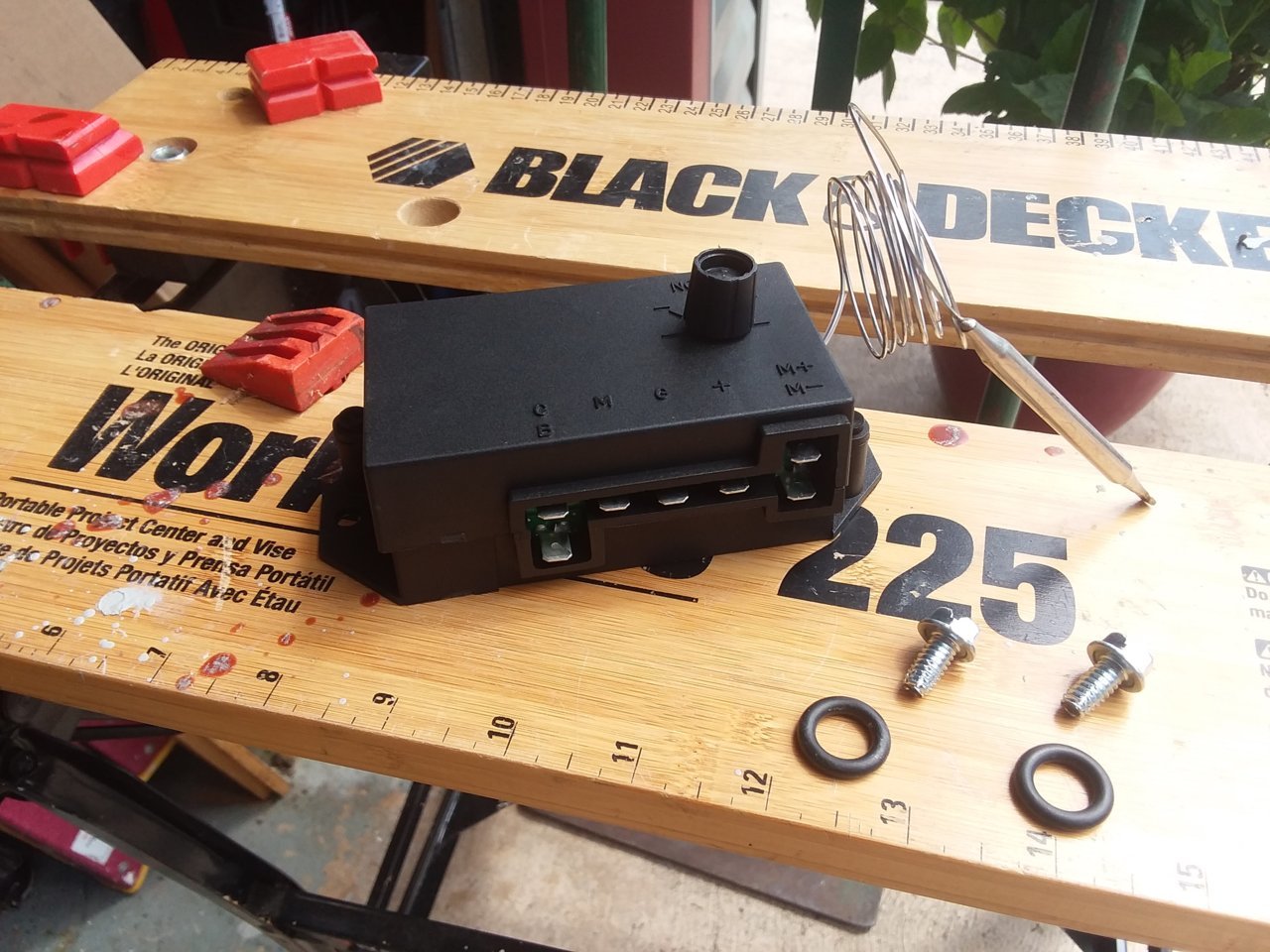

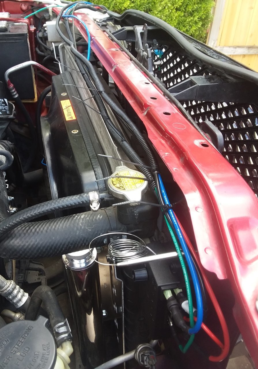

    Now, on to the controller - this is an electro-mechanical unit, and I added some found O rings to give a little cushion to the mount. You can do better - EM hates vibration, and I have no idea if these hold up, given other comments. Terminals are well marked, you have a mechanical thermocouple that needs to be near the inlet to the radiator, and an adjustment know for setting the trip temp.
    Location pretty much needs to be near radiator, so passenger front, and a couple hole drilled to mount it.
    So, starting with the provided wires and terminals, I made the available connections ready at one end, crimped and heat-shrinked. The motor wires are not yet present, because they are supposed to come from "extra" wire. Not. Also, note that I made a JUMPER from the "power HOT" to the "switched HOT" - I want the fan to run after engine shut down for cool off.
    I do all my wiring from a "known point". So, everything connects to the controller, that is the starting point for harnessing. DO NOT BELIEVE YOU CAN DO THIS WITHOUT HARNESSING, OR YOU WILL HAVE WIRES EVERYWHERE. AND, go get two packs 10' #10 wire for the motor wires - they didn't give you enough.

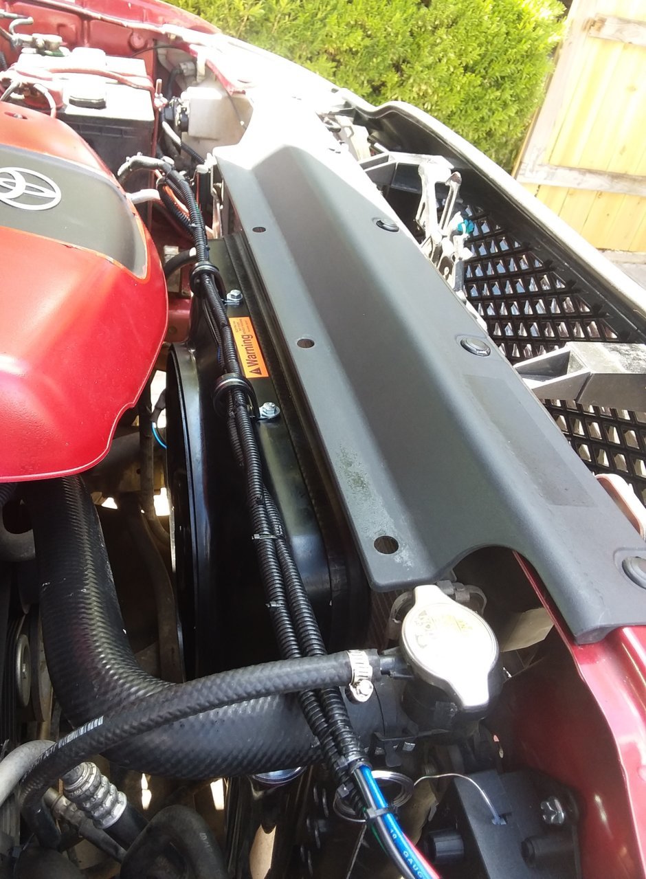

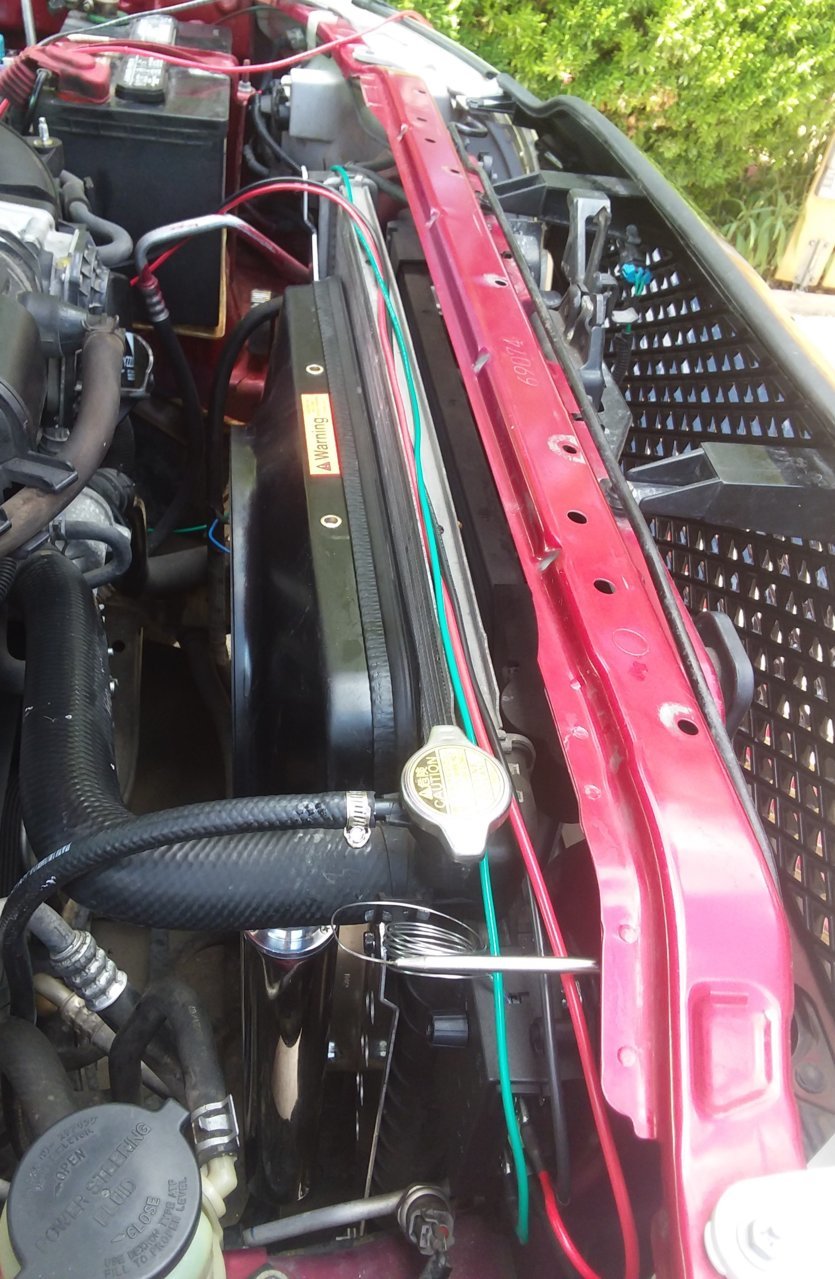

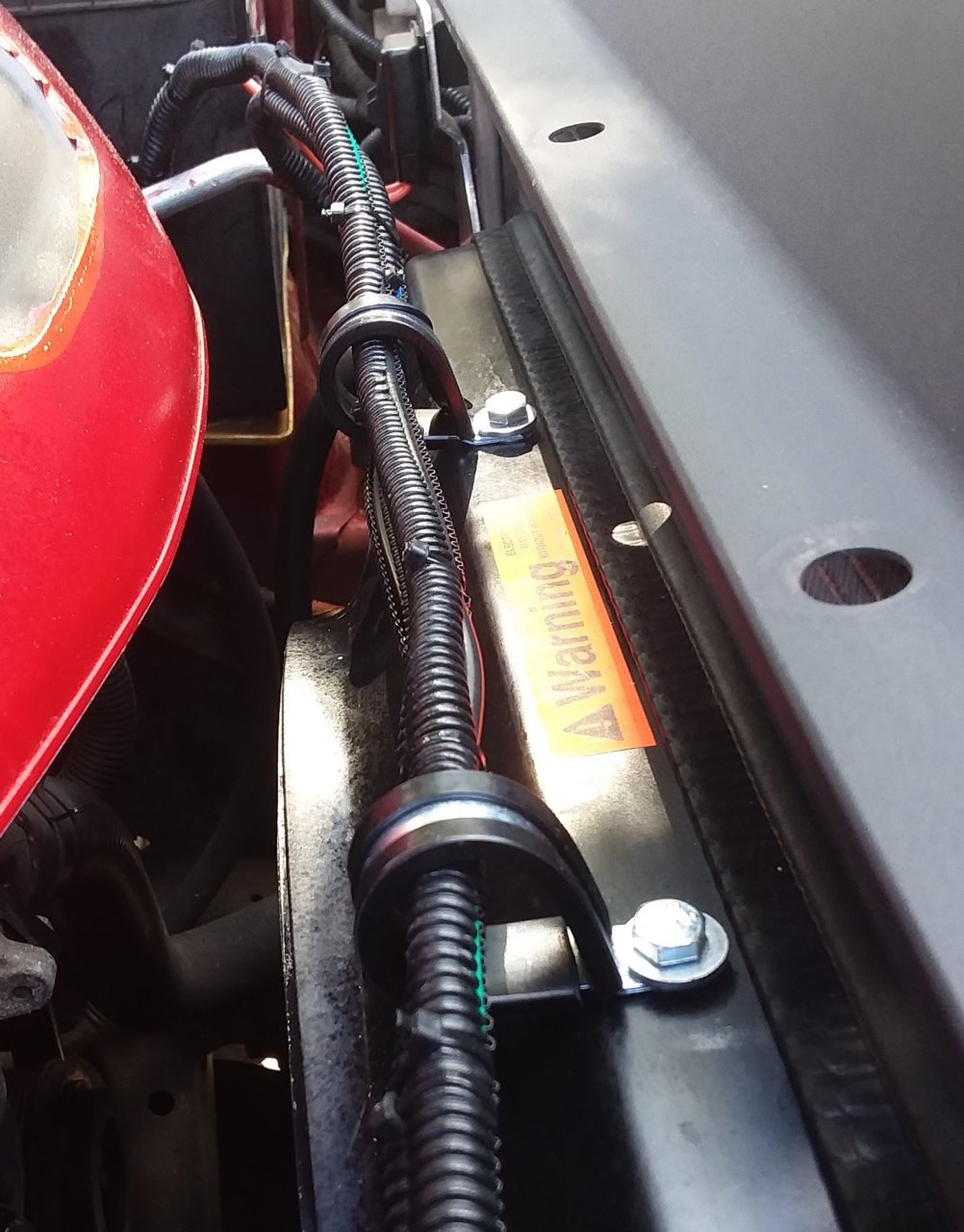

    I laid everything out over the radiator, on the way to the battery side for harnessing.

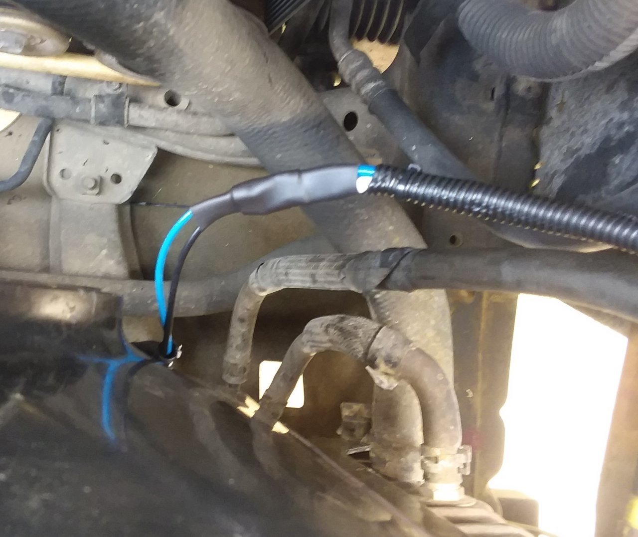

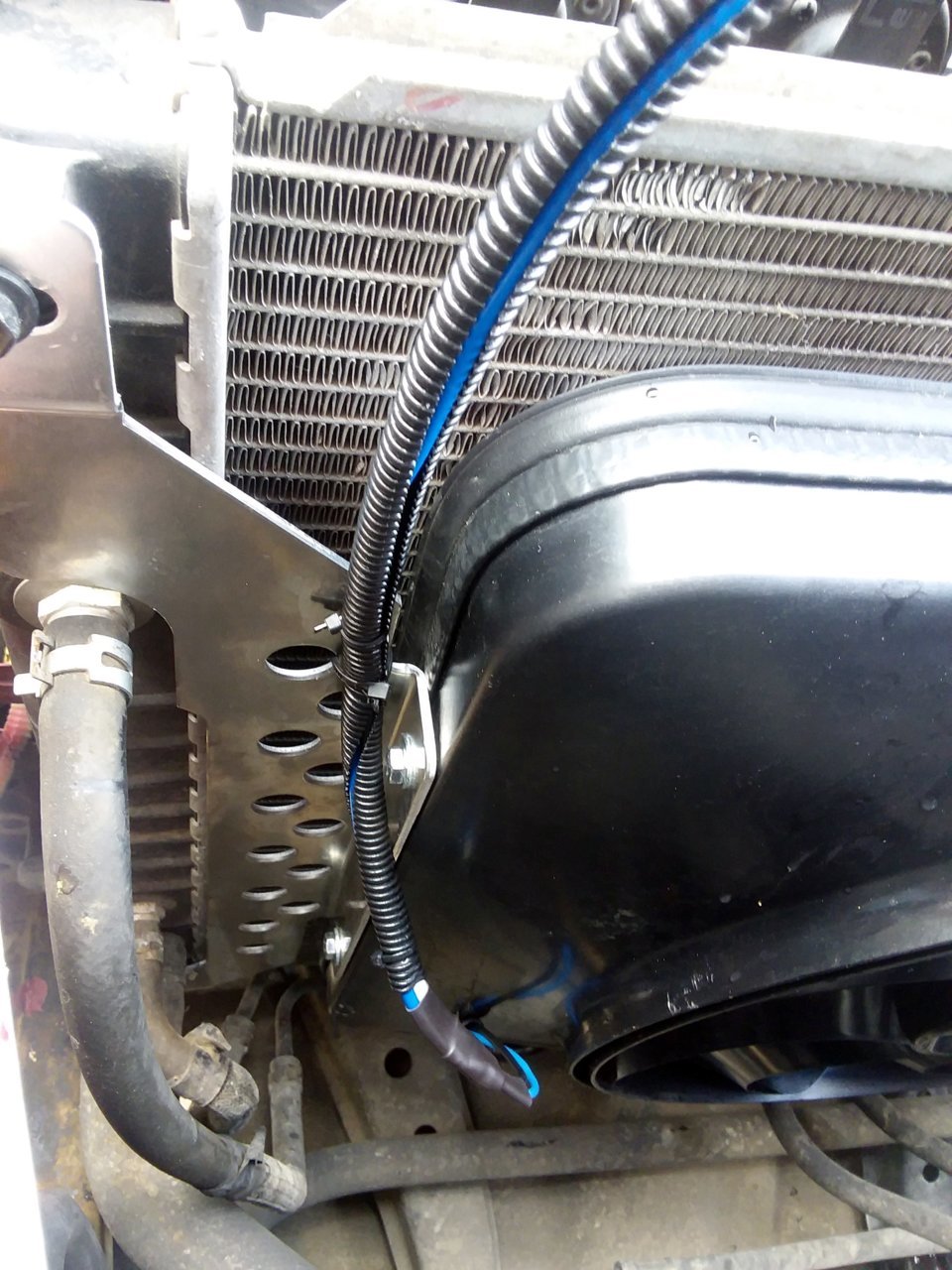

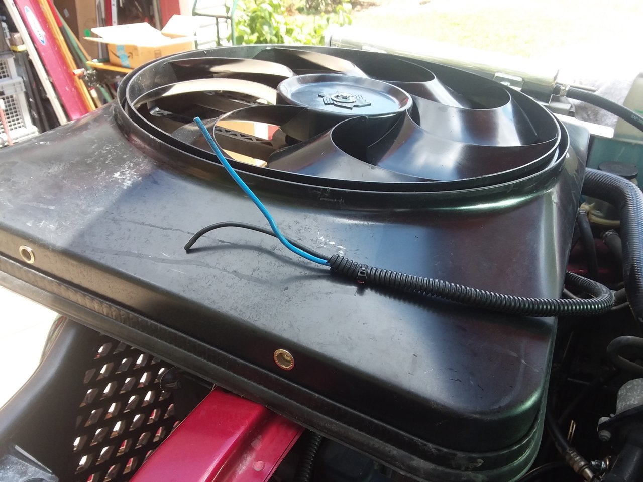

    I had LOTS of left over 1/2" split loom, so I made two harnesses - battery and fan. You can put it in one easily if you have larger. And I chose a BLUE wire for fan power, because that was on the fan itself. So, loom and tie, loom and tie....
    OK, lets make the Fan connection - again; wish I had a connector.
    I fastened that harness to one of the "speed holes" in the mounting bracket.

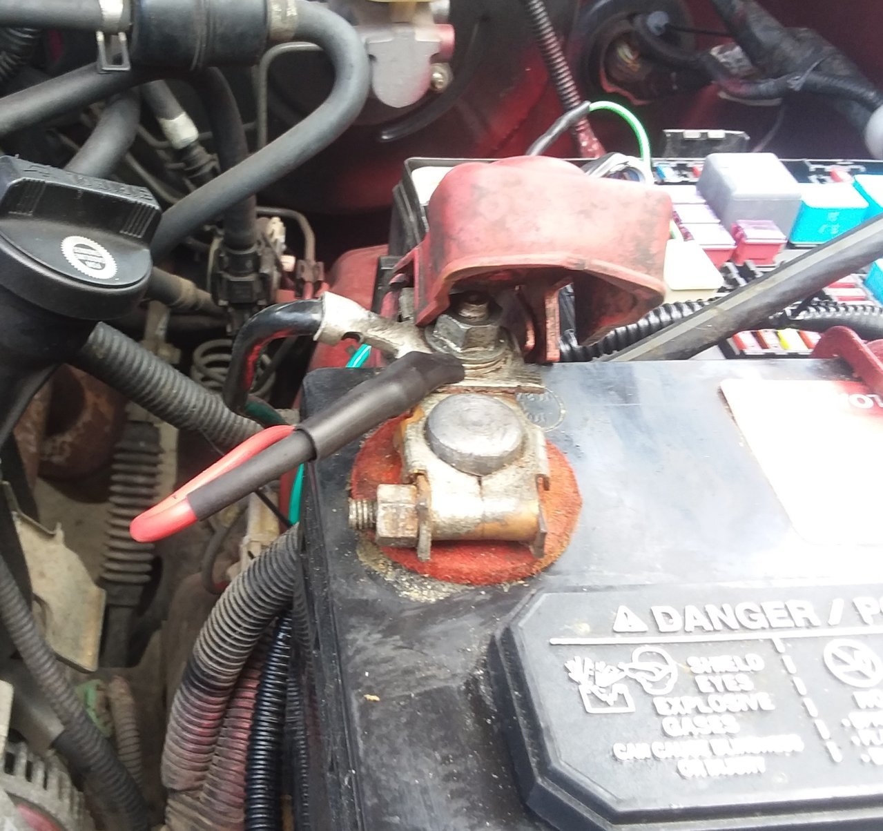

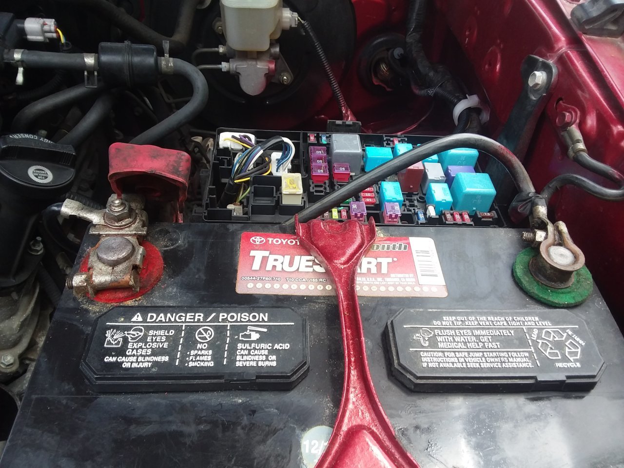

    OK, not following instructions again, I finally disconnected the battery.
    I connected the positive RED wire to an accessory bolt on the hot side.

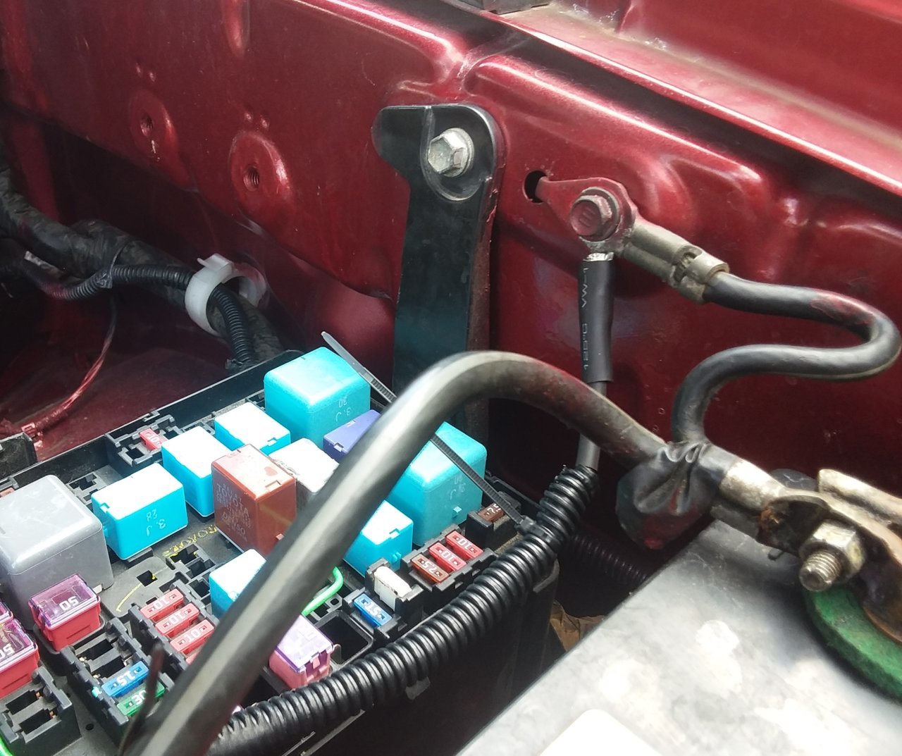

    And the black ground to the body connector next to the battery.

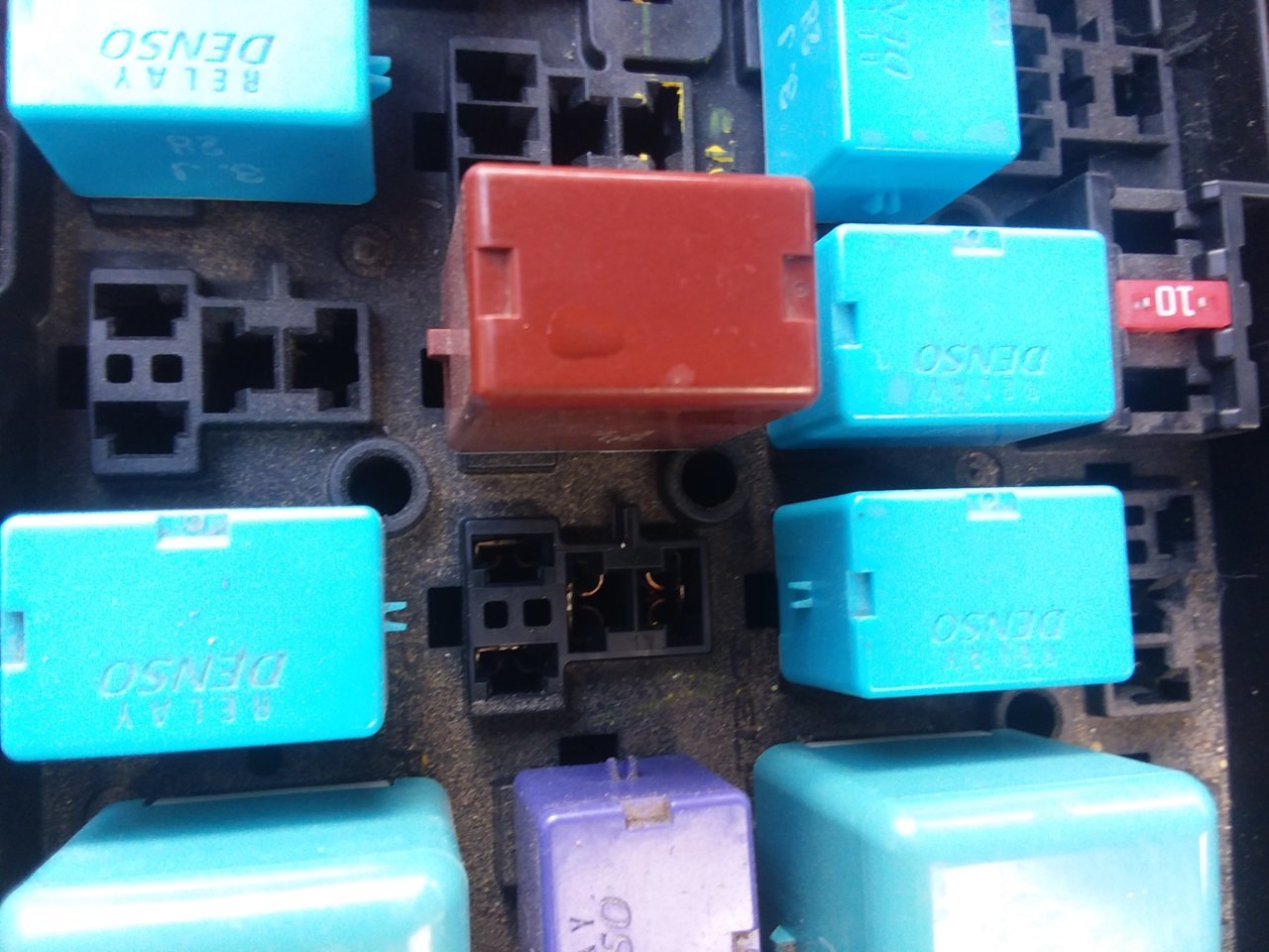

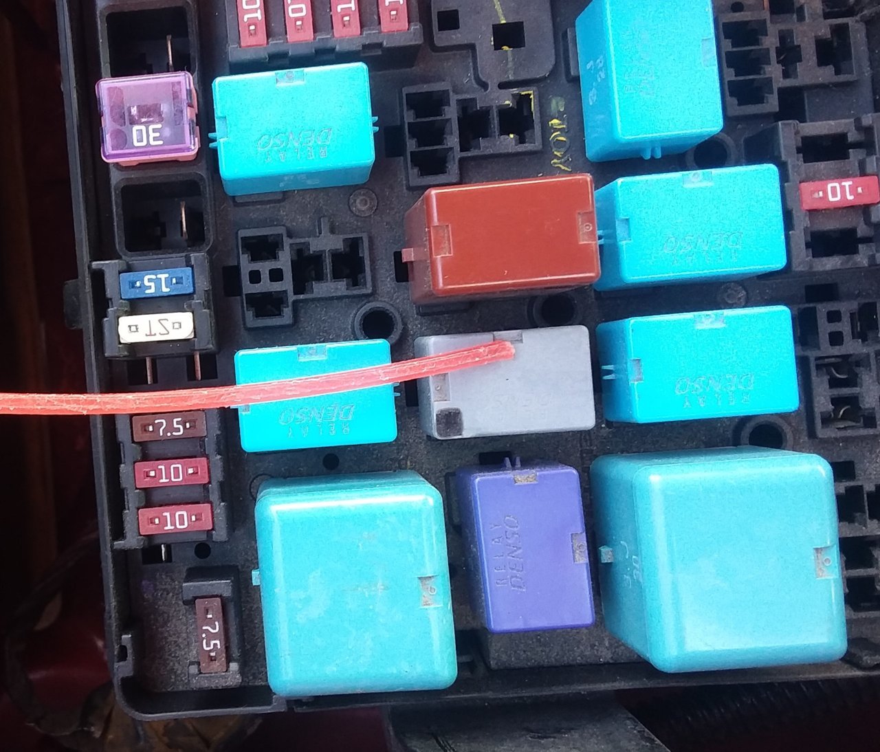

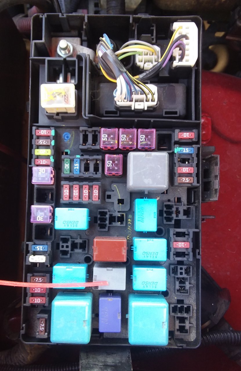

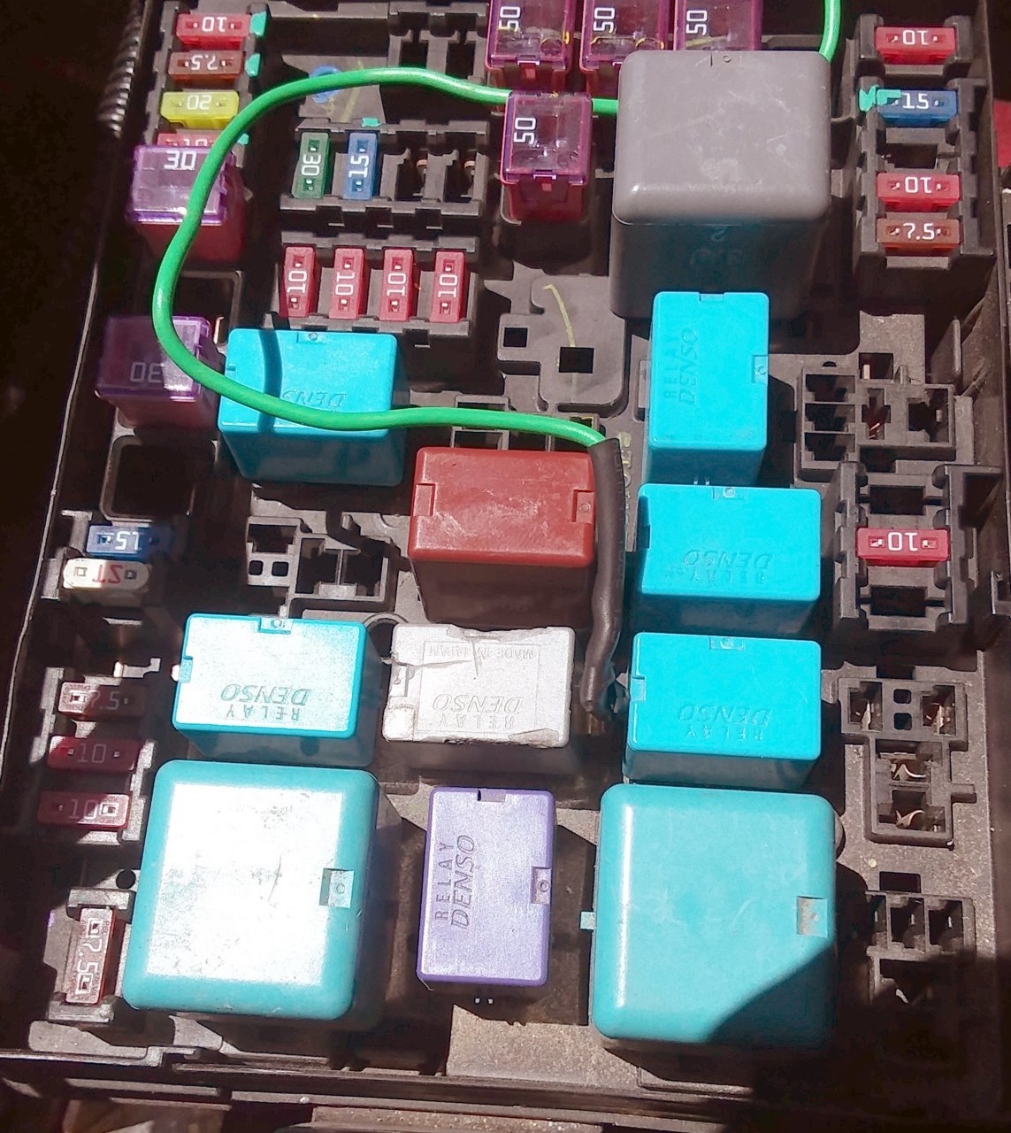

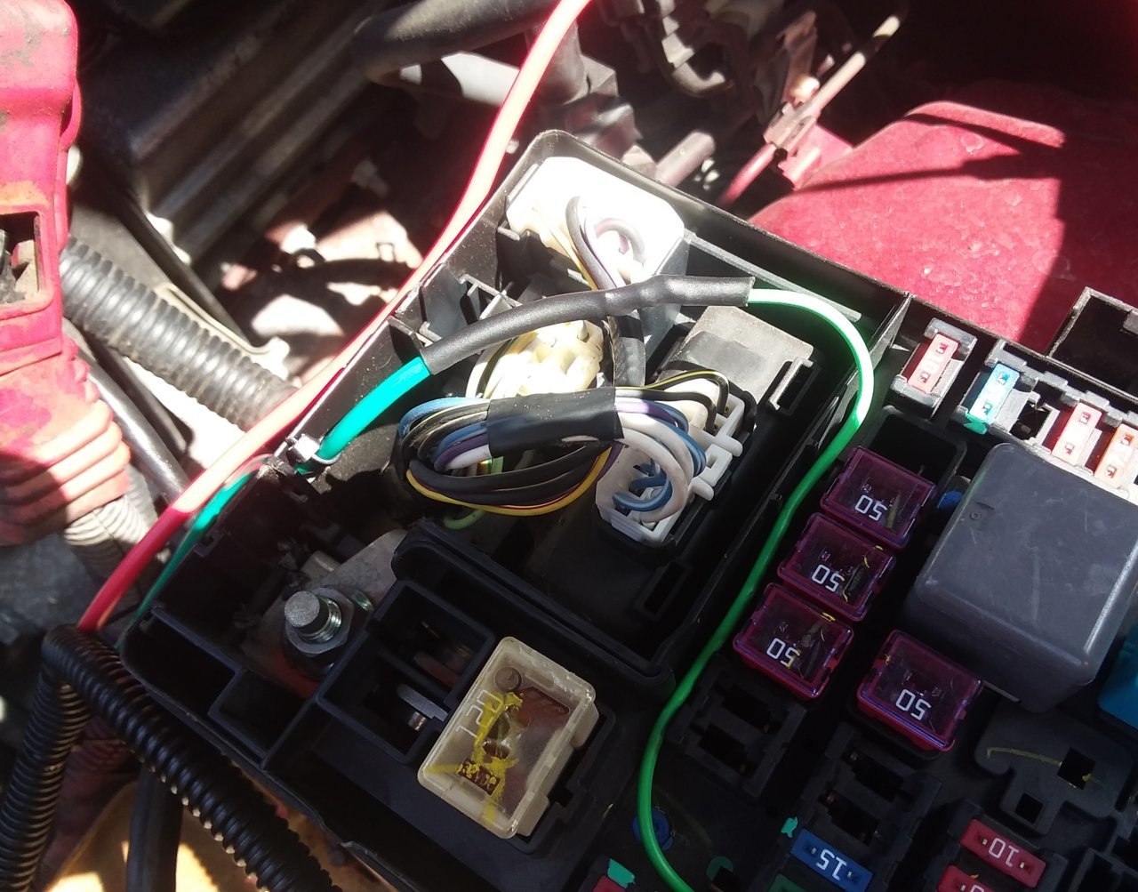

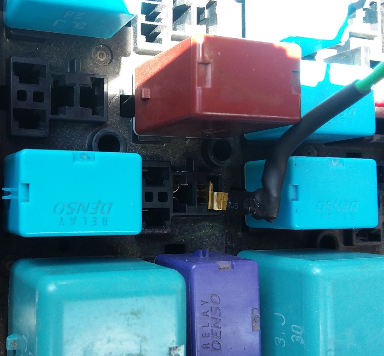

    AND HERE IS WHERE IT GETS REALLY HARD AND SUBJECTIVE! I did not want to try to get in the compressor harness - it's way down in middle earth, and tightly fastened. So, this is where Tacoma Forum and "loginfailed" saved most of my biscuits. I had been searching for the AC Clutch wire connection I needed, and not much luck. It was identified down to a relay in the engine fuse box, and I removed the battery, all hold down, and harnesses to try to get to the bottom. I could not even pry it apart - STOP BEFORE YOU RUIN SOMETHING! Now, follow along on the "get by" method. This is probably suitable for anyone who does not do violent off road, but I understand they don't like the electric fans anyway!)
    SO, here is the relay to work with
    A little closer, from the driver side fender, the red wire points to it.

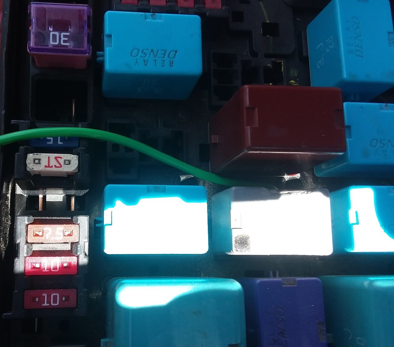

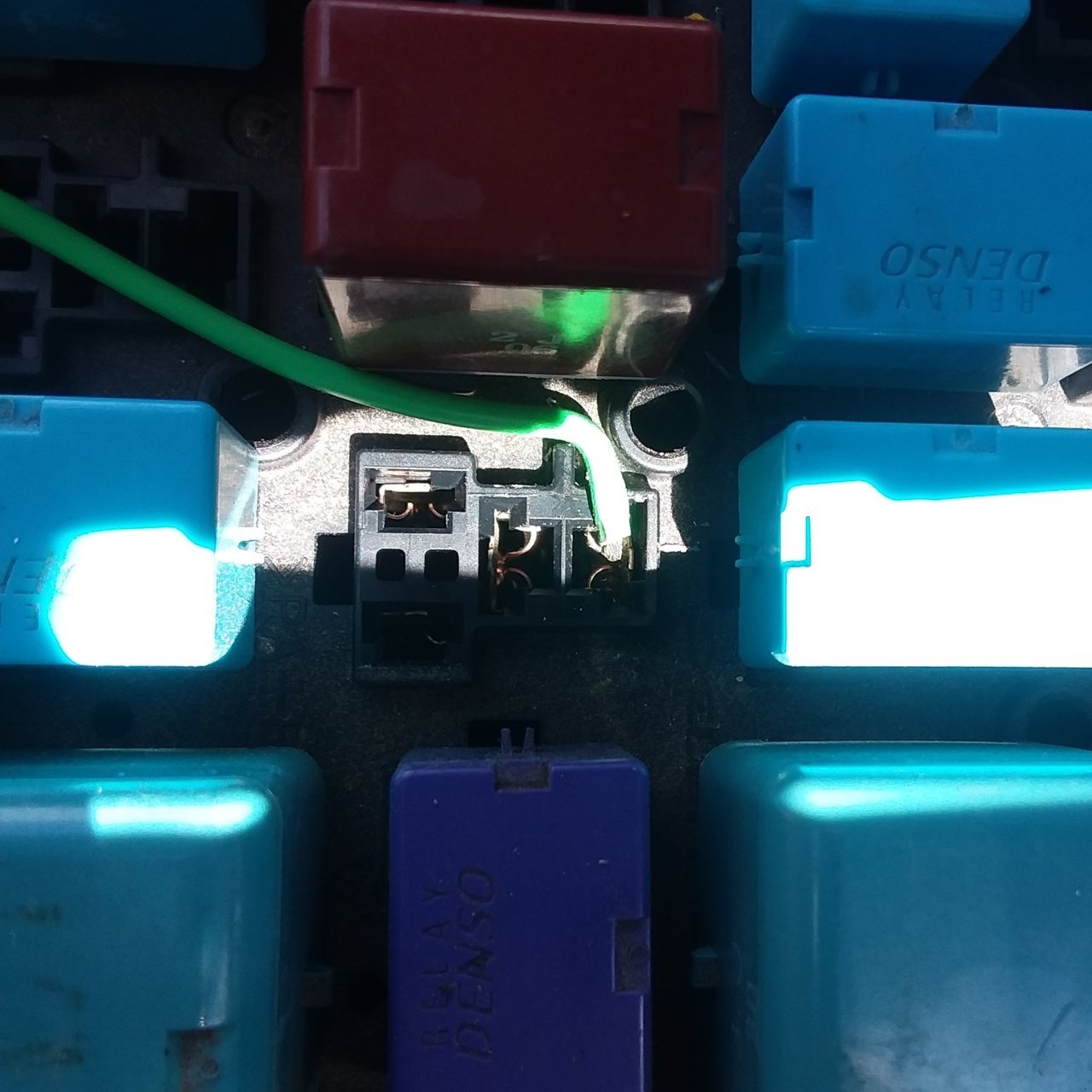

    Removing the relay, the terminal you need it the RIGHT MOST VERTICAL terminal in the pic.

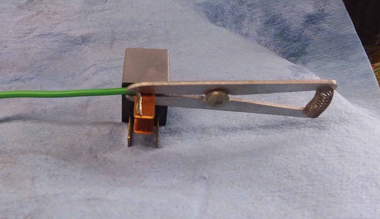

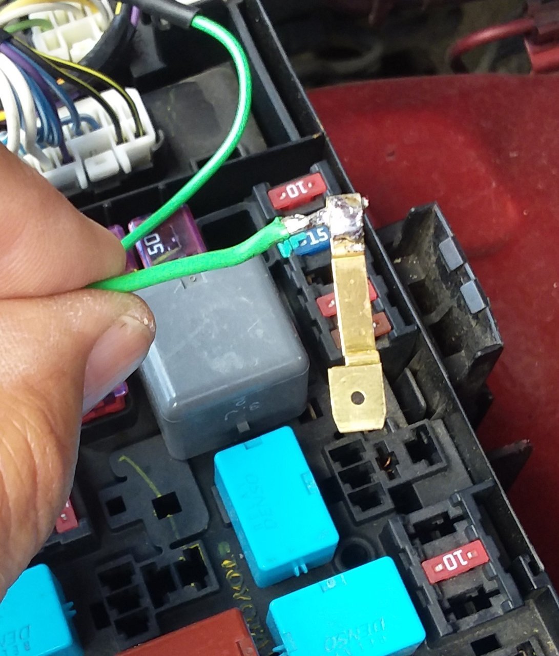

    I thought maybe I could solder a wire to the relay tab, then smooth it down. No, tab does NOT like solder, and relay is sealed, so you are not getting in there.
    So, I ended up with a nicely tinned, 90 degree piece of wire. Using some needle nose, inserted in the "fold" of the terminal socket.
    Now, gently rock the relay back into the socket. The wire should be well held in place for NORMAL use!

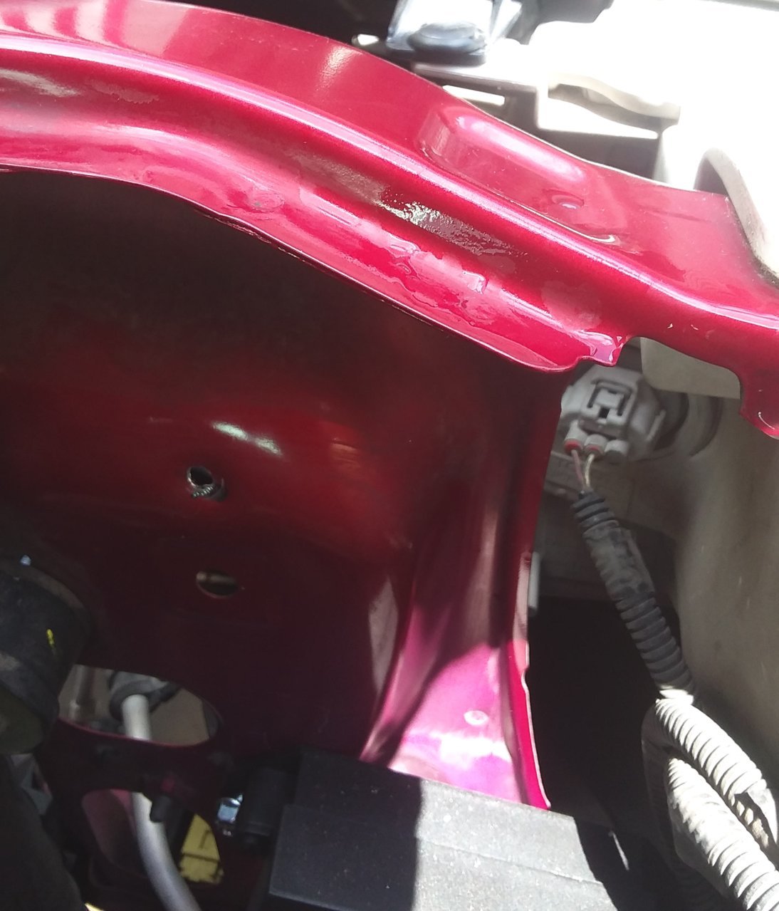

    I drilled a small (wire size) hole in the FB casing, about 1/2" down on the engine side, to run the AC clutch wire from the controller through. Soldered, and shrink wrapped, then formed the wire into the relays to stay out of the way

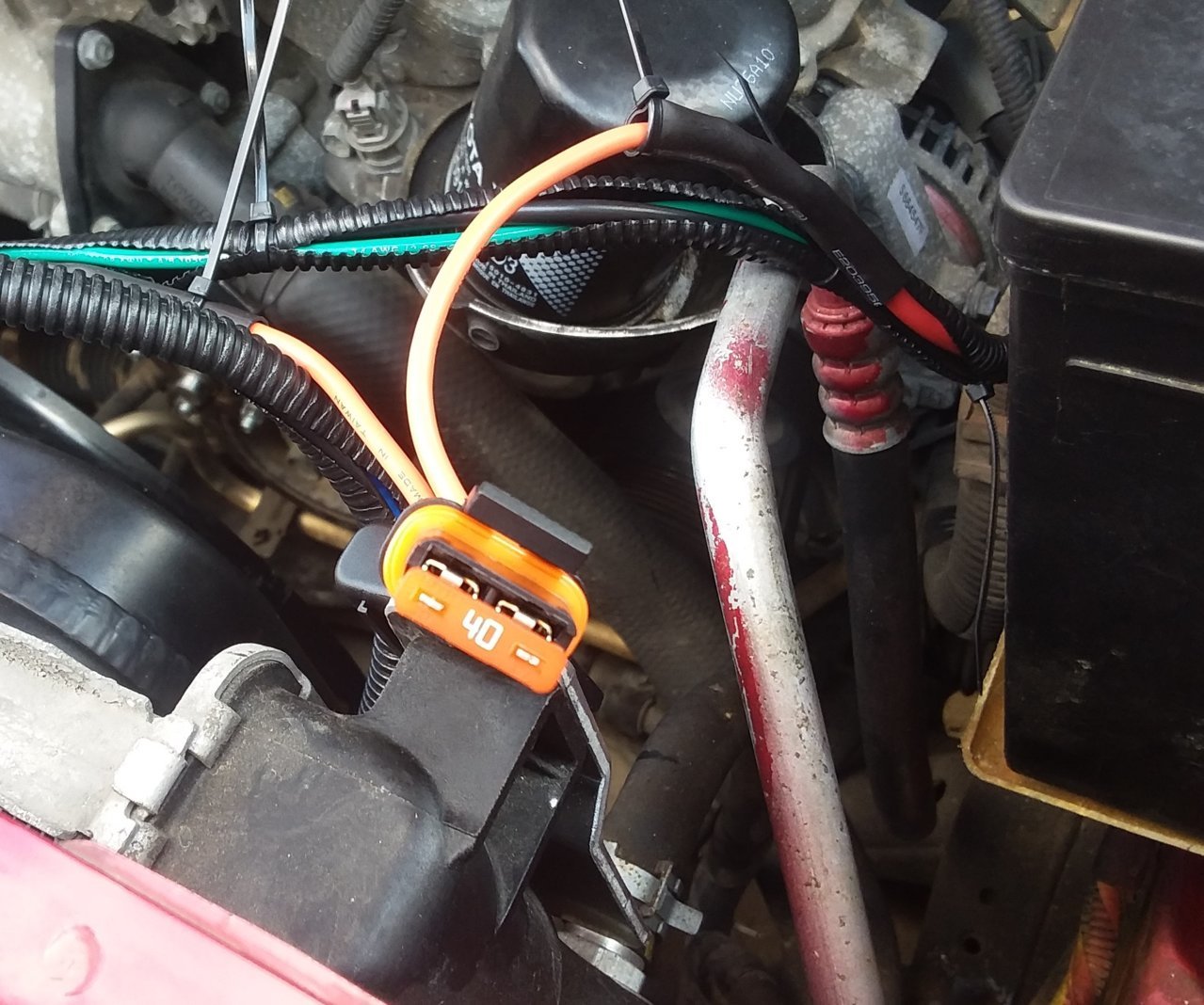

    And you thought I would forget the fuse?
    No, I mounted it to the top driver side shroud bolt, so I can find it. Both of the HOT to the controller come from this fuse - so no false failure mode,

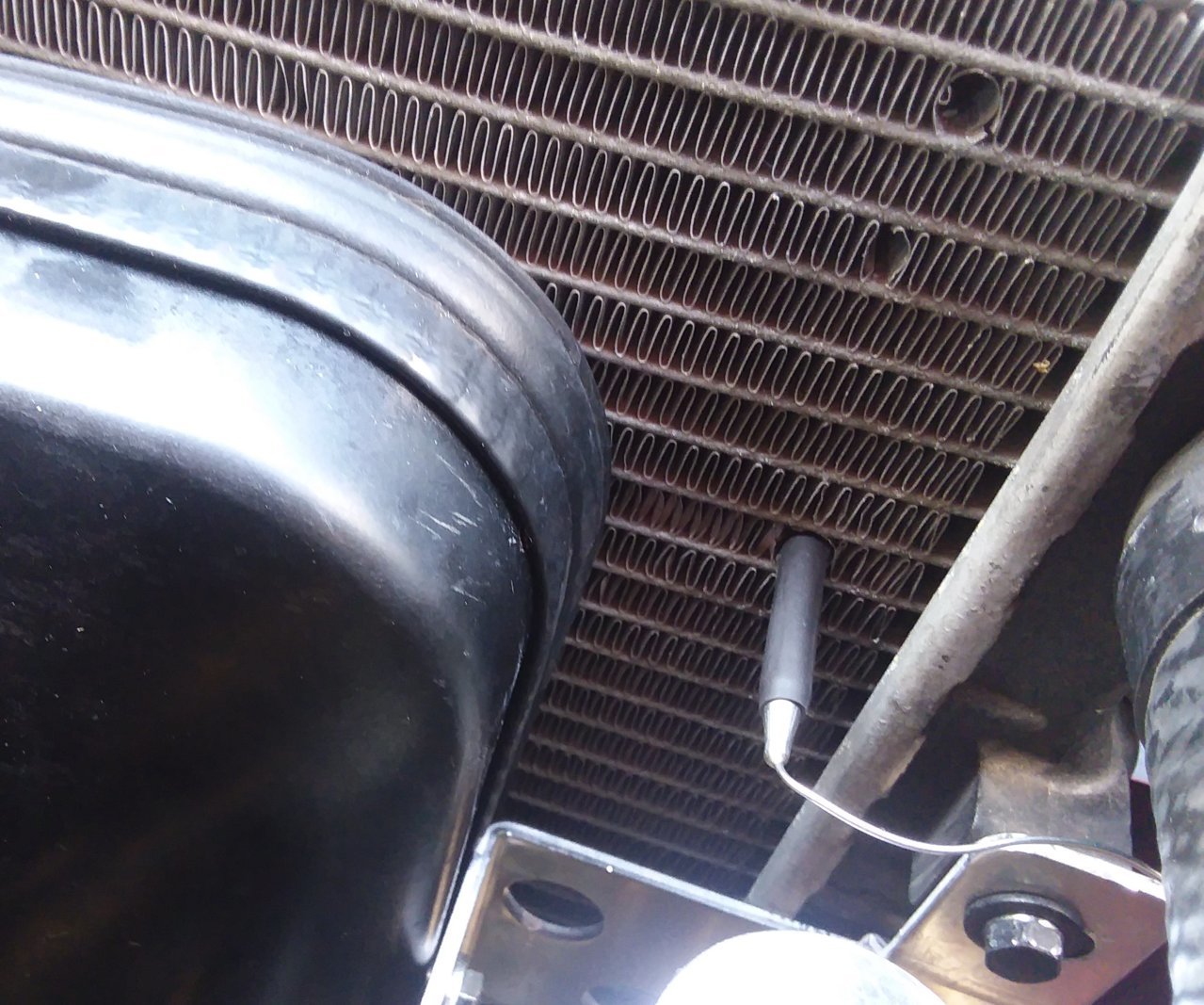

    So, put the thermocouple into the radiator, and let's wrap this up!
    DARN IF I AM NOT REAL HAPPY THAT EVERYHING WORKED PERFECTLY! AC clutch fan on and off = OK. Fan doesn't come on without thermostat = OK. Fan will run until "cool" on engine shut off = OK. Fan comes on by thermostat when AC not on (HA!) = OK. Let's clean up the install!

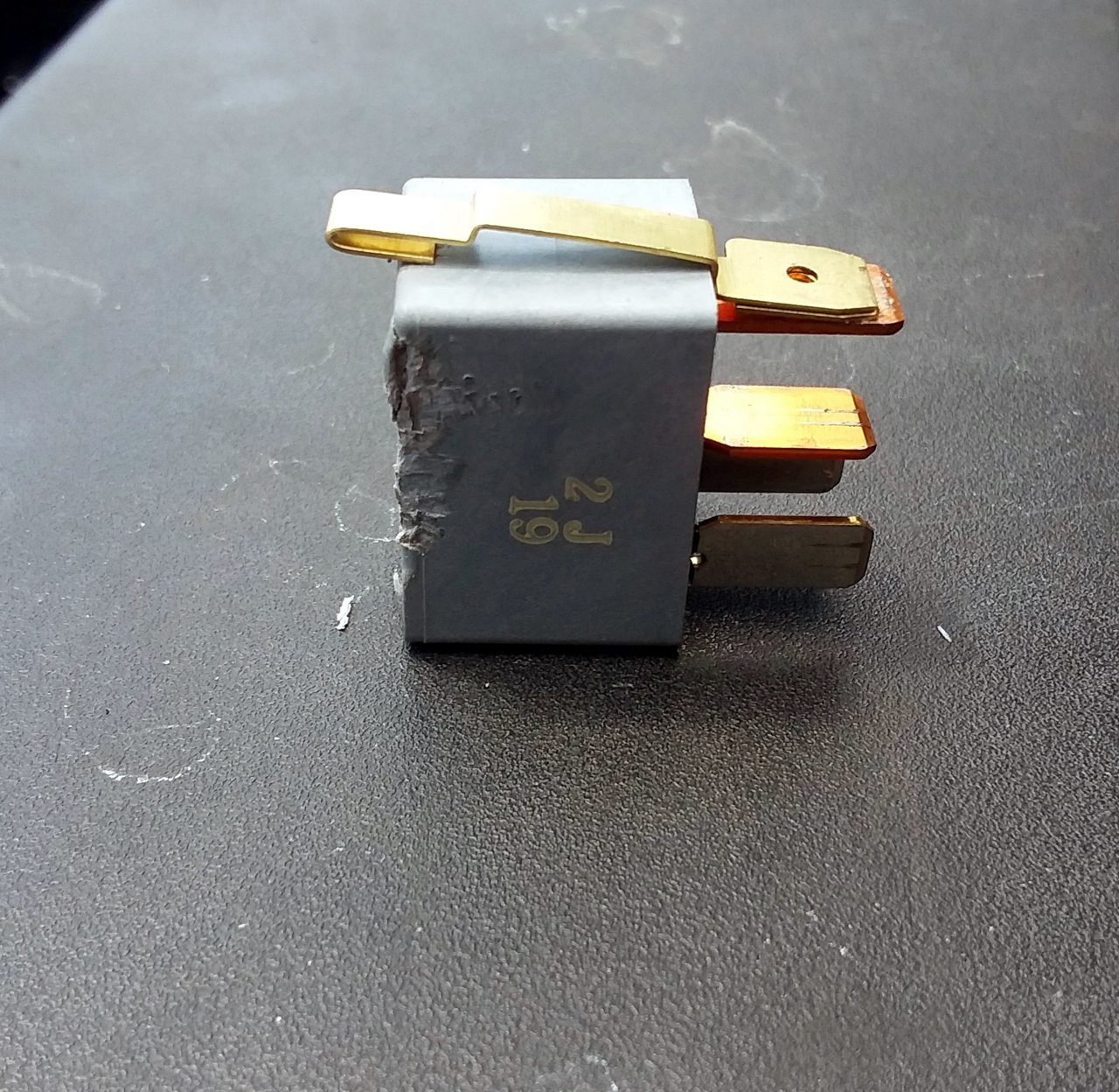

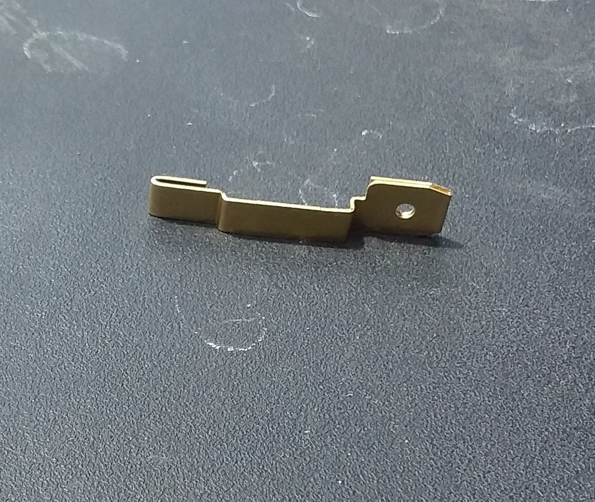

    A dammitnendment. Cleaning up the tools and parts today, I found a weird little metal clip stuck in the melts of the plastic hardware bag. It took a minute, but then it hit me. So, here it is. I'm not sure I like this a lot better, but it's the "right" way to do it. (Maybe...)
    I found two of these little clips, melted in to the plastic bag sealing - a big and little one;
    Yep, it's what you think it is. A clip adapter for a relay terminal. Dang. So, pull the relay, and wire out, solder up a connection;
    So, you would just insert it into the flat, like this?
    No, you cannot get the relay in afterward. You have to hold them together like this, and rock it in, and it is NOT easy - you have to push.
    So, it gets inserted, and is probably more "secure" than my original method. Then I put the wire back into place after this shot, and closed it up.
    MattCowsmasher likes this.

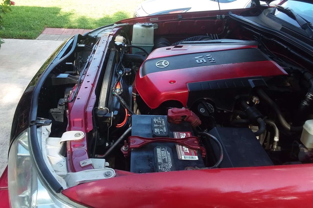

    I haven't been very far since completed, across town (that's three miles), and the car wash auto dry drive. I would say AC is "improved", but the fact that it was still over 100 each afternoon, I really can't say how much yet. Better, yes, because the radiator is cooler, and I WAS able to turn the control to the bi-level, instead of panel only, and down from HI to one step lower - MUCH sooner than I have in the past. I think when it's just in the 90s, I will have some nice things to say.
    As far as the wiring, I did most everything before even disconnecting the battery. It's not that scary, but I understand. If you have a friend close by that doesn't mind wires, and is patient enough to keep it clean as you go, you could probably get by with donating some good beer!

    The correct way to install that is to slip the u-shaped part (where you soldered the wire in a previous photo) over the leg of the relay. The flat end with the hole is for soldering a wire to, or it will accept a spade connector.
