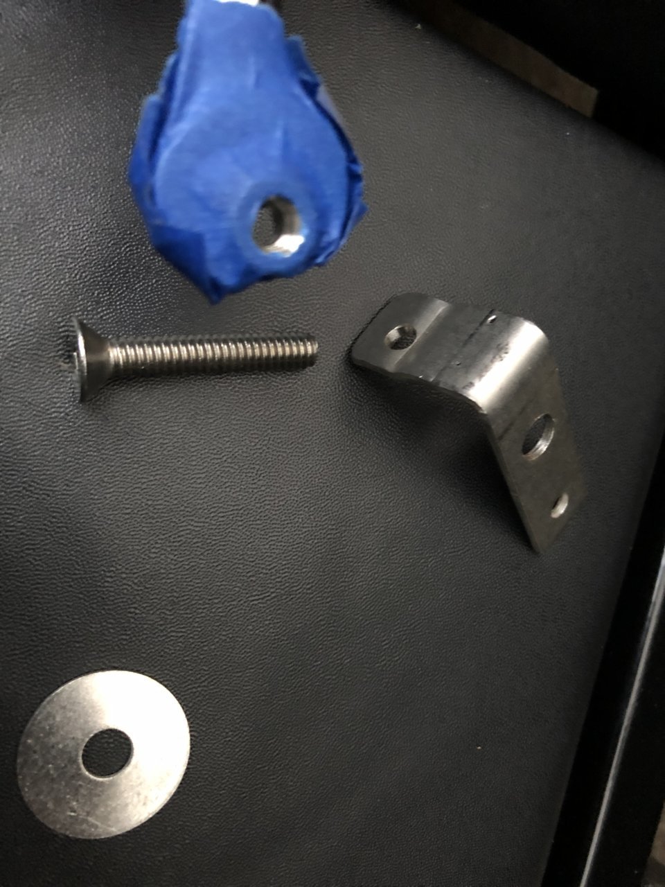

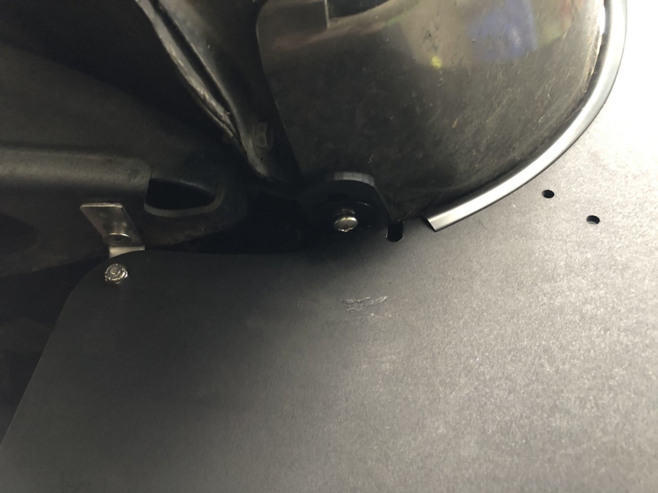

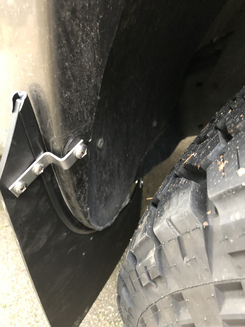

    I just installed the oversized tire version on my 2nd gen and needed to make a few modifications.
    I have 285 (33”) tires with after market UCAs a small cmc and added better wheel well liners.
    So one attachment point has been trimmed away. I used one of the SS brackets and a new bolt to add an L attachment under the cab mount.
    Looks strong enough time will tell. For me deep wet snow is probably the biggest hazard

    How have they held up with having the elongated bracket? And how do they look
