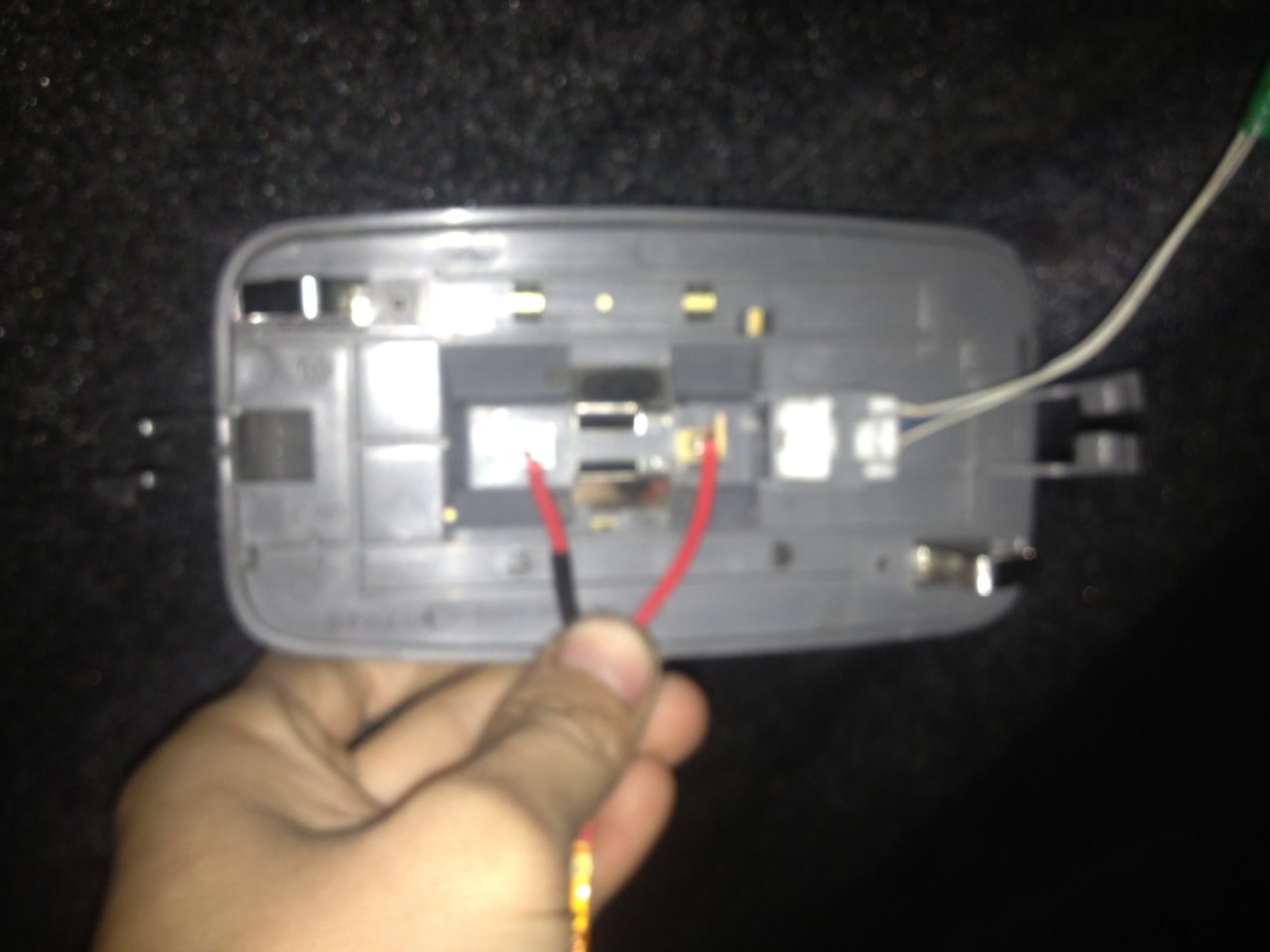

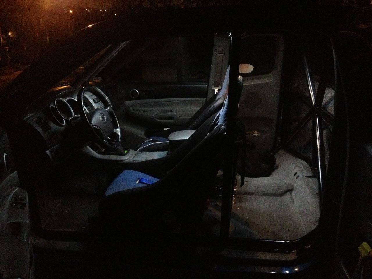

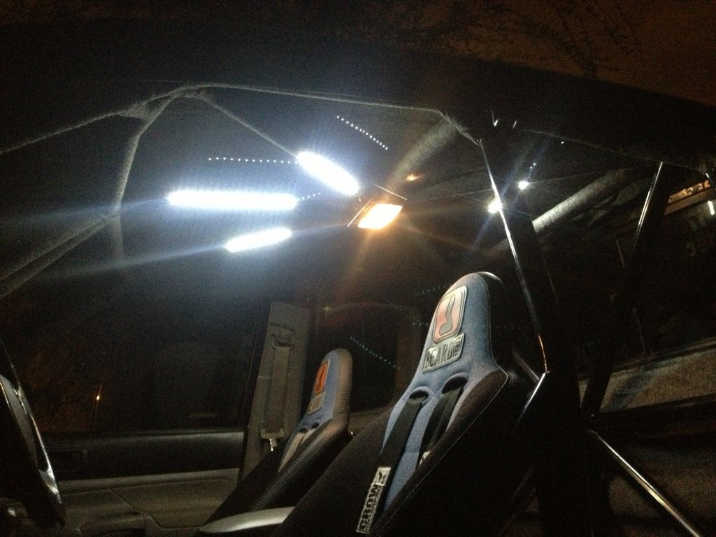

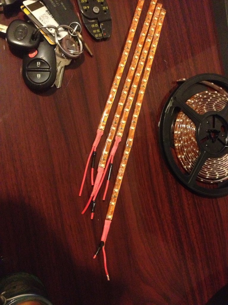

    I just used the LED light strips OP posted to redo my interior lighting. I tapped into the dome light housing so it comes on with the dome light switch and the doors:

    Looks good! how bright are they? im sure the pictures dont do any justice
  18. Jan 7, 2013 at 12:28 PM
    #18
    blackhawke88
    blackhawke88 wo ai ni bao bei ^_^
    Jan 11, 2009
    #12478
    16,598
    SGV, CA
    07 TRD Offroad
    they are way brighter than the stock map and dome lights and they pretty much light up every inch of the cab. You can kind of see the difference in light output in the picture that shows the old dome light and the led strips.

    Yes I had them for a year too and finally got around to installing them. This is how I prepped them:
