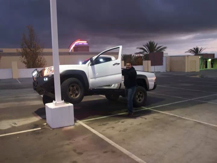

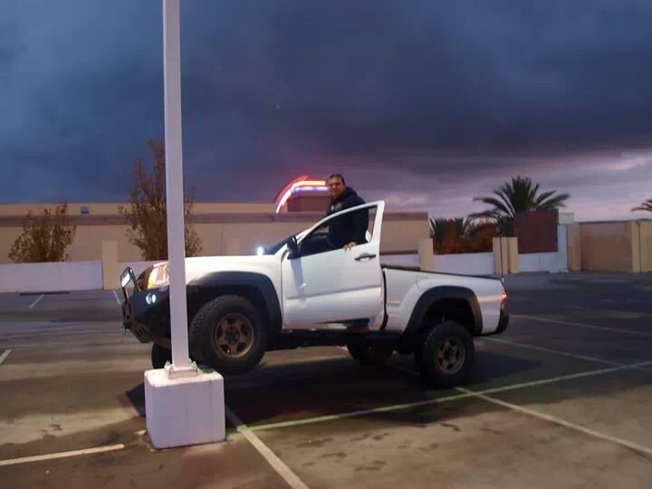

    Can I play?

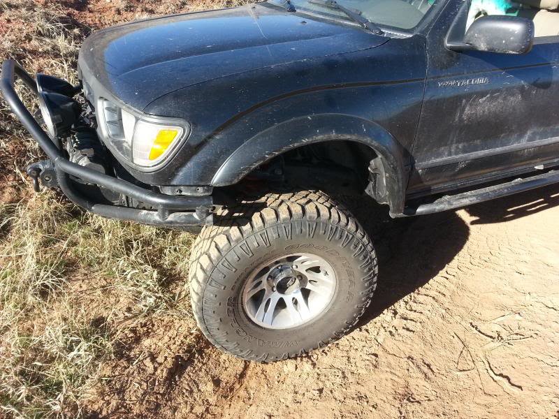

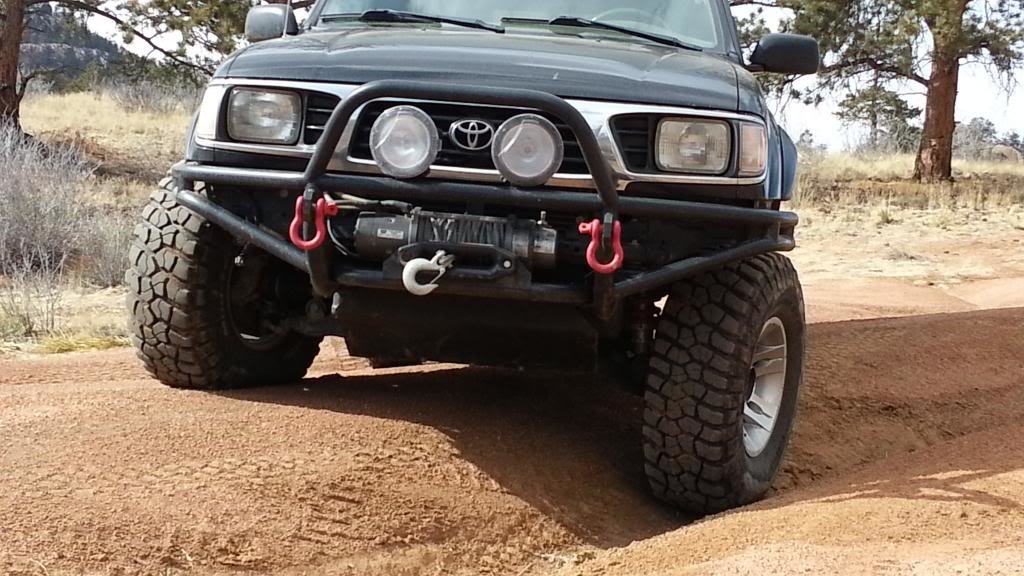

    I think the key for my wheel travel is the fact that I'm using non-preloaded 16" coils instead of the standard 14" coil. My theory is that, if you buy regular 16" springs with 1st gen tundra 5100 shocks, you'll get the same travel for WAY cheaper than most coilovers. If I was you, I'd check into 16" 500lb eibachs. You can probably snag them for $150-$200.

    Hmm. That's pretty sweet. So that's what you have? 1st gen tundra 5100s and 16" 500lb coils? With that winch and skids what's your lift look like? I need every inch of clearance I can get, so it would be awesome to keep it at 3"

    ^I've got 600lb springs but I've got full skids and the winch. If I didn't have that extra weight, I'd do the 500 or 550# coils. But yeah, I'm running 1st gen Tundra 5100s (with the Toytec build-your-own coilover setup) and 16", second gen taco springs.
