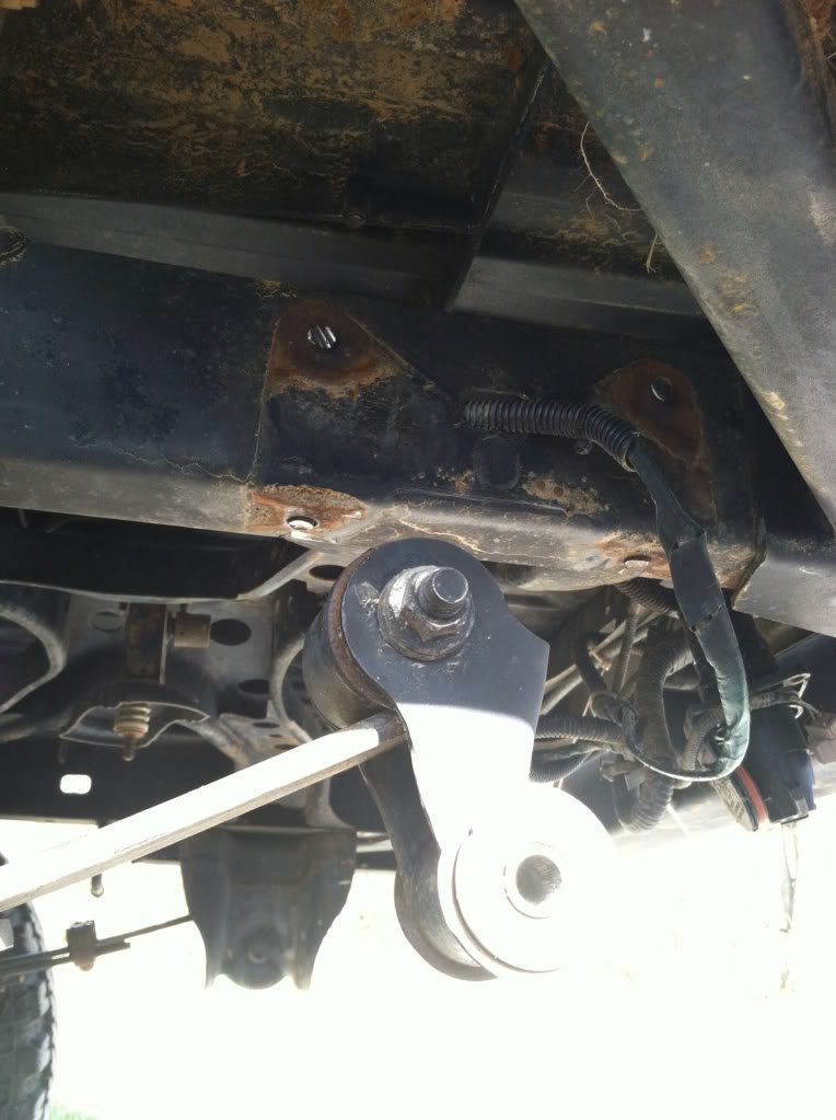

    so what kit is that shackle flip? or is it urs?

    ATO...when he actually made flip kits

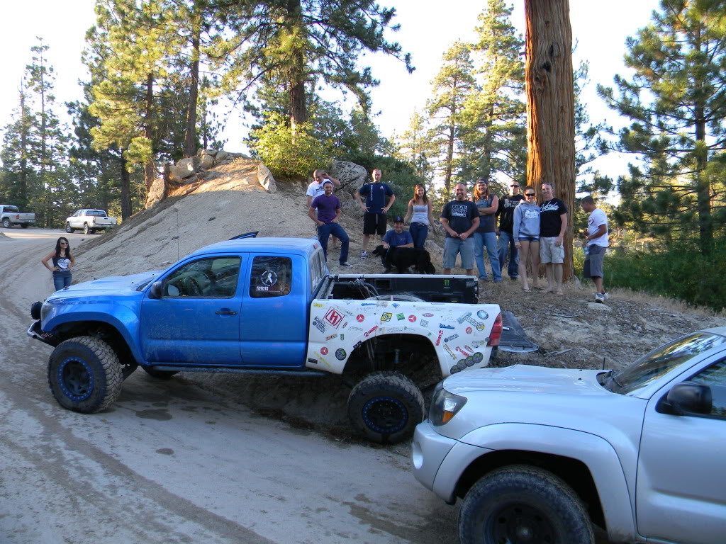

    Kevin's (ATO) bad ass rig he built
    Everything Kevin from ATO did on his... and then some. LOL
    So other then the ATO flip kit, what else did you do to get better flex?

    he's got a build page on his rig...it's a good read
    his shock relocation looks to have paid off which helped out his droop

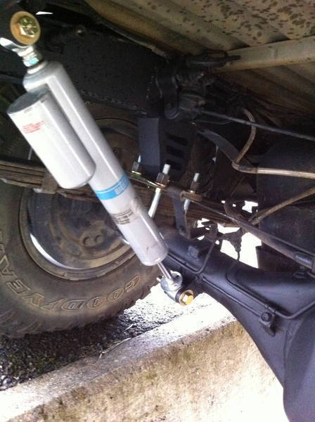

    This. With 10" 6100's. 275/78 valving, mounted like this /\

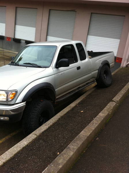

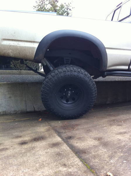

    6" deck plate mod, sweet bed bar.

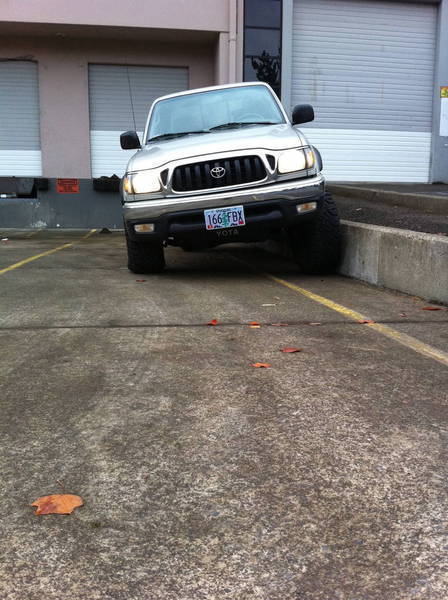

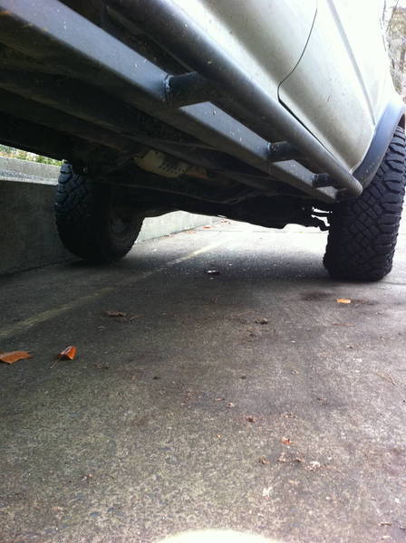

    i need more flex
    how can i get more flex ?

    Front: Remove your sway bar if you already havent. new UCA. Or LT.
    Rear: Run longer springs with a longer shackle, or SU

    so i removed the sway bar, all pro non expo leafs. uca will be soon no LT.
    what is CU?

    SU, not CU.
    SU = Spring Under, aka SUA (Spring Under Axle).

    oh ok yeah i would like to do that but i want the ground clearnce of SO

    If you don't want to go sprung under, you will need longer shackles, only way to achieve more flex. Also you will need to get longer shocks if you are going to have more travel for the rear
