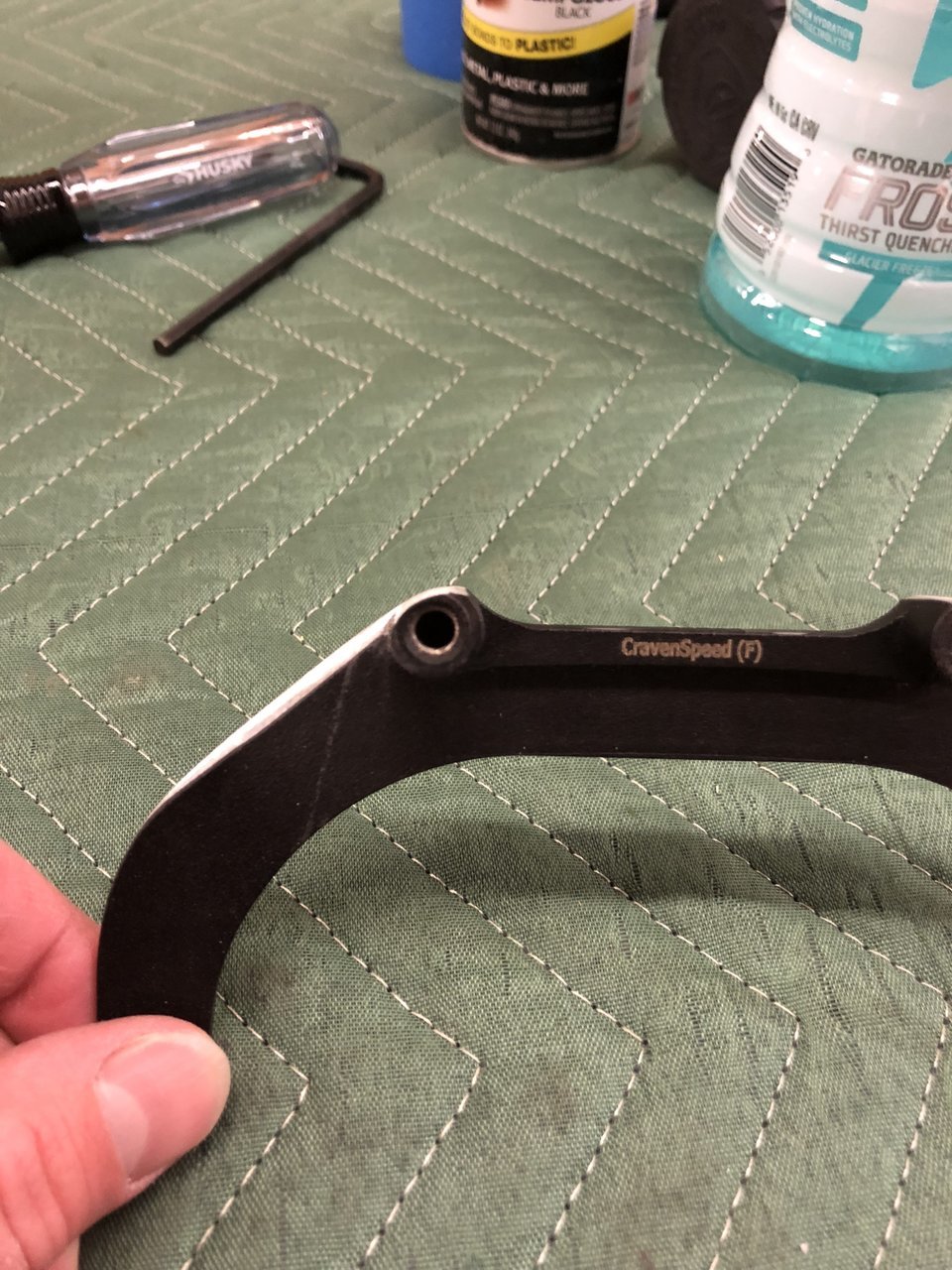

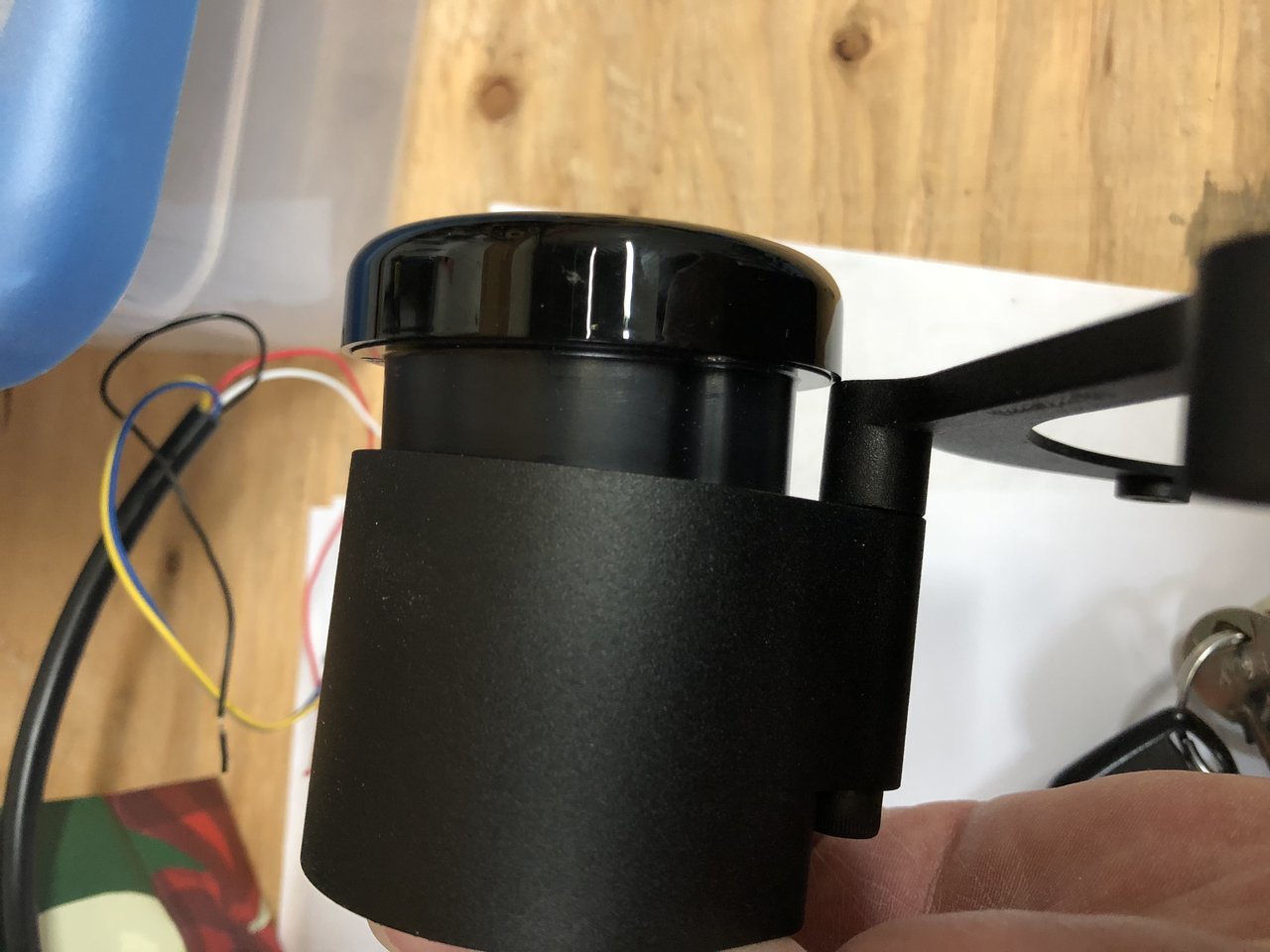

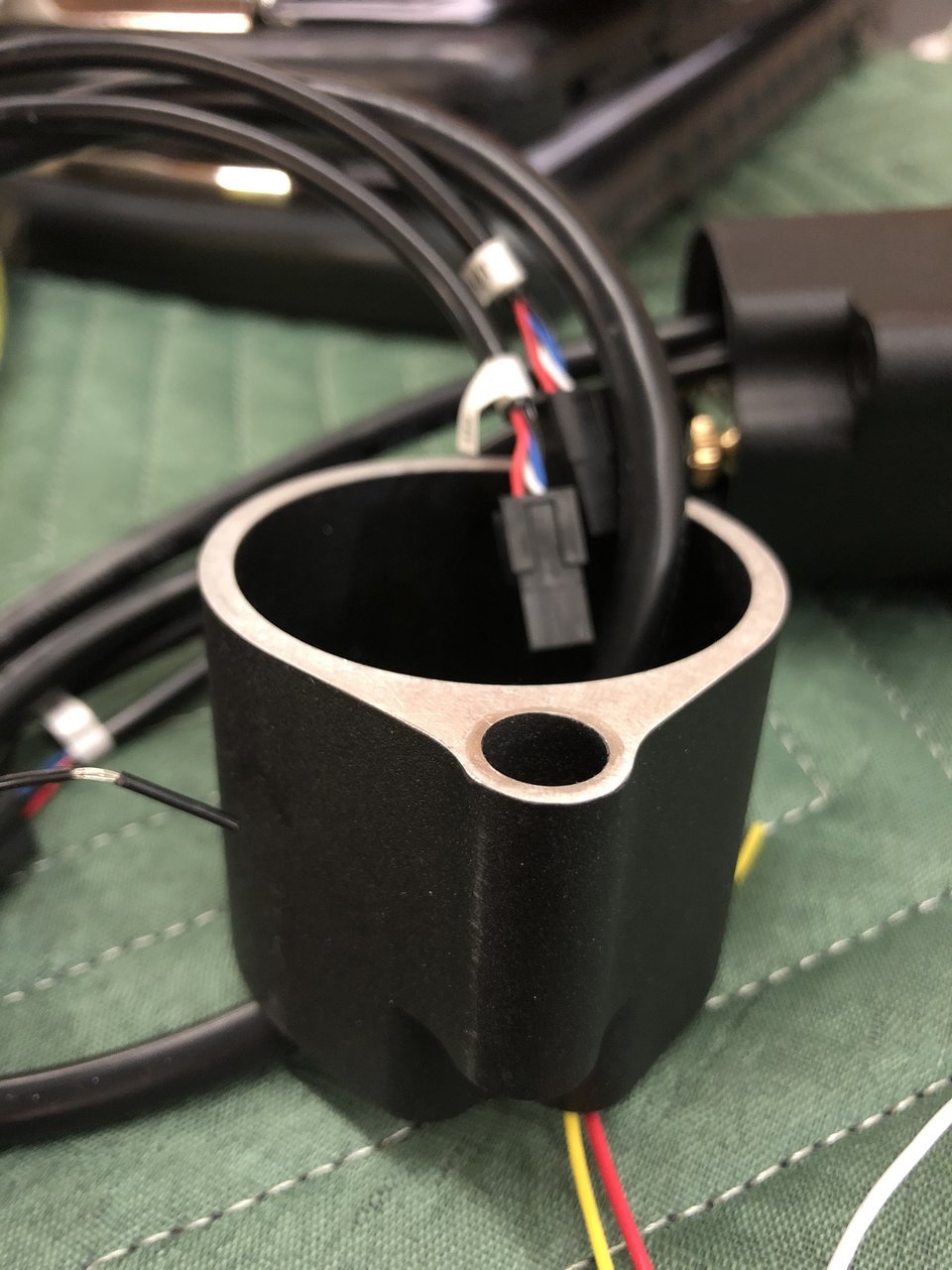

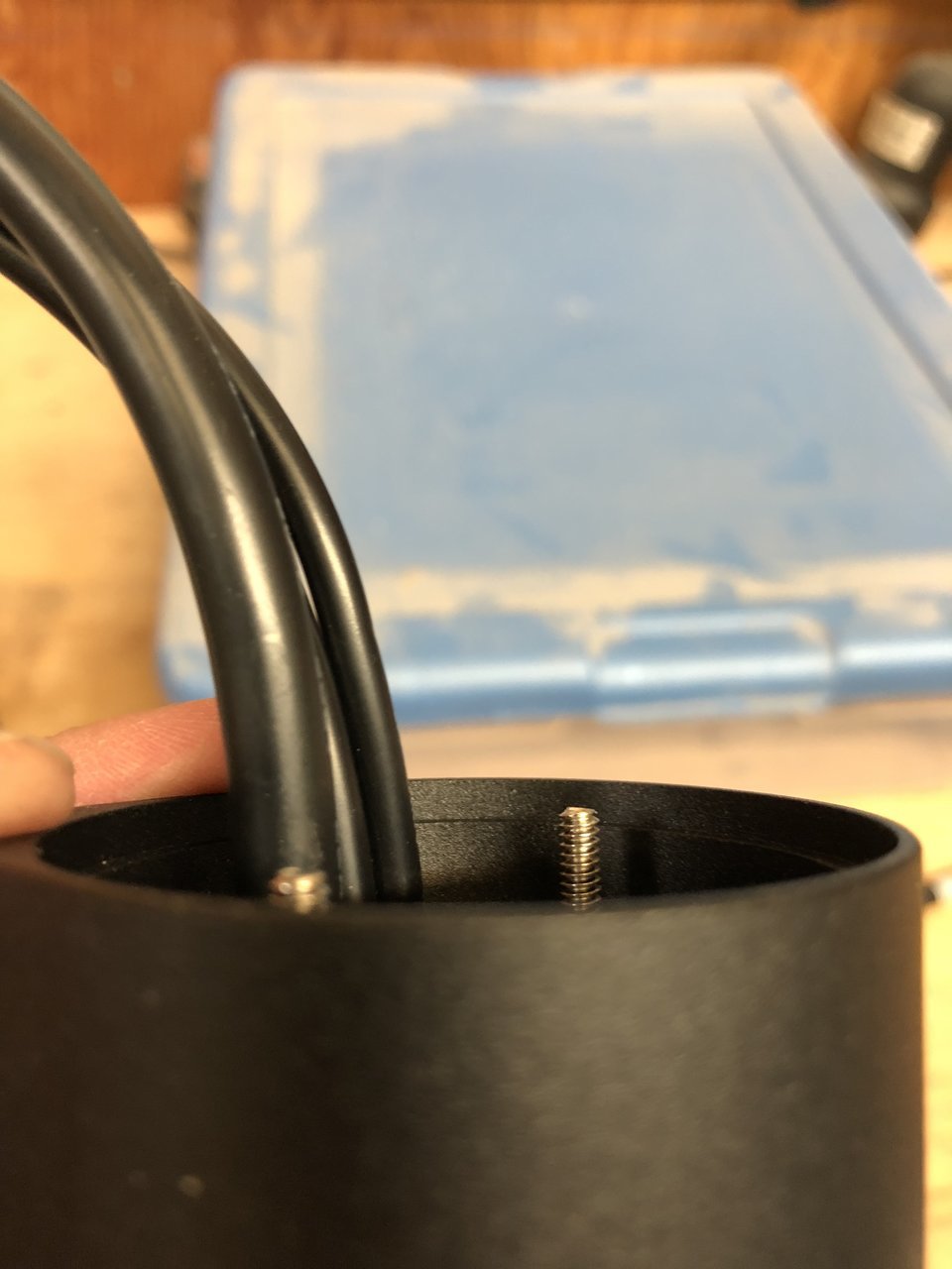

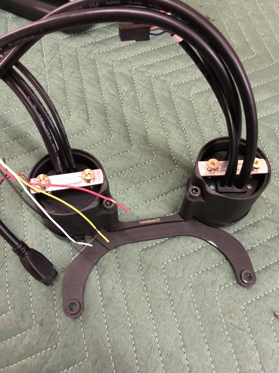

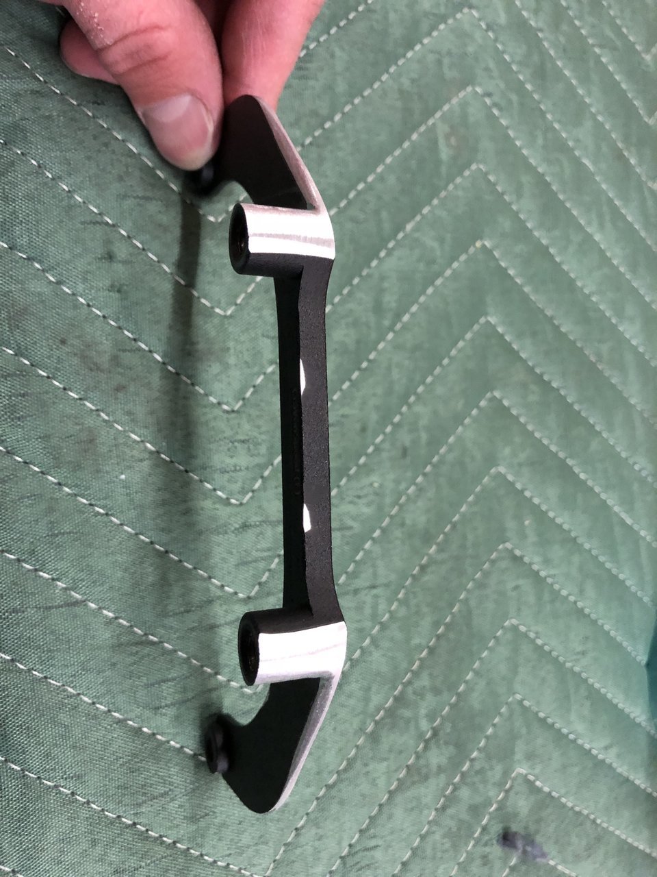

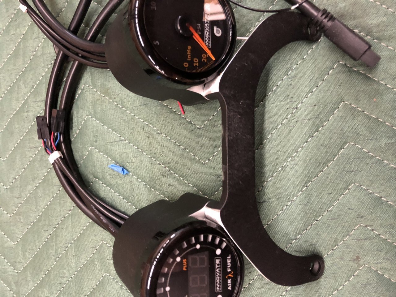

    Hello. I didn’t see anything about fitting these two together so I thought I’d share what I did. There are two problems
    1. The gauges aren’t deep enough for the pods. I hade to grind about a 1/16 off the face. Then instead of the plastic backing plates cravenspeed suplied I cut and ground the metal ones that came with the gauges.
    2. The gauge bezels are huge and won’t clear the pod the mount bolt. I ended up sanding the bezel a tiny bit and filing the mount down.
    9EC747A4-7D5D-4FF3-A902-0684221A26DD.jpg 8CDF8DBD-6B16-47B2-9042-A3A21724C120.jpg BBA662A3-78D6-41E0-9027-F86ECBD24EB2.jpg 3C2C340A-49F1-43DF-A510-E6FD24F4D3CA.jpg B3D3880A-228A-4F04-89ED-7272F0B3D2B3.jpg 3CAC45BD-F8E3-4667-B563-F0104CDDA177.jpg 06F79269-5C1C-4A05-8EE6-D73C136BF753.jpg 93256AD0-D2C9-4D24-AC5E-96FC12D1AD0F.jpg 7690714E-9442-4C06-A1D2-8B9970B96856.jpg
    Now I just need to add a little paint I’m done!

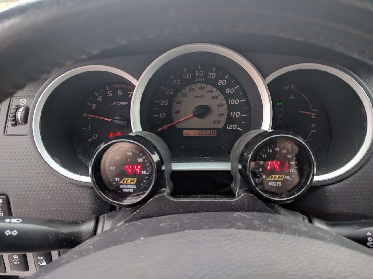

    Old post I know, but do these gauges block your view of the factory gauges?
  4. May 22, 2023 at 8:05 PM
    CrackerJackMack
    CrackerJackMack First class awesome
    Nov 16, 2011
    #67132
    542
    Kevin
    Dallas, TX
    10 4x4 SR5 TRDoff
    Yes, I have to peer around it to check for CIL's or traction.

    I can see more from my view, but this view is straight on showing maximum coverage (was also the only one I could find in my photos)

    That is a deal breaker for me. I wish they would spread the mounts out more for the 3rd gens so we can see our other gauges.
